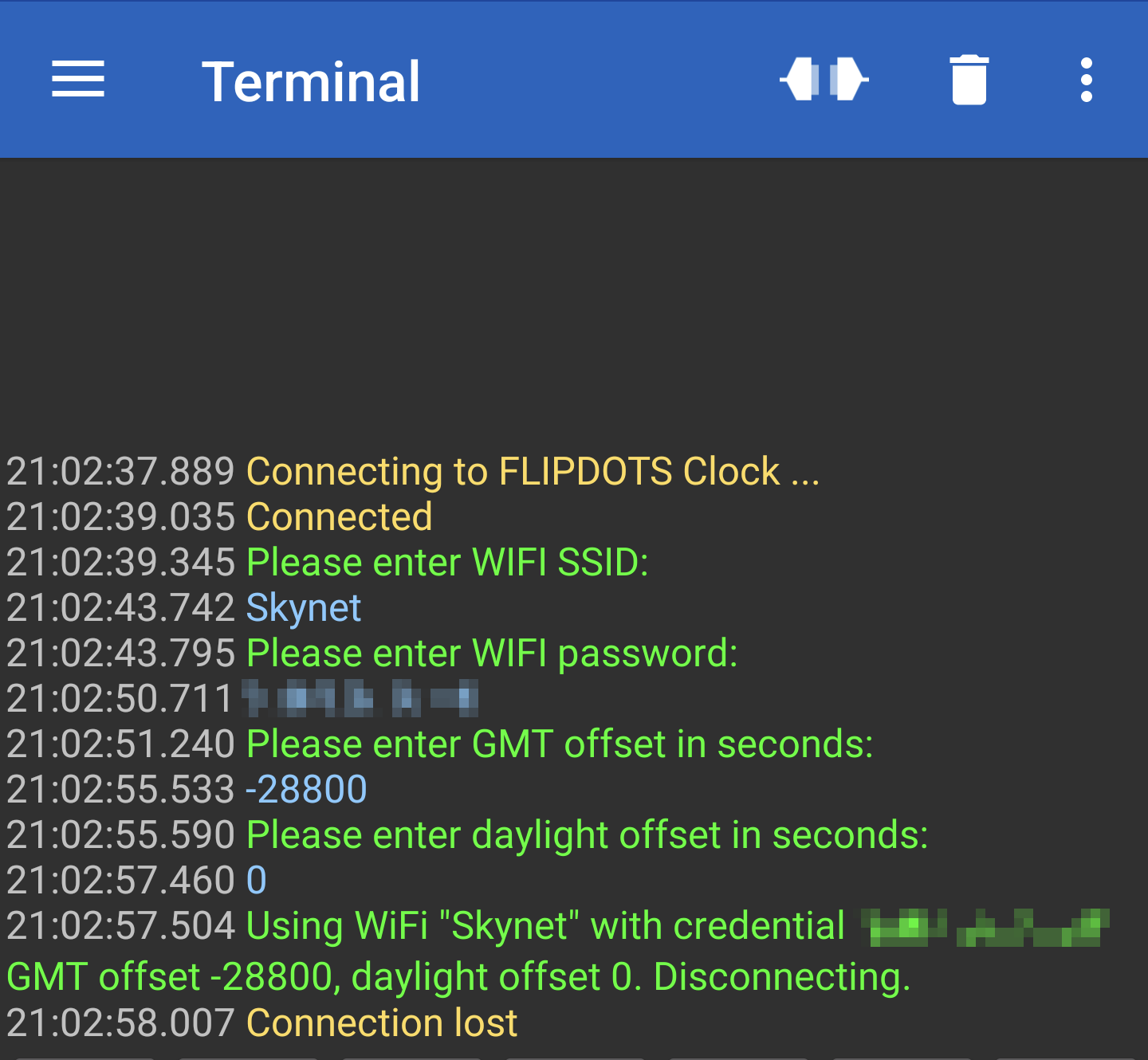

4Configuration
WiFi credentials, timezone, and daylight savings offset is attempted to be set over Bluetooth each time the system boots. If it is successfully configured and connected, it will save that information into the flash storage for use on later boots. If Bluetooth is not connected for 10 seconds on startup, the device will load its last successful configuration from flash. For example, here it's being set over a Bluetooth serial app on an Android phone:
