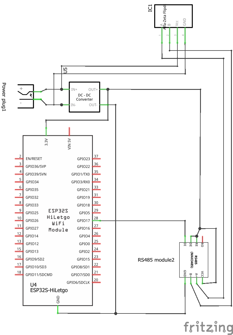

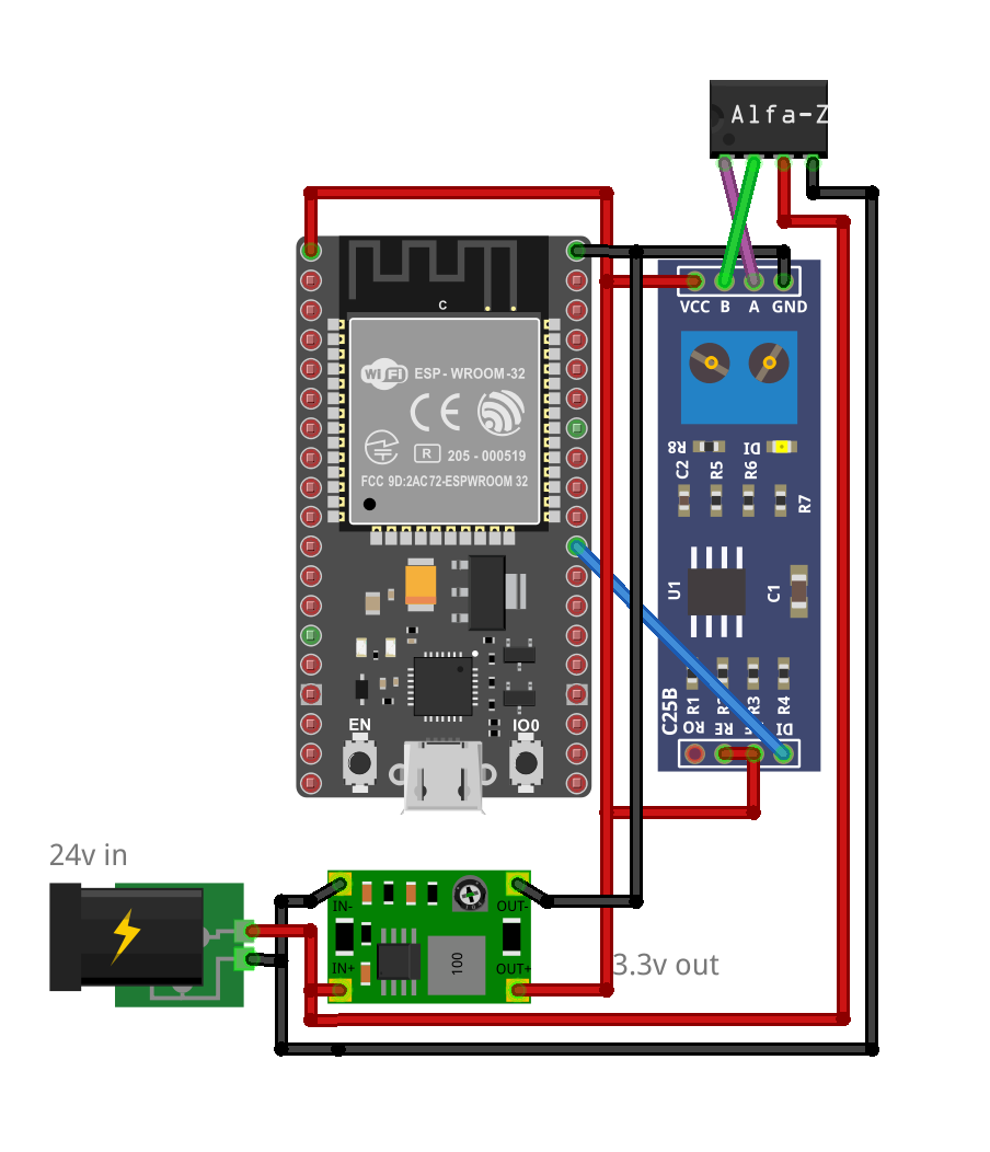

  • 1 × ESP32 (I used a DOIT ESP32 DevKit V1)
  • 1 × Alfa-Zeta 7x7 FLIPDOTS display
  • 1 × MAX485 based RS485 serial tranciever (for communication with display)
  • 1 × DC-DC Buck converter (for stepping down 24v power supply needed for display to 3.3v for logic)
  • 1 × 24v 1.5A power supply (although you could get away with much less)
  • 1
    Wiring
  • 2
    Code

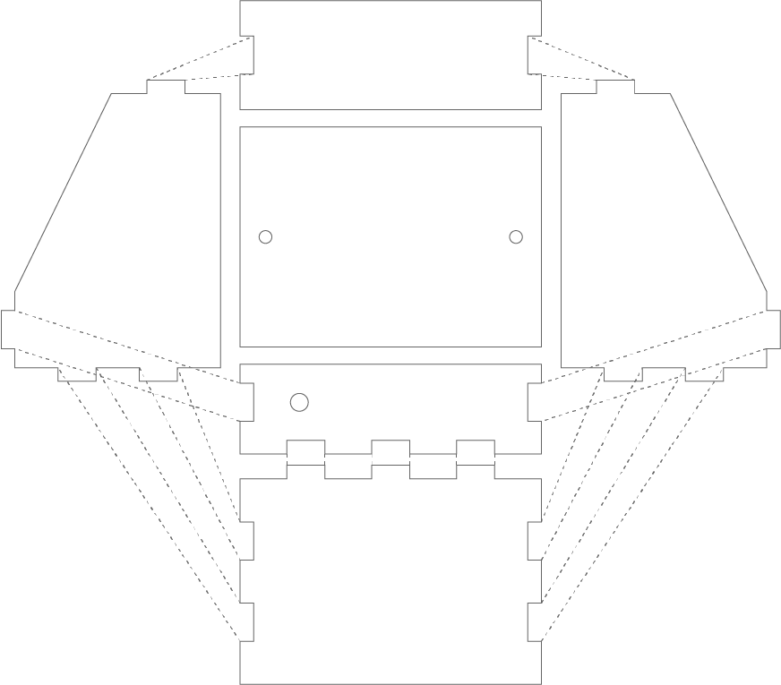

    Enclosure
    The enclosure was designed in Fusion 360 and laser cut on 5.33mm thick plywood, then stained black. The SVGs used to cut are attached.
