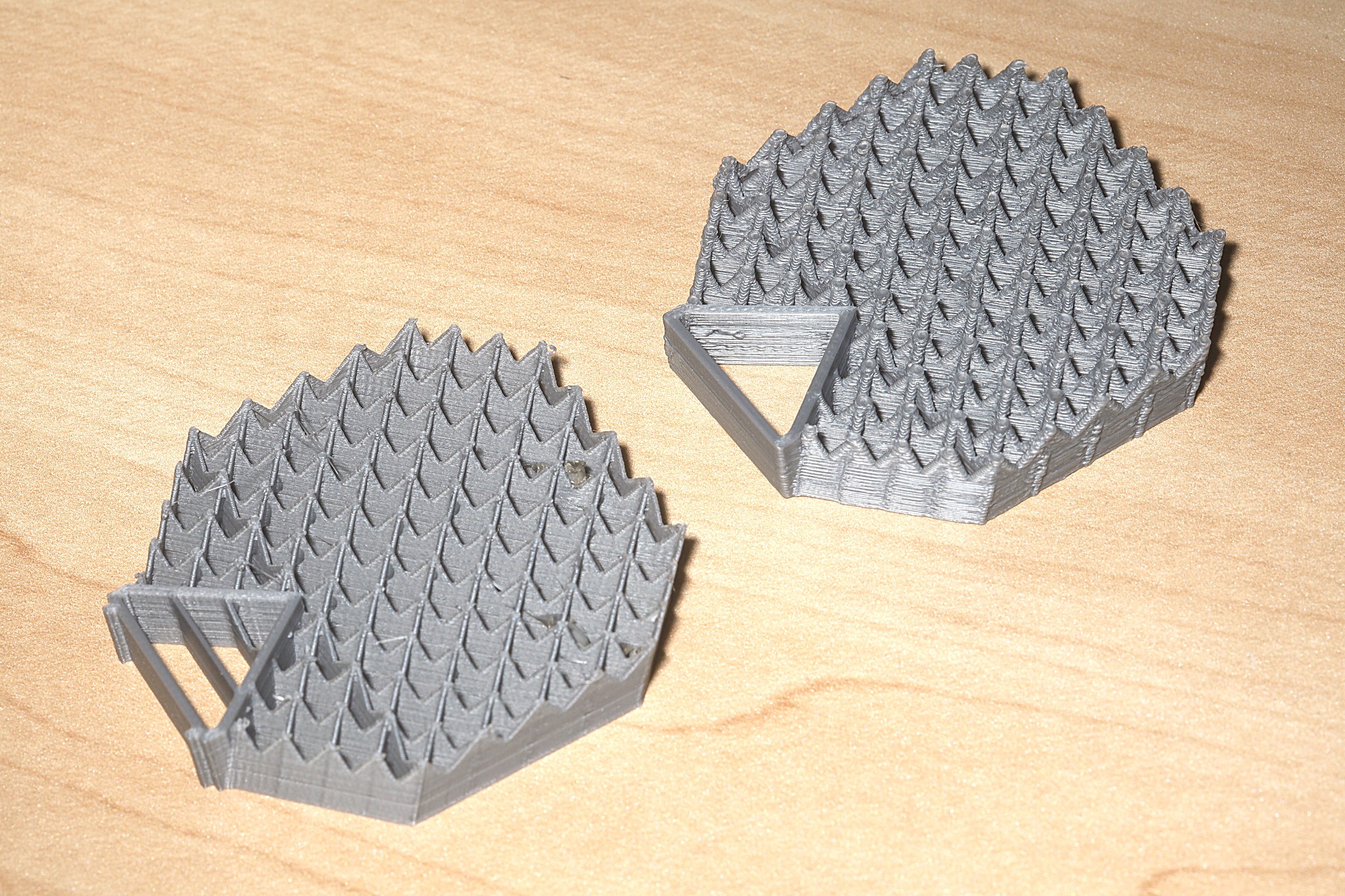

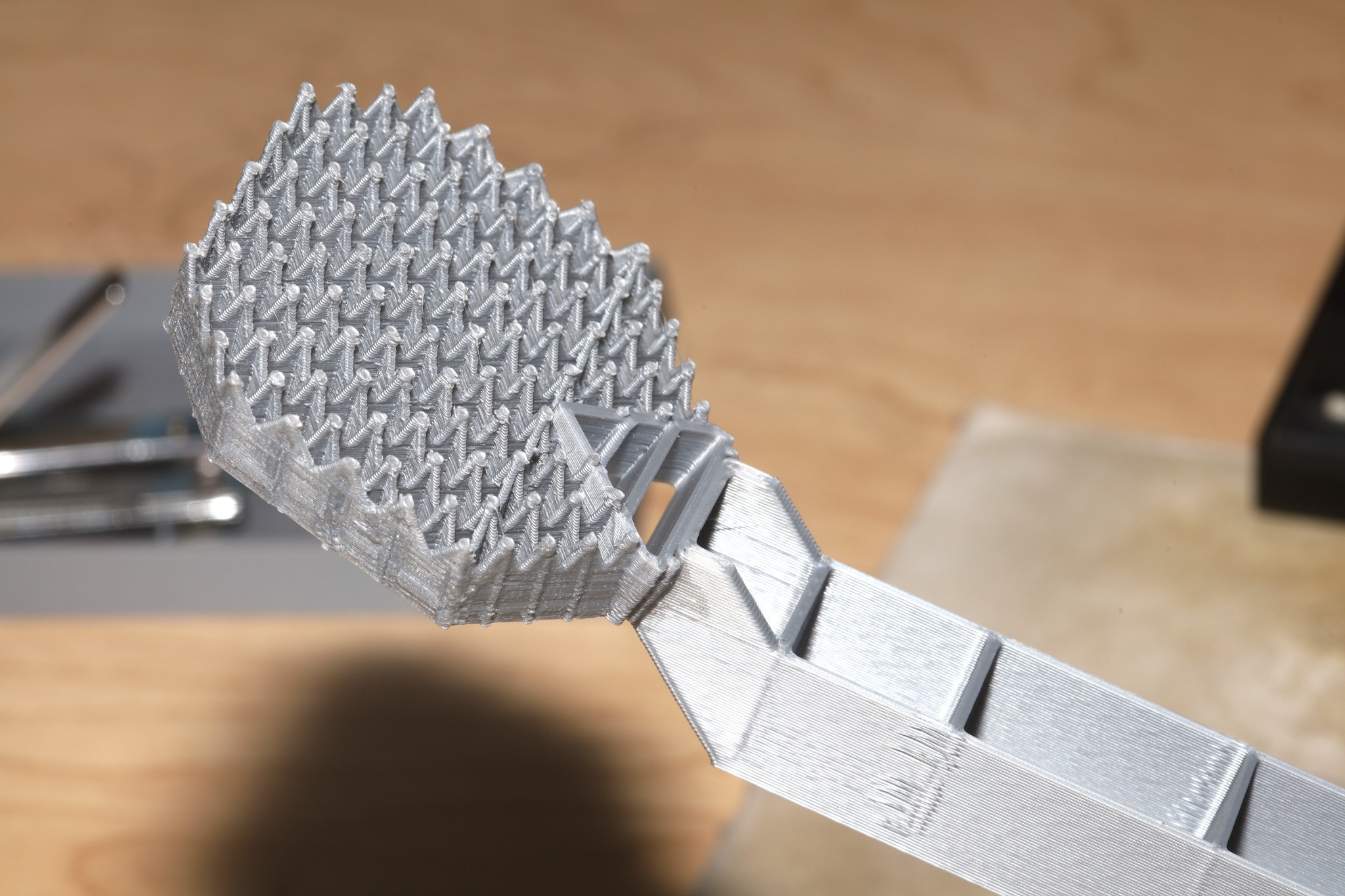

There is an art to designing a back scratcher.

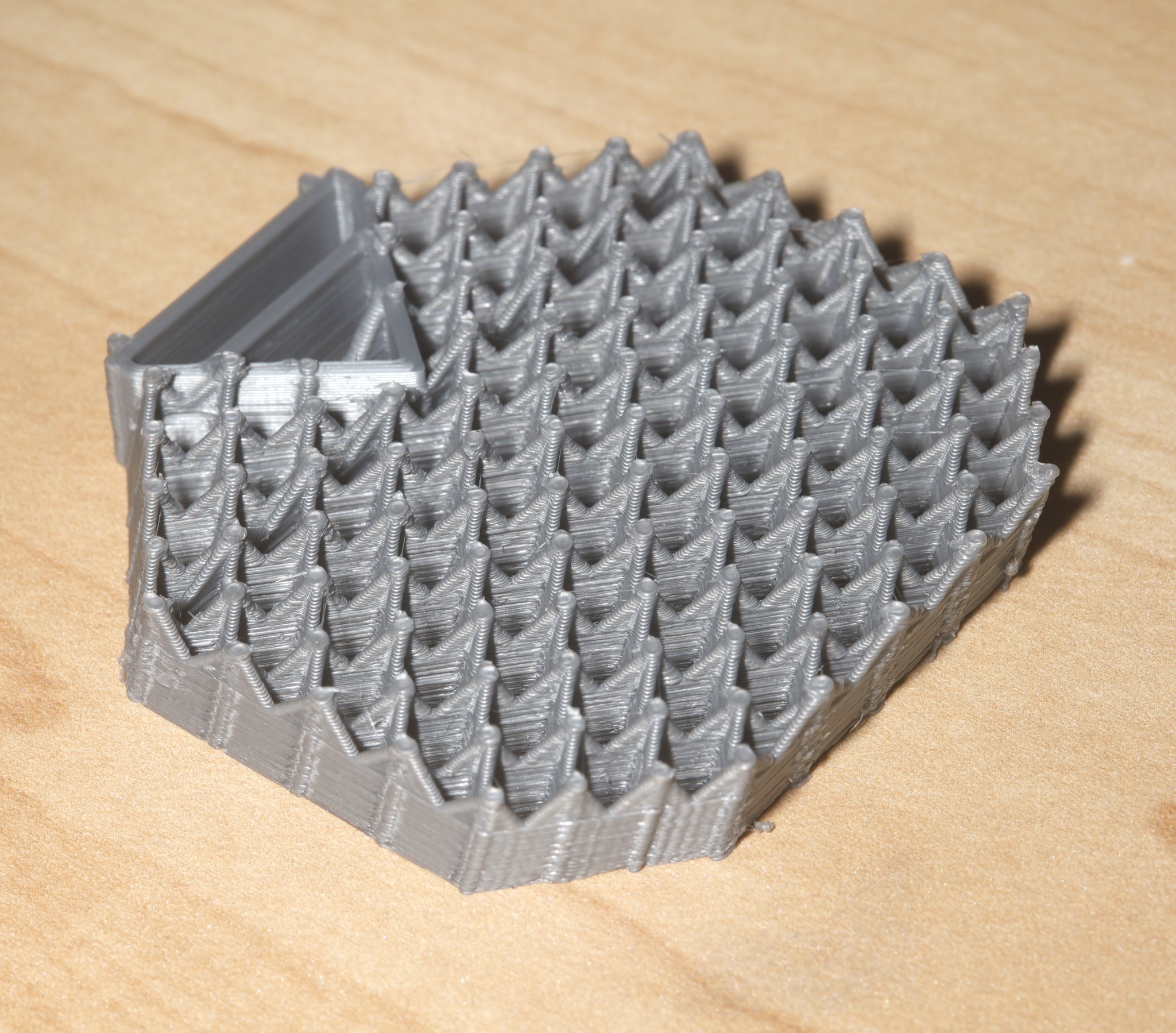

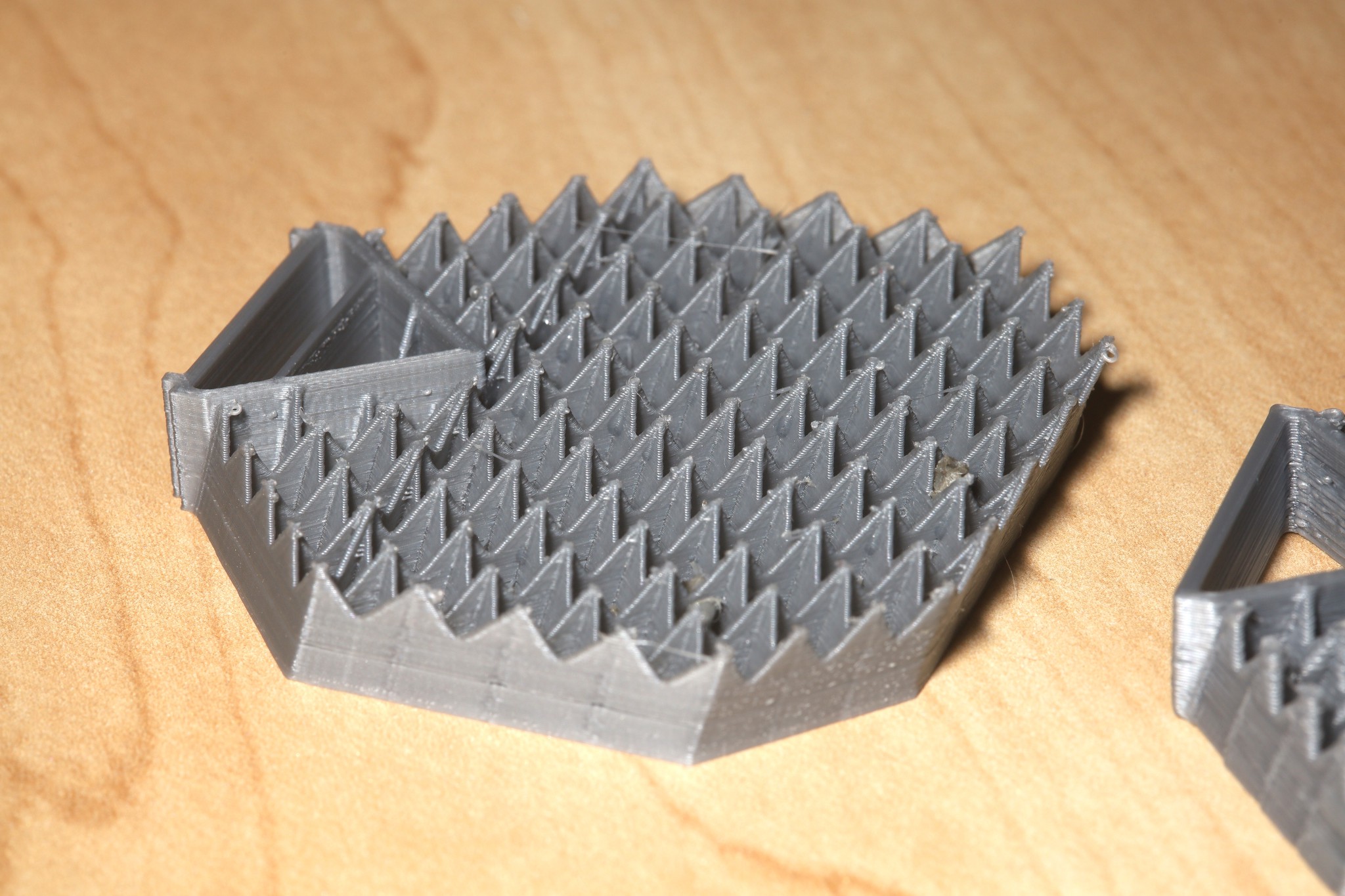

The key feature was interchangeable spikes, since printing a handle is expensive.  The ideal head so far has diagonal crosses on a square panel.
The cross shaped spike, rotated 45 deg, forces skin into a corner before it can pass.  The layers have to be parallel to the plane to get the most abrasive surface.  The spikes have to be tall enough so they do the scratching instead of the edge of the panel.
PLA is much more abrasive than wood, so this can cause injury if abused.  A few light brushes are all it takes to cure all itches.
A diamond panel was less effective because it presents a narrower line of spikes in the direction of travel.

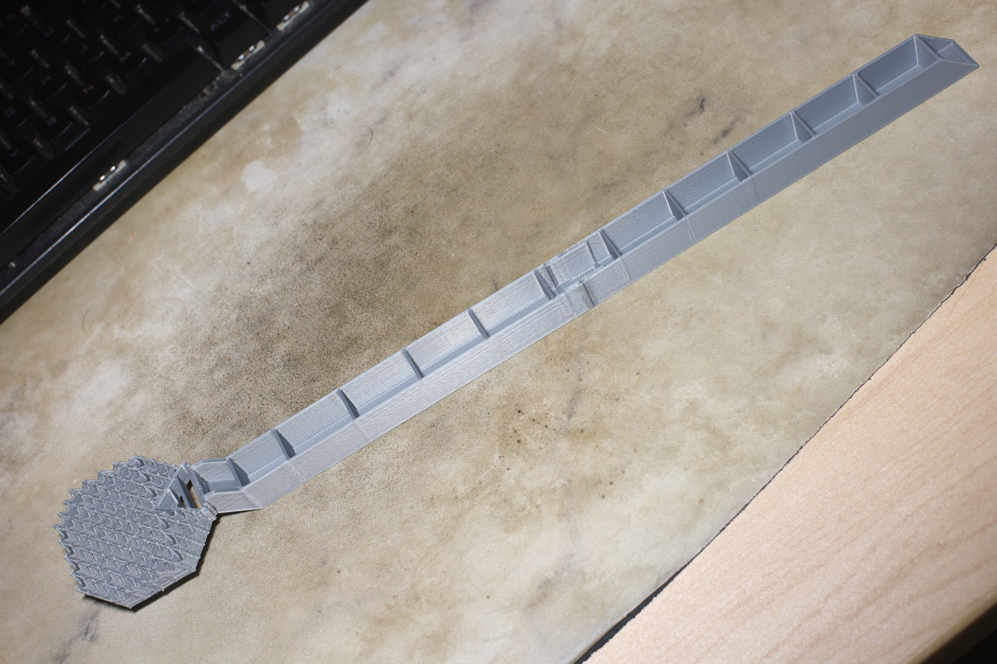

The handle is too short, but it was all lions could afford.  Other back scratchers bolt on to a wood dowel, but the lion kingdom figured bolting onto wood wouldn't be as stiff as a single piece of plastic.  It has a sharp end for scratching other areas not best served by the spikes.
The ever important captive nut farstens the scratcher.

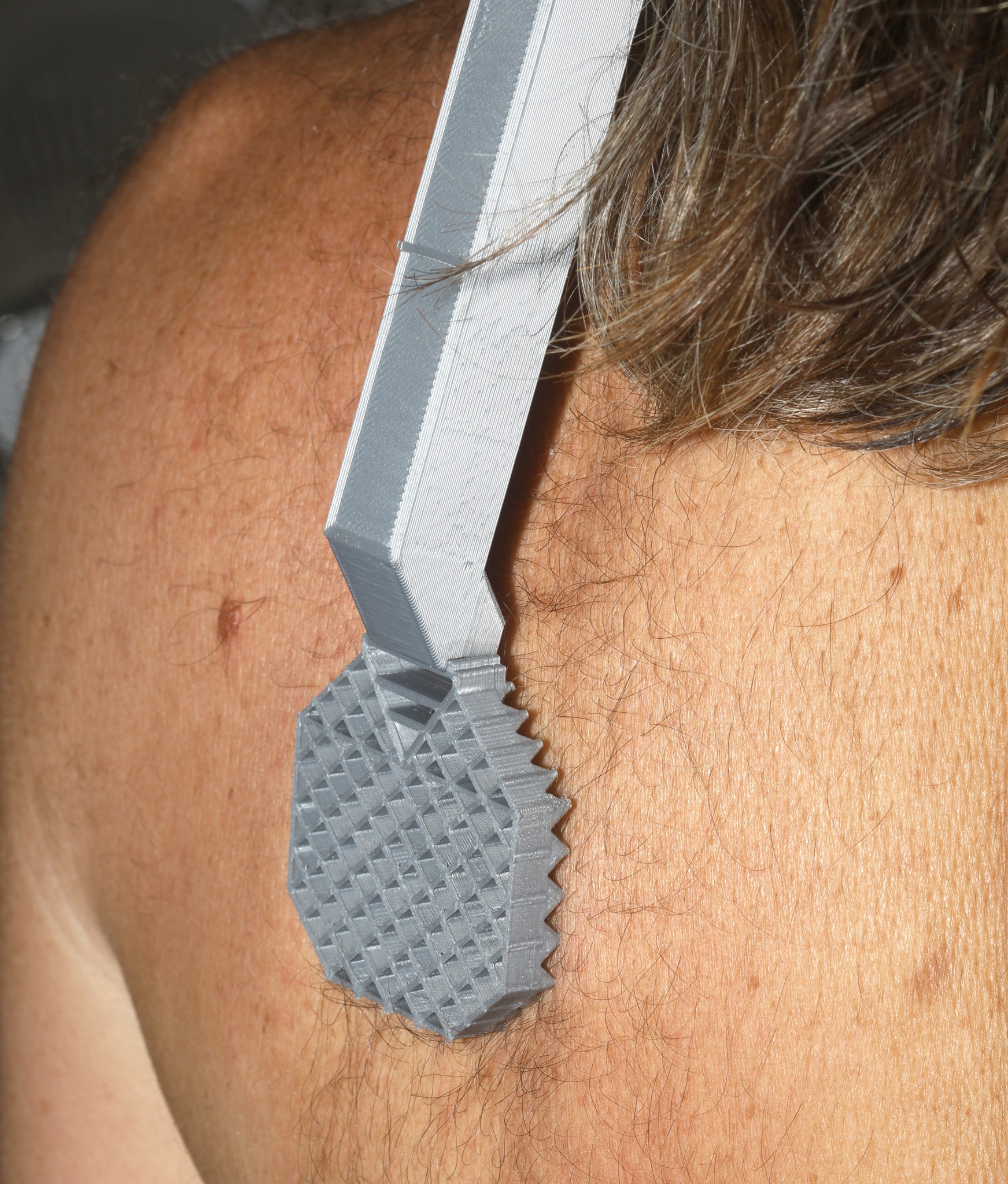

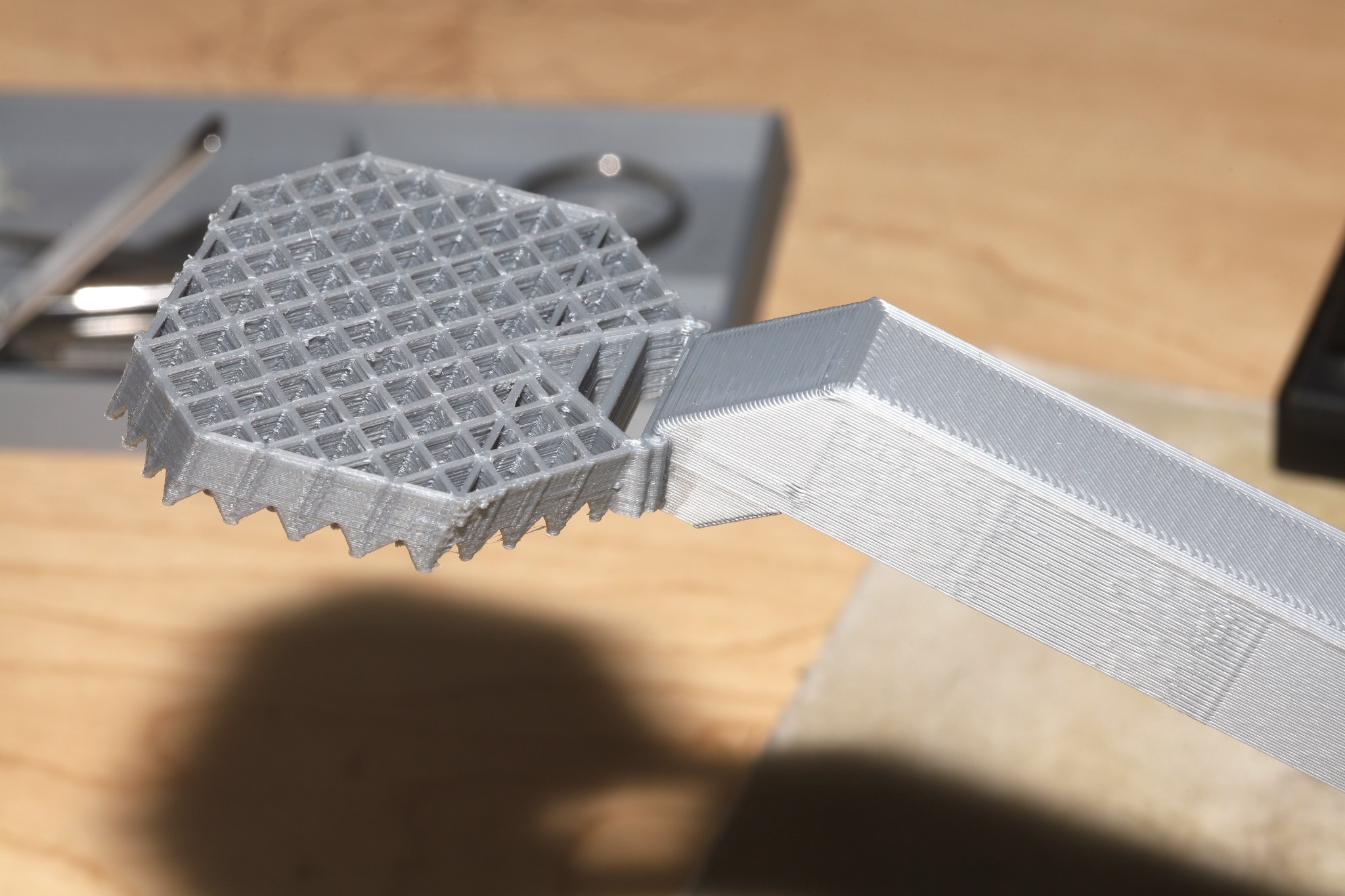

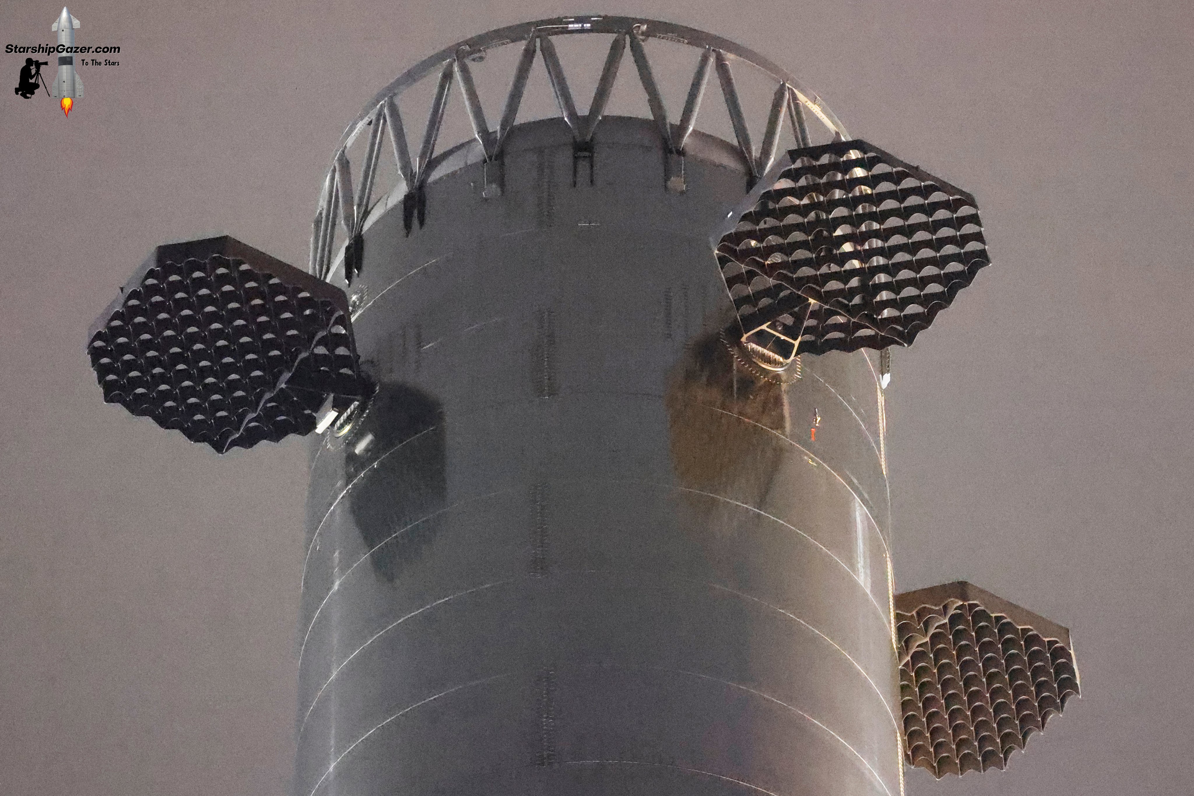

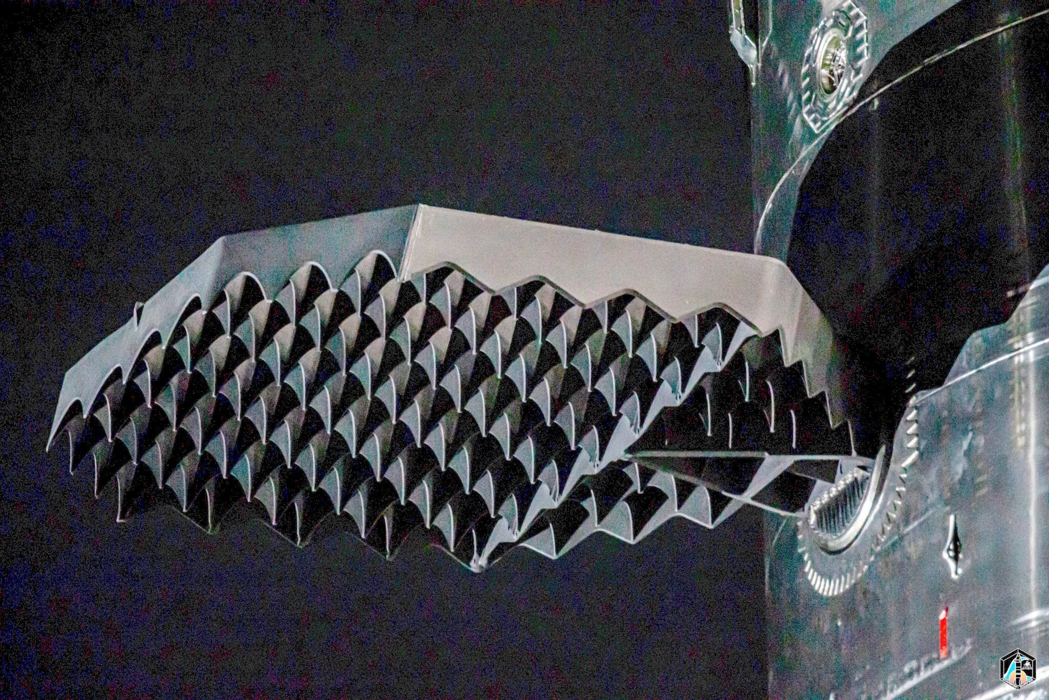

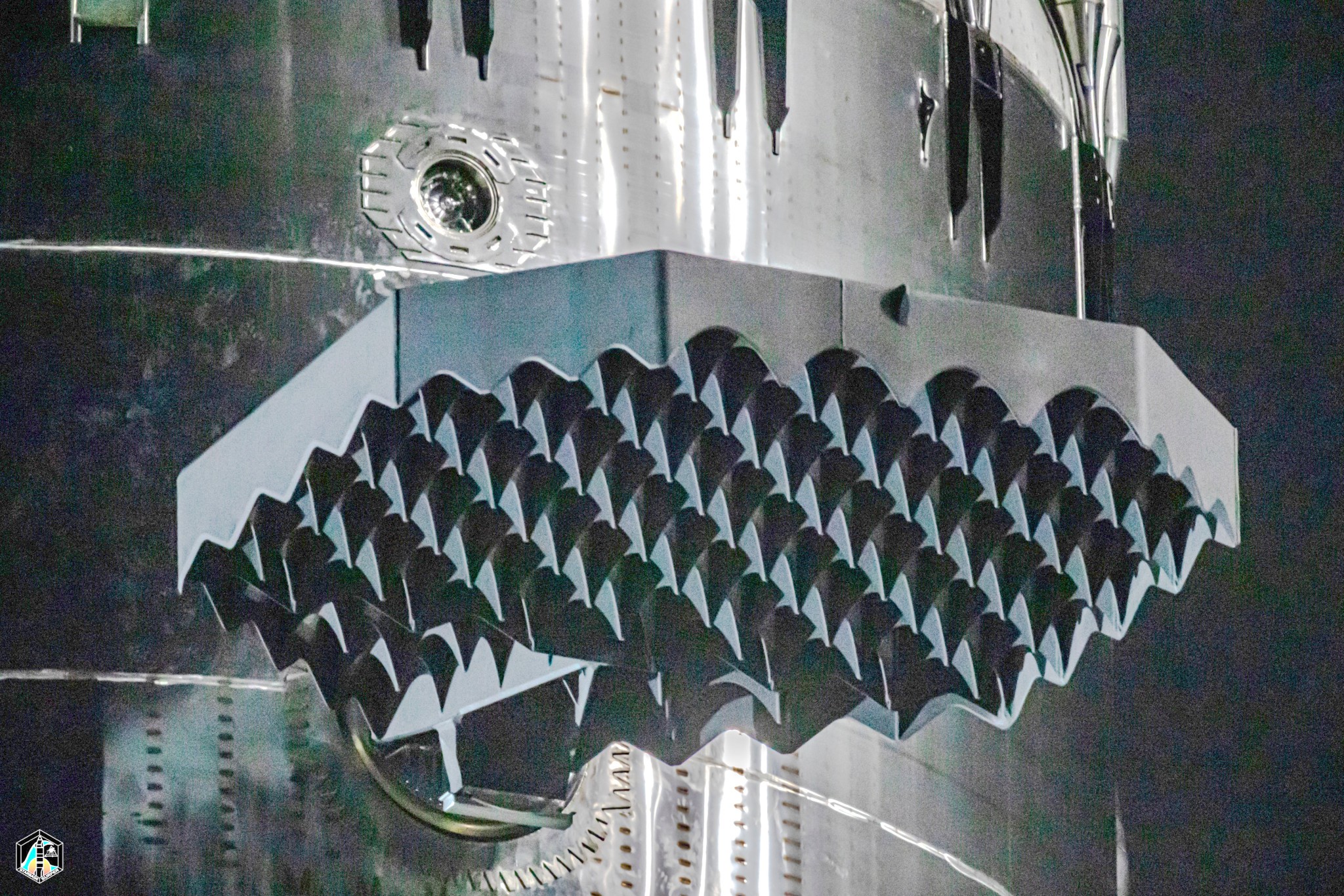

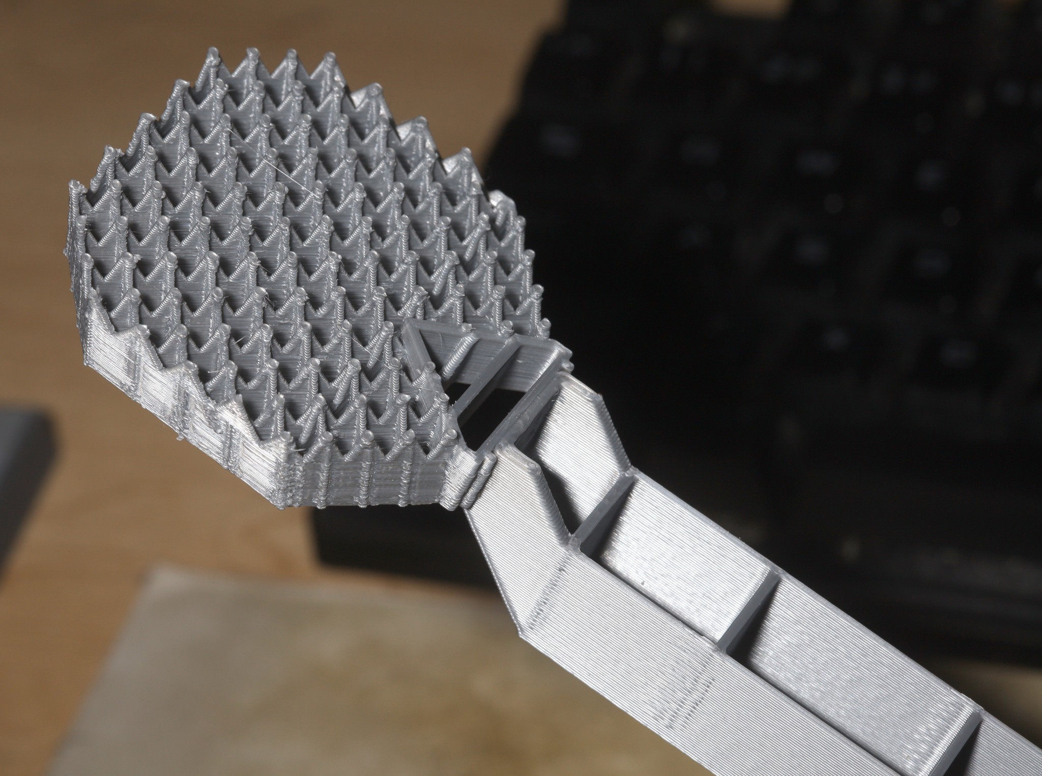

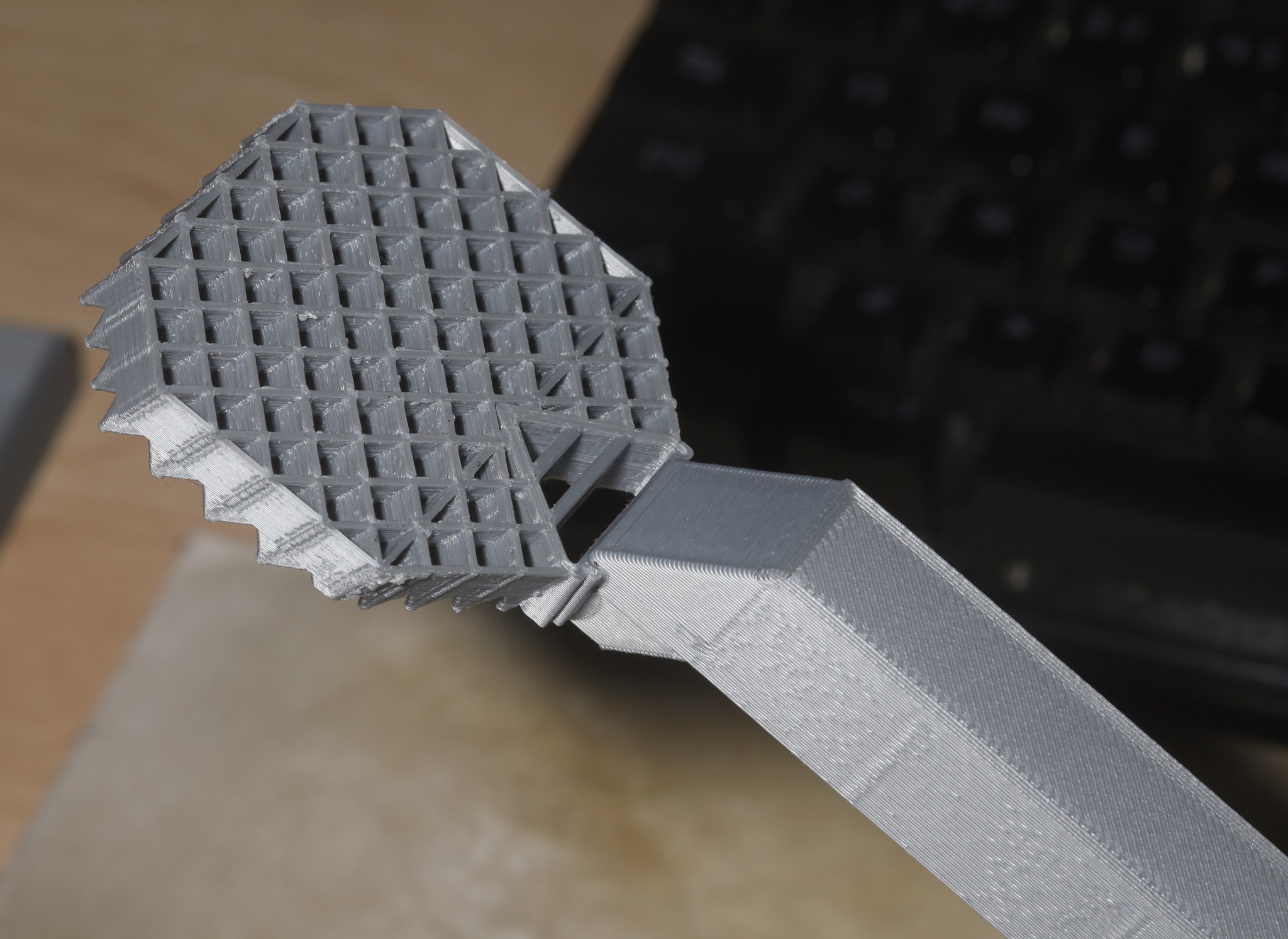

    Tried improving the scratch by increasing the handle angle 10deg.  Also laminated it with CA since the border walls break easily.  It manely scratches with just the last row.  The problem is the slanted grid fin is not the optimum shape for a scratcher.  It's slanted to force the tail down & the engine section up, increasing the angle of attack.
    The side grid fins would be a better match, would be a lot easier to model, but wouldn't look as neat.  The catching pins would have to be removed to make it scratch.
    The 8mm tall joint joining the handle is very fragile.  No matter what, there's going to be a transition to the 8mm height of the grid fin.
    The grid fin printed by the .2 nozzle with .5 walls was very fragile, breaking when pressed against a table.  The grid fin printed by the .4 nozzle with .3 lines & .5 walls didn't break with the same pressure.

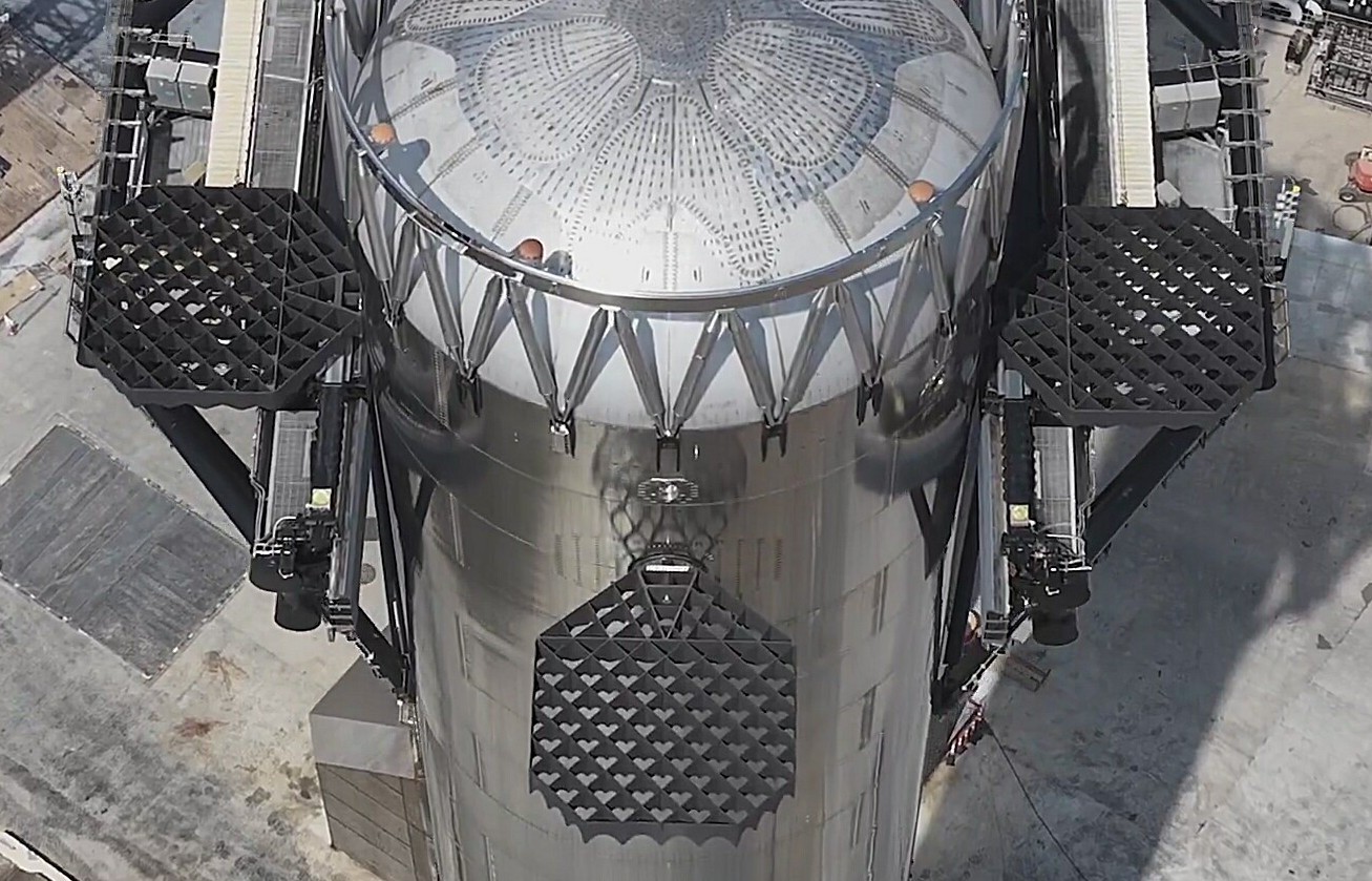

    They had another photo of the slanted grid fin.

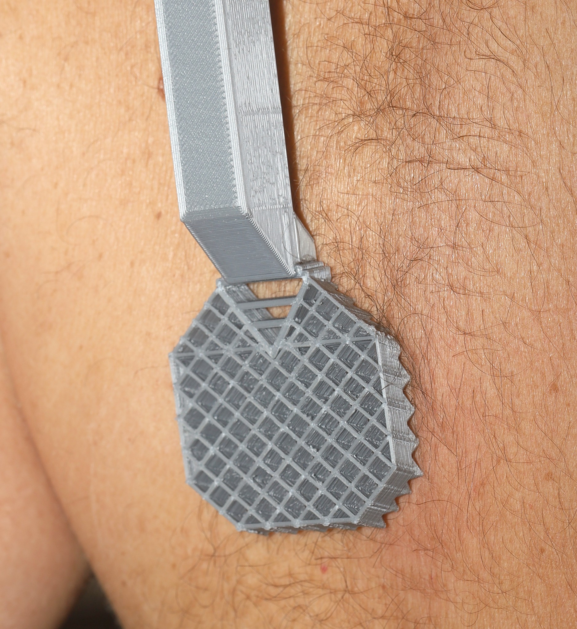

    Decided to go with a right angle grid fin to increase the assertiveness.
    Some photos of the right angle ones showed they're the same dimensions & the catching pin wouldn't be joining us if it was to be a scratcher.  The booleans still required fiddling with the threshold in blender.
    The 10 deg handle angle still seemed right, even if many positions only use the farthest row of spikes.  An adjustable angle would entail a set screw.

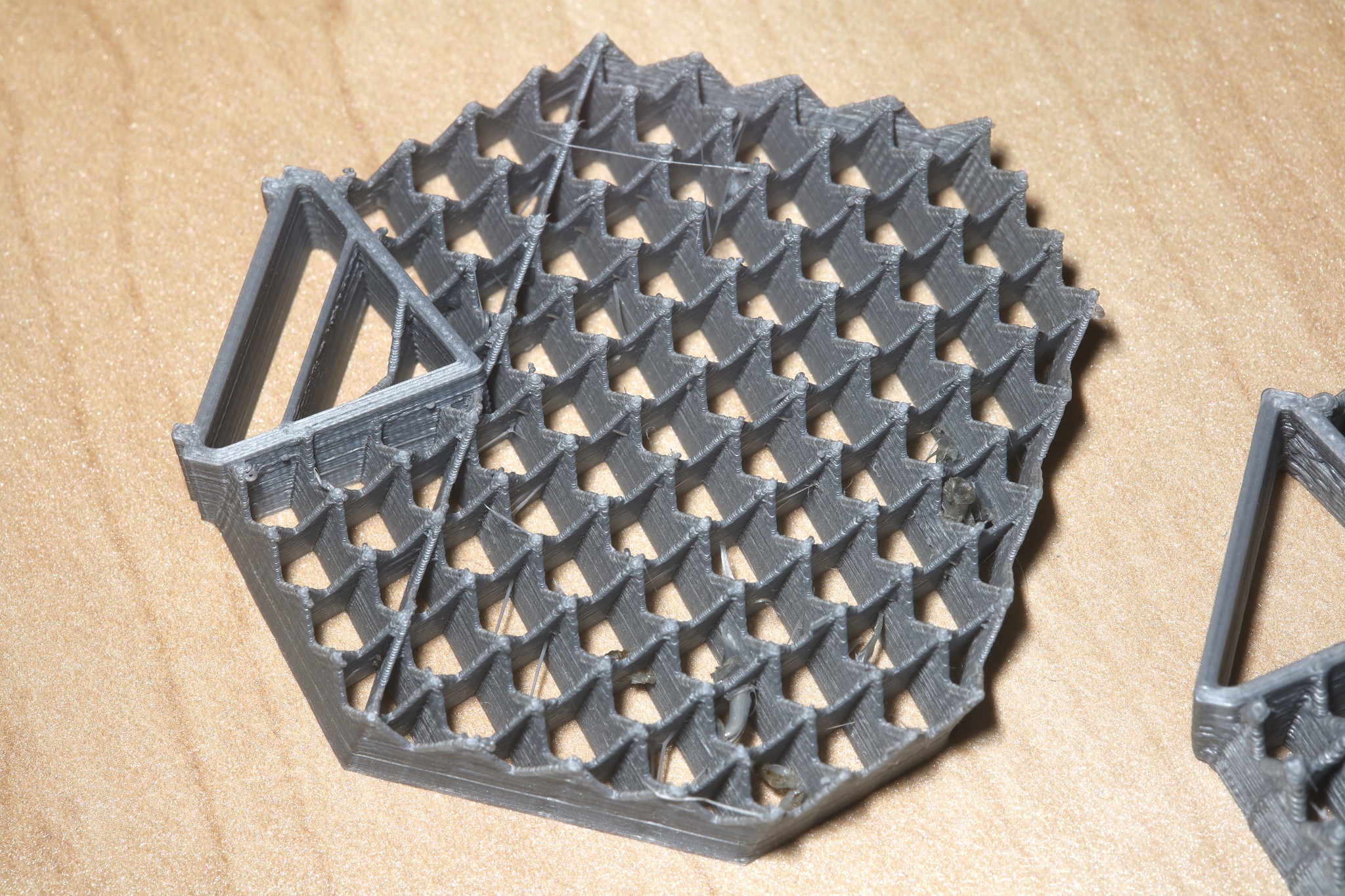

    The great challenge was making the grid fin small enough while detailed enough.  .4 line width with .4 nozzle couldn't make it look enough like a grid fin.  .2 line width with a .2 nozzle was the most realistic.
    It was the 2nd lifetime print with the .2 nozzle.  Helas, the .2 nozzle would require thicker walls to be a structural piece instead of an art piece.  Unsolvable problems with leaking of the .2 nozzle prevented it from printing any more than .5mm walls.
    The best results with the .4 nozzle used .3 line width.  47mm wide seemed to be the largest practical back scratcher.  Either the grid fin would have to be larger or compromises would have to be made.  It would be a good application of resin printing.
    The latest practice has been to glue the scratching head on the handle.  There has never been a need to swap scratching heads.

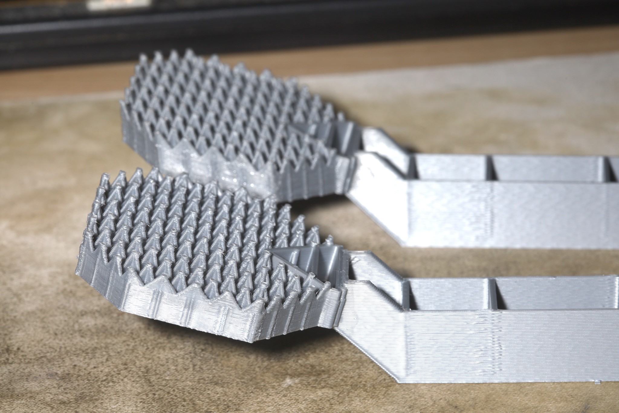

    It does wear down over time.  It's only on a microscopic level, but noticeable.  The new scratcher has a slight plateau where the nozzle slides off.  The old scratcher has the plateau worn down.
    Some new ideas emerged, like lengthening the handle, making the scratching head convex, either keeping the spikes parallel or making the spikes radial.  The scratcher has proven useful for scratching many other body parts & makes a big impact on the pet hair situation.
    A convex scratcher was designed.  The spikes are farther apart.
    The rear scratcher is not to be underestimated.  The longest handle the Ender 3 could print ended up being 270mm.
