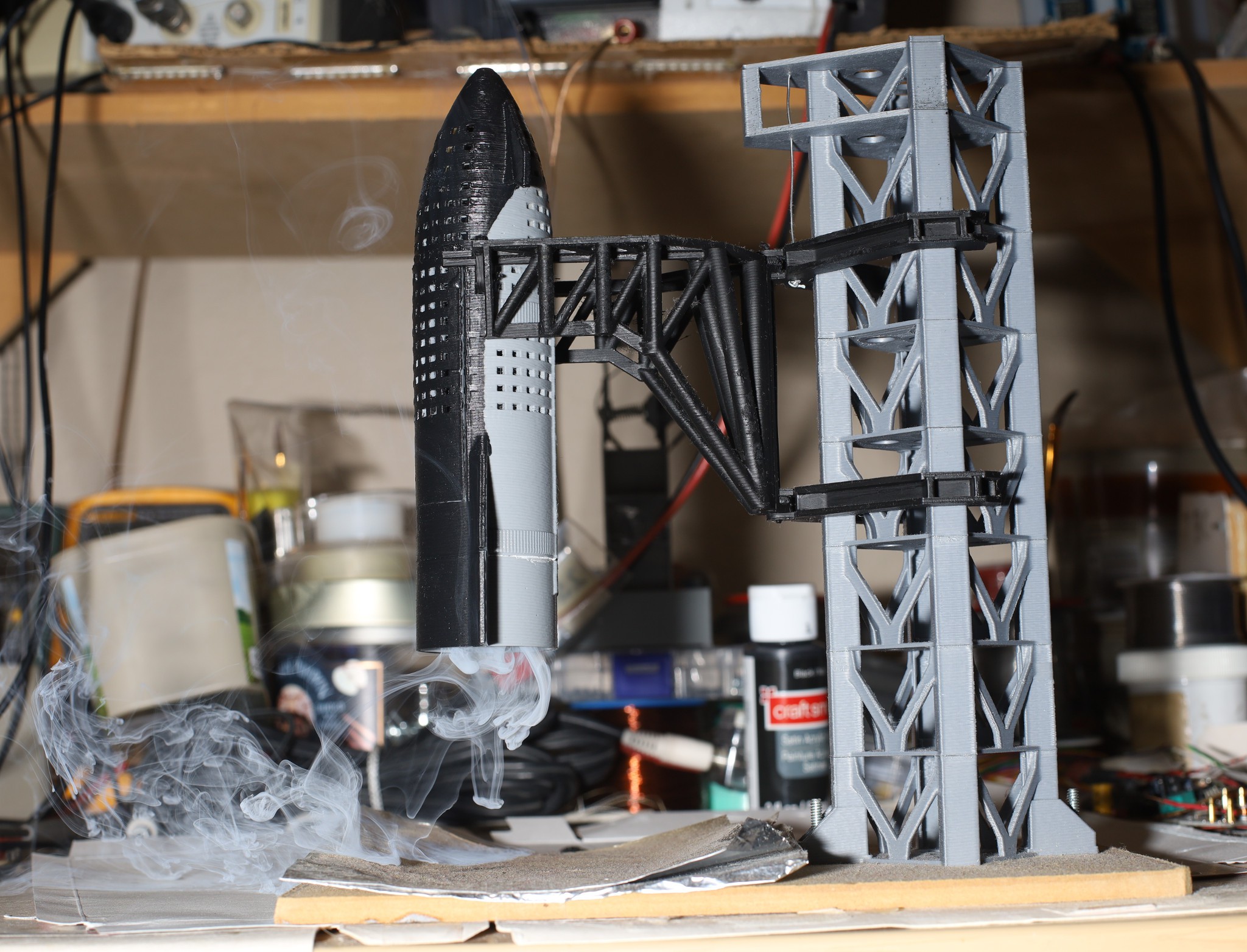

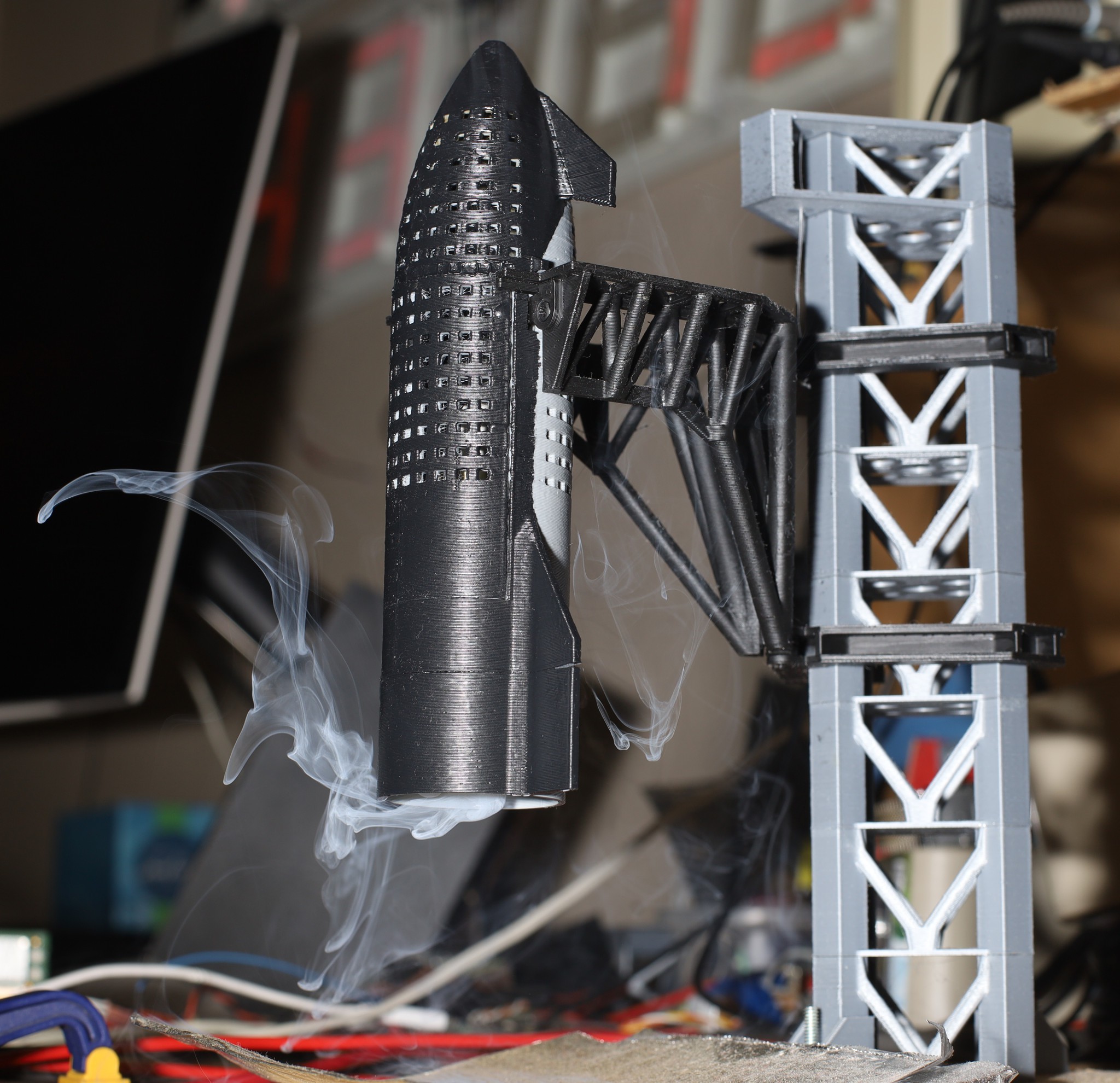

A starship model with real smoke exhaust

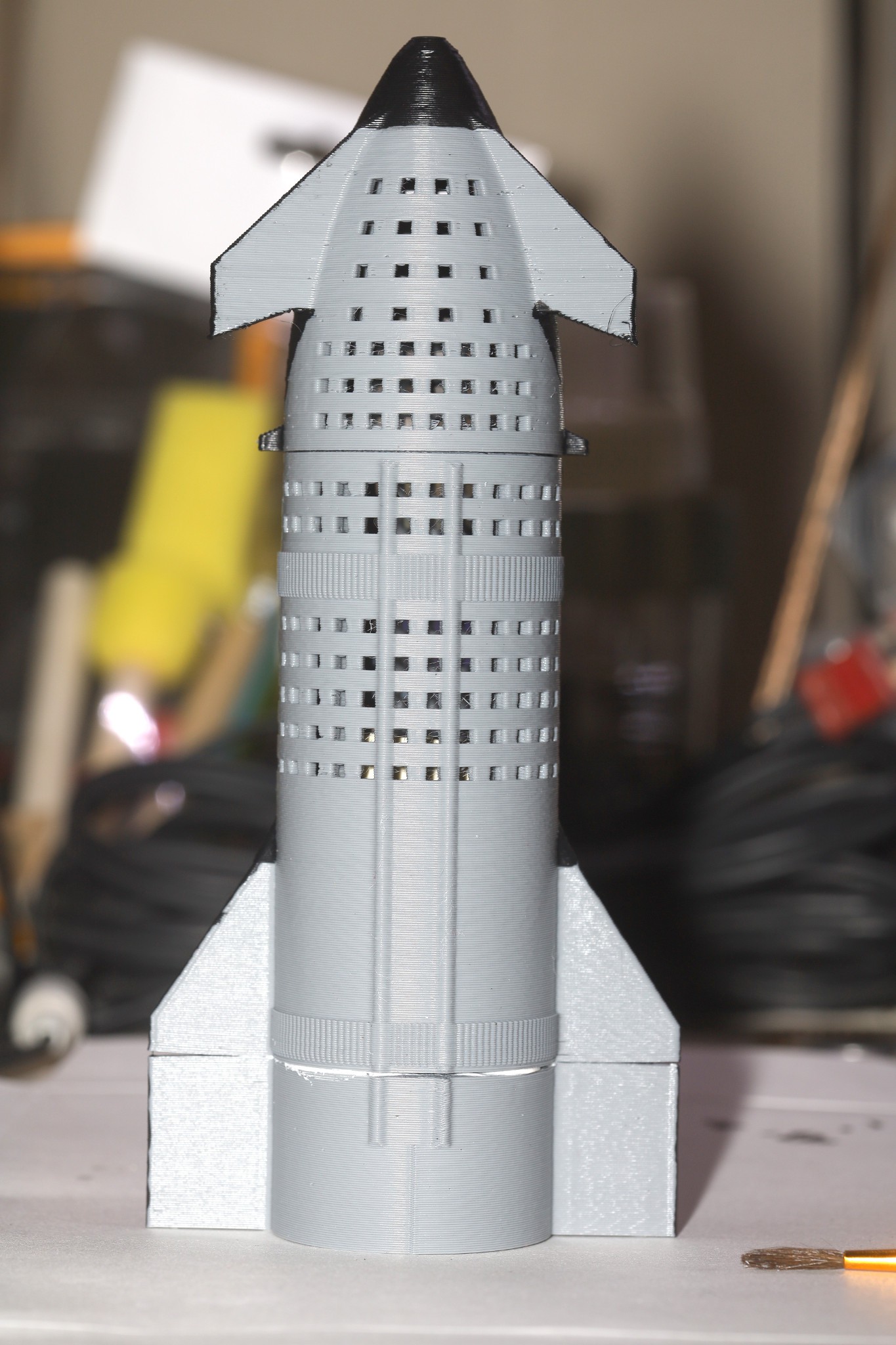

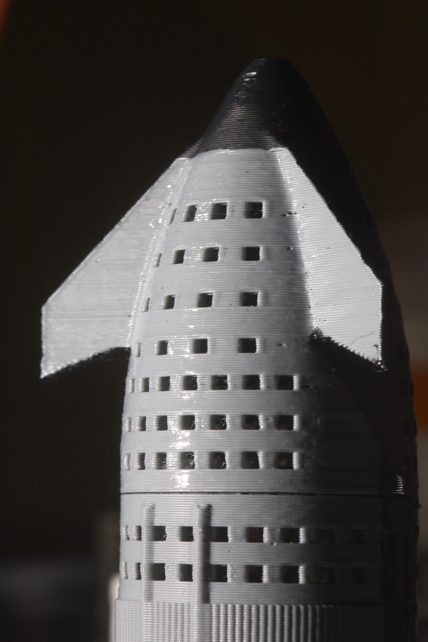

There is a trend in commercial incense burners of having the cone fully exposed instead of trying to make a wind break. The original reason for the rocket was to use it as a wind break but any wind break seems to make a problematic updraft. It could still be useful as an exhaust duct. The latest idea is to chop off the nose & use the cone as the nose. Then make a cylinder all the way up to the nose fins. The hot section would be fully enclosed in the cylinder & go down to the tail fins. This eliminates any room to taper the cylinder into a cone. The cylinder could be removed from above the tail fins for cleaning.

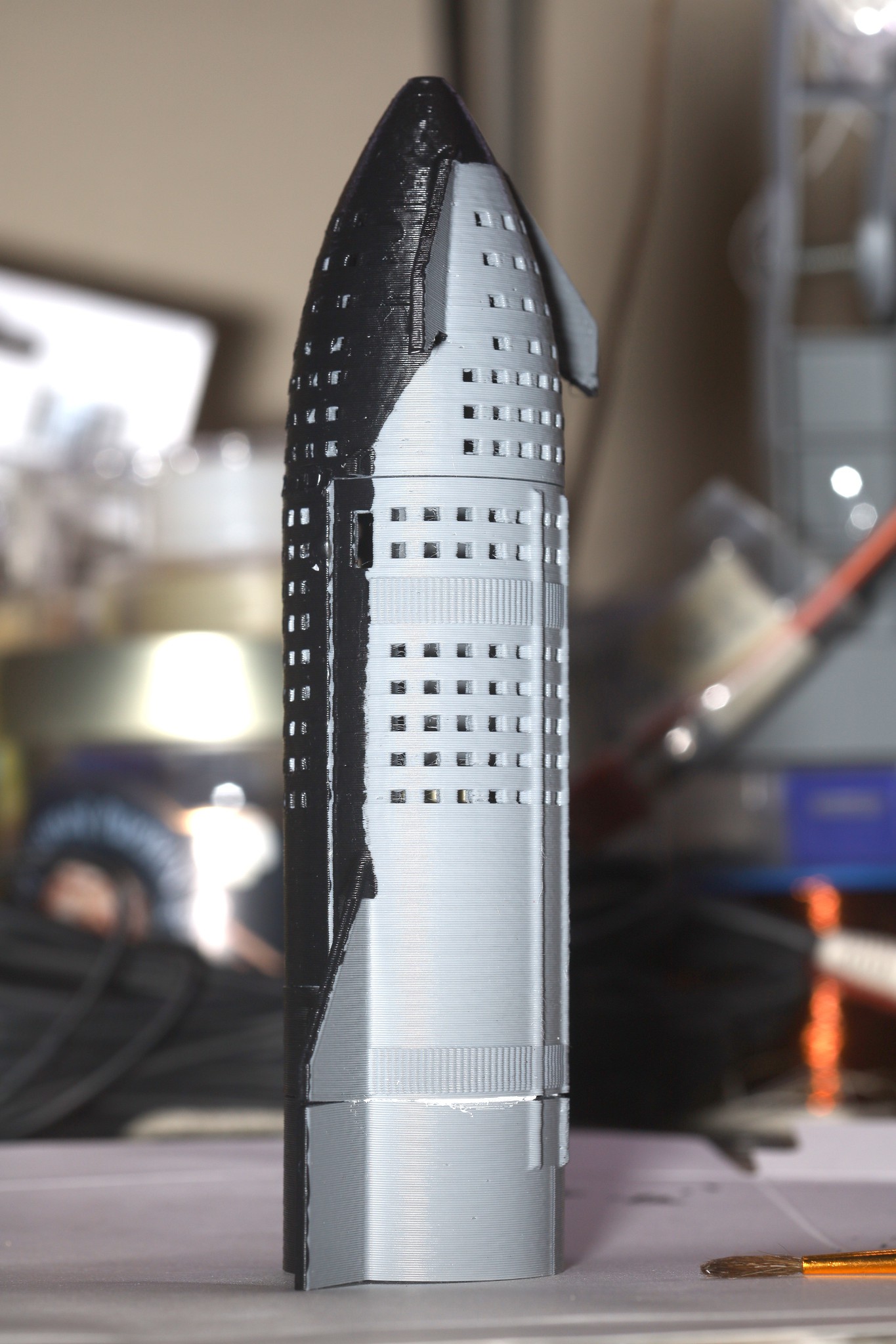

Playing with an aluminum tray some more, it might be good enough with the current amount of holes & just clay securing the hot section & aligning the nose cone. It just needs a PETG nose cone.

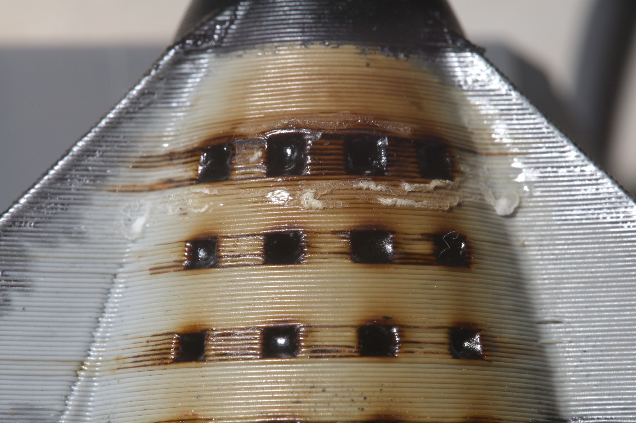

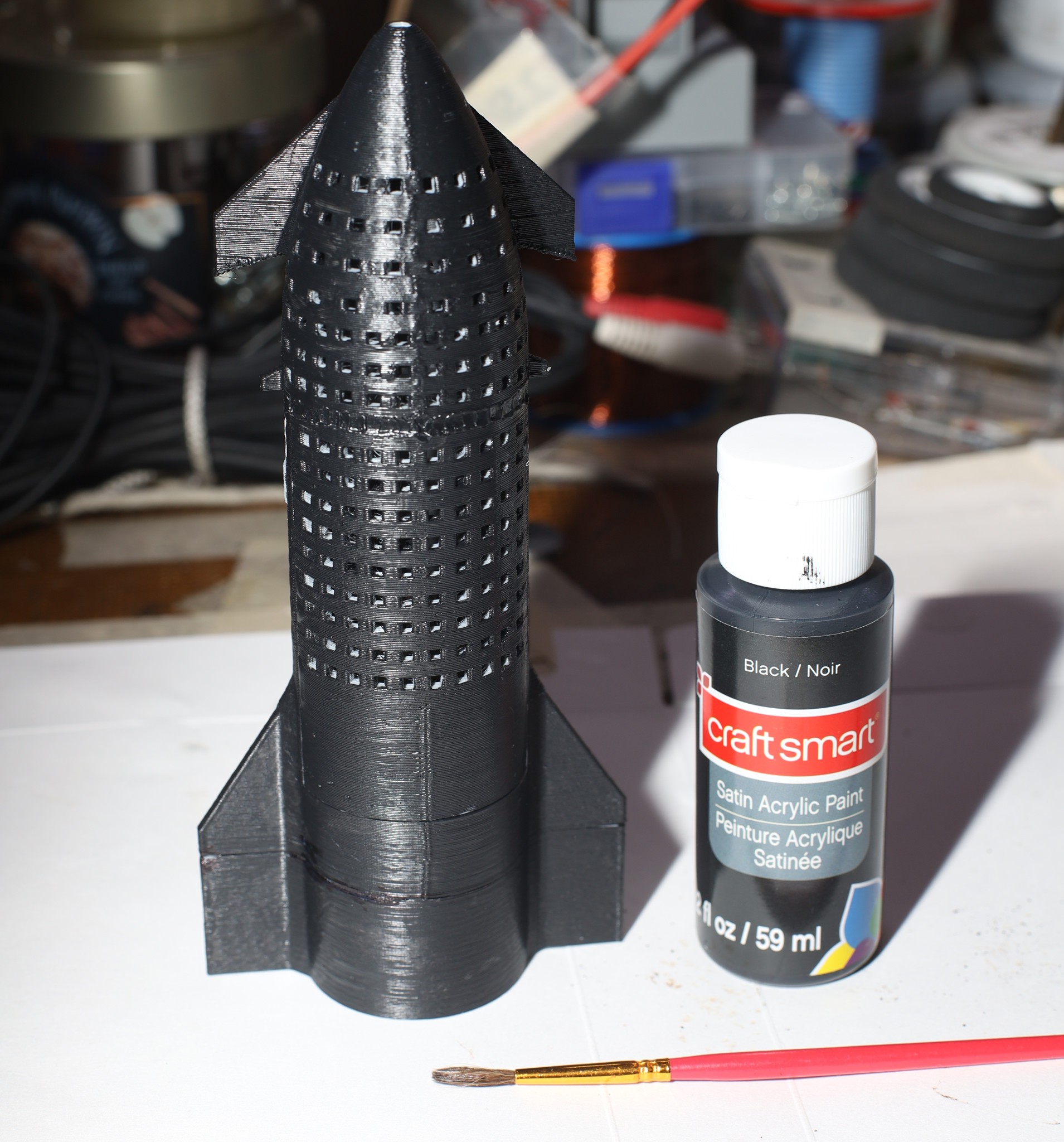

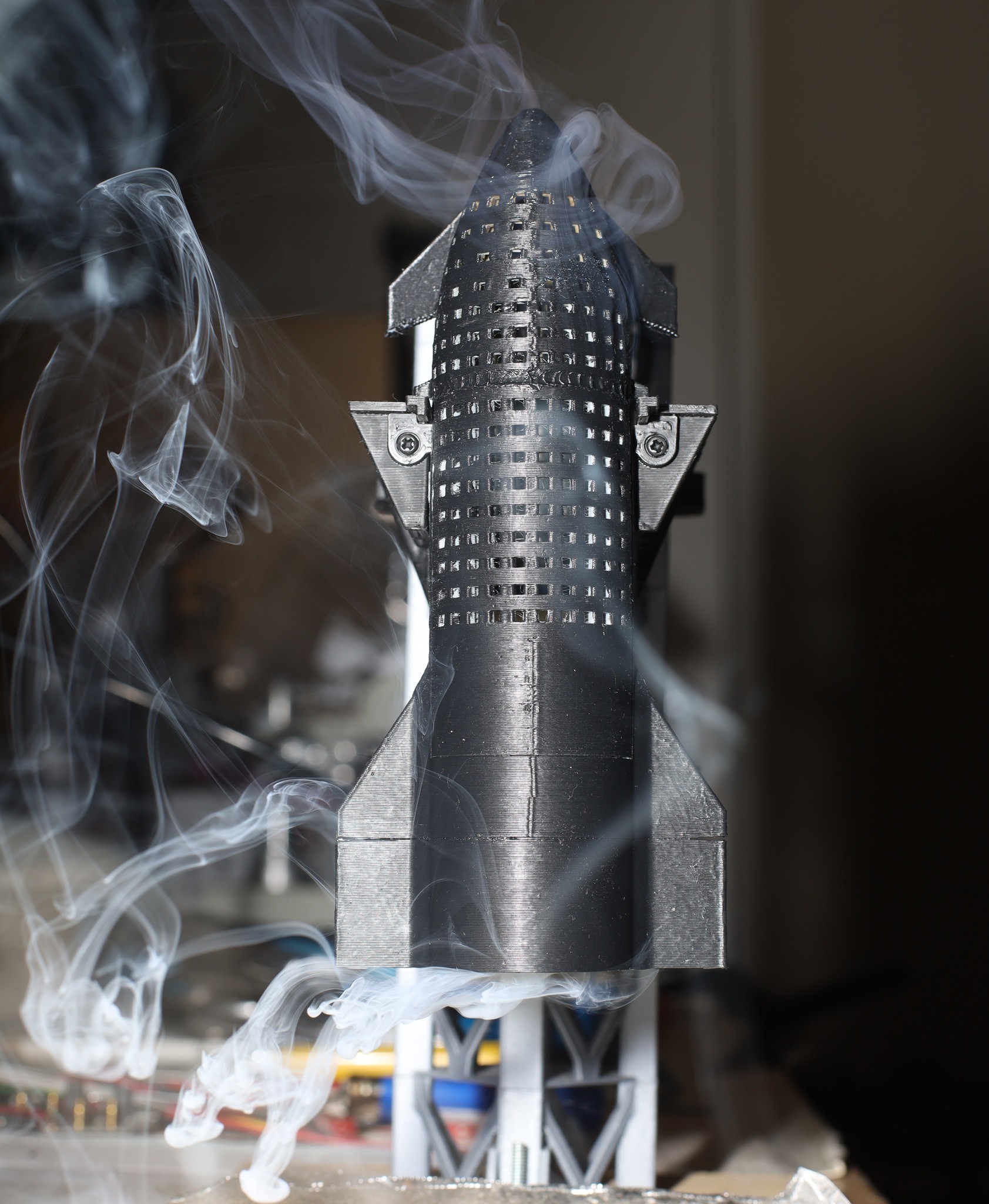

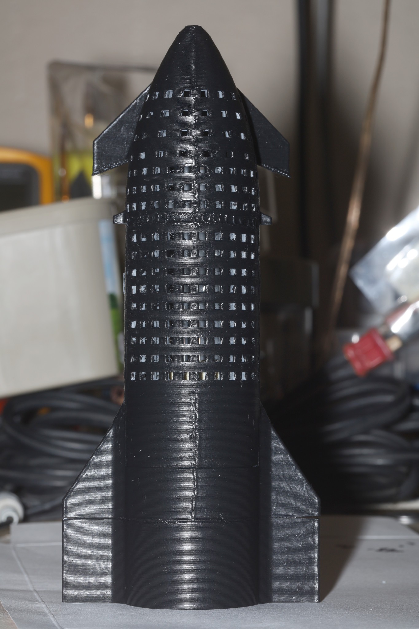

A brand new PETG model achieved the desired smoke, but still got too soft. A system of holes right around the cone seems to give the best results. This cone was manually drilled out.
It gets hottest in the corners right above the cone & it seems to depend on the air currents.
Applied some loctite metal to the trouble spots. This still got too hot to touch, but it managed to keep the PETG from deforming. It remanes to be seen how many cycles it survives & if it stays stuck to PETG. This led to a 1st timelapse of a complete burn.
So basically, the best backflow starship incense burner lions could make ended up being a non functional nose cone on top of an engine section which outgasses like a real engine section. The backflow functionality doesn't serve any purpose other than visual appeal. Maybe it could provide some vicarious audience participation during a starship launch.

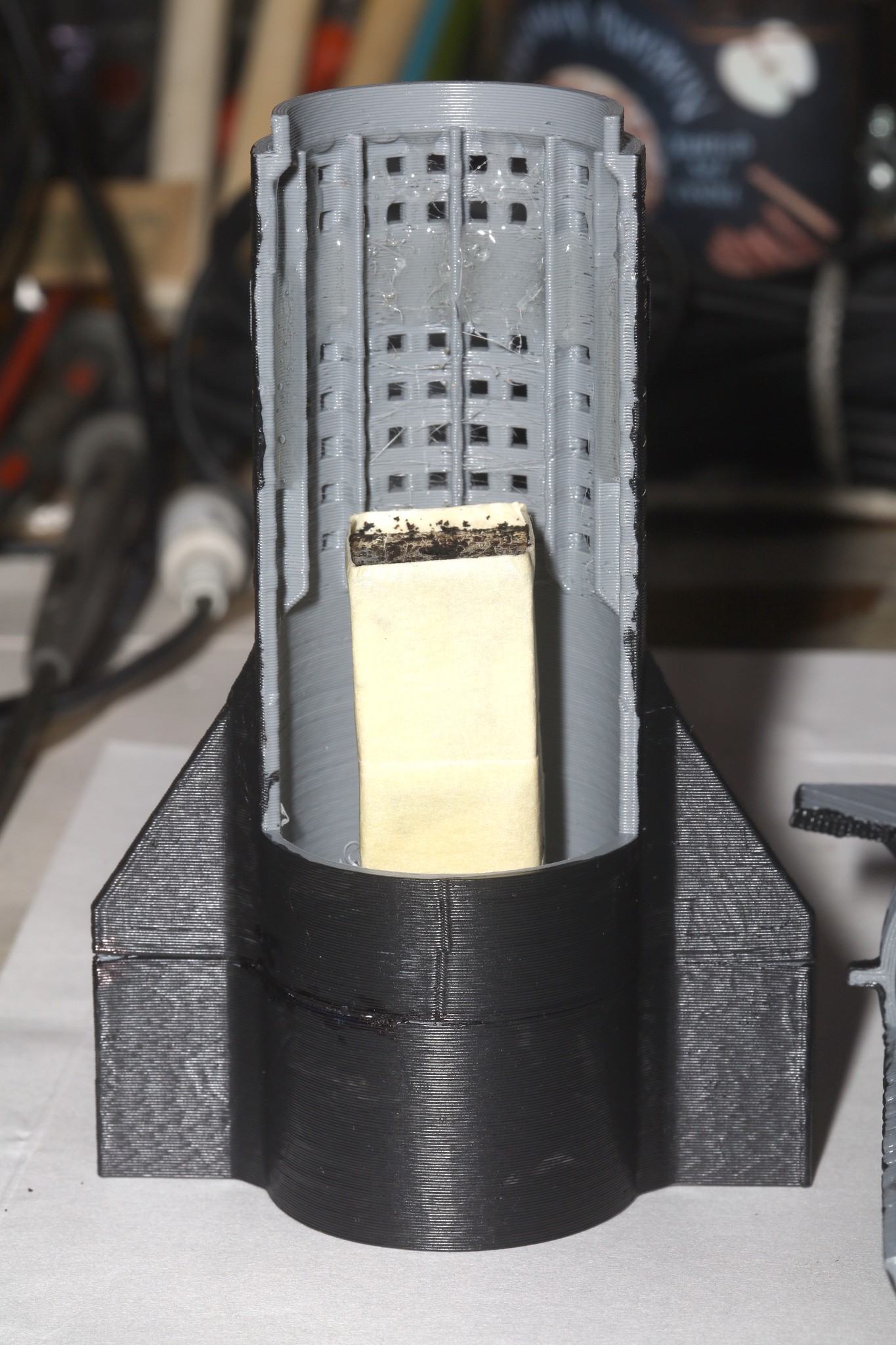

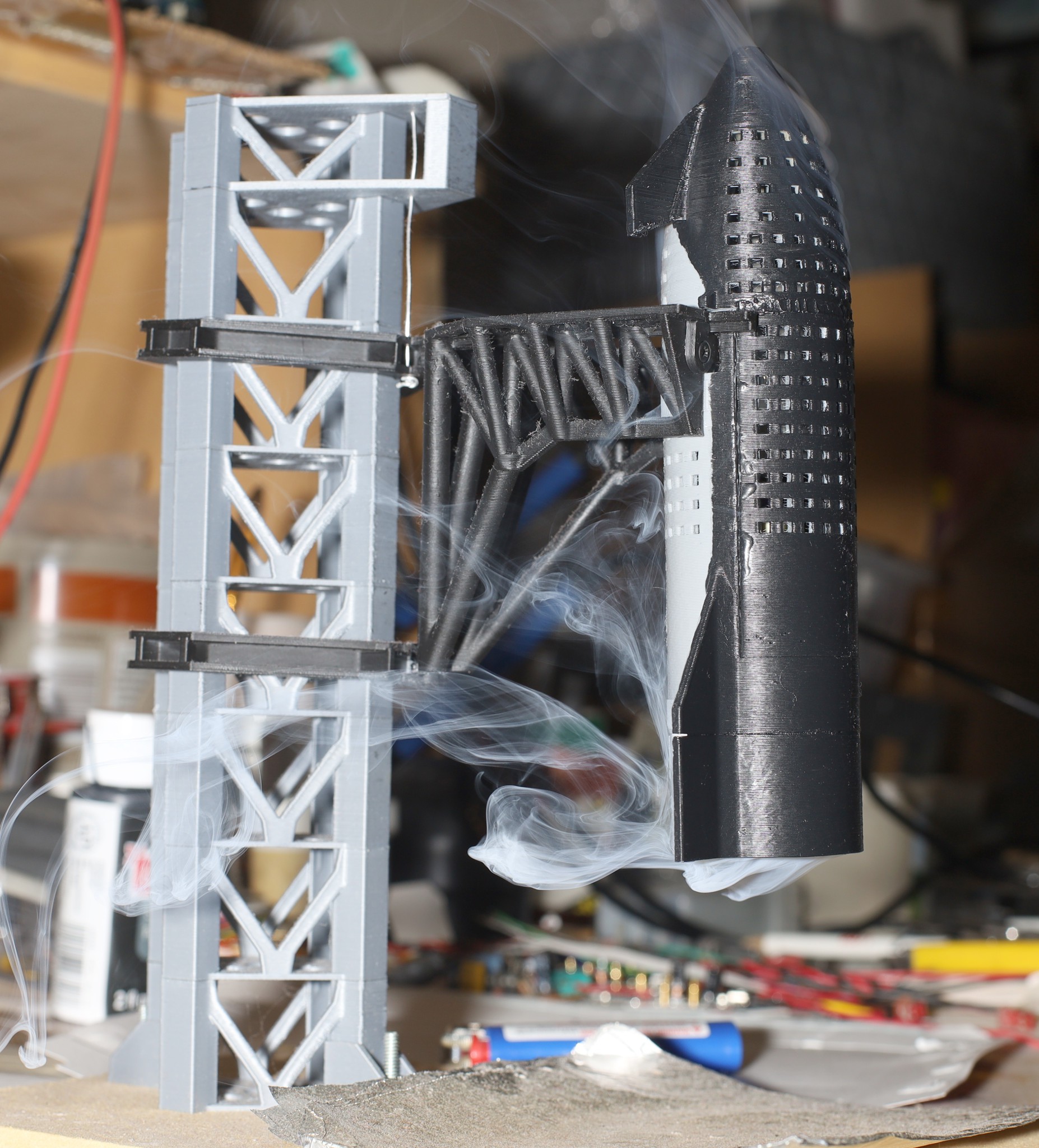

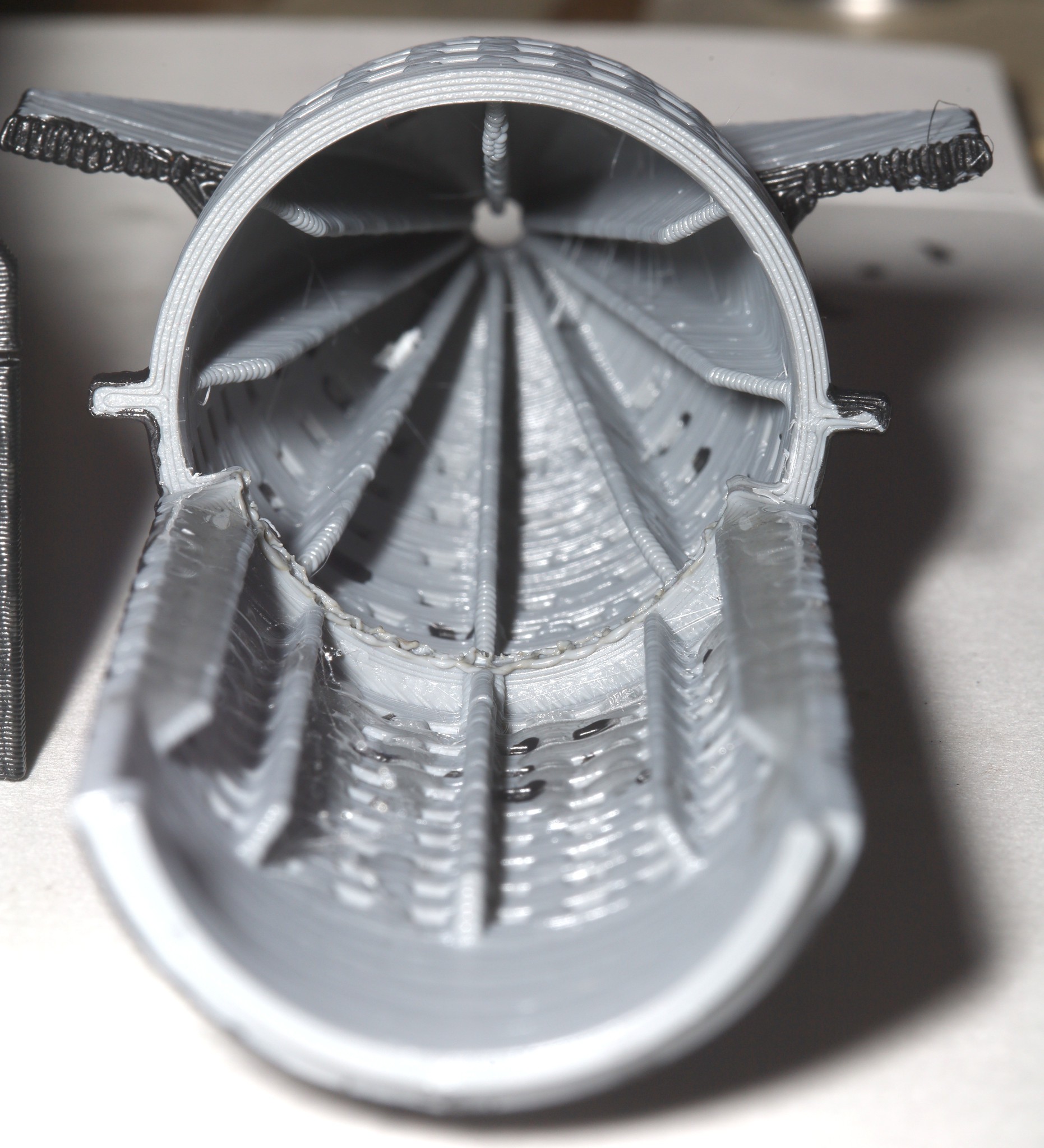

A 1st go at a fully enclosed design was a failure.
The hot section with a PETG base successfully backflowed, despite having a lot of holes.
It didn't backflow with a PLA nose cone. Any updraft still caused it all to go up before it ever went into the hot section.
The PLA nose cone also melted. This part would have to be made of PETG or widened quite a bit. A PETG version would be welded.
Repositioning the inlets made no difference.
The next idea was to make a big old cutout like the stick burner. At minimum, an HLS elevator port might reduce the updraft.
This might have gotten slightly more backflow going, but it still melted.

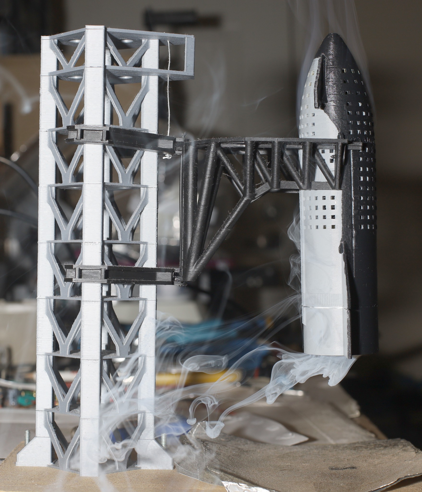

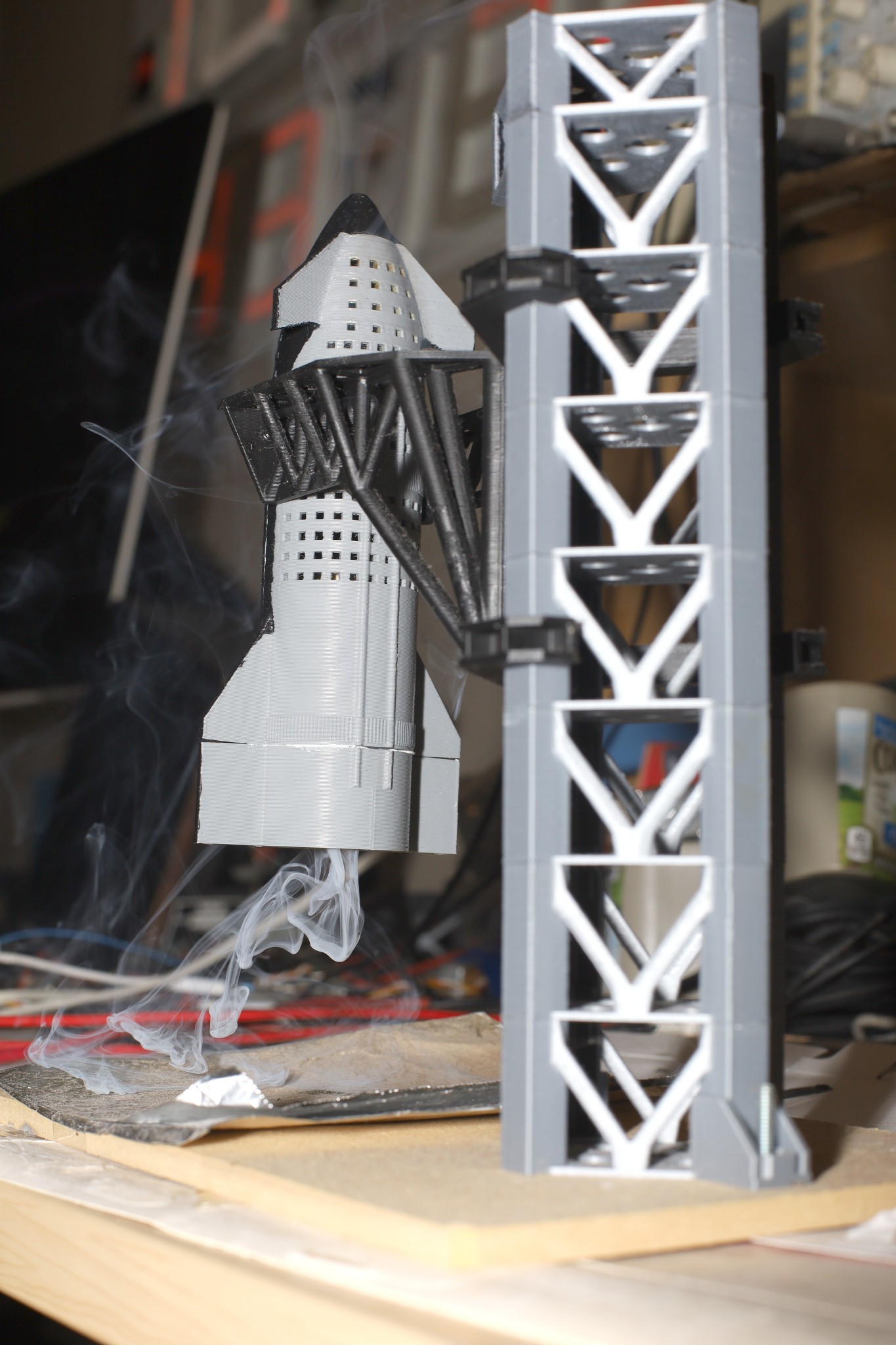

Then tried completely plugging all the air holes in the base with clay.
This got it to just start looking like a liftoff plume. 1 problem is the diameter of the rocket obstructing most of it, but past experiments showed it could form a much larger plume when it's working. Another problem is the backflow still getting defeated by the updraft. The ideal solution is to eliminate the updraft.
Fumes tend to pool inside the base but get taken up by the updraft when they hit the edge. Given the air tight base not being very easy to achieve & not solving the biggest problem, it was pretty obvious that the hot section should stand on its own & have a single piece rocket slip over it, with an enclosed PETG base just for alignment.
All that can be done for heat resistance is to make it bigger & out of PETG.

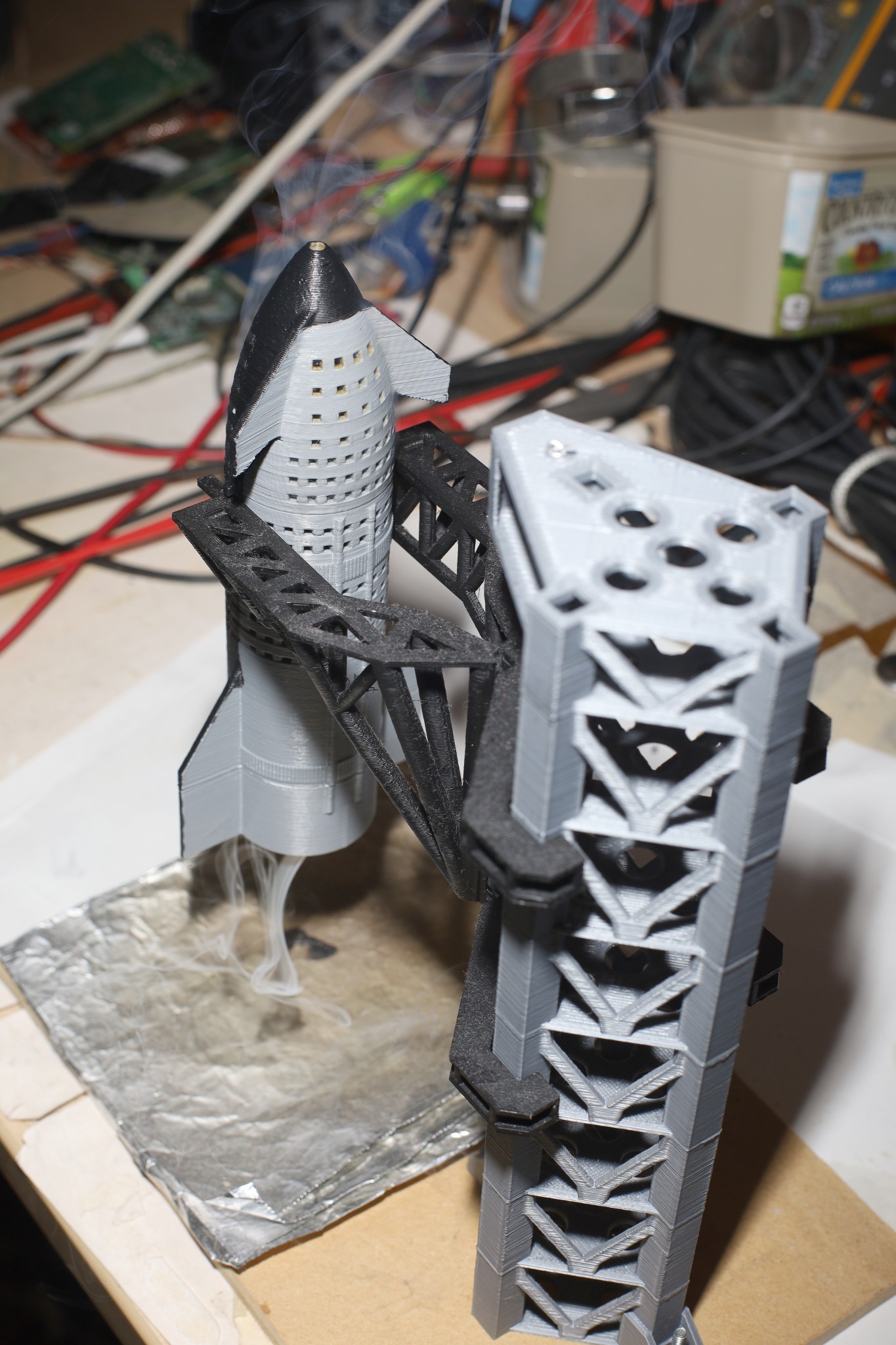

This one did the best of all of them. Depending on wind direction, but much less so, it managed the best spreading of smoke. There is always going to be a need to carefully level it & block wind. Longer cylinders might improve it. The mane problem is the metal gets super hot. It might have to be ceramic.
A longer, narrower exhaust pipe made it diffuse evenly in more wind, but it was still sensitive to leveling.
The 20mm diameter melted as expected, despite being made of PETG. Creating a ceramic hot plate is the great task.
A bigger diameter than 36mm could make it heat resistant.
This one was 3 stacked grids to try to spread the smoke out. A cone would then try to divert it into a cylinder.
It still converged on the downwind side, even during peak efflux. 1 big improvement was a lot more smoke going down instead of up, even when the ambient air was moving. The sealed stack of cylinders gave it a lot more downdraft.
Another problem is the smoke coming out of the outside diameter gets sucked towards the center. It probably needs an outer wall below the outlets to attract it to the outside.
Autopsy showed quite a bit of melting & burning on the top grid. It's probably falling oil. Having a longer gap might cool down the oil.
The cylinder's capability as a wind break showed promise. If it could shield enough wind to spread it into an even pool, it could reduce the problem to leveling. Leveling could be solved by the magnetic receptacle of the original starship incense burner. The mane problem with that is the chance of hot oil falling on a lion paw & the cone getting moved out of position. Another idea is a 3D printer style bed with a bubble to aid the process.
