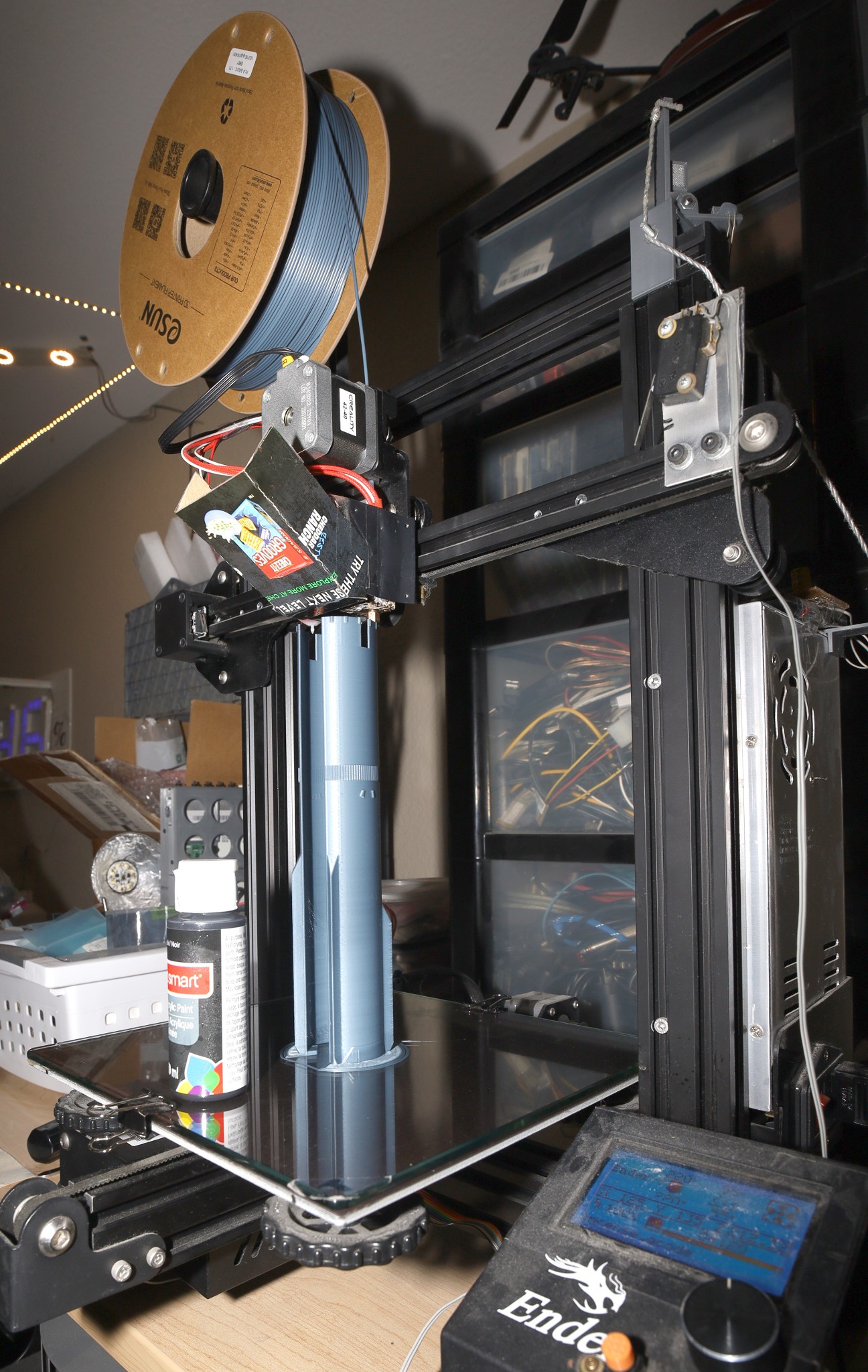

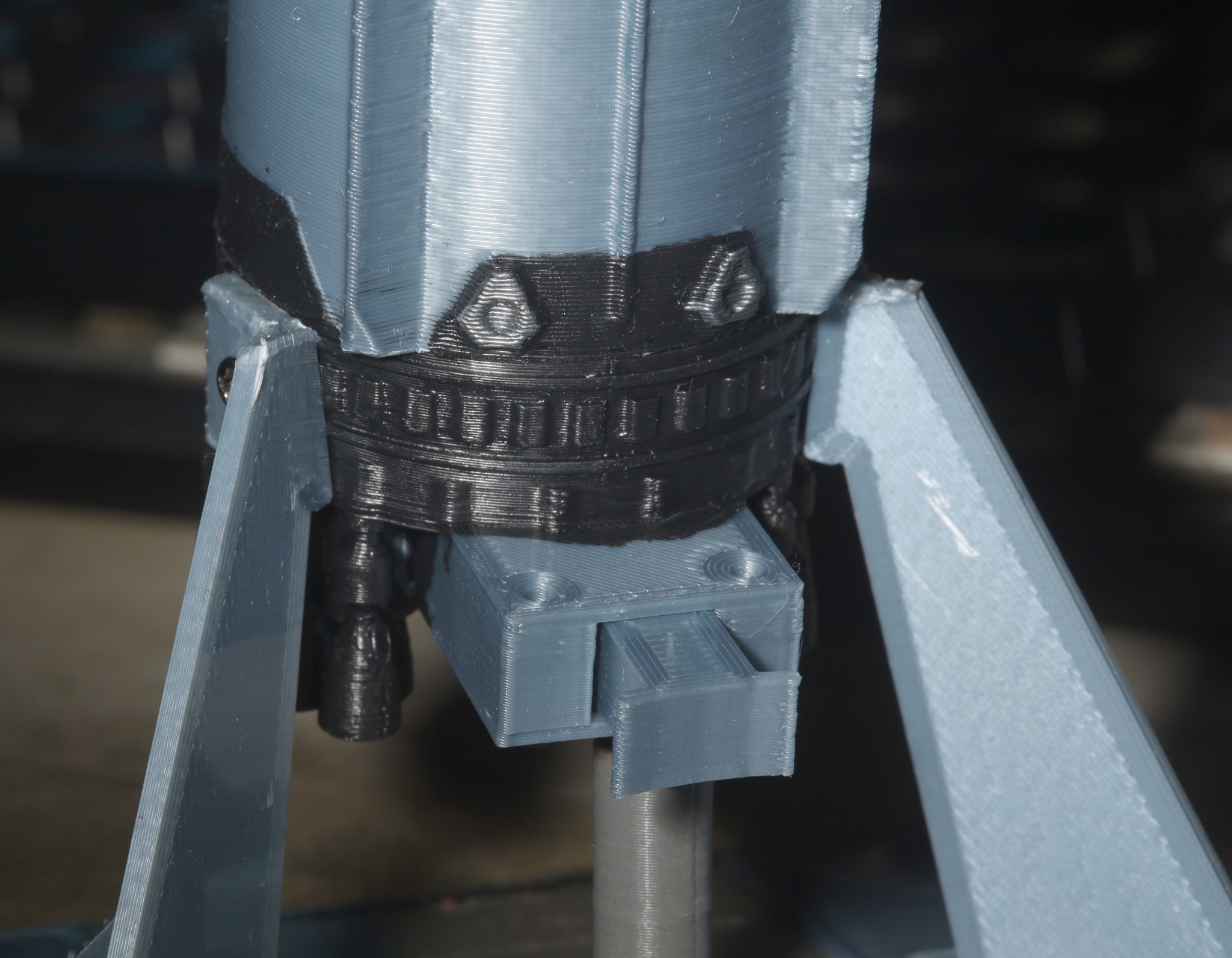

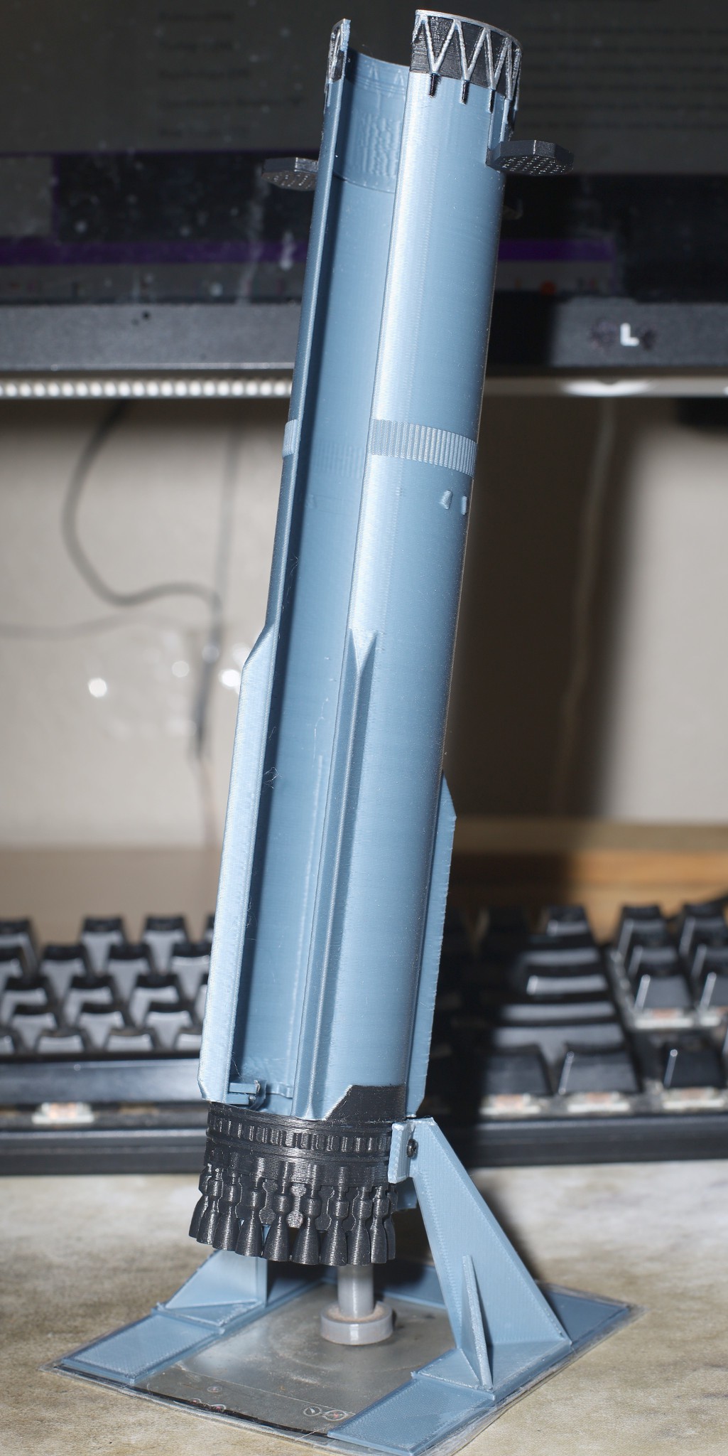

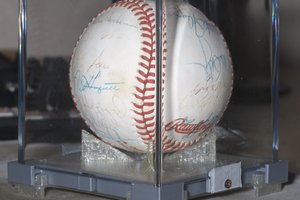

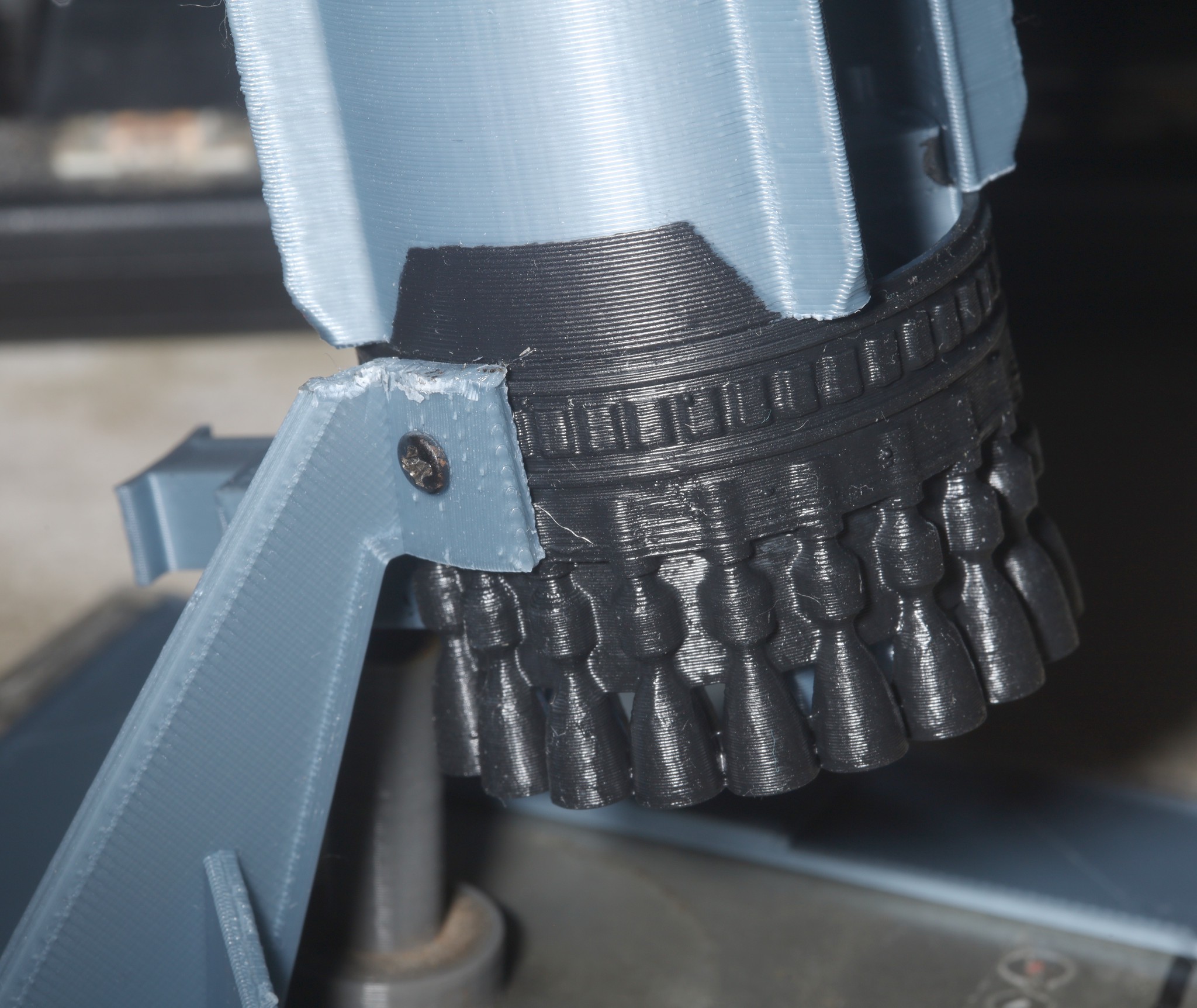

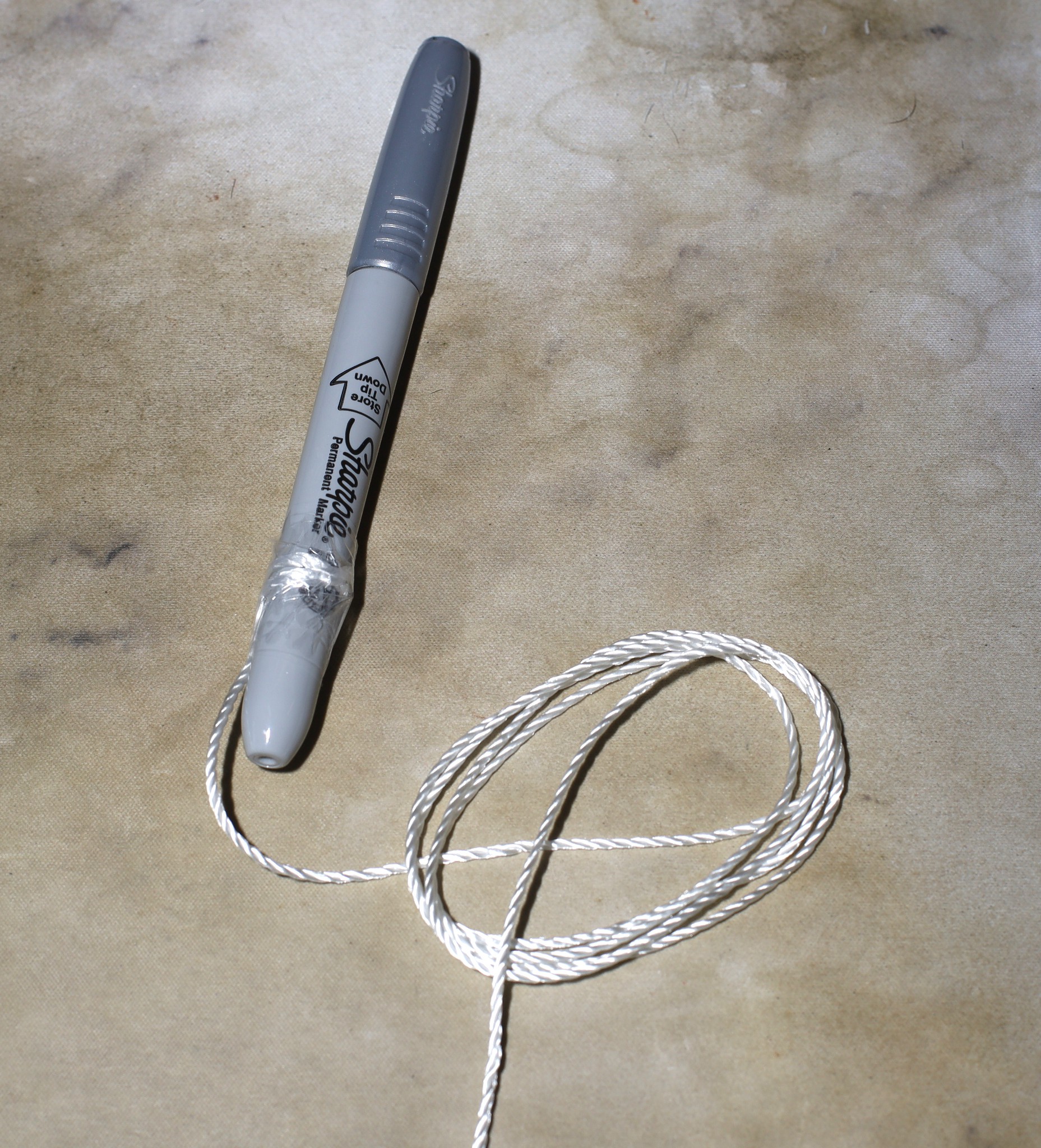

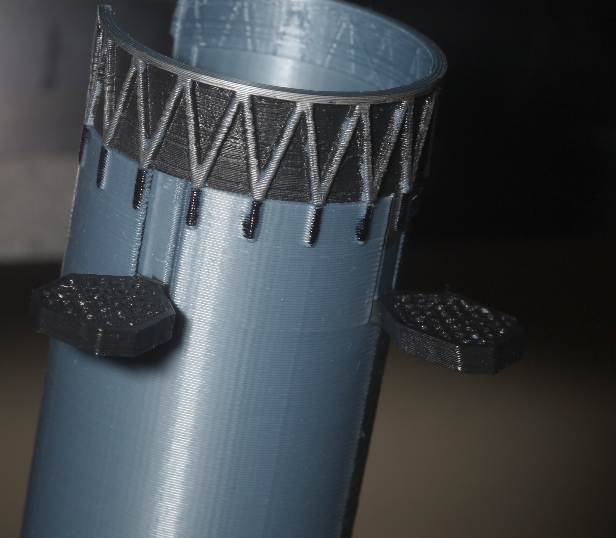

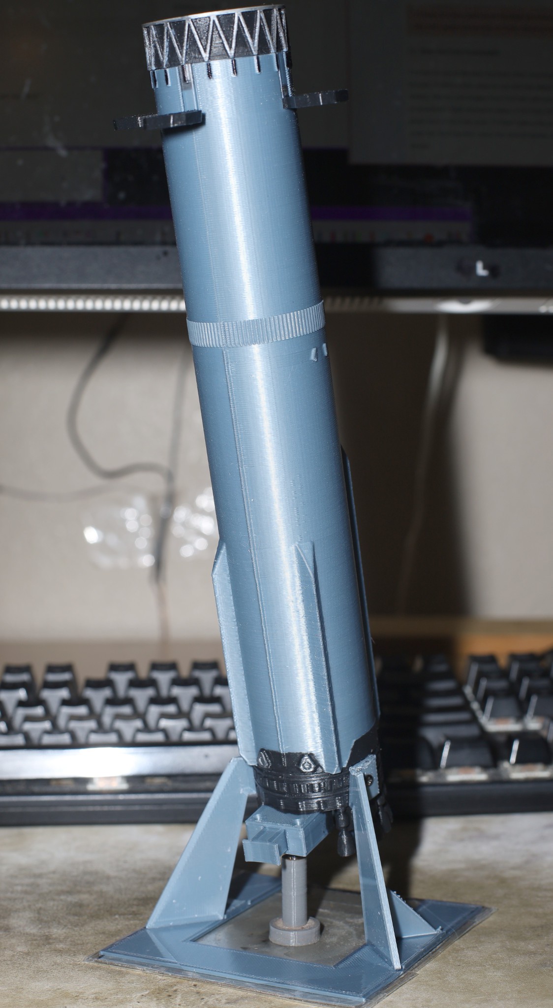

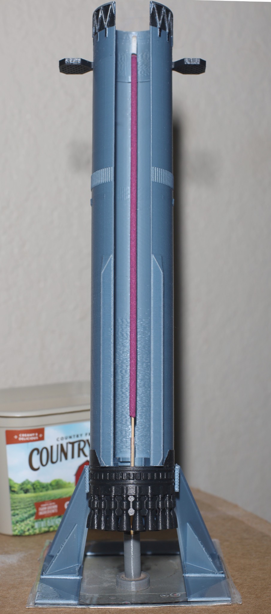

• V3 incense burner
    lion mclionhead5 hours ago 0 comments
    The opening was narrowed again to try to reduce the spills.  The big difference was paint.  The paint brushes weren't small enough so the tiniest details needed sharpie.  Ended up sharpieing silver on top of black.  Sharpies can't draw on top of paint.
    So discovered twirling it just once on a string could get it to overflow enough to write on paint, briefly.  The trick is not over twirling it or it'll explode.
    The last shipment of esun grey ended up blue.  The hazards of the cheapest filament.  Now the lion kingdom has a blue booster.
  • Problematic sticks
    lion mclionhead05/01/2025 at 00:00 0 comments
    For the 1st time in the 3 years since starship incense burning began, got a pack of dead sticks from the dollar store.  The solution for sticks which don't burn is to point them down but as usual for internet answers, it doesn't normally work.  It's also top heavy & requires a support.
    It seems everyone else is using alligator clips instead of the complicated metal base. That wouldn't require wrapping the stick in scotch but it would be harder to aim the stick. There could be an alligator clip assembly which goes above the booster & points the stick down.
    Problem sticks are so rare nowadays, it might be worth just a minimal stand.  An alligator clip takes less precious $1000 sq/ft space but it also is top heavy.
  • Block 2 booster static fire
    lion mclionhead04/24/2025 at 22:25 0 comments
    The 248mm booster was taller than the tallest practical print in the ender 3. It needs more like 220mm to be able to access the filament across the entire horizontal area. At 248mm, it can only print in the middle.
    After much trimming of material, it burned its 1st stick. The extra detail & odor in this one made it easier to bear not having a full stack.  It's definitely more productive.
    The launch mount definitely shows more of the business end than the doughnut did & is sturdy enough because of the right angle pylon alignment.  The pitch angle is slightly off.  It's not assertive enough to get a precise pitch angle.
    Horizontal expansion in the thrust structure clamps & launch mount pylons is the trouble spot which needs most of the trimming.
    The breach loading mechanism needs to have only 1 registration pin.  Having 2 makes it impossible to load.
    The registration pin in the last one was almost completely worn down after 3 years.  The new one has so much interference from glue residue & .32mm layers, it might not be necessary.
  • Block 2 dreams
    lion mclionhead04/17/2025 at 07:21 0 comments
    The last starship print from late 2022 was in a pretty sad state.  Much was cut off while experimenting to improve airflow.  No attempt to deflect the smoke out of the ship worked.  The essential oil just got trapped in the nose & stuck to whatever it encountered, PLA or smooth packing tape.  It didn't go through a hole on top.  A flat internal panel would make it top heavy.
    Started converging on having just the booster & enlarging it to cover the incense.  The ship would be well above the booster, just decorative, & completely open on 1 side.  Given the size of the incense stick & the room needed to diffuse the smoke below the ship, it would have to be a pretty big full stack.  It was really heading towards just the booster.
    There were no good ideas for printing a hot staging ring.  It would have to be filled in.  If an inner support was offset to create the illusion of gaps, it might be top heavy.  This would trap smoke.  A long shot would be printing it as a panel & bending it around a tool with heat.  It's still waiting for block 2 & the new launch mount.
    Hard to believe they've been using the same booster design since mid 2022 now, 3 years on.  It's made lions ponder continuing to modify the block 1 incense burner.  They bit off too much by making block 2 require raptor 3 so now they're facing a long gap between the last block 1 & the 1st block 2 booster.
    The launch mount has a problem of obstructing the engines.  A radical idea would be to scrap the launch mount.  Tilt the full stack over 45deg to liberate more smoke.  Support it in the middle.  Keep the detachable engine section for cleaning & accessing the incense.  There still has to be a metal piece below the engine section to position the incense.  It could be supported separately.  The base would become quite large.
    A practical compromise would be to keep the current tilt while getting rid of the launch mount.  Support the booster in the middle & keep the existing metal plate.
    As long as a metal plate is needed below the engines, nothing is as convenient as having the launch mount.  It's just the easiest way to dump the incense from the booster.  The launch mount could be replaced with minimal supports to see the engines.  The plunger for changing incense should go in the back to reveal more engines.
    The metal plate could be replaced by a magnetically attached V plate inside the booster.  That could reposition the incense.  Then it wouldn't need any stuff under the engine section.
    During the booster redesign, it became clear that the engines couldn't line the front because the back had a necessary attachment point.  The farsteners would be obstructed.  They would have to point up from the bottom instead of down from the top.
    There were doubts about gaps between the engines being possible.  Gap areas like the engines & the hot staging ring all need a supporting panel.
    Eventually arrived at something that would print over 24 hours. There were a lot of block 1 features mixed with what little knowledge of block 2 came out before Elon lost interest & moved to politics.
  • Wishlist
    lion mclionhead10/02/2023 at 18:19 0 comments
    The reduced odor from this design has been a growing problem.  The nose cone tends to collect essential oil instead of letting is pass through the holes.  The latest theory is to make the ship part optional or leave it out entirely.  It would just be a booster.  Since the booster has expanded with a hot staging ring, it has enough detail to stand on its own.  It would have to be expanded to cover the entire incense height & require a new launch mount.
    Another option is creating the smallest possible hole in the nose cone to allow all the fumes out, then cover up more of the side.  The nose cone tends to create a pool of fumes.  It would look like 1 of many lunar lander prototypes.  This ended up still pooling fumes inside the nose.
    Another option is creating a ramp inside the nose to direct the fumes out instead of pooling.  This would make it top heavy.  It almost needs a ramp system of some kind to guide the fumes out.
    There's also angling the existing design 45 deg so the fumes just rise vertically.  This increases the risk of outside air blowing the ashes.
    A growing fascination with the starship lighter made lions ponder how such a thing could be incorporated in the incense burner.  Obviously no-one is going to tear down a $175 lighter. So much of the exterior is cut out for the controls & air intakes, it's easier to imagine gutting the entire side to stick in a $10 pen torch.
    The 2nd stage of a starship incense burner could be a lighter like this while the incense burned in the 1st stage. Maybe you could stack it while the incense burned & destack for lighting. It would need the right air passage to direct the odor out, otherwise it would have to be destacked for burning.
    Once the butane ran out, it would be very expensive to refill.  That's the mane problem.  Lions have used $1 lighters for 20 years.  Then, there's the problem of what the purpose is of wrapping a butane torch in a starship enclosure.  It wouldn't save any space because instead of a pile of lighters, there's a pile of butane refills.  Using a starship shaped thing for lighting a starship incense burner has a certain appeal, but the enclosure would have to be somehow essential for the function of the lighter rather than being a model with a lighter stuffed inside.  Maybe another starship model could be a storage container for a bunch of $1 lighters.
    There are butane refills of a certain size locally
    https://www.walmart.com/ip/Ronson-78-gram-Butane-Fuel/31954646
  • The vijeo
    lion mclionhead06/07/2023 at 06:22 0 comments
    Finally got around to documenting how to use a starship incense burner.
  • Starship meltdowns
    lion mclionhead01/07/2023 at 22:26 0 comments
    Another curved incense stick showing the best way to orient them.
    Another thrust structure is printed after another meltdown.   A rare stick burns all the way down & melts it.  Some brands always burn to the bottom.  It's 1 peril of PLA incense burners.  It has to be disassembled & reshaped with the soldering iron.
    The leading idea is wrapping the stick in some kind of tape to try to stop the flame before it reaches the bottom.
    Scotch does indeed stop the flame, but it's yet another step in addition to cleaning after every stick.
     The latest thrust structure has more aligning fiducials which aid in aligning the tabs, but still requires the mark 1 eyeball for perfecting the angles.
    There is a desire to get rid of all the farsteners.  The plunger has to be removable though.
    The final frontier might be Mars, but the final frontier of incense is the backflow starship incense burner.  The concept is backflow incense & LED light creating the illusion of an exhaust flame.  3 problems emerge.  There's obviously the heat of the cone.  It would need a heat shield, maybe a metal plate.  The smoke comes out as a narrow stream.
    The typical incense holder has most of its structure devoted to spreading the narrow stream into a waterfall.  They pool it 1st, then the pool overflows in a wider stream.  In the case of a starship, the incense would burn in the 2nd stage.  The 1st stage would contain the diffuser, maybe diffusing it into exhaust streams.  It probably can't hit 33.
    Then, the ambient airflow is going to blow the smoke away so it needs a wind break.
  • Troubleshooting
    lion mclionhead10/07/2022 at 21:35 0 comments
    A completely encircled thrust structure is required to contain the ashes.  It might even force the ashes to the back.  There's a strange flow  of air currents.
    The curved incense sticks have to be put in sideways to catch the ashes.  Sticks which are too thin to stand up have to be doubled with a toothpick or wire.
    Light the incense by 1st fully assembling it, then using the manipulator to angle it outside.  Light it & use the manipulator to angle it inside before it drops ash everywhere.  Many a lion has accidentally left it outside after lighting it, leaving a pile of ashes outside the starship.
  • Better magnet free design
    lion mclionhead09/30/2022 at 21:29 0 comments
    This one has a notch allowing the rocket to lock by rotating.  It's the most convenient of all tab designs & doesn't accidentally release.
    The thrust structure was cut open to allow ash to be poured out without destacking.  It still doesn't all come out without destacking & it's not as visually accurate.  It still has to be destacked to change incense sticks.
    Periodically, ashes fell outside the thrust structure so that was a fail.  It needs to be a complete circle.
  • Magnet free design
    lion mclionhead09/26/2022 at 23:39 0 comments
    The leading idea is 3 tabs which rotate into slots.  The problem is progressive stretching of PLA, printing the tabs with supports & enough precision.  There could be horizontal tabs which screw into the existing magnet positions.  As the tabs wore out, they could be replaced.  It would eliminate the supports.  It's all a bit janky without metal.
    A few printouts had problems staying in place.  The tabs aren't big enough to flex into locking notches.   A spring would be required for a rotating mechanism to stay in place.
    It became clear over many prototypes that the booster can flex.  Instead of rotating, it could flex to insert the tabs into the slots.  It's just never going to be tight without springs or magnets.  There could be spring loaded ball bearings in front.
    The trick with the flexible booster concept is to 1st insert the rear tab while putting the front tabs on top.  Then insert the front tabs by bending them out.  Remove the front tabs 1st by bending them out & putting them on top.  Then press back to remove the rear tab.  How long it lasts is a matter of experimentation.  It may be that the tabs can be a lot less aggressive.  It takes 13 hours to print a new rocket with different tab sizes.  A temporary adhesive might get it down to 8 hours.  The chines don't line up as well as they did with magnets.
    The tab mechanism was a pain with a fully printed booster.  There's no way it would be practical with incense loaded.  The booster tabs can't be less aggressive because they stick to the bed.
    Less aggressive tabs can be printed in for the thrust section without reprinting the booster.  Another idea was making the bottom tabs rotate into position, but the screws would loosen.  The screws can be temporary, since the thrust section isn't hard to print.
    A new single piece engine section with temporary screws for gluing was finally designed.  It was surprisingly indistinguishable from the multi piece engine section.  The temporary screws leave holes which can be filled with hot snot.
    The ship was glued without the booster so the booster could be reprinted.  The booster might actually stay attached to the grid fins without glue or with hot snot.  It stays pretty attached with friction.
    A slightly modified tab section was printed to make it easier to get the booster on.  It may eventually be easier to leave the rocket permanently stacked if a bigger hole for the ashes is designed.
    The correct chines were designed.
