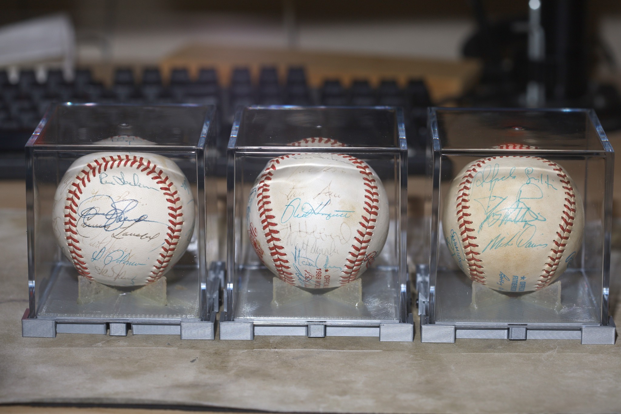

    lion mclionhead05/30/2026 at 06:45 0 comments
    Helas, lions overpaid for those enclosures.  They had 2 for $19. They have an AI assistant of course, which doesn't do jack any more than chat bots 20 years ago.

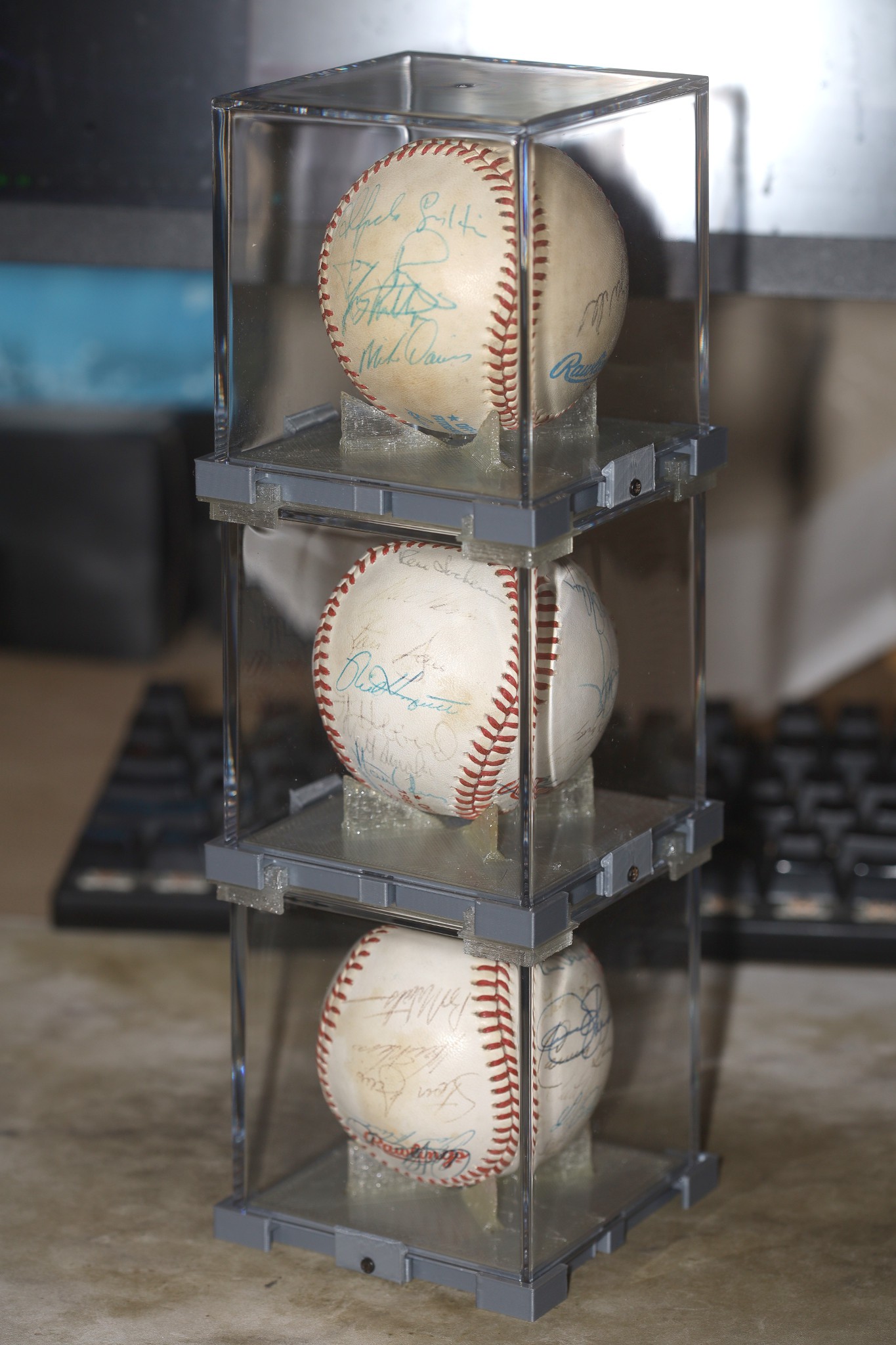

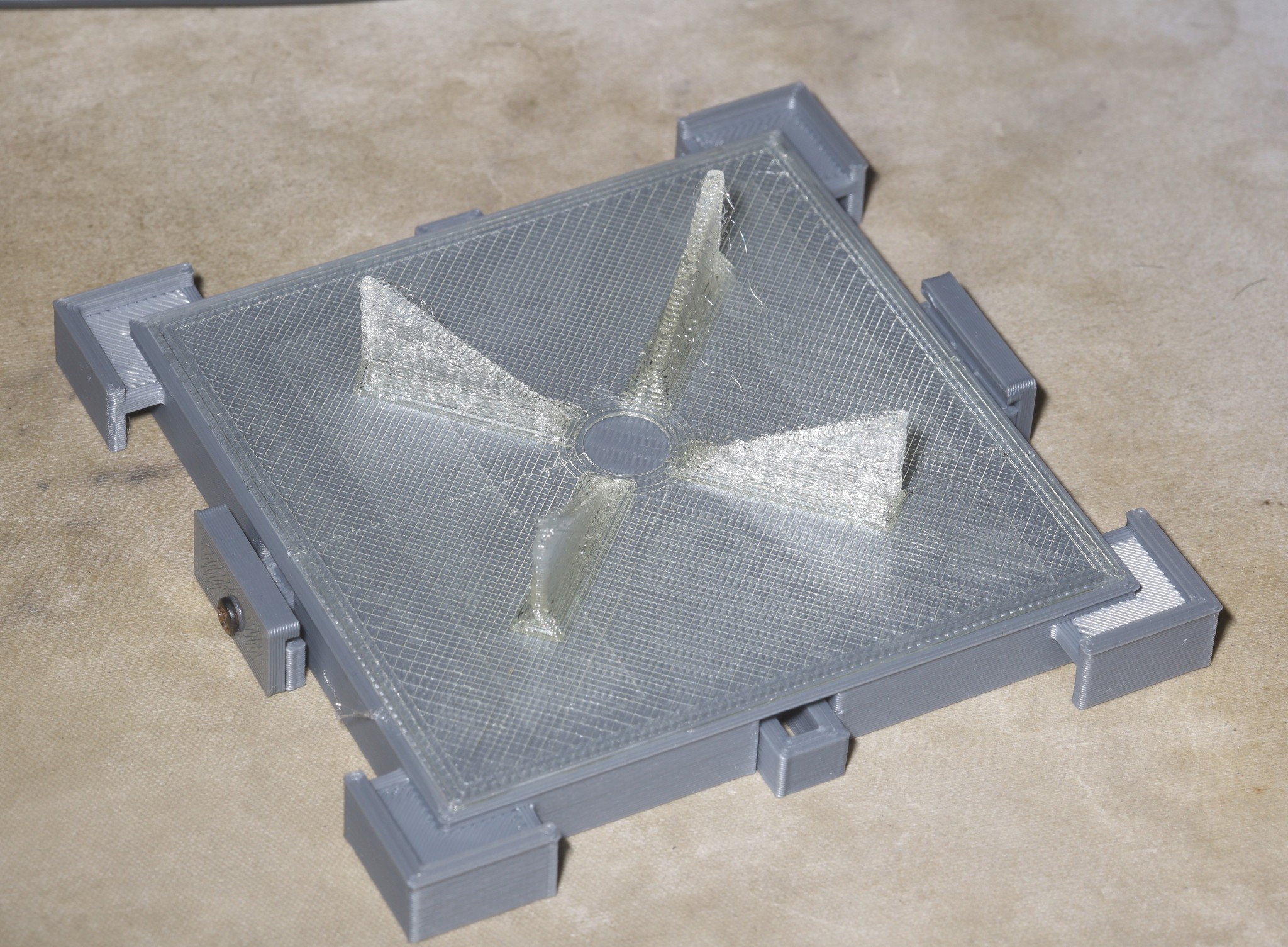

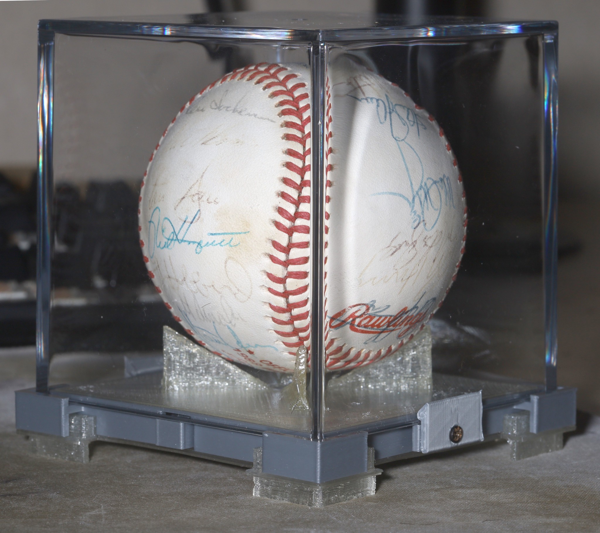

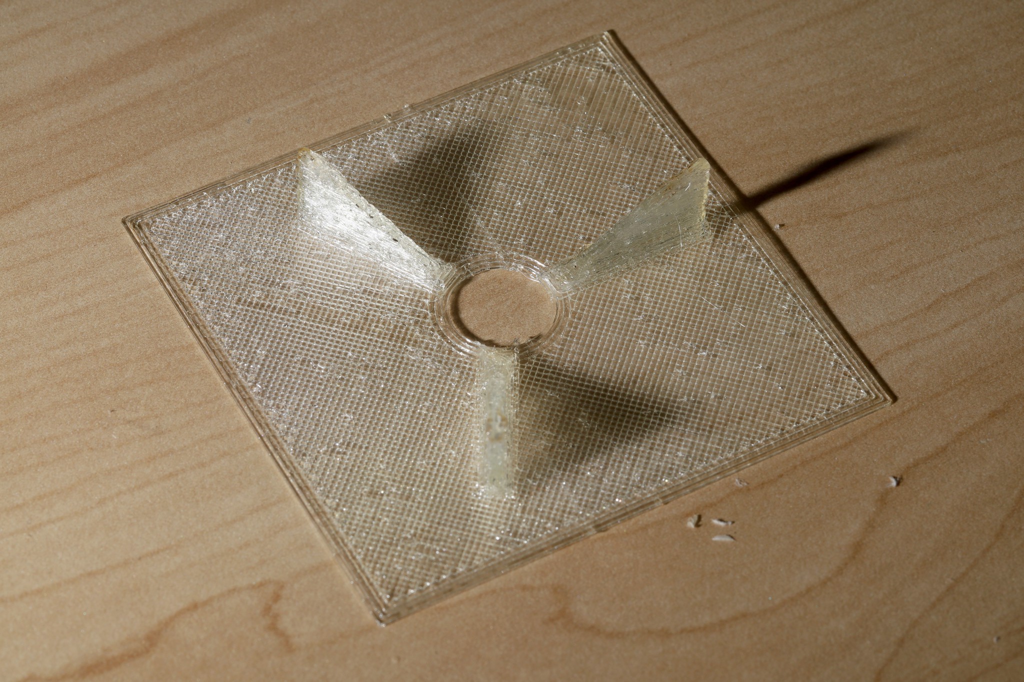

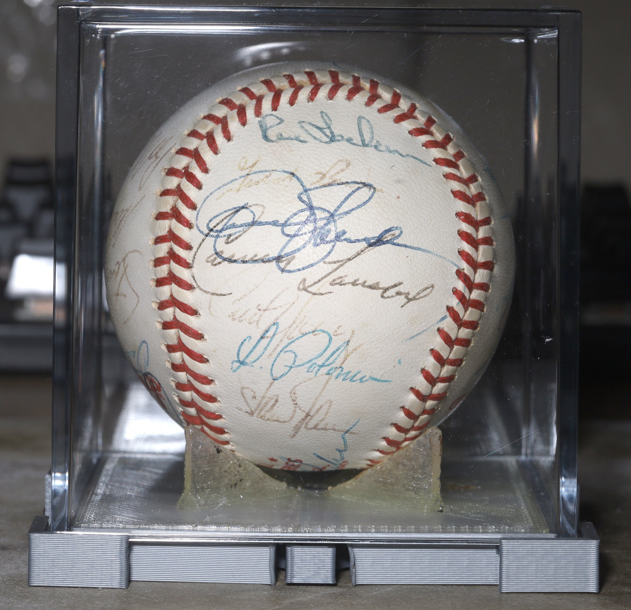

    The limitations of 3D printing make stacking them difficult.  Avoiding scratches would take a TPU panel that poked up on 1 side & down on the other side.  Perhaps 2 panels could be double side taped together.  Double side tape holds glass printed panels quite well.  The panel just has to be 4 layers thick instead of 2 & rather ugly.
    This worked quite well.  They stood up on their own.  The upward facing panel could have been PLA, but TPU allowed it to passively stay in place without adhesive.
    The 4 sided crosses became more annoying, as the ball would not easily contact all 4 sides but would flop between 2.  There's basically a compromise between large scale flopping & small scale flopping when the ball is not a perfect sphere.

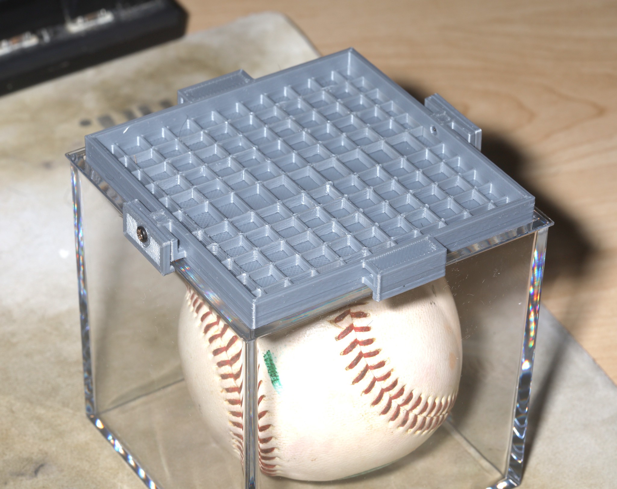

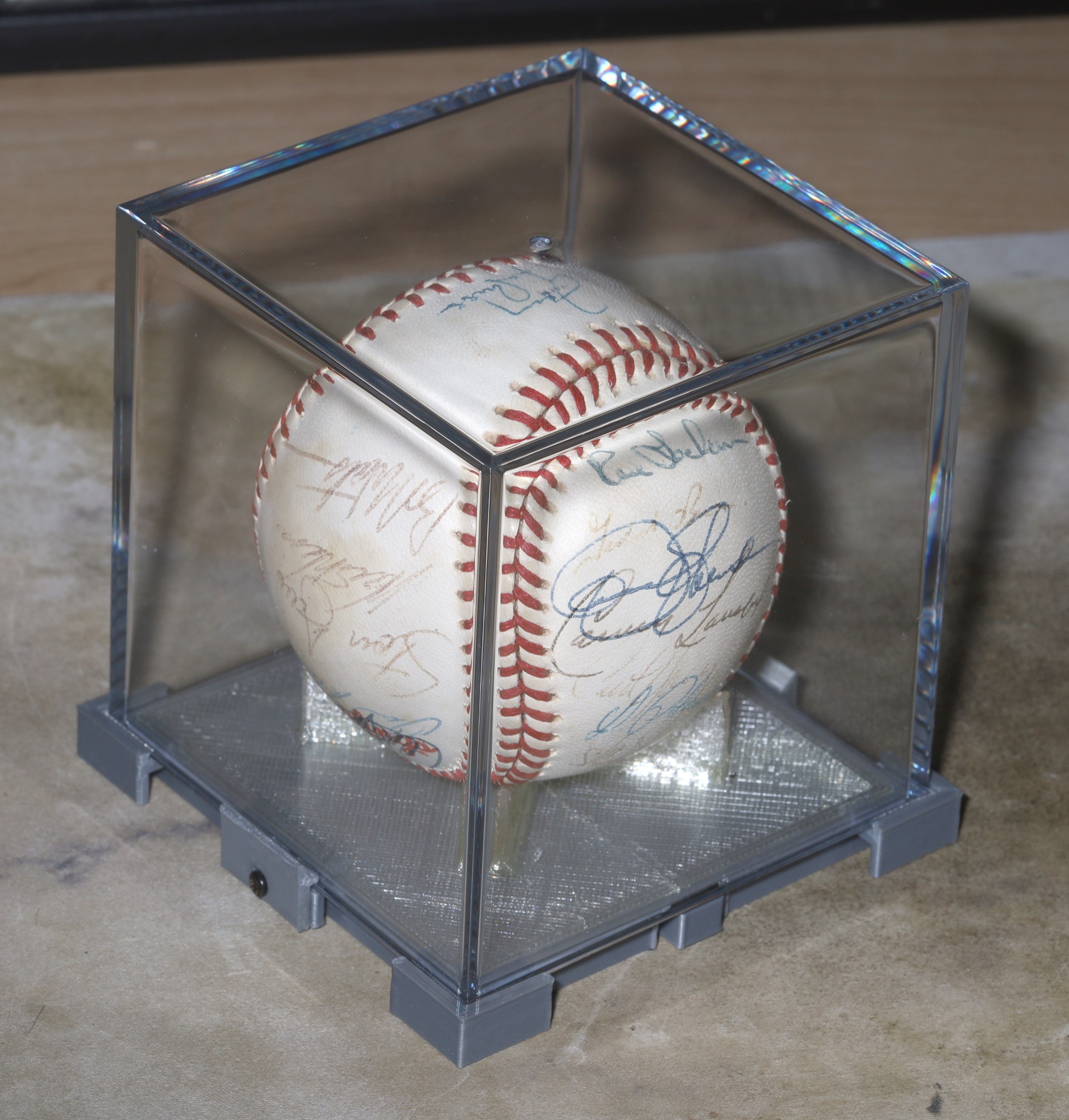

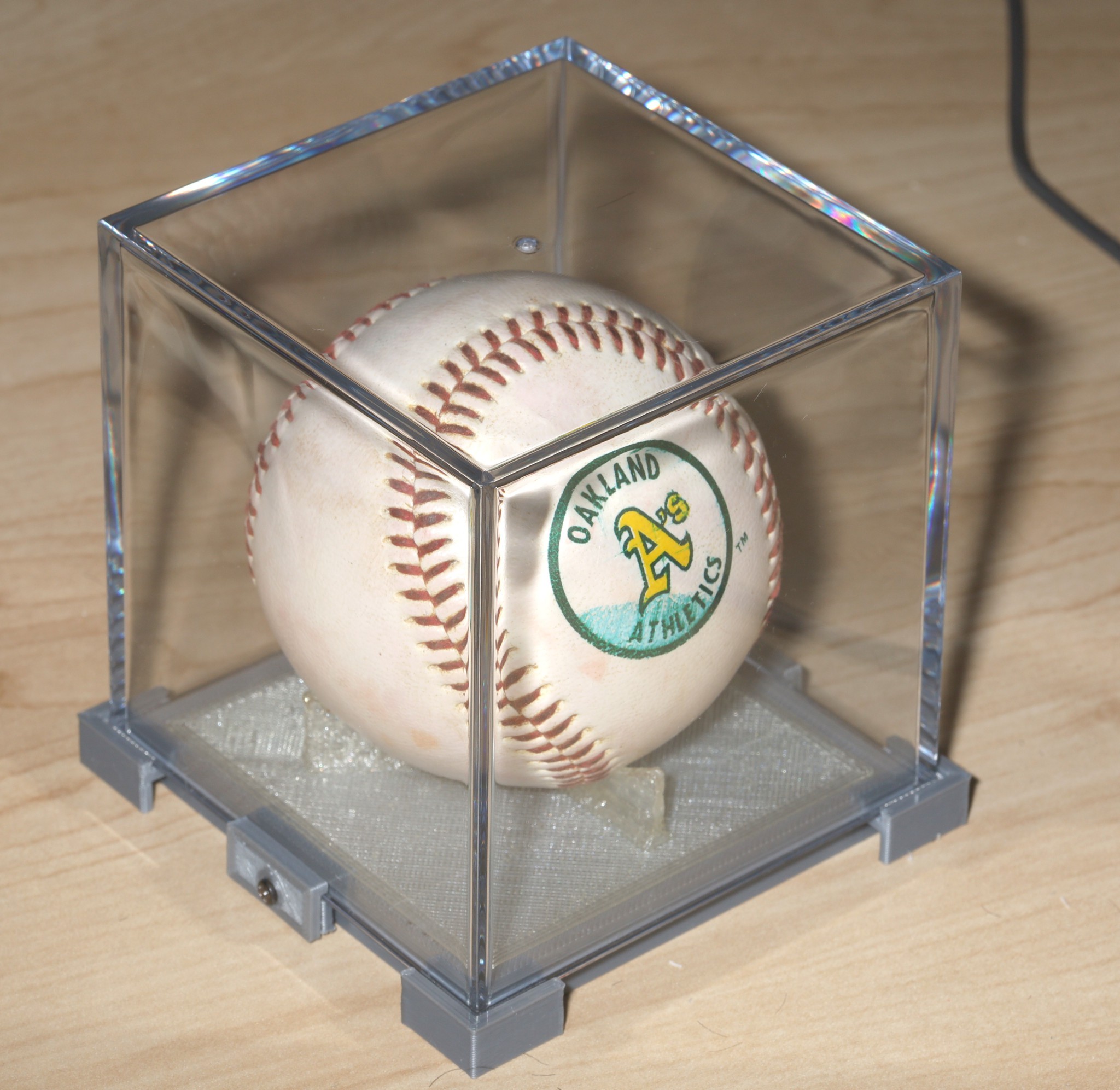

    lion mclionhead05/27/2026 at 18:13 0 comments

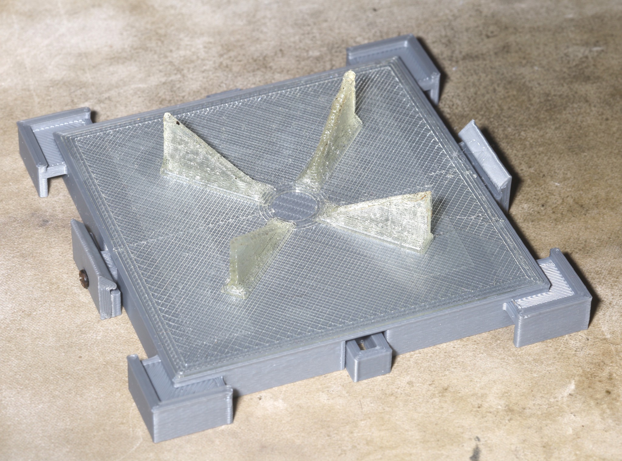

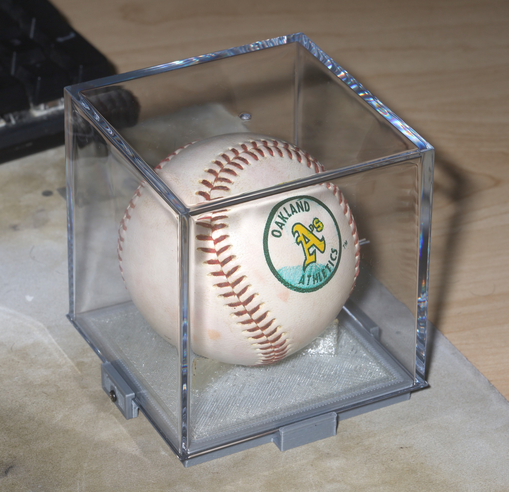

    Enclosure #2 as delivered had the right size transparent section but the wrong base.  The base was supposed to clip on, but the tolerances left a lot to be desired.  The clip mechanism didn't work.  Lions must have been the only animals to ever order this case.
    The decision was made to try to make a custom base.

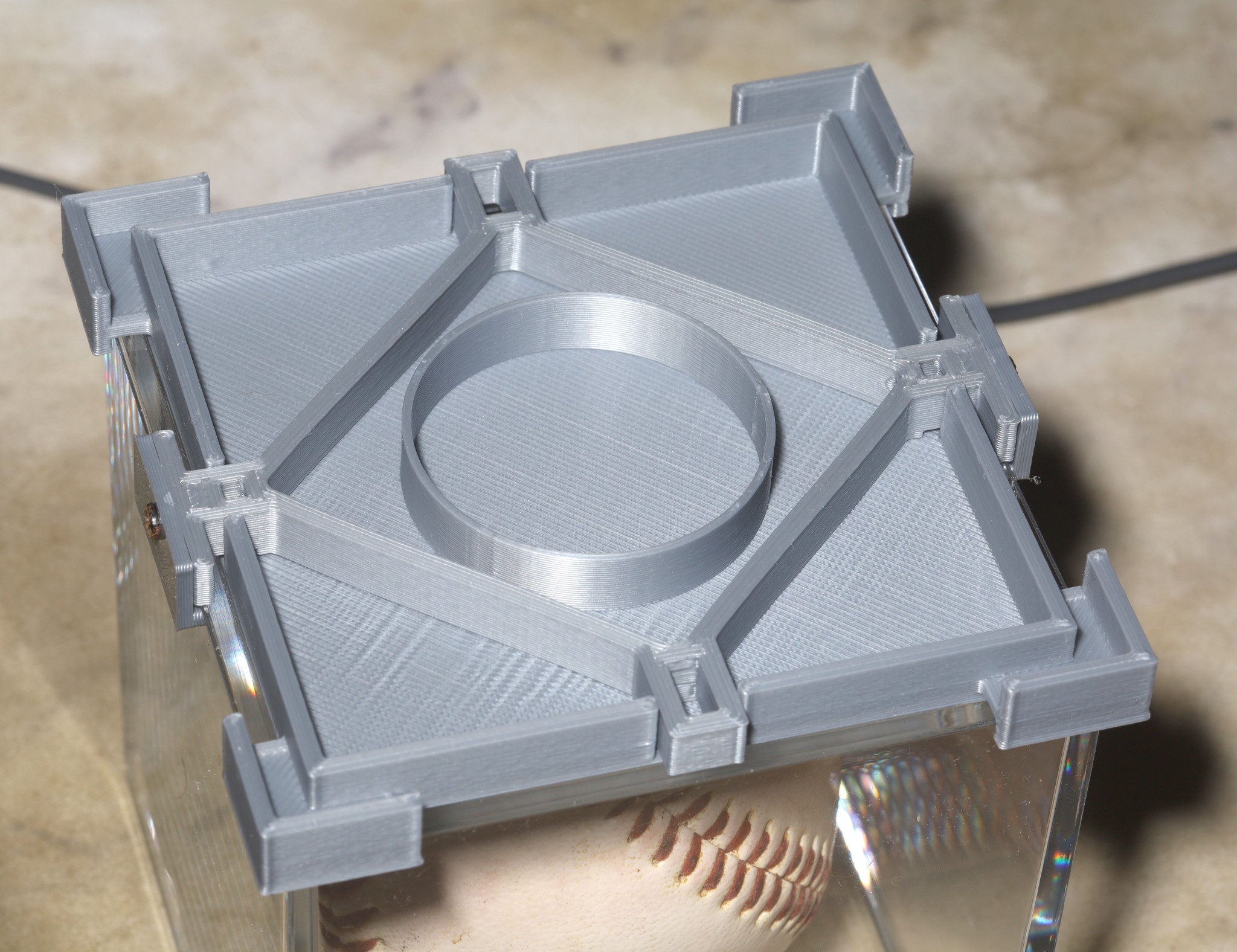

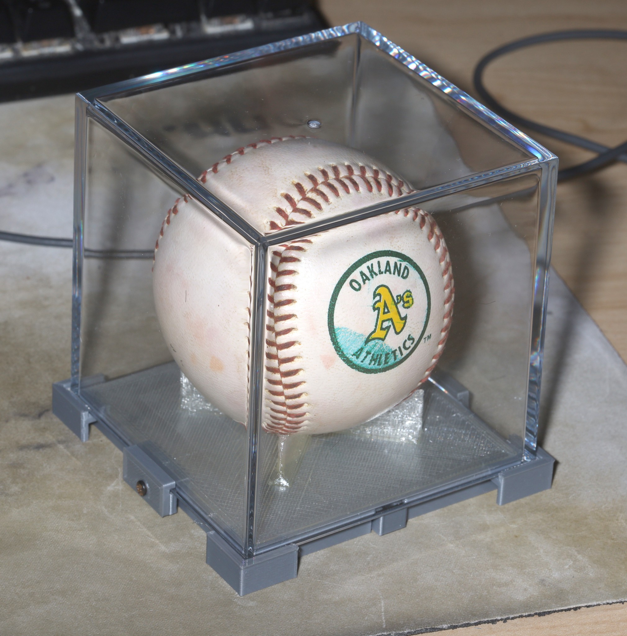

    Better, but having to screw on the clips was a pain & the support should really be in the corners.

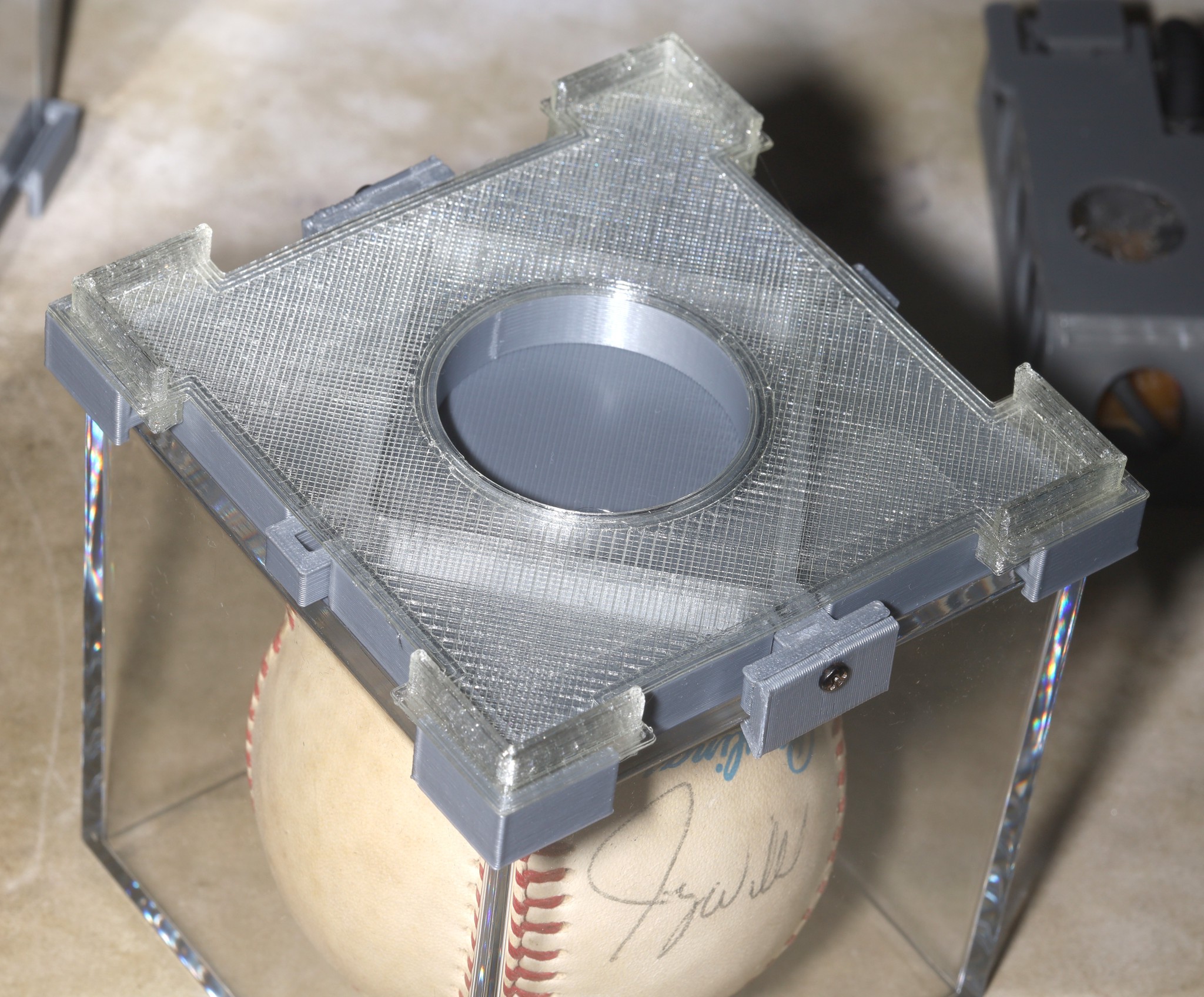

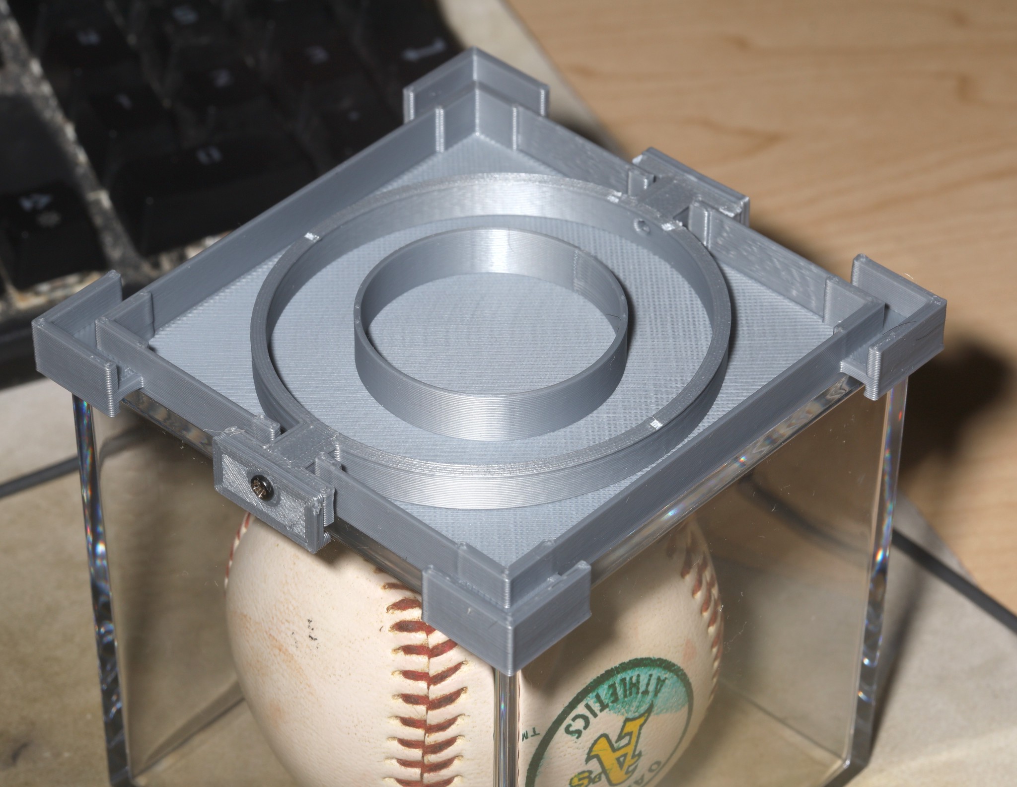

    A PLA spring was more promising but of questionable durability.  It took a lot of PLA & a lot of deformation to make it stiff enough.  It's hard to install it without moving the ball.  It needs to be possible to shove the enclosure down without having to fiddle with the spring.
    Another iteration added pushbuttons to release the clamps.  A new TPU stand went back to a 4 sided support.  It seemed to more securely hold the ball on a large scale while also letting it flop around on a small scale.
    Still kind of fiddly to assemble everything.  The buttons require a lot of constant force while pressing up to keep everything together.  It's still a juggling act to put it together without moving the ball.   It desperately needed pointed clamps which could be engaged just by pressing down on them.
    Given unlimited money & time, it would have a bottom panel to keep the mechanism together.  They're also not stackable.  It would be a matter of extending the corners down & providing some layer of scratch protection.

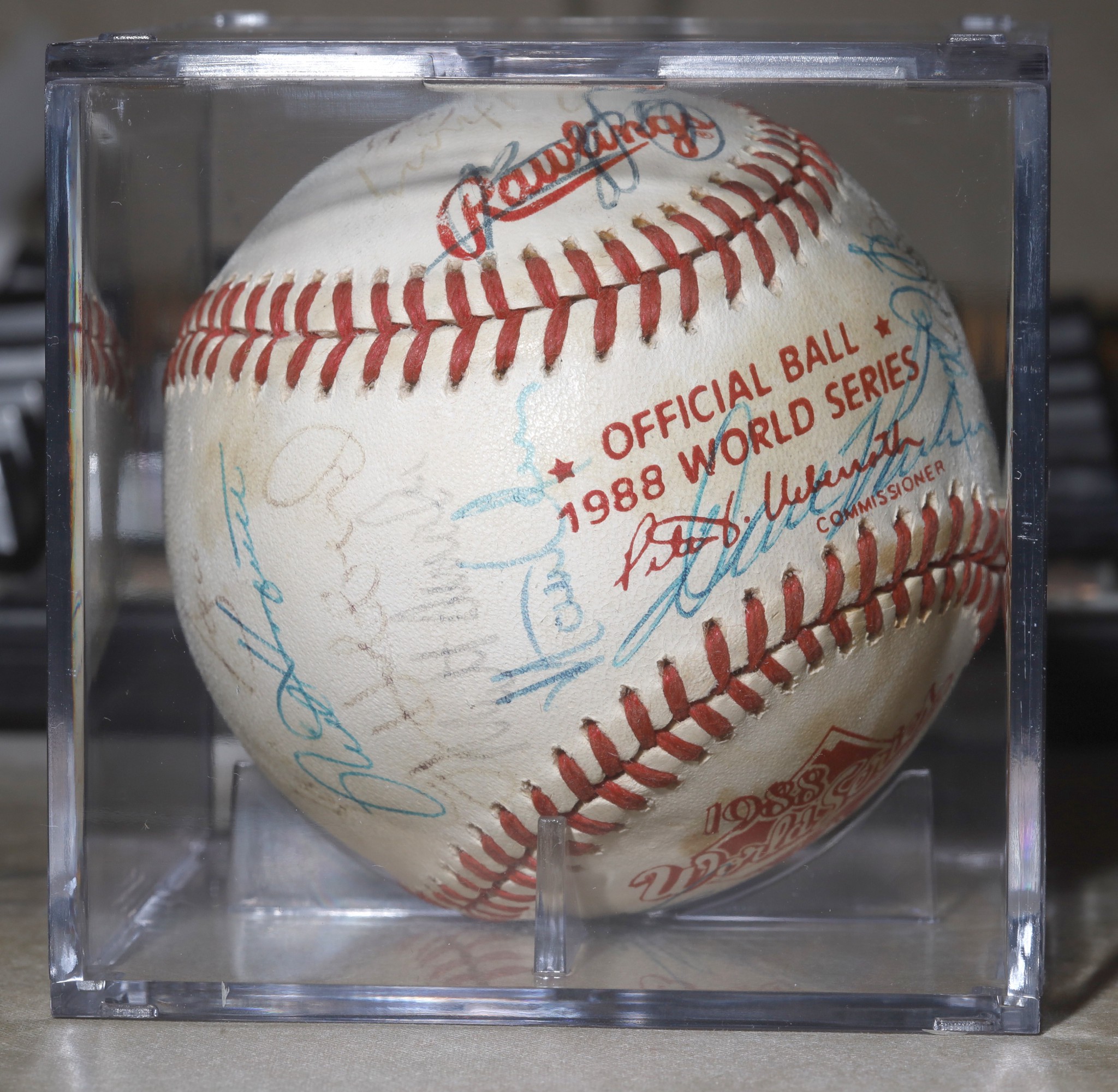

     Baseball preservation wasn't going so well.  The cheapest $4 containers let it flop around & had it contacting 2 sides even when upright.  The dimensions came in at 3.25" on the outside with 1/8" thick sides.
     There's no way a container this size would isolate it from the sides.  A cross with straight lines would keep it more stable than the existing cross.  A 3 sided cross would have fewer contact points.  A cylinder would not be more stable without costing more visiblity.  The feet are on top, so it scratches when upright.
    The mane advantage with this container was the view of all 6 sides, but it's not clear enough to photograph through the plastic.  No dimensions for any alternative containers are given.

    Any cross support lions printed would have to be TPU to be less abrasive. The TPU would have to be on a panel of sorts, farstened with double sided tape.

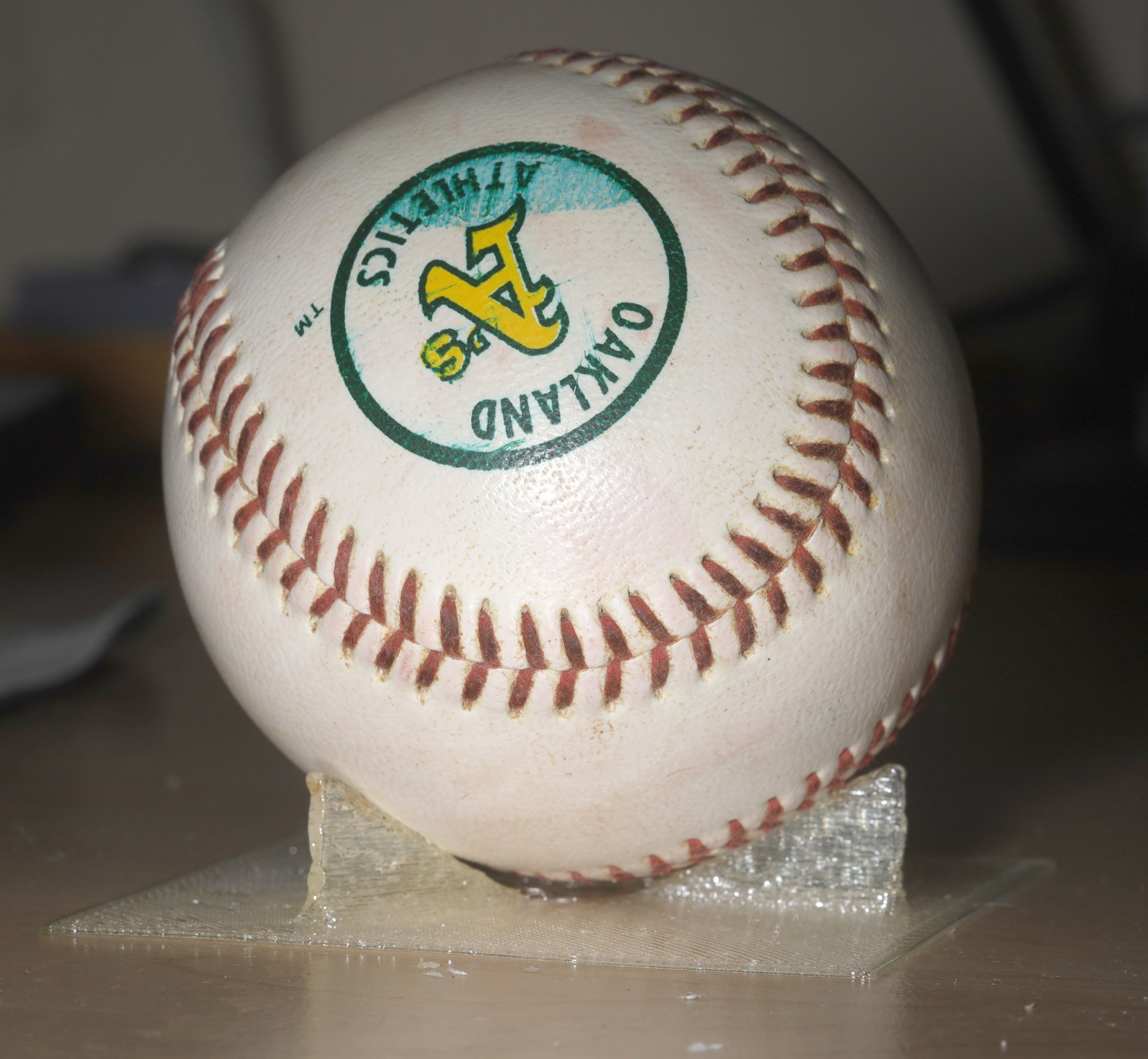

     Much experimentation & modeling arrived at a 3 side cross with straight lines being the ultimate stand but it had to be 1mm too tall to keep the ball stationary.  No matter what, it would no longer fit in the 3.25" containers.  The ball is not a perfect sphere so it's impossible for all sides of a cross to contact it.  The amount of variability requires a lot of margin.
    The enclosure needs to have a 4" outer dimension for it to clear all the sides.  The TPU cross when printed on glass actually grips the acrylic.
