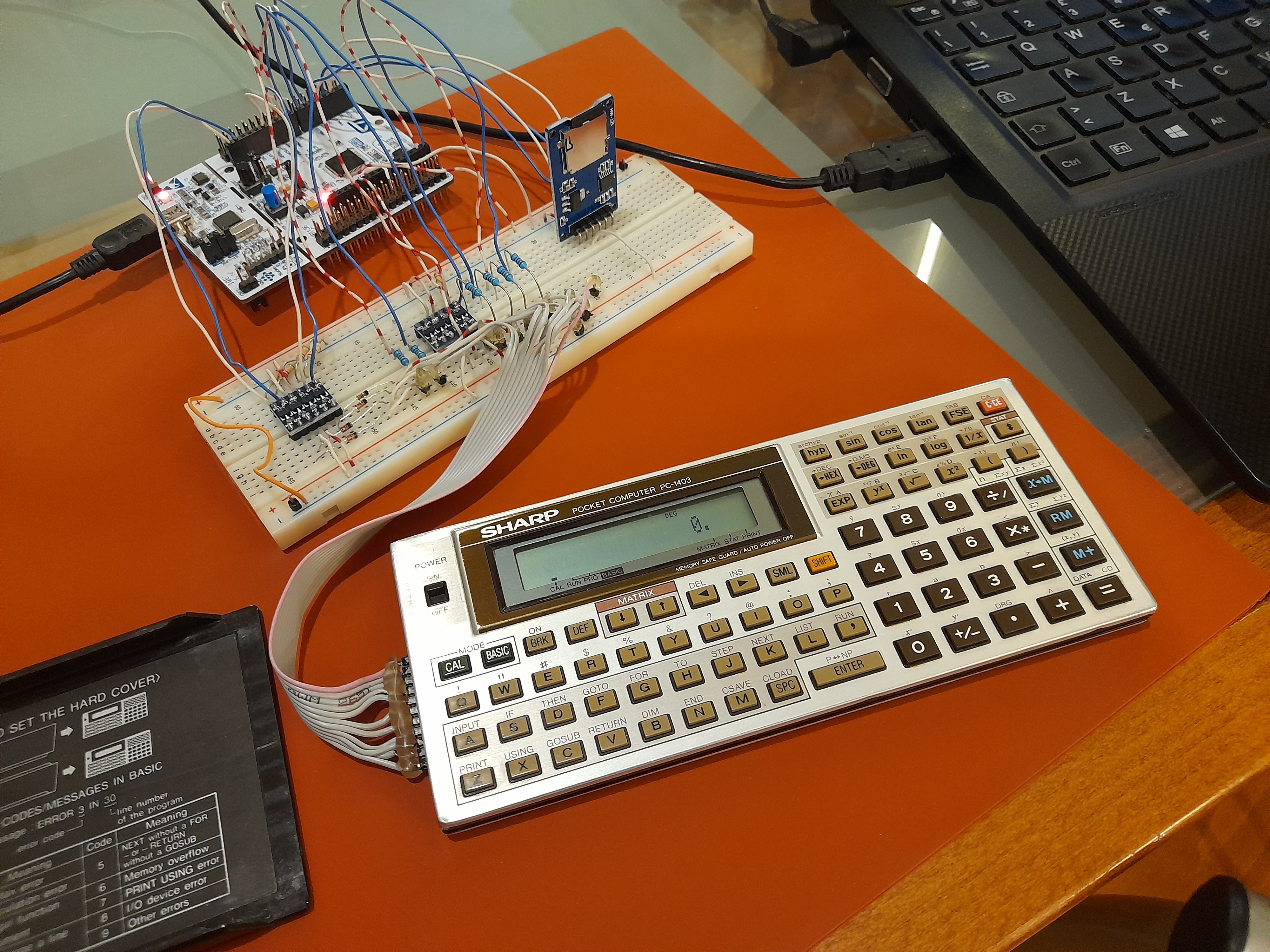

The initial idea was to build something self-contained, not relying on a PC, that could emulate at least the LOAD and SAVE commands, to store and retrieve programs on a standard SD card.
I developed the project starting from the early prototype below, based on a Nucleo STM32 L053R8 board, using the Mbed online tools to develop the firmware.
Here, the PC connection serves only two purposes: powering the device and serial-terminal debug logging. No functional service to the device.
Below is the very first demo I recorded, showing successful LOAD and SAVE operations. A milestone for me!

Interface schematics (find the complete KiCad progect on github - KiCad v1 project), is relatively simple:
What I struggled with most, even on the prototype, was the level conversion. I was unlucky to have only a Nucleo board at hand initially, and I stuck with it. Starting the project on an Arduino might have made the first steps easier.
The Sharp PC uses 5V CMOS logic, while the Nucleo board runs at 3.3V, so level shifting is needed. The Nucleo’s inputs are 5V-tolerant and can read the Sharp’s outputs directly, but its 3.3V outputs aren’t enough to drive the Sharp’s inputs. For that direction I used a SparkFun-style level converter (or rather, one of its clones).
Receiving the device code (0x41), the first step of the handshake, was the hardest part. With converters on every line, the board always read 0xFF, probably because of the Sharp’s high-impedance outputs. The solution was to use separate pins for the return path, removing the converters from the Sharp-to-Nucleo direction, and to enable the internal 45K pull-down with a 10K series resistor as a voltage divider. During output, the input pins are set to high impedance (PullNone).
The two devices share only ground, to spare the Sharp’s PC coin cells. For now the Nucleo is USB-powered, with battery power planned in the long term.
