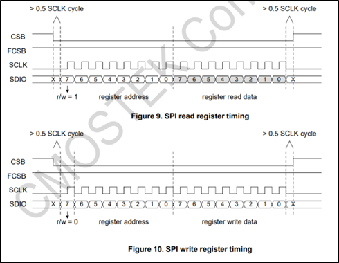

    The datasheet for this chip proudly touts SPI support, but looking beyond the front page of the datasheet reveals a custom communication protocol more similar to I2C (or at least I think so). This protocol requires 4 wires (+GND).
       > CSB: Chip selection for register access, active low
       > FCSB: Chip selection for FIFO access, active low
       > SCLK: Clock (+ve edge)
       > SDIO: Data input and output
    The timing diagram is shown below. For basic register access I will be ignoring FCSB.

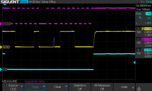

    In the scope capture, there’s a short spike between the RX and TX bytes. This is caused by the handoff between the pi pico and the CMT2300A. I have a weak pullup on the line, so data starts to rise to VCC before being pulled down by the slave.
    That’s all for now… transceiver is talking so I can do some register poking to put it through its paces.
