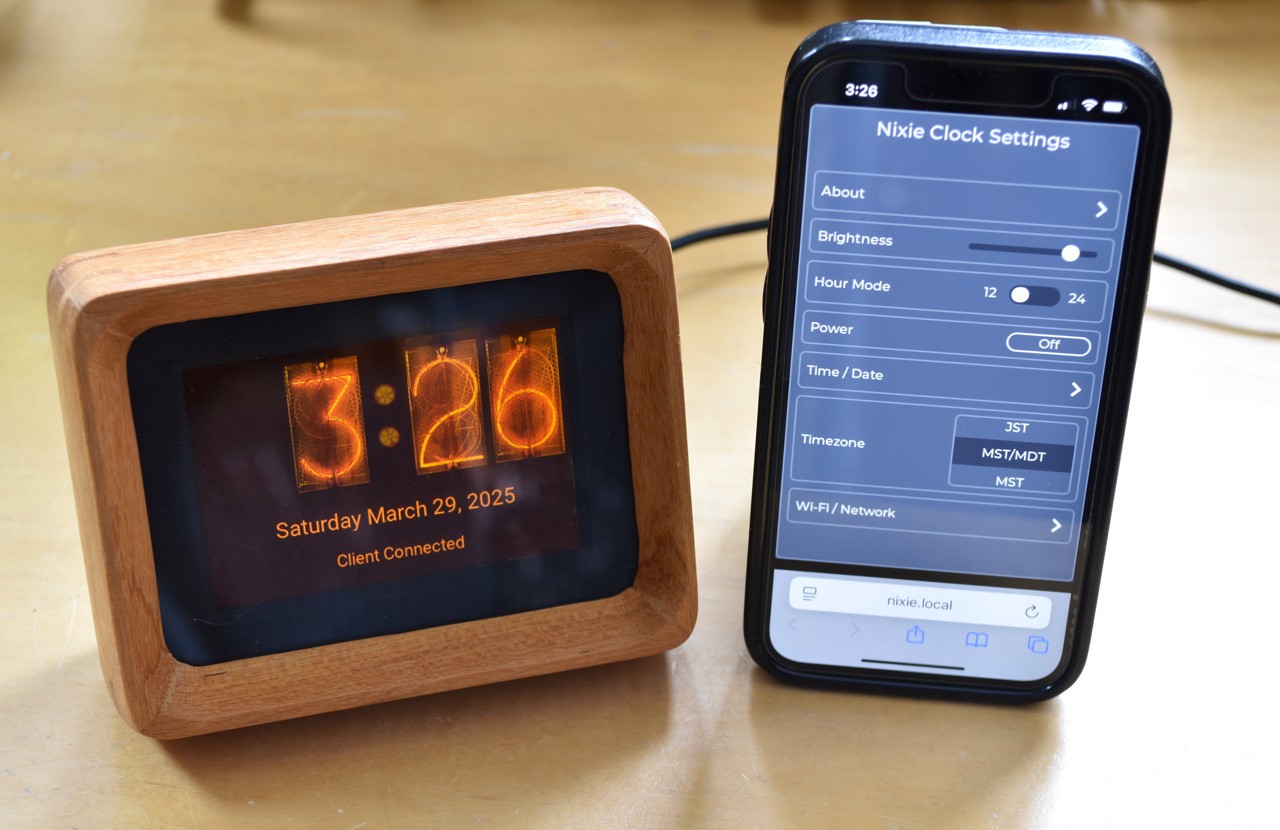

  • Faux Nixie Clock using gCore
    Dan Julio03/31/2025 at 02:34 0 comments
    Described here and project files here.
