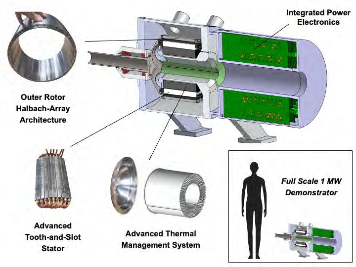

Actuator:
The torque of the REB 90 is 300 Newton meters, and since the motor has 27cm of diameter, then a linear version would have 200kg of pulling/pushing force. But this is a spaghetti linear motor, so only pulling force.
The kilowattage is rounded up to 80kw, but in reality it uses 60-70kw continiously. In any case, since it uses 800 volts, it would use around 100 amps. Accordingly to the AWG of aluminium wire, I would need 1AWG of aluminium wire, which is 7.5mm of diameter, almost a centimeter.
Since it has maximum 4000 rpm with 800 volts, I would assume that its KV is 5. I don't need the speed of 4000 rpm in linear motion, but the actual number depends on the position of each linear motor.I forgot the number of poles and slots that the REB-90 was supposed to have...
I did count 59 magnets and 44 slots in the 3D models that I've made. Dunno if it is correct, the number of poles and slots should be dividible by 2 and 3 (2 poles and 3 phases).
So it is probably 60 poles and 45 slots.
Also, I forgot: this is the widing calculator: https://www.bavaria-direct.co.za/scheme/calculator/Now I don't think this winding scheme/calculator is a good example for a tubular linear electric motor, since the coils would be one above another in this case.
If I find the winding process too difficult I may just stick to the conventional square linear motor...
Maybe it will be easier to turn a induction motor into a tubular motor, they are already stacked in a diagonal, just need to straight it out:I can't find for the love of me the number of turns required. It changes between 10 and 200 turns in each stator. :|
Plus, the Reb-90 is a long motor, with aorund 20cm of height/thickness, meaning that I would need to make the turns like it was in a 20cm long slot, and then keep it in a tubular shape for the linear electric motor actuator.Well, I will do the following: I will make a 3D model occupying the space around the stator teeth, by taking the volume and the density of aluminium, I can find more or less how many turns I would need.
It would occupy around 90 cubic centimeters of space, and since I'm assuming the original would use copper wire, it would weight around 800 grams. But since it has 45 slots, it would weight around 35kg, in total, but the original is said to weight around 23kg.
Assuming that the copper weights 15kg in total, then each coil weights around 300 grams instead.
Taking a volume, density and weight calculator, it would be 2.51 meters in length.By the way, since the Reb90 has 27cm of diameter, it would have 84cm of length. So it would also actuate 84cm, totally 170cm of length in total. But it would be so long the electromagnets wouldn't be able to "catch" the moving part.

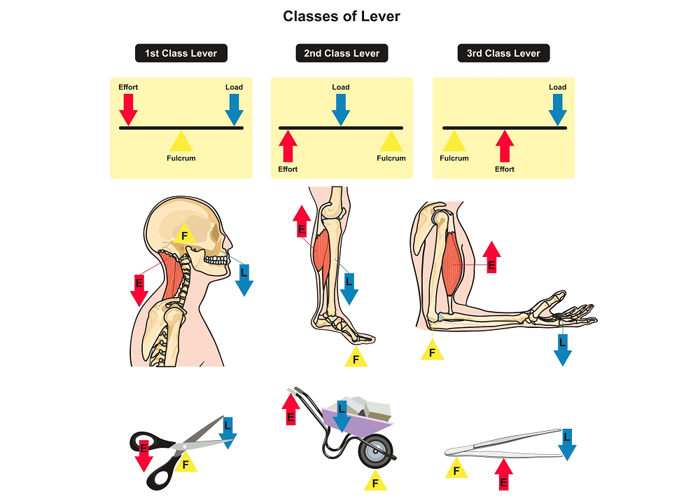

The only issue I have with this idea is that I always assumed stewart platforms to distribute its loads equally between all actuators at all times, which is not the case.
I was thinking of using something like this... But I don't know if this stewart platform is hyper flexible because it has extra actuators or because of its unique joints.
Well, guess what?
I was right, unfortunately.
In a rough estimation, if a stewart platform is expected to handle X amount of weight/load/force, each actuator should be able to output and/or withstand at least Y amounts of that force/weight/load.
And the general rule that ChaGPT/BingGPT/PoeGPT comes with is that each actuator should at least be able to output 1.5 to 3 times the force you want to output and withstand a load of 7 times the output force.
Whenever I choose hydraulics, mechanical or electrostatic actuators, this is the "rule of thumb" for the stewart platform, and thus, the actuators would need to be built accordingly.

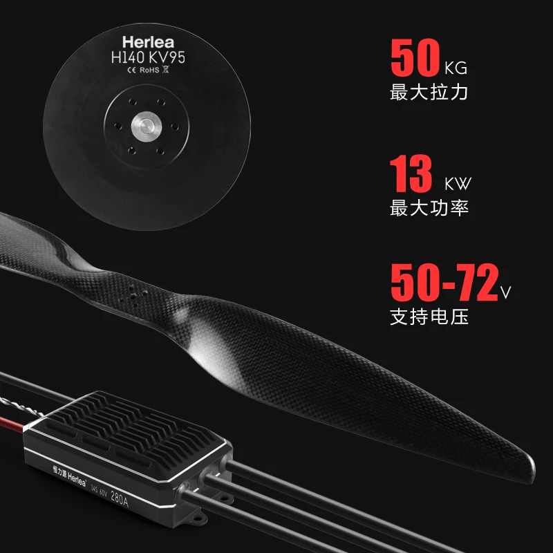

Not exactly great...Well, since I would need 2.5 kW to move 500 kg at 1.4 m/s, then I would need 22.5 kW for 4500kg at same speed, and around 45 kW for 9 tons.
A freerchobby 15kw motor weights around 2.88 kg, and since I would need 30 of these (at least), it would weight 86.4kg (at least).
There are in fact, 45kw motors out there and these often weight around 5 to 7kg, so 150kg to 210kg in total respectively. But I think that is overkill anyway.
Now, unfortunately, I will have to figure out the number of poles, turns and teeth in this electric motor, just like the REB-90. I had all the time to do that with that motor, but now I have to do the same thing all over again...

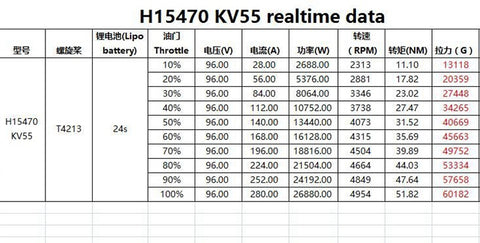

Well, I couldn't find any information on the motor, but I found this one:
It is named a "30kw freerchooby", however, when looking at its wattage output, it actually peaks at 26kw.
It is said to have
- MOTOR: MP 15470
- KV: 55
- MAX POWER: 30KW
- RATED POWER: 12kw
- MAX CURRENT:300A
- ESC:120V 500A ESC /22S 500A ESC
- MAX VOLT: 100V
- RPM: 5500
- SIZE: 154 x 69.5( without shaft )
- TORQUE: 50Nm
- THRUST:60KG
- POLES: 20 (40 MAGANET)
- SLOT:36
- PWM:8-16KHZ
- TIMING DEGREE: 15
- NET WEIGHT (kg):3.5
I don't know what "net weight" means, but I will guess that it is the weight of the motor. So, with 30 of these, it would weight around 105kg.
And dammit, it also has 300 amps, how the hell does this produces only 50 Nm of torque with 300 amps while the REB-90 can produce 300 Nm with only 100 amps?

Of course, I did find some interesting articles about ultra high speed alternators that could possibly solve the issue of generator size and weight.
(this is a conventional 10 kilowatt AC dynamo generator and it "just" weights half a ton)
The articles in question are the following:
- https://www.sciencedirect.com/science/article/pii/S1876610219313967
- https://www.researchgate.net/publication/224713273_An_Ultra-High-Speed_500000_rpm_1_kW_Electrical_Drive_System
- https://www.pes-publications.ee.ethz.ch/uploads/tx_ethpublications/zwyssig_IAS05.pdf
Of course, these are really small energy outputs, but look at the size of said generators, one of them is as small as a match head.
This means that it would be easier to use a gear box that multiplies the rpm instead of torque.

Ah, by the way, the article talks about a company specialized in super tight tolerances and super dense brushless motors called "Thin Gap", which uses a slotless winding that I couldn't quite grasp how it is done.
This one is said to have 100 kilowatts of power.
The paper I linked above kinda explained how these are done, but I don't think I quite grasped it yet.

Converting the 40cm/s of linear speed with the 1/10 mechanical disadvantage of the human body in a forearm with 30cm of length, the rpm of the arm would reach 250 RPM, or 4 meters per second of linear speed (I heard that a punch can reach 45 km per hour of linear speed).
Now, if we input these numbers in an mech arm with 60 cm of length (since the entire mech is twice the size of an average human), and we maintain the linear speed of 4 meters per second, which would give 130 rpm, we would need 6000 newton-meters to lift 1000kg.
By the way, it doesn't matter if the load is put in a difference distance, if it is going to lift 1000kg on the tip of 60cm, the lever arm length won't change the final wattage, no matter how you tweak the rpm and torque, you can't scape the laws of physics.And, if you input the numbers in a torque to horsepower calculator, it gives you 81,686 watts, or 109 horsepower.
If we take the more "whatever" approach and simply say that the arm and shoulder are the same, the torso uses the same amount of energy and the legs use 3 times more, it would still give 545 horsepower, or 408,750 watts.
This is basically half a megawatt.
If we take a somewhat precise approach and simply multiply the other limbs force requirement by 3, the numbers go bonkers.
109 hp to the forearm + (109x3) to the shoulder, ((109x3)x3) to the torso, (((109x3)x3)x3) to the legs, which would give:
4360 horsepower or 3,270,000 watts of power.
You would need 3 megawatts of power to a simple mech that moves at same speed as a human being.
It is not "super speed", just "super strength", you would still run miserable 10 km/h with the mech (average human running speed), maybe 20km/h due to the double size of the limbs (a mech even slower than this could be viable, but what would be the point?)
And a exosuit with 100kg of lifting capacity would use 145 horsepower/109,000 watts, not much lower than the mech (a exosuit even slower than this could be viable, but what would be the point?²).
Plus, I'm calculating only a 100% efficient machine, which is not possible. With inneficiencies, the energy consumption would increase even more.

In either way, one would need to plan how many tons of weight each limb would support, and on top of that, figure out if the structure will handle falling into the ground, running, jumping and whatever other actions one would need to peform.
Let's just remember that each part of the body is technically a lever, and each subsequent part of the body needs to be more powerful than the previous one. The shoulders would need to be X times stronger than the arms, the torso be X times stronger than the previous two and finally the legs that would need to be X times stronger than all others.
The "best" rule of thumb is to make everything somewhat stronger than it needs to be and make the legs 3 times stronger (it is said that the lower part of the human body is 3 times stronger than the upper part, and that is why you can carry weight and still be able to run and jump, besides your own weight).

I even thought on using a micro turbine engine with a high speed alternator, which would be way lighter, but these aren't cheap, easy to make, nor efficient.
This one is a 8 kilowatt microturbine generator, I literally cannot find anything like that online, but taking into consideration that turbine engines uses titanium alloys and/or inconel alloys, it definitely ain't cheap.

There is also that megawatt induction motor made by MIT, but heh, I doubt I could even come close to such performance and efficiency...
Well, some news websites call it an induction motor, others, like this one, says it has a hallbach array arranged magnets on the rotor...

By the way, I was checking the numbers and it seems like I would need 3 times more energy to make the artificial muscles to go into the same velocity as the real muscles.For example, the biceps brachii muscle has a lever arm that is approximately one tenth that of the center of mass of the forearm and, thus, the muscle needs to generate a force over 10 times the weight of the forearm in order to produce elbow flexion. It has subsequently been proposed that muscle-derived forces are the primary source of mechanical loading that generates bone strain [8, 9].
Source: https://www.ncbi.nlm.nih.gov/pmc/articles/PMC4306629
Basically, the mechanical disadvantage that I was planning was one-third, in other words, if I apply a force at a speed, I would receive 1/3 of the force and 3 times the speed at the end of the limb.
However, since the disadvantage of human muscles is 1/10, this means that it applies a speed and a force that is divided and multiplied 10 times.
Human muscles reach a speed of 40cm/s, just like my artificial muscle, but it receives a boost of 10 times its original speed.
But mine only receives 1/3 of the speed, meaning that in order to compensate, I would need 3.33 times more speed to compensate.Force x Velocity = Energy.
