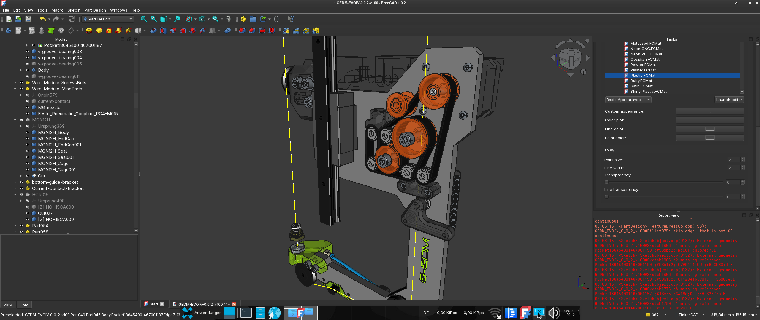

The next router is a lot easier to build. Some parts are cut to size to reduce weight and lower the cost factor.
Much less printed plastic, only one HGR20 rail on X, ballscrew on Y reduced to the size needed, the large Y extrusion cut to the needed size, new mounting table concept and some other changes.
The project file will provide a portal for HGH20CA blocks (the ones that ship with most HGR20 sets) but also a portal for HGH20HA linear blocks which are a little longer and better for Y.
If things work out the new C-Arc and the portal can be ordered on http://justway.com later.
Also this time all parts are labeled with sizes etc. so it is easy to lookup the required size of for example rails/ballscrew/extrusion/acrylic plates etc.
Still trying to figure out a cheaper replacement for the aluminum extrusions.
The new wire module design is almost ready and justway.com sponsored the backbone. Ordering process is straight forward and couldn't be easier. Uploaded the step file, selected the manufacturing process (Lasercut in this case), material, surface finish and it was good to go. Big thanks to the team from justway for providing their service and helping the G-EDM project getting forward.
The part is laser cut from solid 8mm stainless steel. This version has a belt driven wire feeder on the C-ARC itself and requires only some minor 3D printed add-ons which heavily reduces build complexity while improving rigidity and also the maximum cutting area.
The part was packaged well and arrived without surface damages. I haven't measured the tolerances but it seems to be within the range that is expected for laser cutting. Some of the holes had a perfect fit while some others had some residues from the cutting process. Lasercutting 8mm stainless steel does not create a mirror finish. But everything was within the expected range and to specs. Nothing to complain here.
They offers multiple surface finishes and I would have loved to get the black oxide finish but to reduce the cost for the prototype I went with the standard raw finish.
