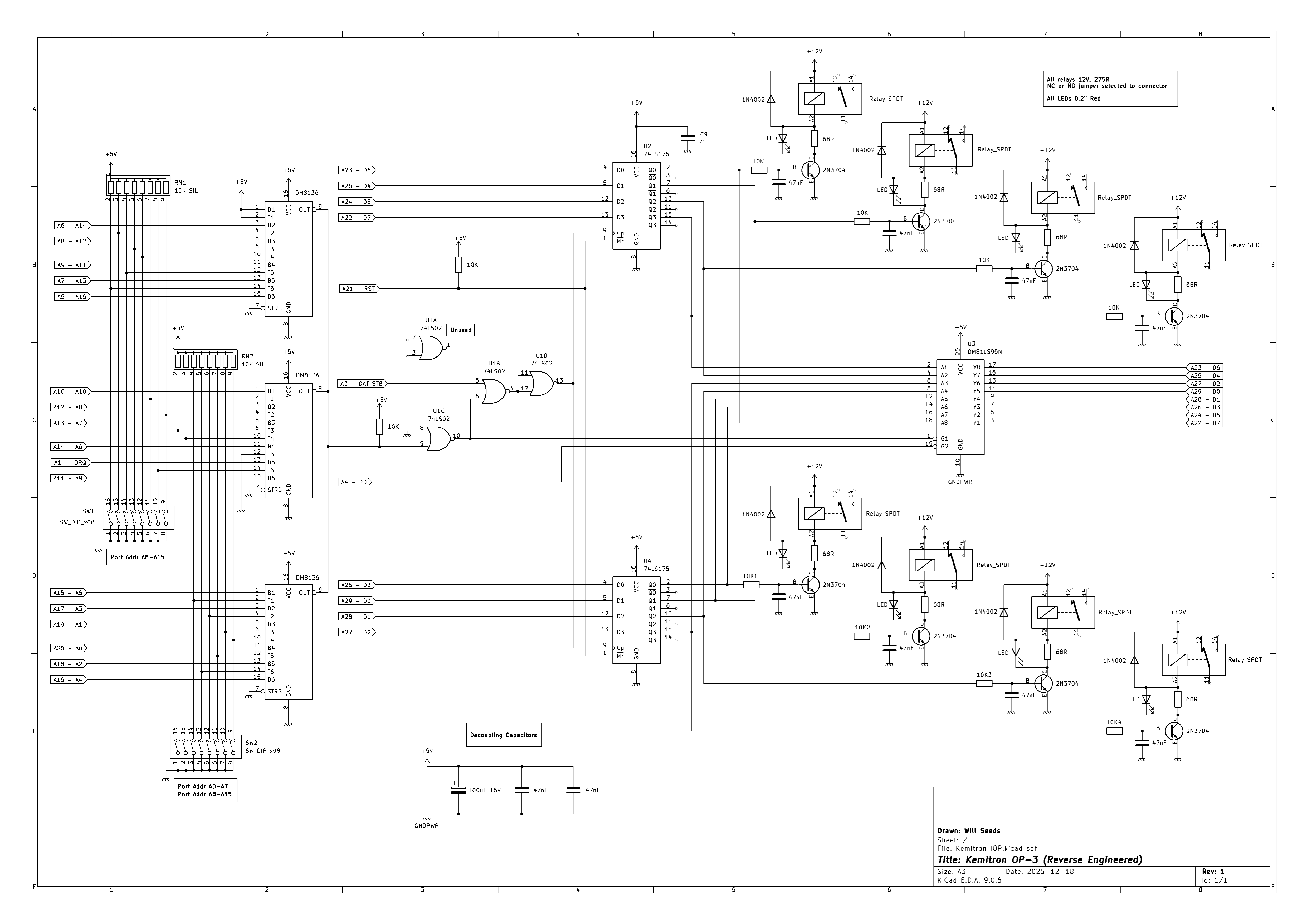

It seems the small UK manufacturer Kemitron produced at least three Kemitron models: The 2000 Series, the 3000 Series and the Solo. My cards look to be the correct size for the Solo, but of course I've never seen the other models.
As I find more information, I'll add it into the respective project log.
