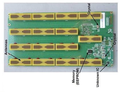

BreatheSense is a‘Breathe-to-Speech’ assistive device which converts an individuals breathe data into speech. This system works on a sensor called ‘Walabot’, which is manufactured by Vayyar Imaging Ltd. This is a 3D imaging sensor, which is embedded with 15 high accuracy Radio Frequency antennas. Its primary function is in-wall imaging, but due to these RF antennas, it can even detect the slightest of movements, like thumping of the human heart, or the movement of diaphragm.So, this enables it to perform the functions of Heartbeat Sensing and Breathe Sensing. I have used the Walabot Creator for my system, hence all the explanation will be with respect to the Walabot creator model.

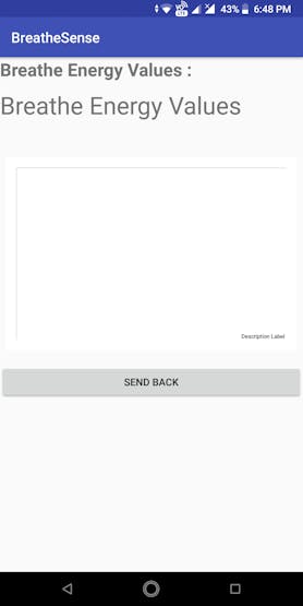

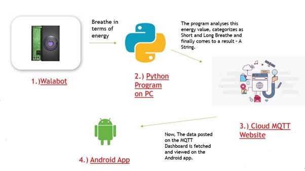

Now, the walabot sensor will give the breath readings in terms of ‘energy’, which are in the order of 10^-5, which is due to the micro movements of our diaphragm moves. Now, these readings are plotted, analysed by a python program written by me, which converts them into text messages for a particular sequence of breath data, and sends it to the android app, which speaks it out loud (speech).

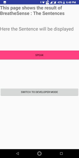

Now, each of these combination will represent a particular sentence or block of text, like “I need Help”, “I need Food”, and other simple sentences that a disabled person would need for a casual conversation. Now these sentences are sent to the android app, which will convert this into speech by speaking them our loud for the normal person to hear.

To understand every detail of the system, we will divide it into certain parts, which is shown by the flow diagram, giving a detailed explanation on how the system actually works.
