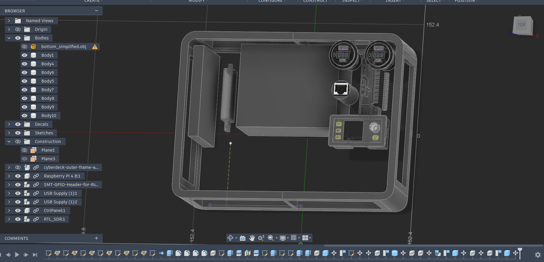

    As I have been integrating various peripherals, it has become clear to me that I'll have to do additional planning to mitigate heat, power and USB power draw. I really thought my power architecture was sufficient but it is looking like I may have to revisit that assumption.
    I gutted and used a 294wh power unit with dedicated USB A and C outputs, raw DC outputs and charging inputs for line or solar. I am thinking I am going to have to create a USB switch for the individual peripherals to control how much is on the USB bus at any one time which will also impact power.
    Thermally I always had intended to create ducted exhaust channels but I am realizing the RTL-SDR is creates a lot of heat just idle so I am thinking being able to turn devices on and off will help me manage it. I am also going to double down on oversized heat sink for both Pi and DIY something for the RTL-SDR. On the up side, I did get SDR++ installed and working and installed an ADS-B tracker as I am testing devices and such and that's been fun. :)

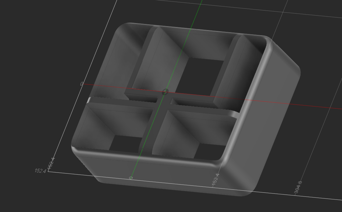

    1. Integrated Faraday cage descoped - my approach for addressing this scope item was just too difficult to execute effectively and affects the rest of the build. I have found some great faraday cage solutions and have resolved to build a separate purpose built faraday storage container which will store this and other sensitive devices offloading that requirement from the deck to a separate support element.

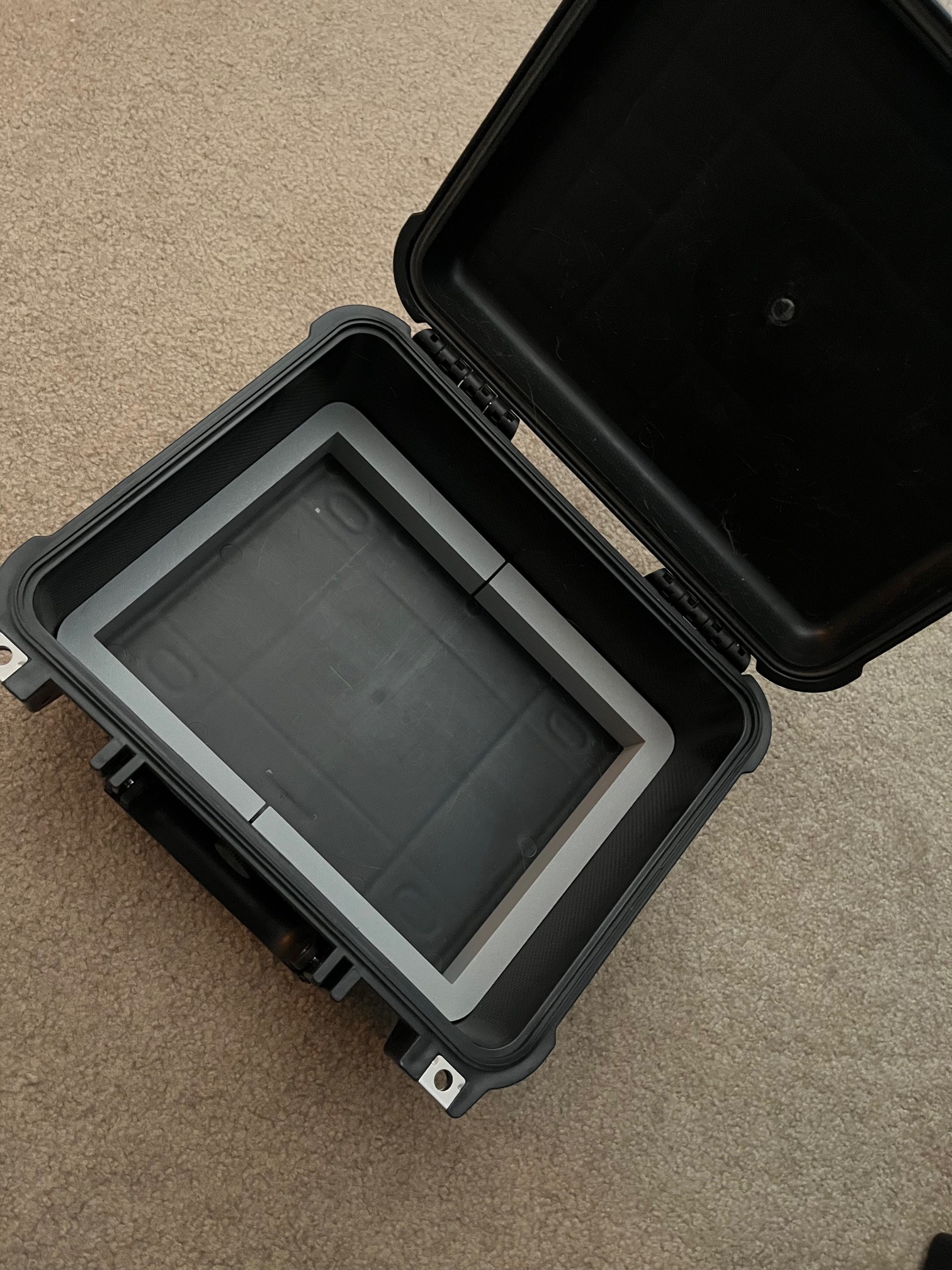

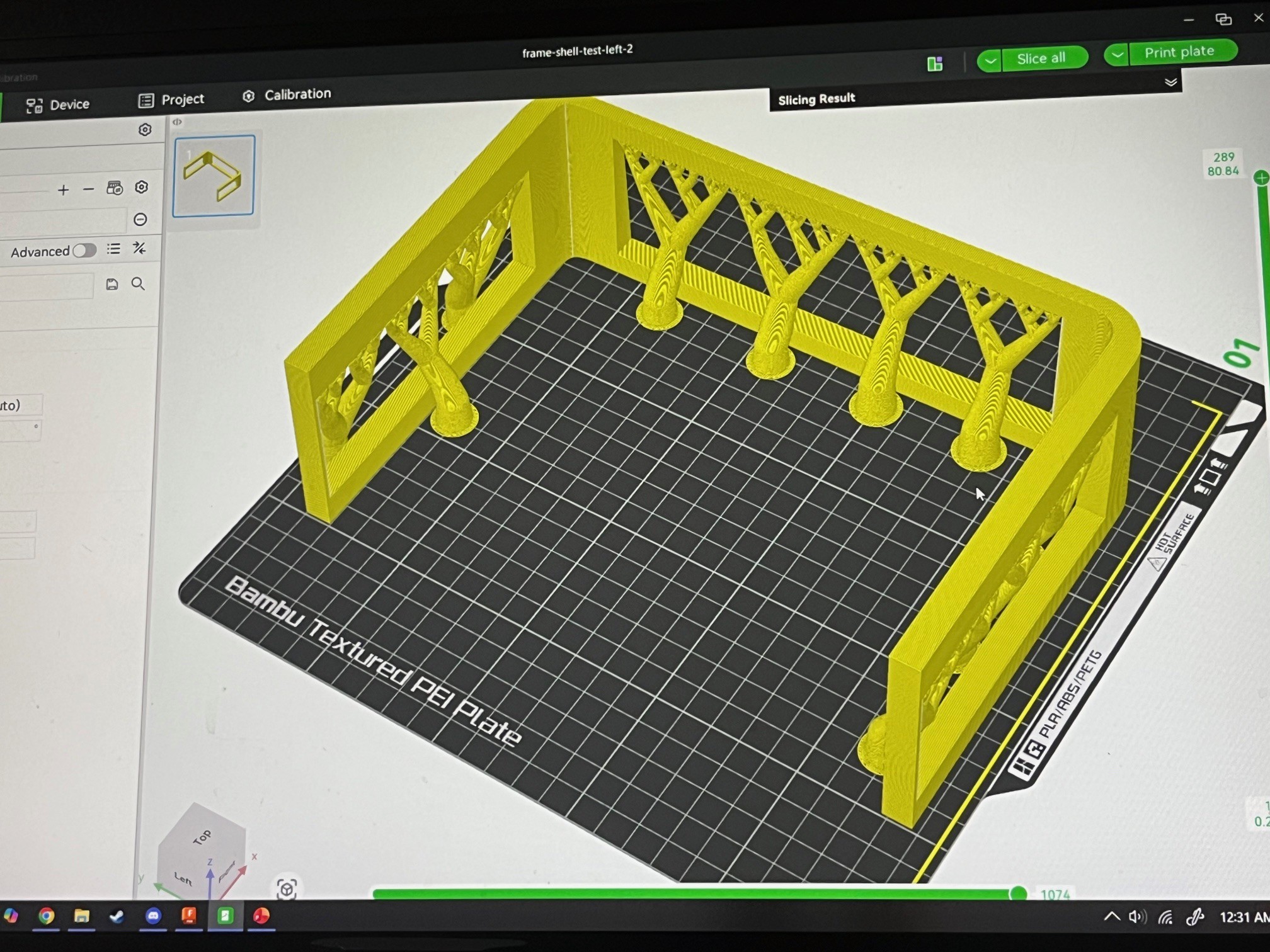

    2. Larger Plastic Hard Case - I decided to go with a larger Olympia case I found cheap, new outer dimensions are L10.47”xW9.68”xH6.87”
    3. Battery Pack . I had a rarely used 294Wh Solar generator (power pack) for camping which has a BMS, In/out ports and controller with a Lithium battery.  I am going to repurpose that hardware and battery for this build.

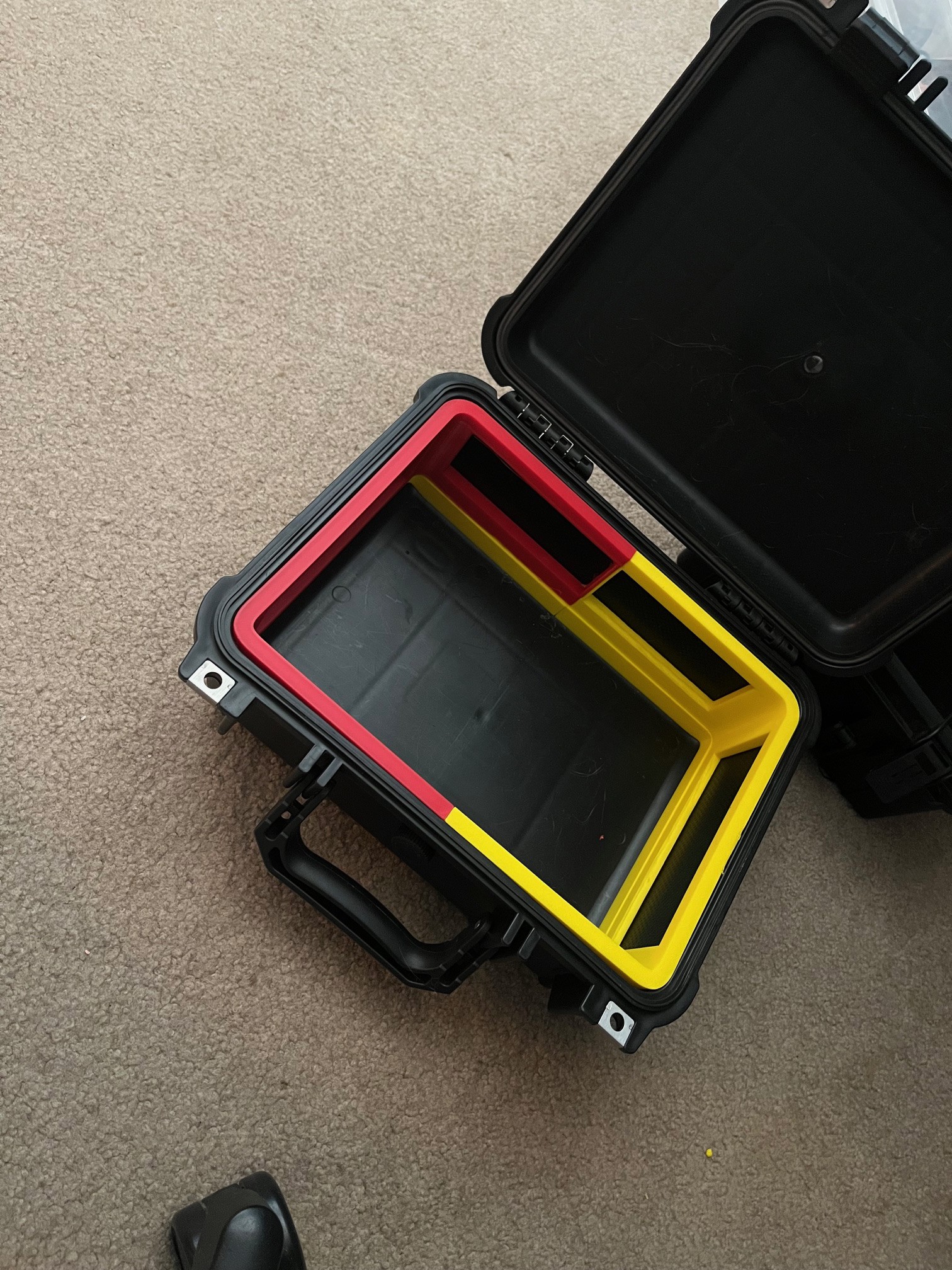

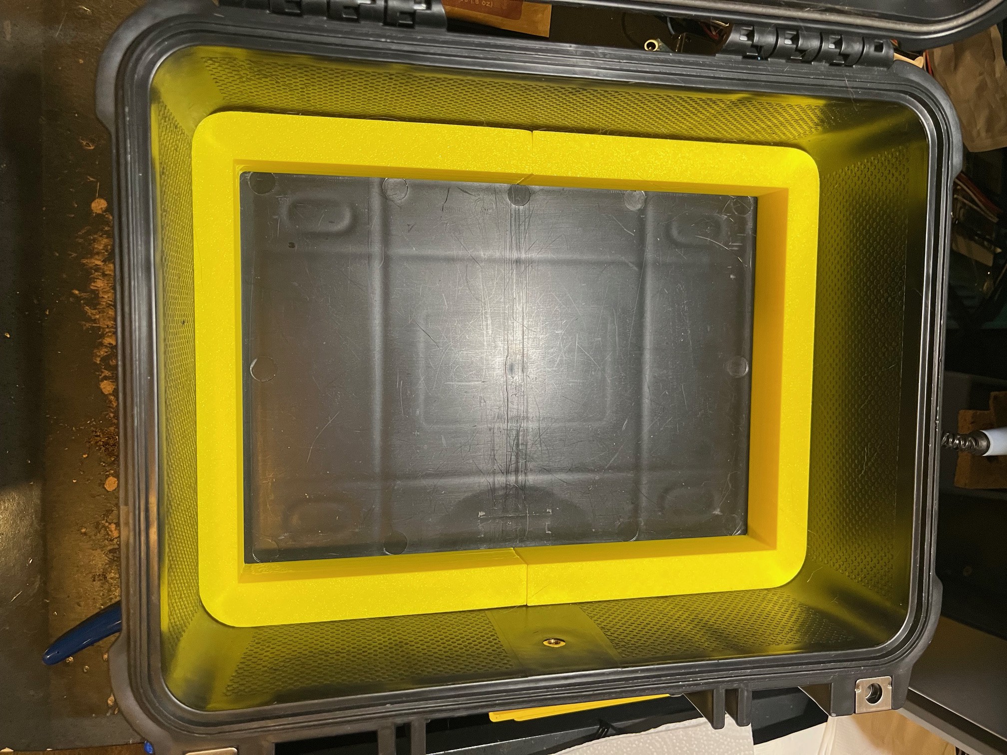

    Get a case

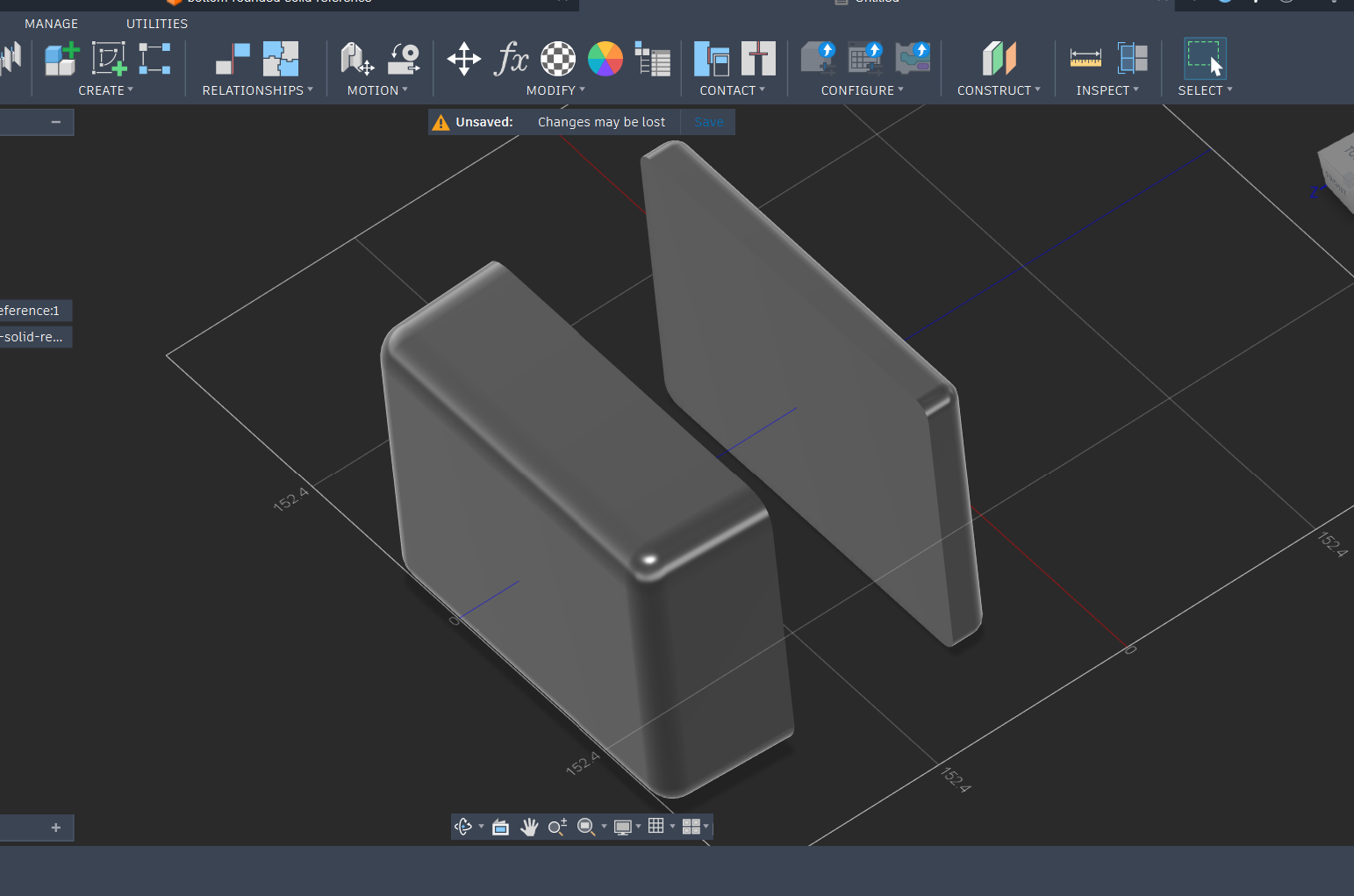

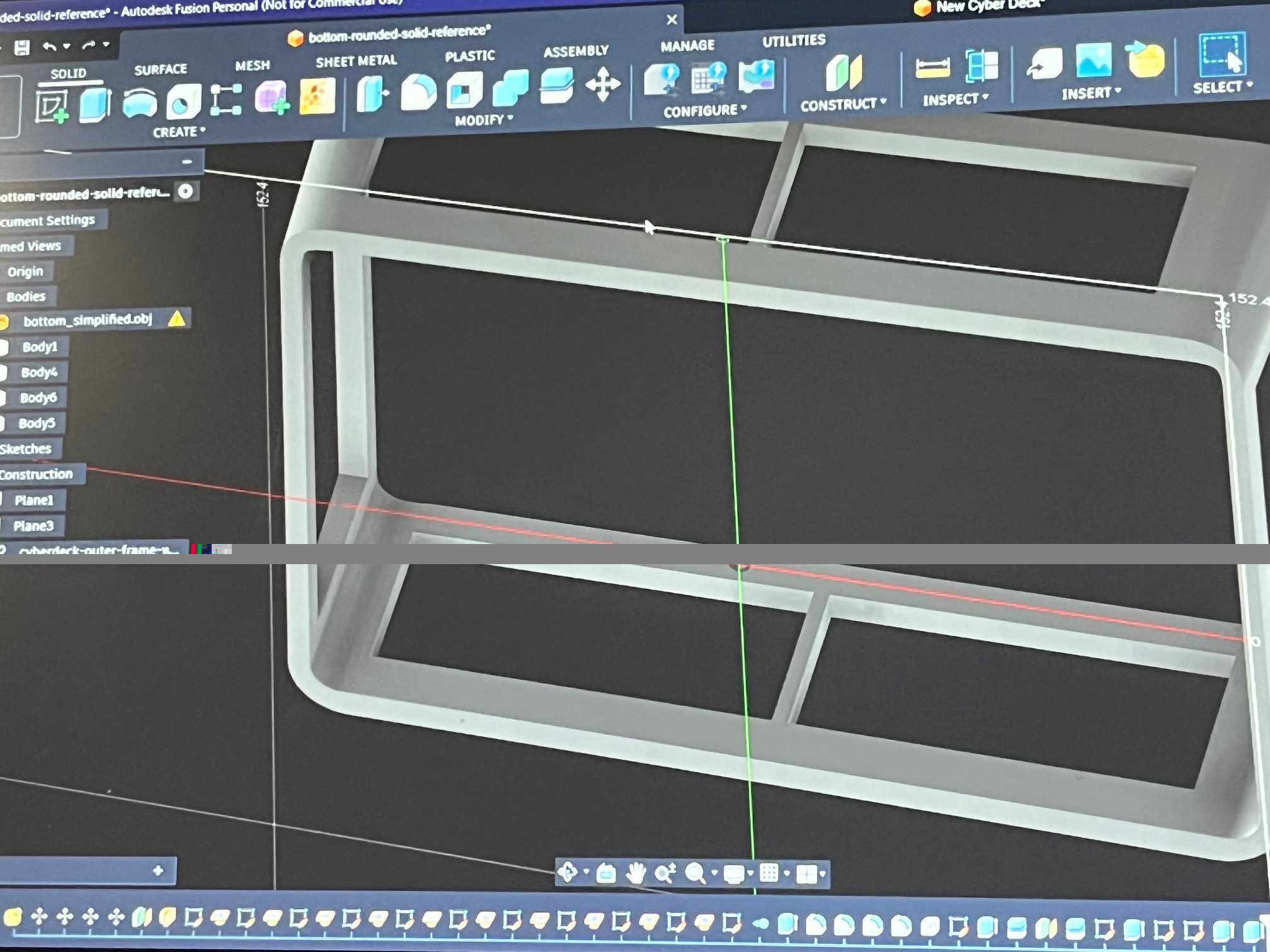

    Ultimately your case is going to be one of the biggest constraints. If you don't already have one, figure out which one you are going to use then get the specs or buy it and measure it in person Once you know the size constraints of your case, you can figure out how much you can stuff in it.
    Once I had my case, I verified the factory dimensions with my own measurements (always double check) to determine the interior dimensions of the case. Because I already had some parts and cables, I was able to dry fit in some of the components to begin to visualize how'd they stack and where cable routing and access points might go so I can be aware of any space constraints. I didn't yet have all of the parts so at this stage so I took a step back and began to model the interior frame and front panel design in Fusion 360 by roughing in the parts I had at that point and then creating placeholder objects if I could find the dimensions online. This allows me to make some progress on two fronts while I collect all the gear; 1) it helps me virtually organize the interior components and front panel and 2) later in the process I can take the CAD files and use them for CAM like to 3D print, laser cut or CNC elements of the deck.
