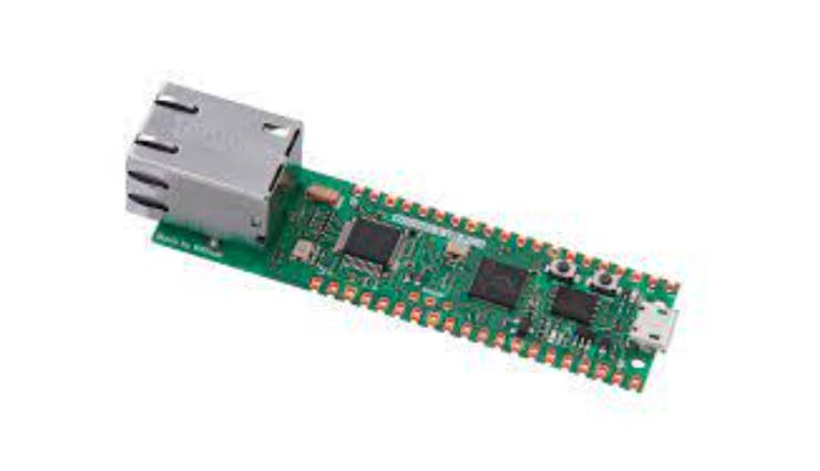

Raspberry PI Pico (W5100S-EVB-Pico)
Pico communicates and receives the data inferred by Raspberry Pi 4, and utilizes Ethernet communication to make menu recommendations using chatGPT.
Connect Ethernet, power and set up the UART to communicate with the Raspberry 4.
Hardware connections
Connect GPIO pin 14 (TX) of the Raspberry Pi 4 to the UART RX pin of the Pico.Connect GPIO pin 15 (RX) of the Raspberry Pi 4 to the UART TX pin of the Pico.Connect the GND pins of both boards to each other.

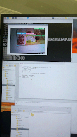

We detect the object refrigerator. Obviously, fast reference frames in object objectification are good for real-time detection, but we'll simply be objectifying and uniquing class values to create data.
1. To create the object detection model, I first created a dataset. Through crawling, I built a dataset of images related to food ingredients or containers. I spent about 5 hours drawing bounding boxes for each object element in the photos.📷
2. We trained with the YOLOv5n.pt nanomodel. The reason is lightweight. Then, we switched to Onnx TFLite. However, the capacity itself is not much different and the reference speed is not different, so we used the YOLOv5n model.YOLOv5 Train.ipynb
# pt to onnx to -> TFlite file !pip3 install tensorflow==2.3.1 !pip install -r requirements.txt !python3 export.py --weights result.pt --img 418 --batch 1 --include onnx tflite

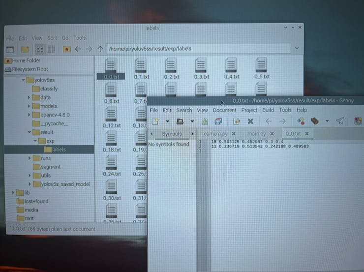

3. Object recognition using Raspberry Pi 4. Create a reference using the appropriate code. I used RaspCam, so RaspCam, which I set to '0', which is data, enters the source part and makes an inference. Then, I post-process only the class value and bounding box coordinates of the objects detected through save-txt in the parameter and send the data to Pico.
We've coded the appropriate preprocessing in the main.py file, and we can use it to send data to pico.We've also coded the UART communication.(The author is Korean, so there is code to preprocess the label values in Korean.)
