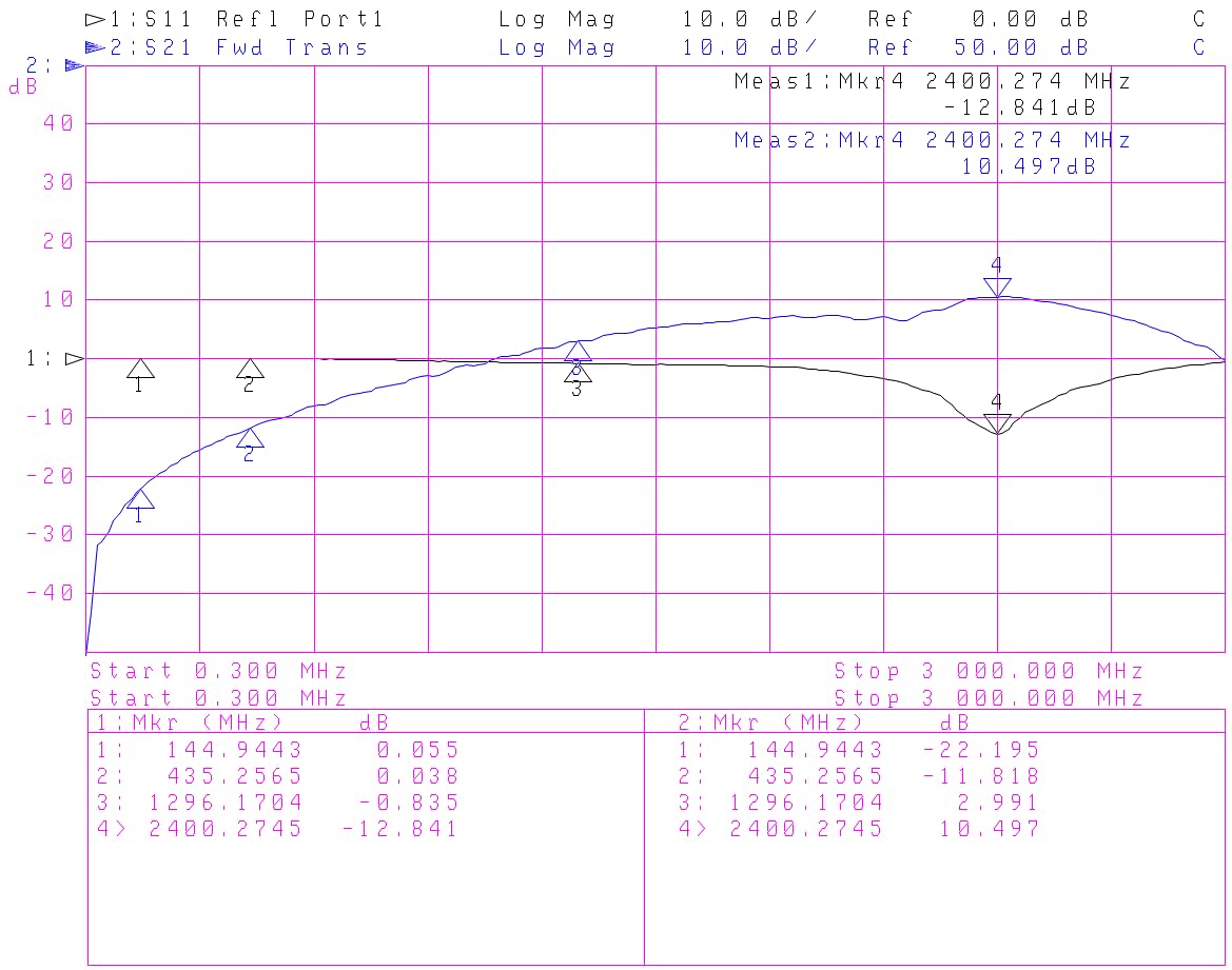

Ansoft Designer SV simulation
  • Ansoft Designer SV simulates gains and impedances.
  • GT is transducer gain - worst case with bad matching.
  • GMAX - ideal maximum possible gain with input-output matched with source and load.

  • MicroCAP and Ansoft Designer give the same results in AC analyses.
  • The best result after optimization varying only caps is 9dB of gain.
  • Theoretically, in accordance with S-parameters for RF2126, the maximum achievable gain is 11 dB, but to reach it more complex matching networks are necessary to implement (LC circuits, TLs etc.).

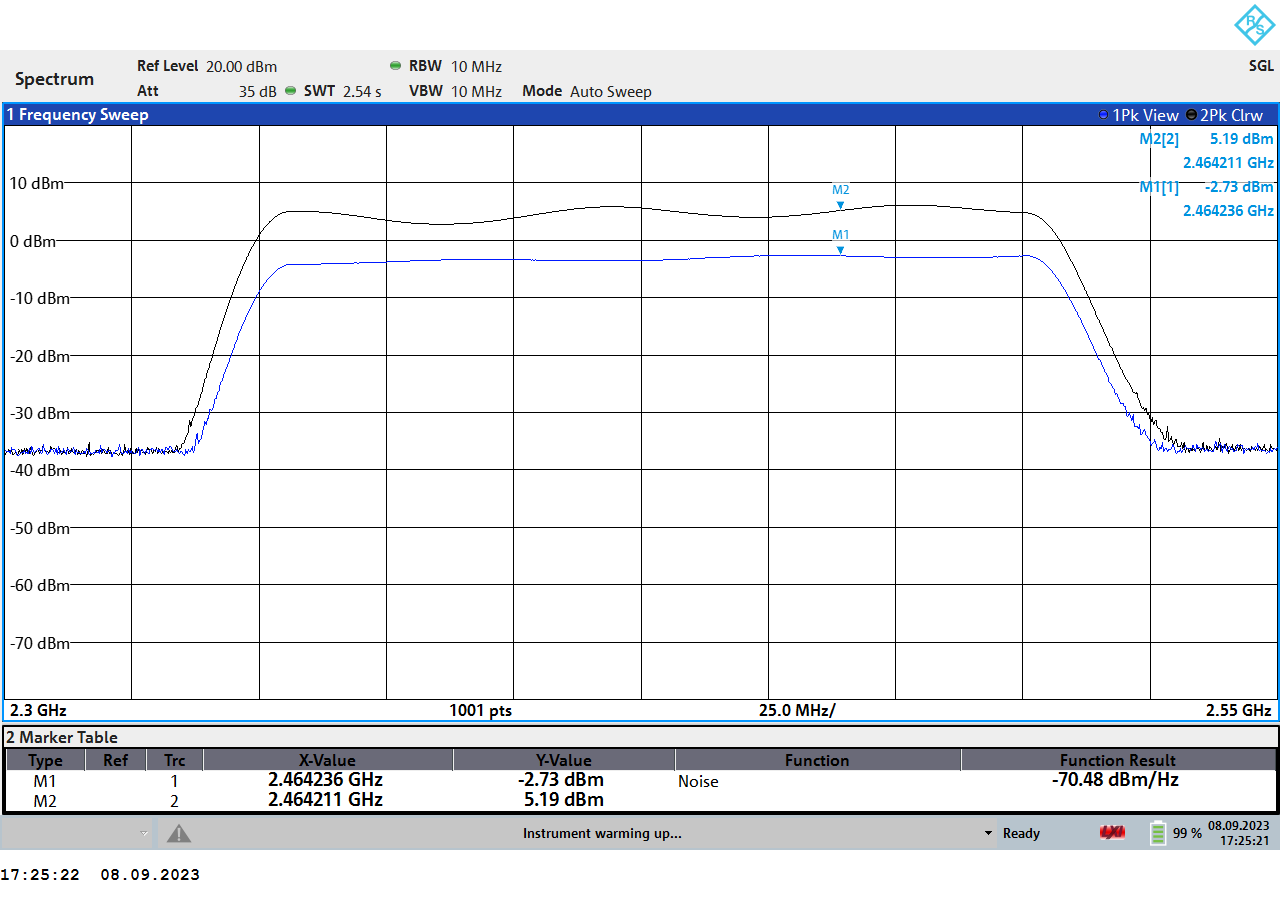

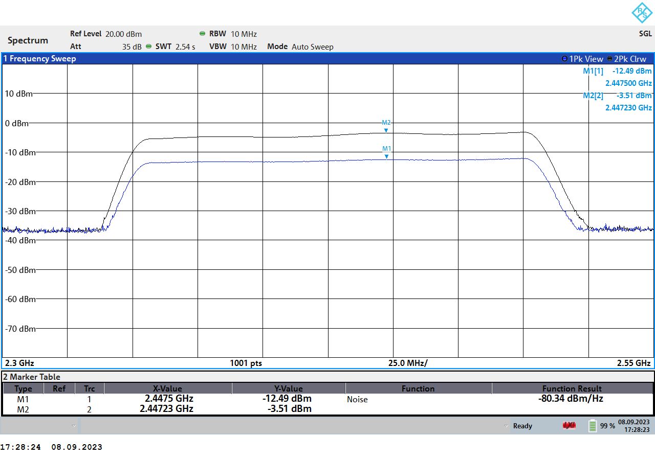

Experiment
  • 20dB attenuator at spectrum analyzer input.
  • 10dB attenuator at RF2126 module input improves gain flatness, so seems like the signal generator source impedance is not perfectly equal to 50 Ohm. See the log for the second module modification results.
  • The result might be 1dB better, one cable (1m) extra with module measurement.
  • The gain measured around 8.5...9 dB which is a good match with the simulation.
