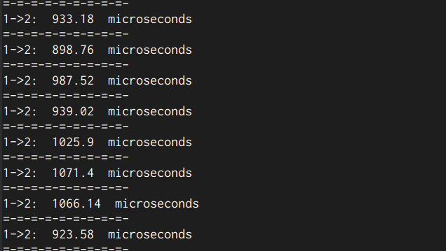

    After the initial exploration, I found some problems with the setup I used:
    • I had questions about how high I could bump the clock frequency in the ESP32
    • I was getting very inconsistent results in my timing measurements -- like, three orders of magnitude difference in time-of-flight measurements
    I decided to look for something new...and found it, thanks to a Pi Pico that my father had given me as a gift.  I started looking for ways I could do high-resolution timing with it, and came across this thread in the Raspberry Pi forums that had pretty much exactly what I needed: example code that would do microsecond-resolution timing...and in microPython, no less!  I had not done any reading on the capabilities of the Pico, and the state machine blew my mind.  The example code posted by one of the folks in the thread was an excellent introduction to what could be accomplished; after a few hours of reading through the excellent SDK documentation, I thought I could get the timing I needed.

    So!  After some futzing around, I had:
    •  microPython code to run on the Pico.  (The code there has references to MPU6050, but that should be removed.)
    • 3 piezo sensors clamped to the 2x4 of Science at various distances; I found this helped a lot with consistency.
    With this setup, I started gathering data by knocking on the board and capturing the timing between different sensors as the sound travelled through:
    (Side note: BEHOLD MY MIGHTY DIAGRAM.)
    I was able to measure the time of flight successfully -- yay! -- but there was still a lot of variation when hammering by hand: for one set of measurements, it was anywhere between 855 and 1095 microseconds to travel 30cm.  That's about a 25-30% difference.  I tried dropping the hammer from the same height, but that really didn't do much.
