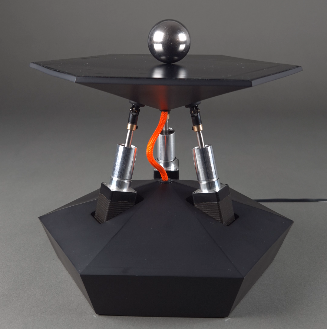

    The BJR_019 is now complete!
    Thank you for coming along for the design and development of the BJR!
    I learned a lot about coding, prototyping, sensors, and control systems during this project.
    You can find the full source code of the project in this repository: https://github.com/EverydayDynamics/bjr
    Here is a picture of the finished product:
    The coated 3d printed parts came out beautiful!
    My worry was that the black vinyl on top of the touchscreen would hinder it's effectiveness, but no issues found whatsoever.

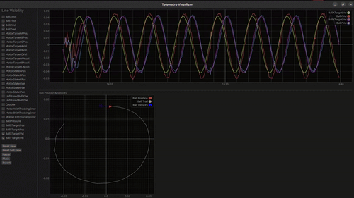

    The BJR_019 project isn’t just firmware. Alongside the embedded code, I wrote a telemetry visualization tool, also in Rust.
    This small visualizer enabled me to chisel out control related issues with minimal data processing. I could see what's happening to the robot in real time.
    Because both the firmware and the visualization software shared the same language, I could rapidly iterate on the communication protocol. Adding a new telemetry field was as simple as tweaking a few lines in one package That tight integration was a huge win for speed.

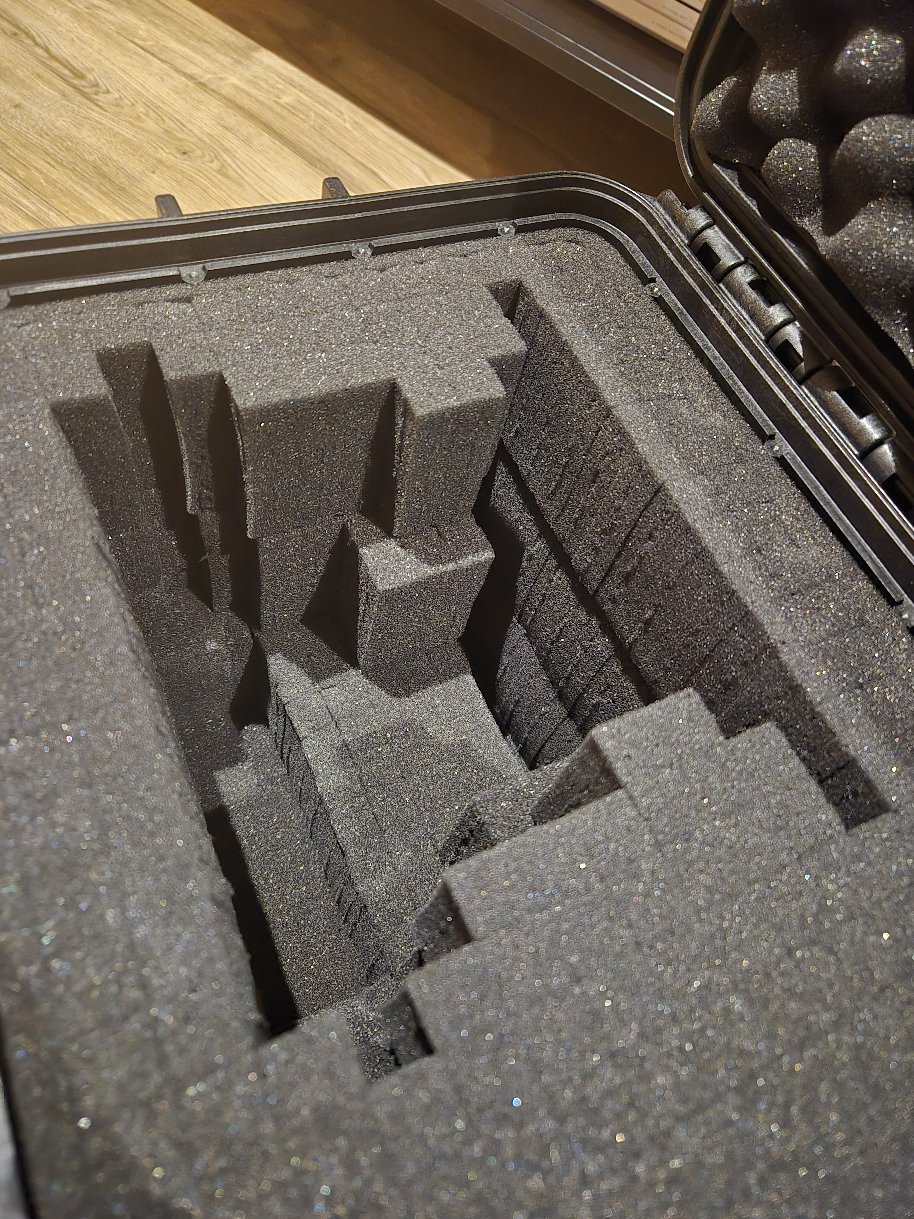

    The BJR just received a flight case!
    It's probably an overkill, but I've been working on this project for a long time, so I wanted to make the investment to be able to transport it without having to fear for it's safety.
    The case came with multiple layers of pre cut foam cells. All I needed to do was to break away the thin bit of foam holding the chunks together, and that left me with a cavity that fits the robot perfectly.
    The box is the MAX400  case. It's a tad bit bigger than what I needed, but better this way, so I can ship the accessories alongside with it.
    These flight cases are no joke, it's rated for IP67, and various military standards as well.
    If you find yourself having to transport your project, I can highly recommend a flight case. If not for else, the coolness factor is through the roof if you rock up to the function with one of these.

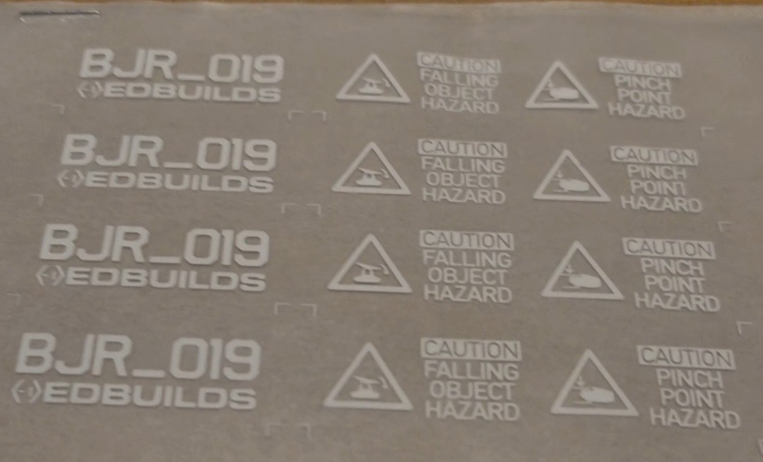

    Some Dry transfer decals have arrived today!
    What are these?
    These are sort of stickers that will act as decoration and warning signs. on the robot. I chose these instead of Vinyl or water transfer, as it adds the least amount of height to the surface. (Or as I was told, I still need to test it.) I want the decals to have a low profile, so on the plate it wouldn't disrupt the movement of the ball.
    The markings show:
    - the corners of the active area
    - The diameter of the "Circling" mode
    - A cross in the center for the "Center hold" mode
    - The triangles show the "Point-to-Point" mode locations.
    I added the hazard labels after doing a quick risk assessment. these are the main risks that I see when anyone interacts with the robot:
    - The universal joint could pinch the skin on someone's finger
    - The ball could fall off from the platform, onto someones foot.
    And of course, Can't forget the name and iteration of the project:
    Let me know what you think of these designs! I'll post soon about how they look on the robot.

    The next video shows on a surface plot what the plate recognizes from my finger:
    In the next video, you will see that the response is still great even if I hold a bearing ball in my hand.
    |f I'm wearing thick gloves, there is still some response, but not strong enough to be able to detect a singular touch point, so the internal filter just gives up.
