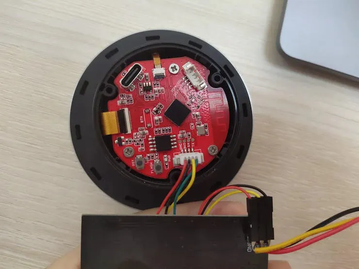

Step 2: Hardwar
12/25/2023 at 09:19 • 0 comments- connect J2 to WS2812 LED:
3V3 to +5V;
GND to GND;
RX to DIN;
- This share uses a light board as an example, but it also applies to ws2812 strip lights.

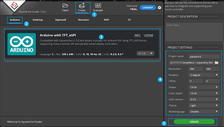

Step 1: SquareLine Design
12/25/2023 at 09:19 • 0 comments- Create a new product
Choose the Arduino and enter in parameters. According to the features of MaTouch ESP32 S3 2.1 Rotary TFT with Touch, the resolution is 480*480, the shape is a circle, and the color depth is 16-bit.

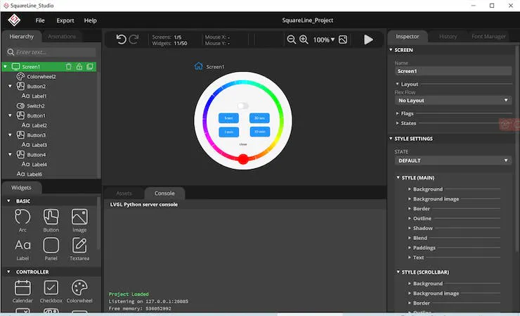

- Design the screen
Add the colorwheel, switch, and buttons on the interface, the color wheel for getting colors, the switch for light switch, and buttons for timed triggers,and you can modify the parameters of them on the Inspector panel. After that, you can select some other widgets to decorate your interface, all is determined by your preference.
