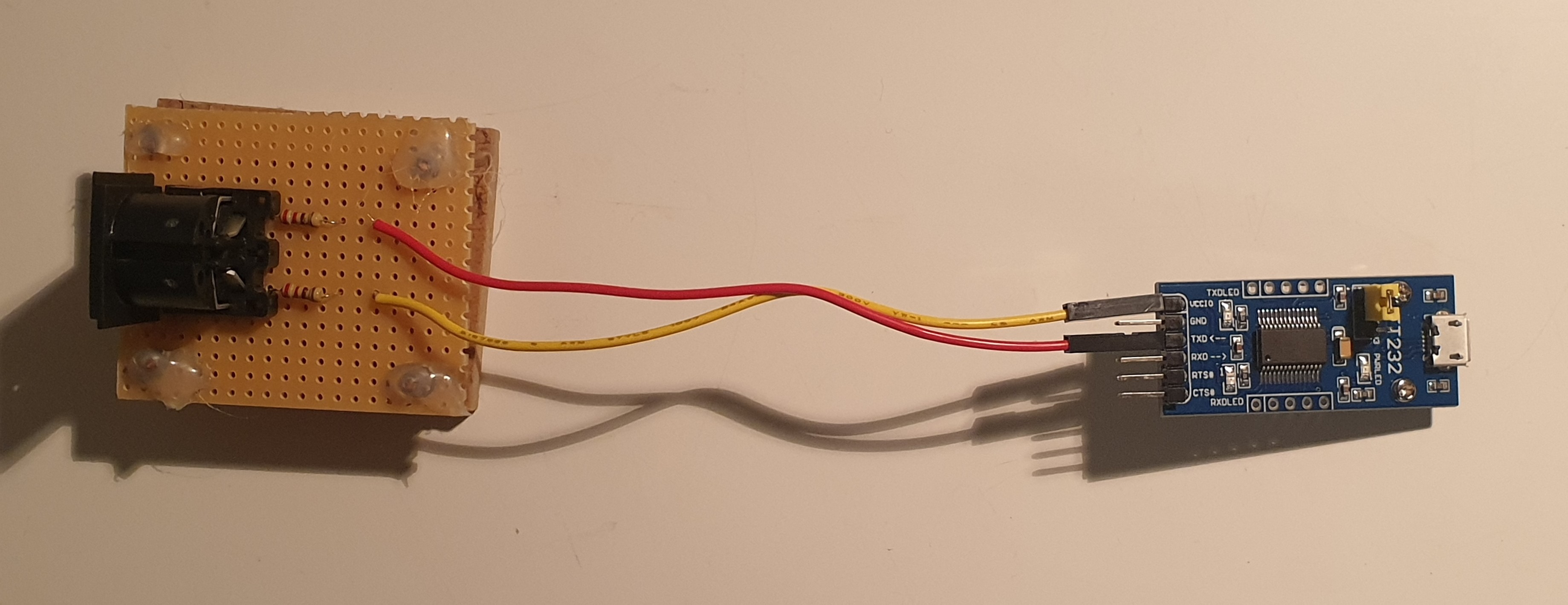

    The approach to create low latency MIDI output that was used so far in lalelu_drums is shown in an early log entry. Unfortunately, this approach recently stopped working. In the following, the problem is explained and an alternative solution is presented.
    the problem
    The original approach relied on a PCI card based COM port that was used with a specific linux driver provided by the manufacturer. With the help of this driver it was possible to configure the specific baud rate that is required for MIDI (31250).
    At some time between November 2025 and January 2026 an automatic update brought the system based on ubuntu server 22.04 into a state where the driver was not working any more. It was not possible to make it work again (see below for a list of attempts).
    The PCI card based COM port can be used with the linux kernel builtin driver, but in this mode it only supports standard baud rates that do not include the one required for MIDI.
    the solution
    As an alternative approach to create MIDI output, a USB-UART bridge is used. It can be used without special drivers and supports the MIDI baud rate.
    Figure 1: As an adaption to the MIDI definition, two 220 Ohm resistors are used and the jumper on the device is configured to output 5V signals.
    With this configuration a total system latency in the range of 20-22ms could be confirmed, similar to the results obtained with the earlier approach.

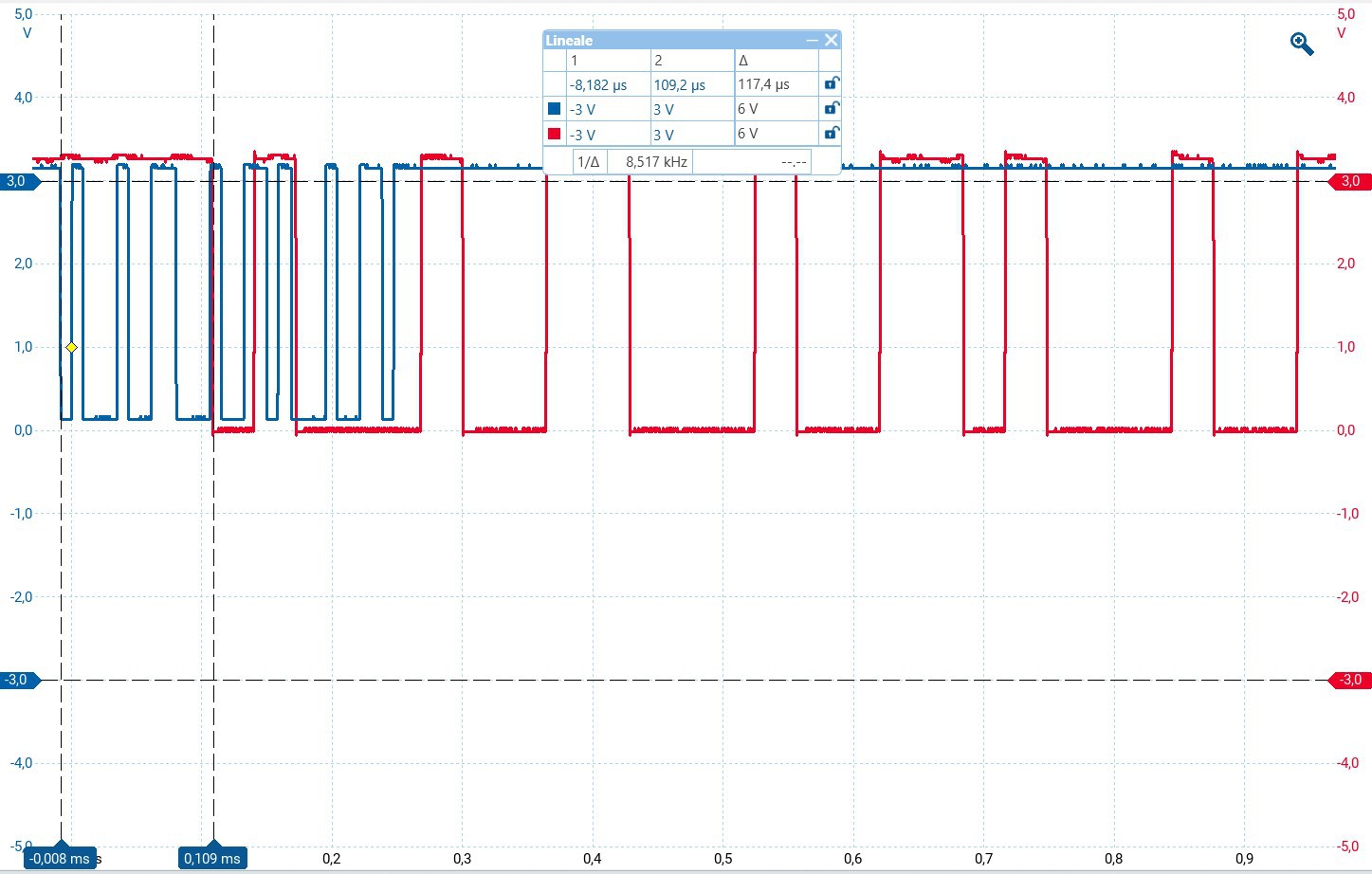

    Before switching to the USB-UART bridge, a different workaround was implemented to restore the MIDI out function. The PCI card based COM port was used with the kernel driver at a high baud rate (115200) and a raspberry pi pico was used as a baud rate translator. It was nice to see how easy this application could be implemented using micropython:
    from machine import UART, Pin
    uartIn = UART(1, baudrate=115200, tx=Pin(4), rx=Pin(5),
                  bits=8, parity=None, stop=1)
    uartOut = UART(0, baudrate=31250, tx=Pin(0), rx=Pin(1),
    while True:
        c = uartIn.read(1)
        if c:
            uartOut.write(c)
    An oscilloscope measurement shows that the translation introduces as little as 109µs of additional latency, which is negligible for this usecase.
    Figure 2: Input and output of the baud rate translator. Vertical cursors show latency.

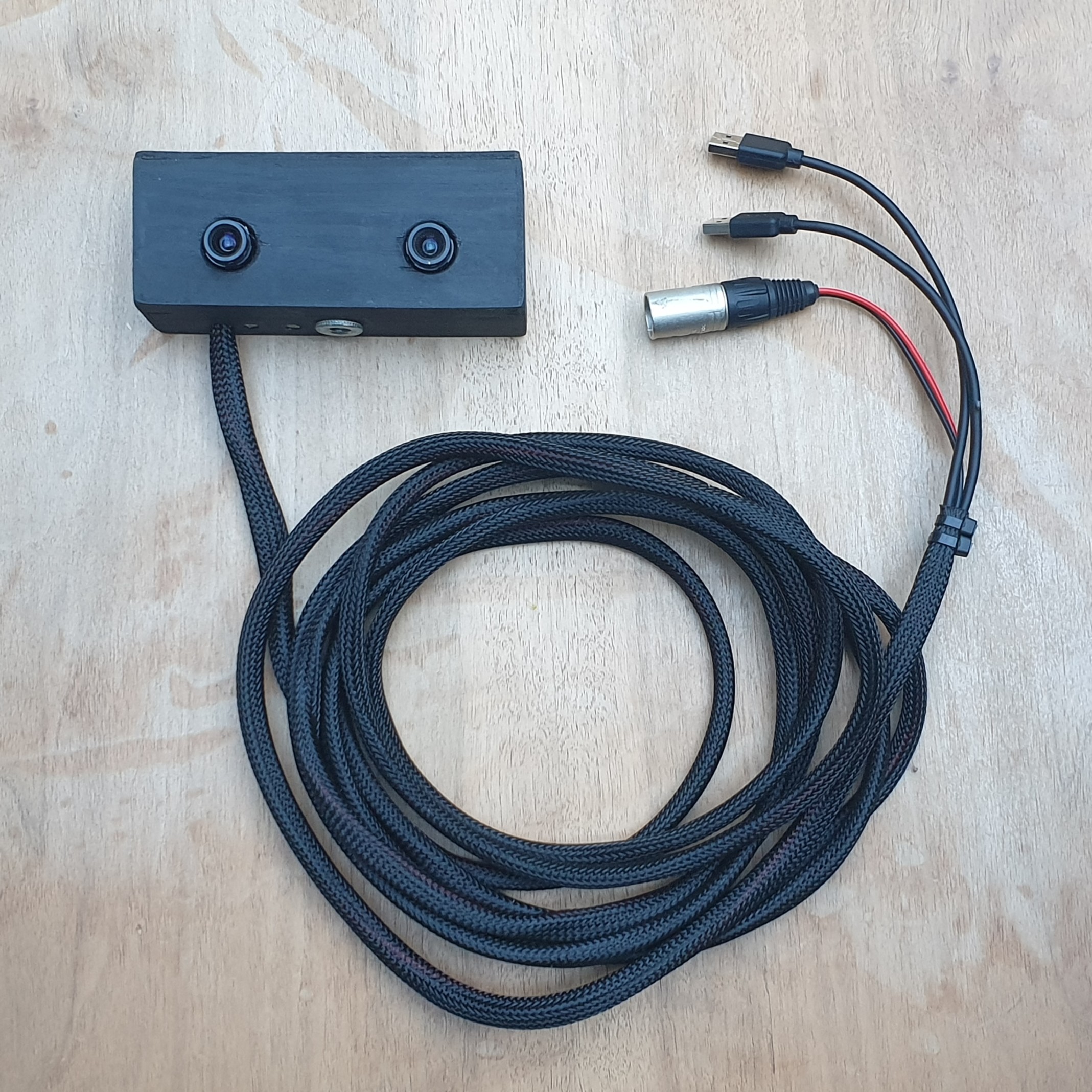

    The side project highrate_longexp is finished, so that there is now a synchronized dual camera available that can be used for lalelu_drums. The benefit of using two cameras is that for a given frame rate (100 Hz) a long exposure time (20 ms) can be realized, reducing the illumination requirements. The two cameras are running at 50 frams per second and are synchronized to acquire frames in a time interleaved fashion.
    The two cameras are mounted side-by-side to minimize the distance of the sensors. Still, there is an offset and a parallax between the viewpoints. Here, I present an algorithm that solves the problem to fuse the two camera streams into a single consistent stream of pose estimations at a rate of 100 Hz.

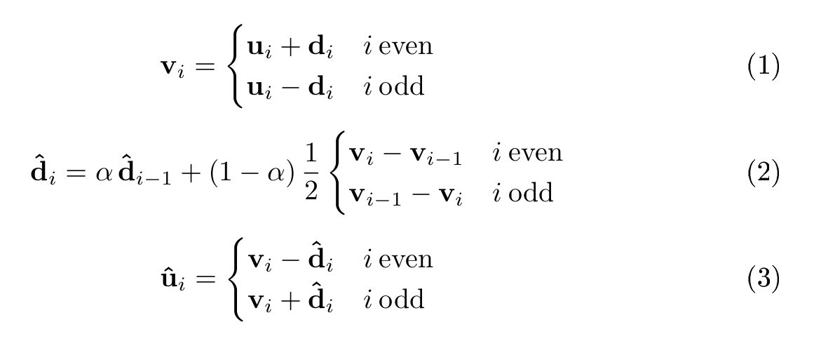

    The first step is to run a human pose estimation model on each camera frame regardless of which camera it comes from. Here, blazepose is used, but movenet would also work. These models do not have a memory, so they treat each frame completely for its own. The result is a stream of pose estimations that jump back and forth between the two viewpoints.
    The situation is shown in figure 1 for a single keypoint. For each time point i there is a true position u of the keypoint, the true positions forming a trajectory (dashed line). The observed positions v can be modeled by adding a displacement vector d, that can be different for each time point.
    Figure 1: Model
    To allow the sensor fusion, we assume that d varies only slowly. In other words, if the keypoint does not move, we assume a constant d and if the keypoint moves, d may change, but it does not change abruptly. With this assumption, the following update rules can be used to find estimates d_hat for the time varying displacement d and u_hat for the true positions of the keypoint u.
    Figure 2: Formulas
    The central idea is to use a running average of the difference between consecutive observations v (dotted vectors) to find d_hat (formula 2). alpha controls the amount of averaging and was set to 0.8 for the example videos. d_hat can be initialized from a single observation v at the very beginning of the measurement.
    Video 1 shows the behaviour of the sensor fusion algorithm for a single keypoint. The pose estimations for the two different camera viewpoints are drawn in green, forming two separate trajectories. After activating the sensor fusion algorithm, the fused trajectory is drawn in red.
    Video 1: Explanation
    In the video, the original rectangular frames were cropped to a quadratic shape so that they can be used as input to blazepose. By cropping the frames from the two cameras differently, the offset could be further reduced (not shown).
    In conclusion, this sensor fusion strategy relies strongly on the performance of the pose estimation network, that does the heavy lifting of interpreting the different camera viewpoints in a consistent way. It is much easier to fuse the keypoint vectors than the original frames.

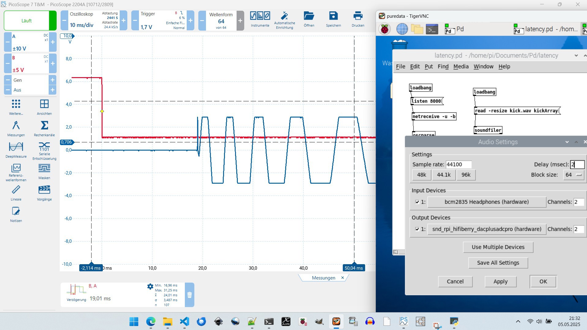

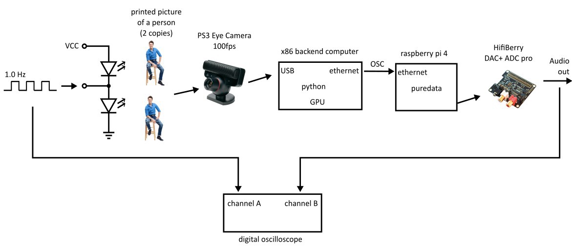

  • Log #20: more on RaspberryPi latency
    Lars Friedrich05/06/2025 at 13:27 0 comments
    Following up on my previous latency measurement covering the setup with OSC messages sent to puredata running on a RaspberryPi, I tested the HifiBerry DAC+ ADC pro as an audio output device.
    With the HifiBerry the latency was reduced compared to the earlier result:
    latencyHifBerry DAC+ ADC proMackie Onyx Artist 1.2
    mean 24.01 ms29.61 ms
    standard deviation3.487 ms4.048 ms
    min16.96 ms15.20 ms
    max31.25 ms38.46 ms
    Here is a screenshot of the measurement:

  • Log #17: Latency
    Lars Friedrich04/07/2025 at 19:52 0 comments

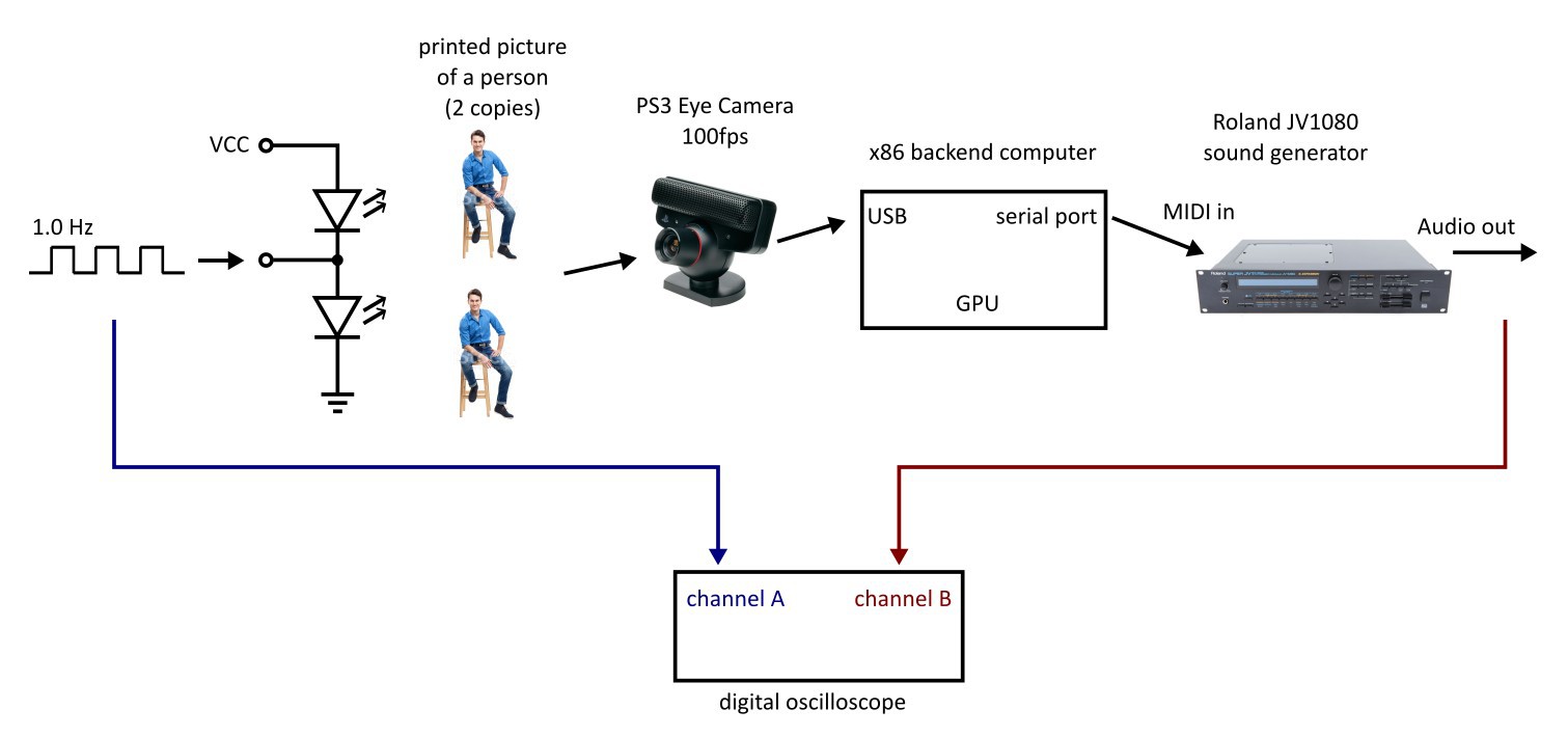

    In this log entry, I present a measurement of the latency of the lalelu_drums system. The measured latency covers the full pipeline from the optical input to the camera, AI pose estimation with the movenet network, signalling a MIDI message via the serial port of the backend and translating this MIDI message to an audio signal by a Roland JV1080 sound generator.
    The measurement scheme is as follows:
    A 1 Hz square wave signal is used to drive two white LEDs in an alternating fashion. Each LED is used to illuminate a printed picture of a person. The two pictures are presented to the camera of lalelu_drums and the pose estimation system is used to track the coordinate of the nose of the person. The system is programmed to output a MIDI "NOTE ON" message whenever the nose moves from the left half of the camera frame to the right half. The MIDI message is transferred to a sound generator. An oscilloscope is used to determine the delay between the switching of the LEDs and the appearance of the audio signal at the output of the sound generator.
    The video shows the course of the measurement. It can be seen that the average latency is approximately 20ms. The variation in the measured latency of +/-5ms is expected due to the exposure time of the camera of 10ms.
    This measurement does not cover the application of puredata to generate the audio output (see Log #15: puredata). I plan to investigate the latency of the puredata setup in a later log entry.
