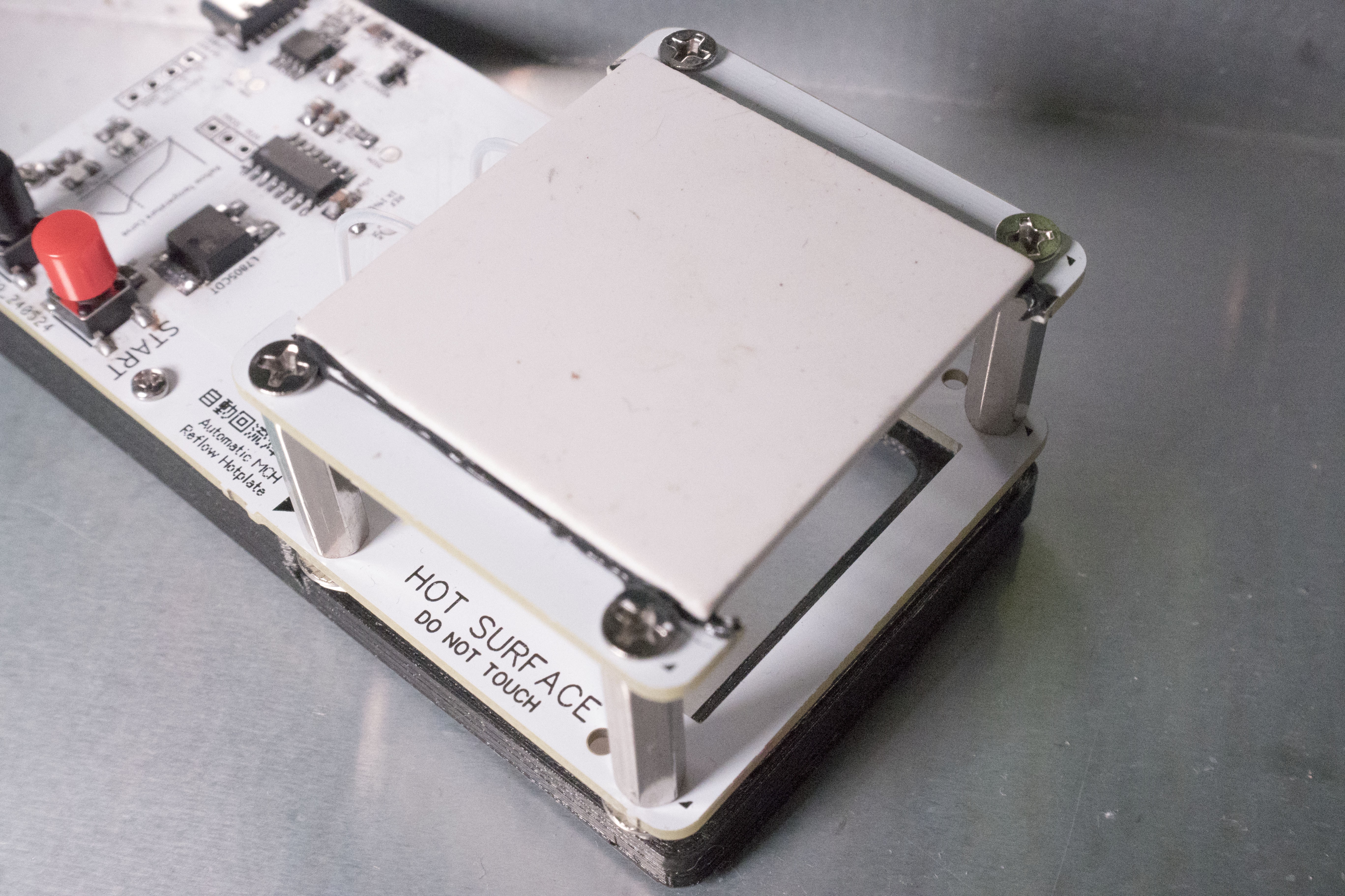

This is probably the first open source USB-PD powered MCH hotplate on the internet, even featuring the automatic reflow profile for Sn63Pb37 but not other specific solder paste design for low temperature reflowing.

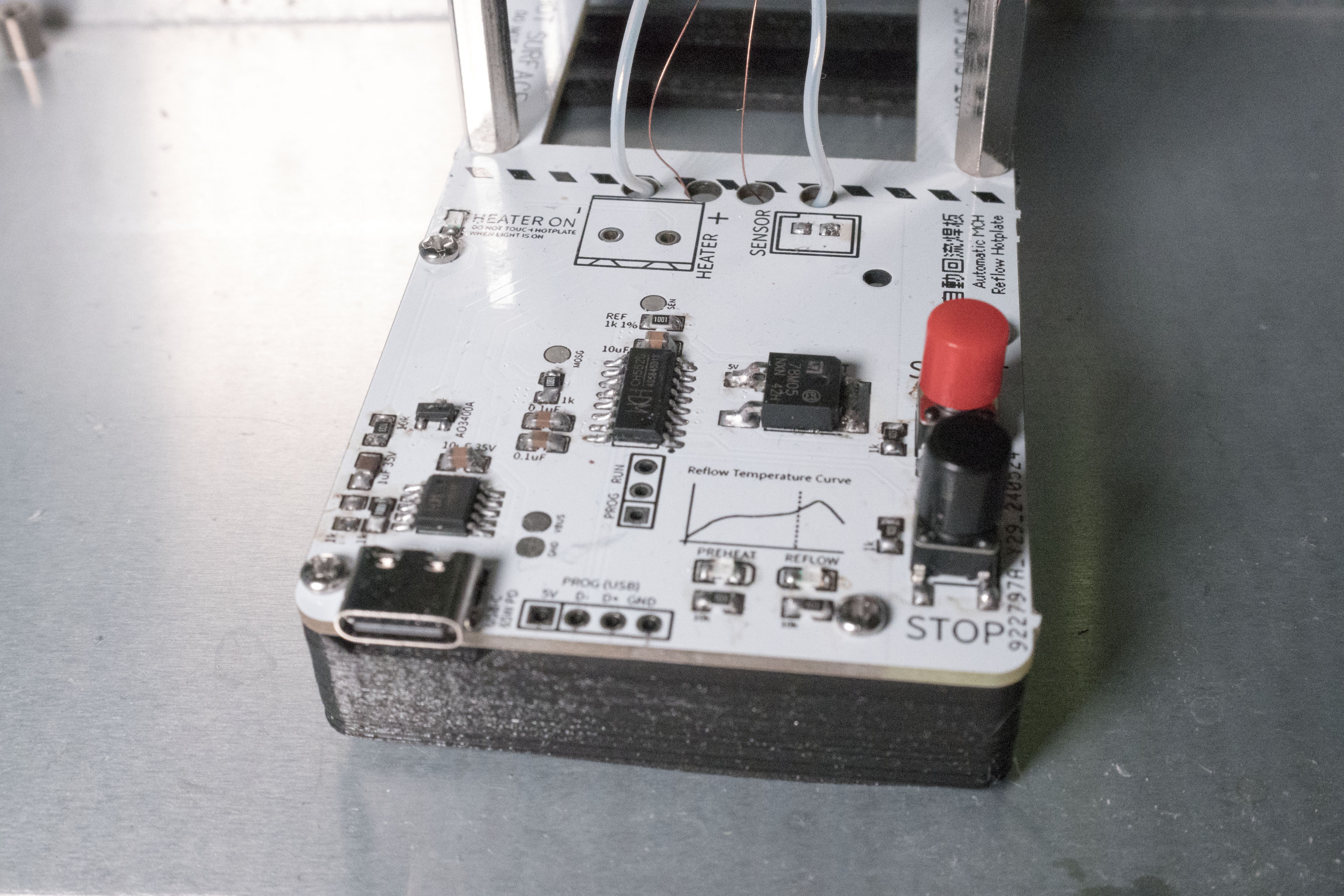

The issue is that MCH hotplate is a bit tricky to get and finding one with specific specification always require custom made. This design factors in the difficult of souring such components and design the hotplate components to be swap-able with a PCB hotplate or MCH hotplate with different spec. Just change a few lines of code in the firmware to control the power switching frequency (and hence, adjusting the power to the hotplate), this PCB design basically fits most of the heating element you can find online with suitable sizes and power rating.

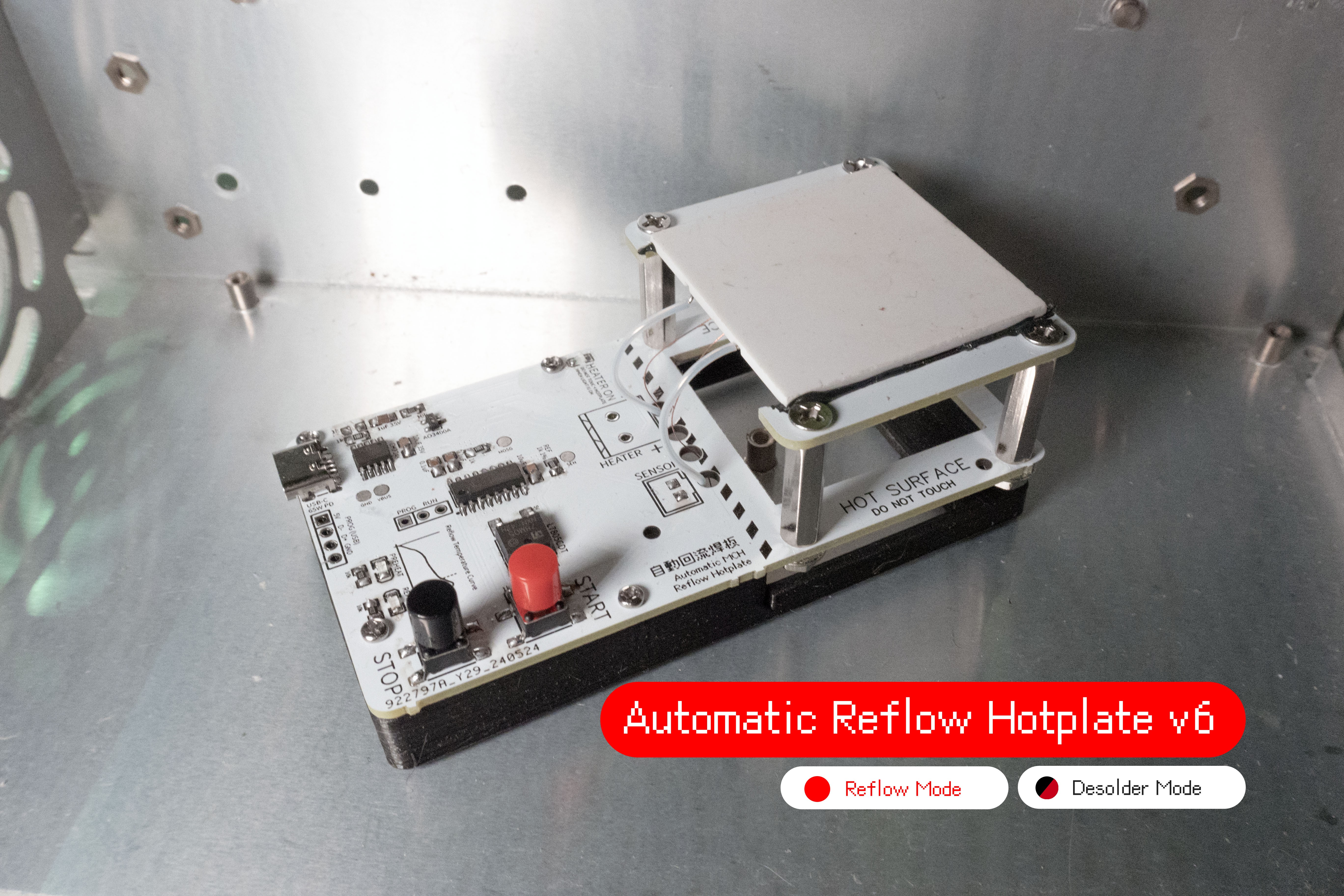

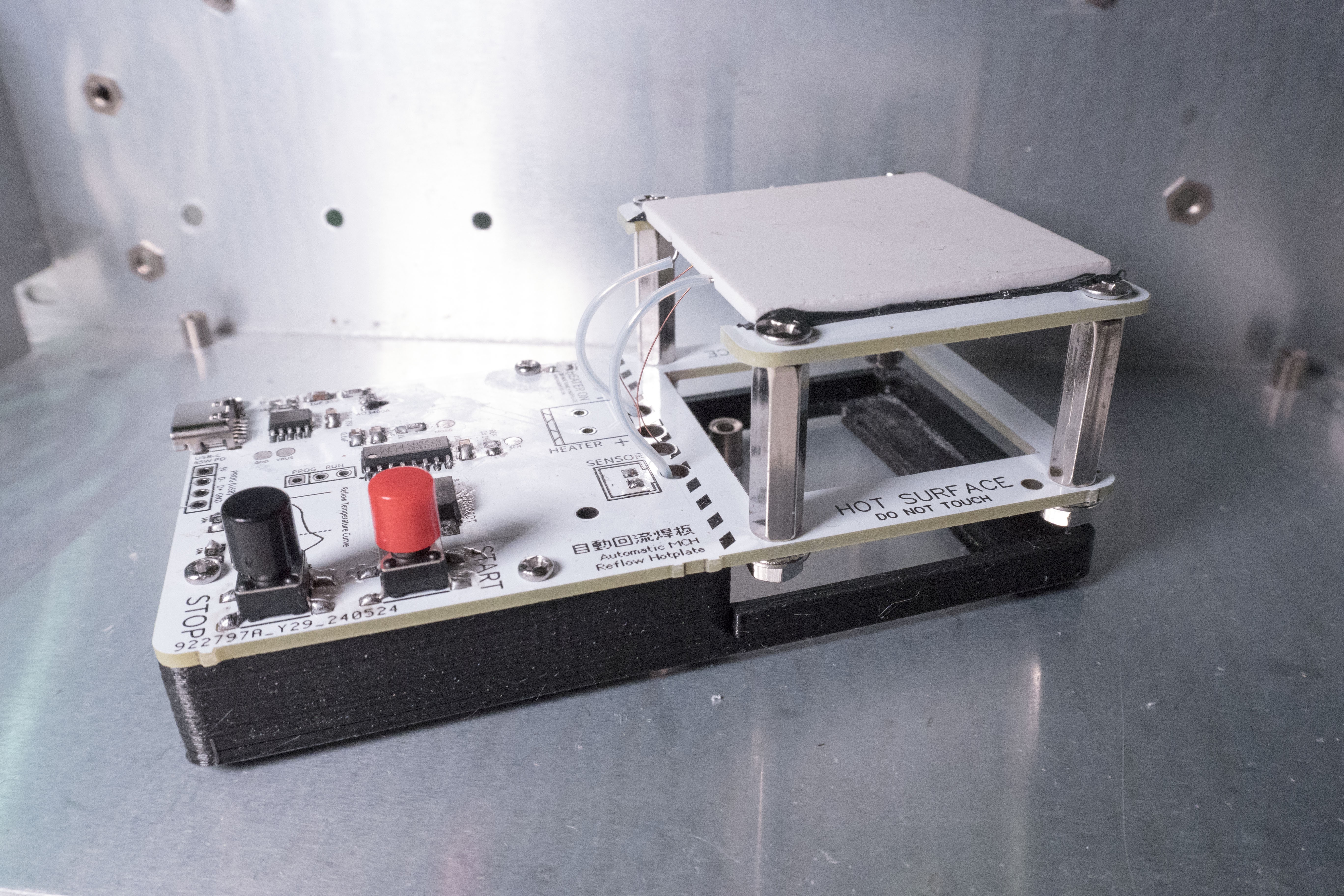

  • Introducing the v6 / v7 65W Reflow Hotplate!
    tobychui07/21/2024 at 02:54 0 comments
    After a few more revisions of the hotplate, I finally get this perfected!
    The new v6 hotplates replaces the touch button for a physical buttons so it is more tactile when working with messy workspace. The major differences from the previous version is that
    • Support reflowing PCB larger than hotplate size
    • Much higher power (60 - 65W) with a new custom ordered MCH module
    • Added desolder mode, so you can rework damaged PCBs and extract components
    • Uses non-copper plated FR4 for support structure instead of MDF wrapped in Kapton tape and insulation layers
    • Updated the PD trigger IC to CH224K to support more modern PD power supply protocol
    • while keeping the cost identical as the old revision!

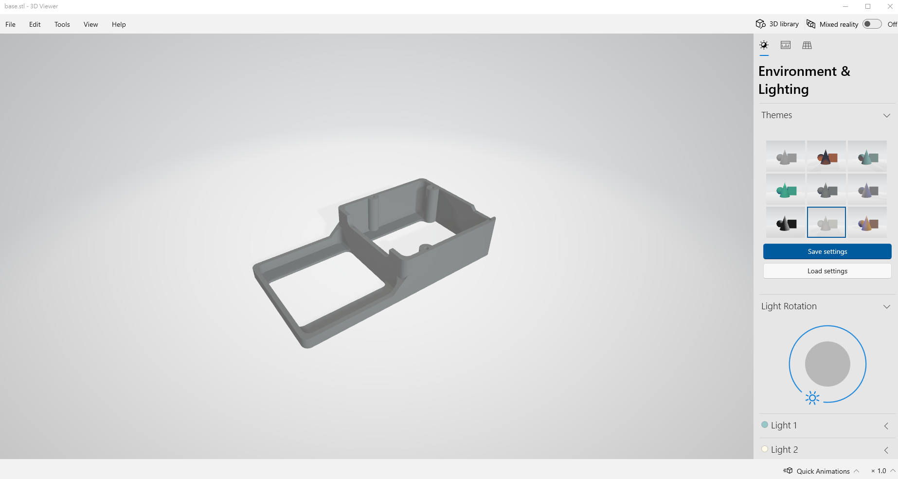

    3D Print the Mounting Base
    First you can start by 3D printing the base. It is a simple step. Just get the stl file, slice it and send it to a 3D printer.

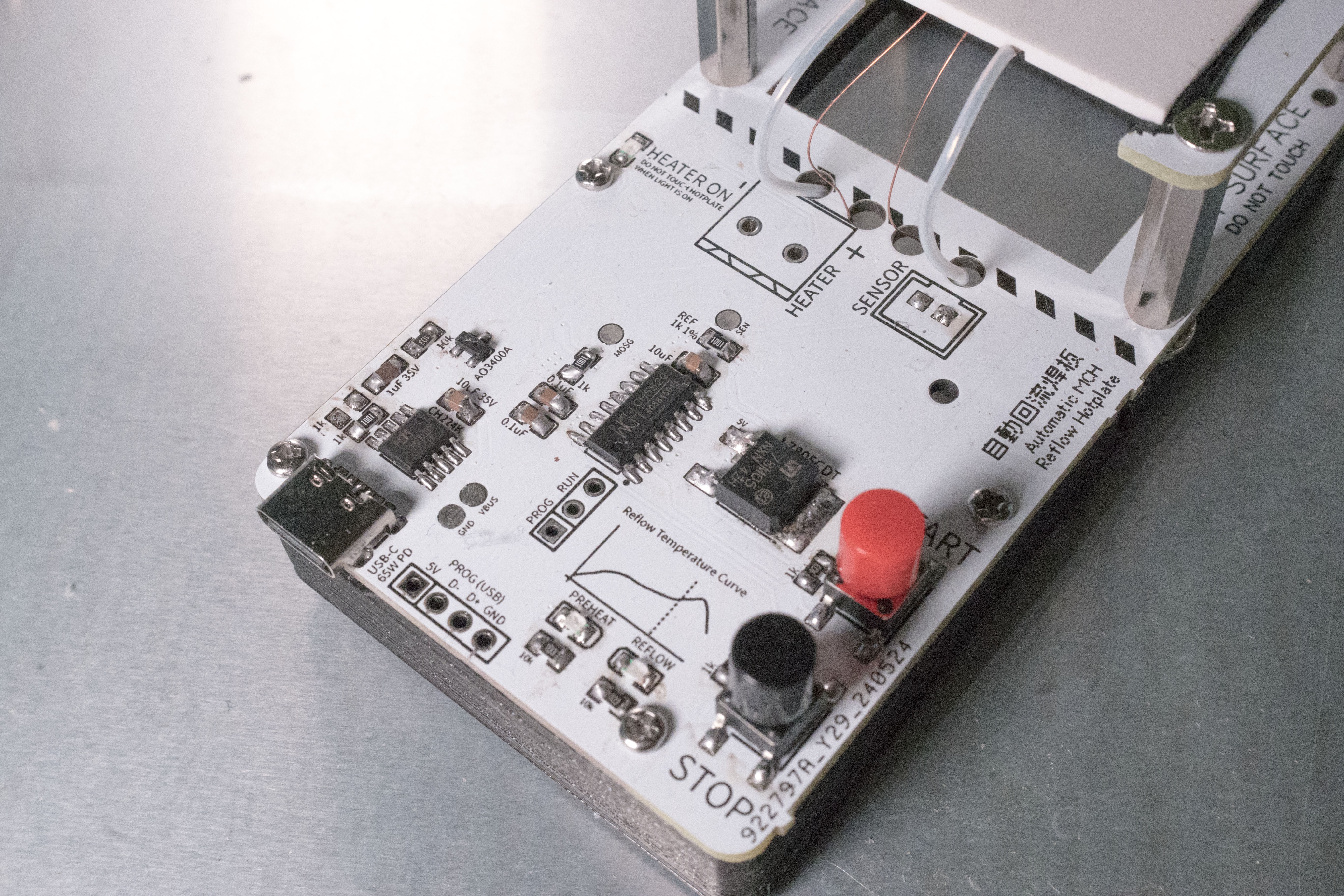

  • 2
    Send the PCB to Print
    As the PCB is the main component of this build, you can order your PCB at any PCB manufacturer you preferred. This project is sponsored by JLCPCB. If you have never tried to order a PCB before, please feel free to try out JLC services with the link below.
    https://jlcpcb.com/
    In my case, as the MOQ of the MCH hot-plate is 50 pcs, so I order a bunch of them from JLC so that I could make a few more of them and give them away with only the material costs.
    You can find everything you need for the PCB over here on my github repo.

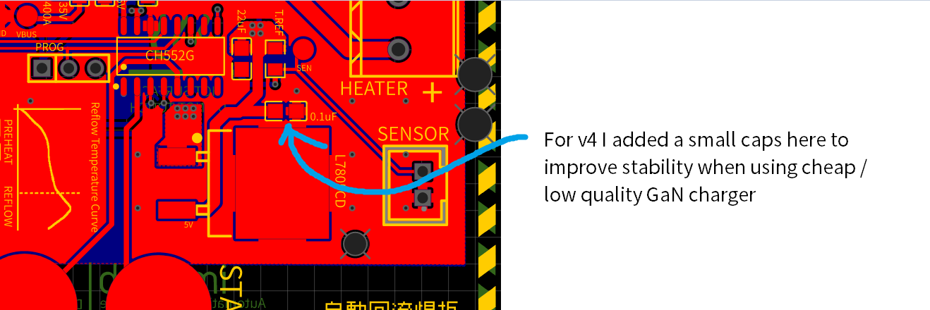

    https://github.com/tobychui/MCH-PD-Automatic-Reflow-Hotplate/tree/main/pcbSide Note
     I am using the v3 design but later I found that adding a small 0.1uF caps over the output of the L7805 improve the overall stability when using cheap / low quality GaN charger with large ripples. This is optional but I recommend adding it if you are making one for yourself.

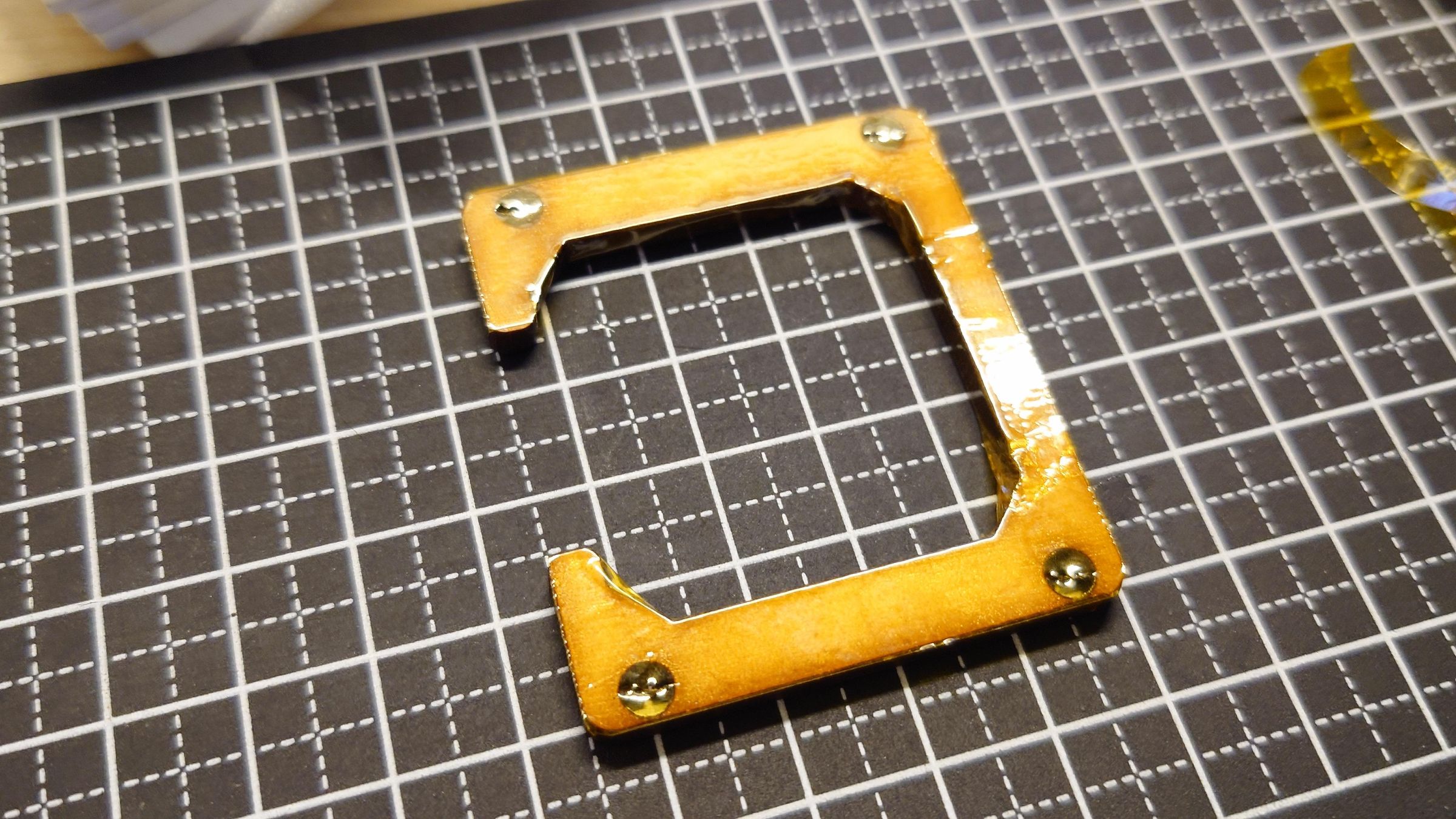

    Laser Cut the Hot-plate Support Structure
    The hotplate support structure is a piece of 3mm MDF that is wrapped in Kapton tape. This prevent the MDF from smoking and turning black after long period of uses.
