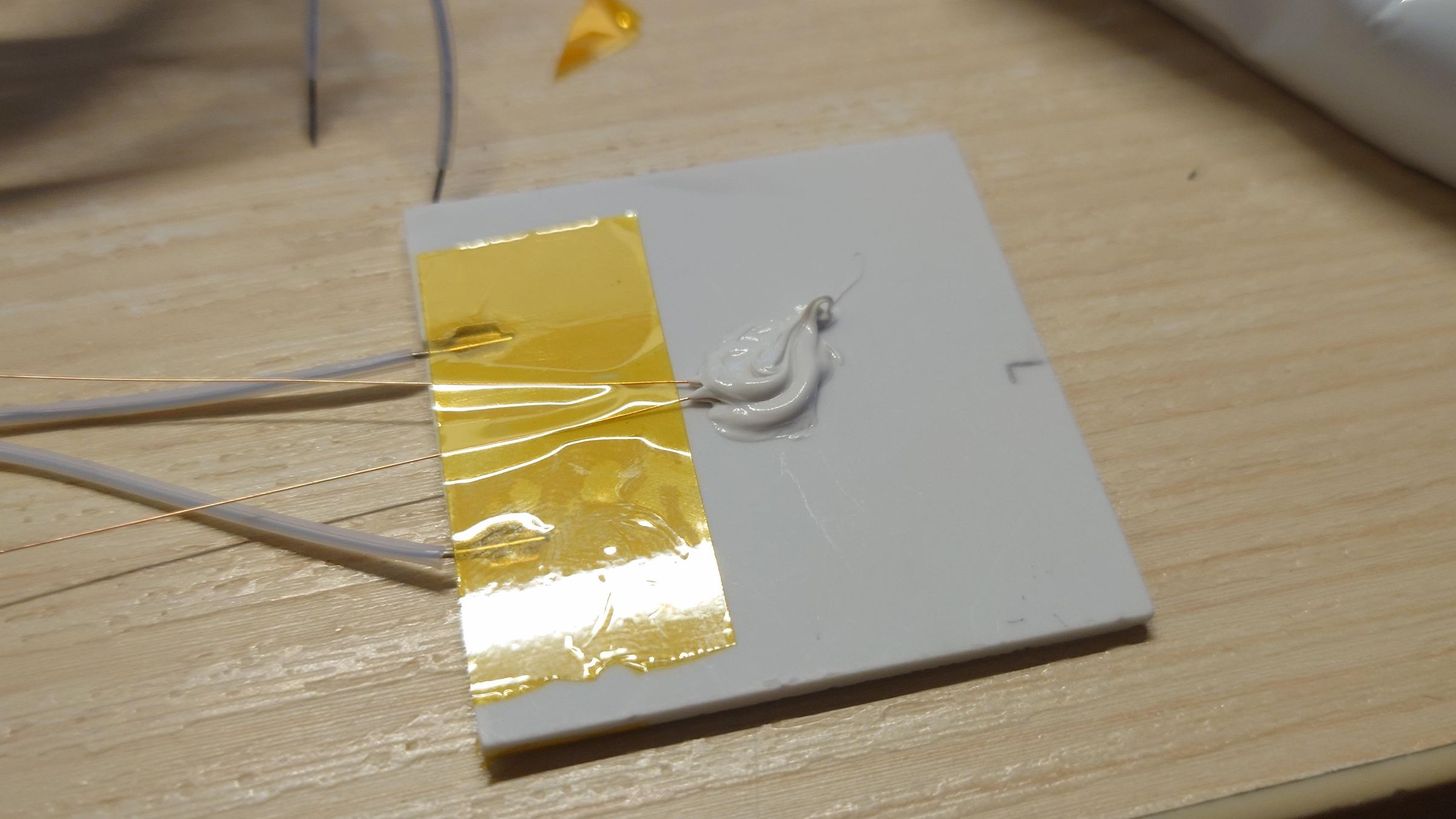

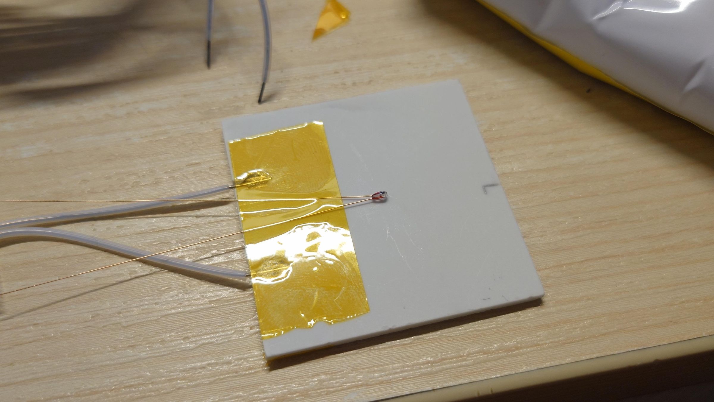

The temperature sensor (glass bulb part only) is glue to the back of the MCH hot-plate with heat-sink adhesive. Note that there are a lot of S922 heat sink adhesive clone out there that cannot handle the temperature stated in its datasheet. So make sure you get them from a seller with good reputation.
You will want to place the thermistor on the bottom side of the MCH and fix it in place with a piece of Kapton tape. Next, slightly bend the glass bulb so it is touching the surface of the MCH. Finally seal if off with a glob of heat sink adhesive.

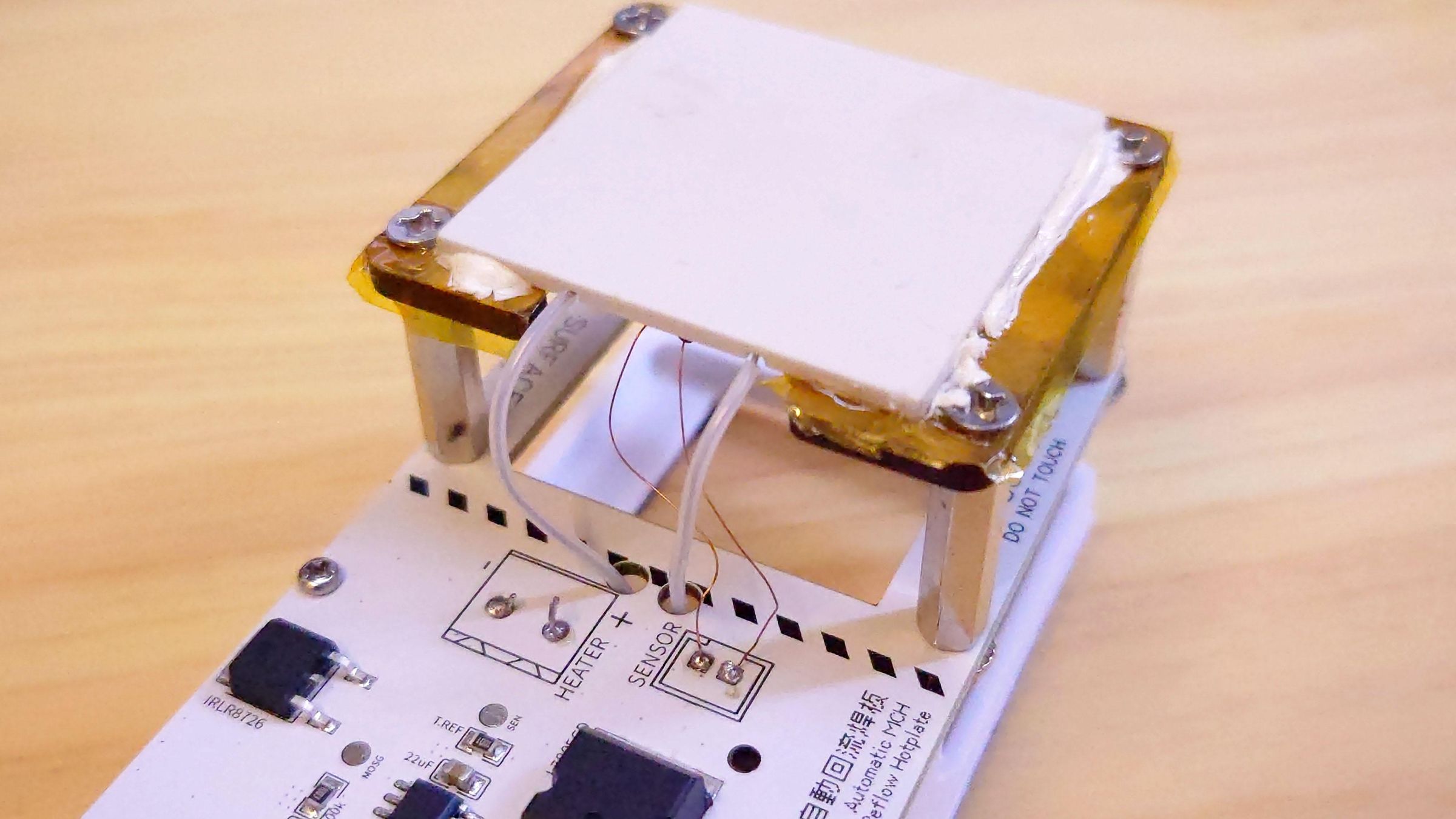

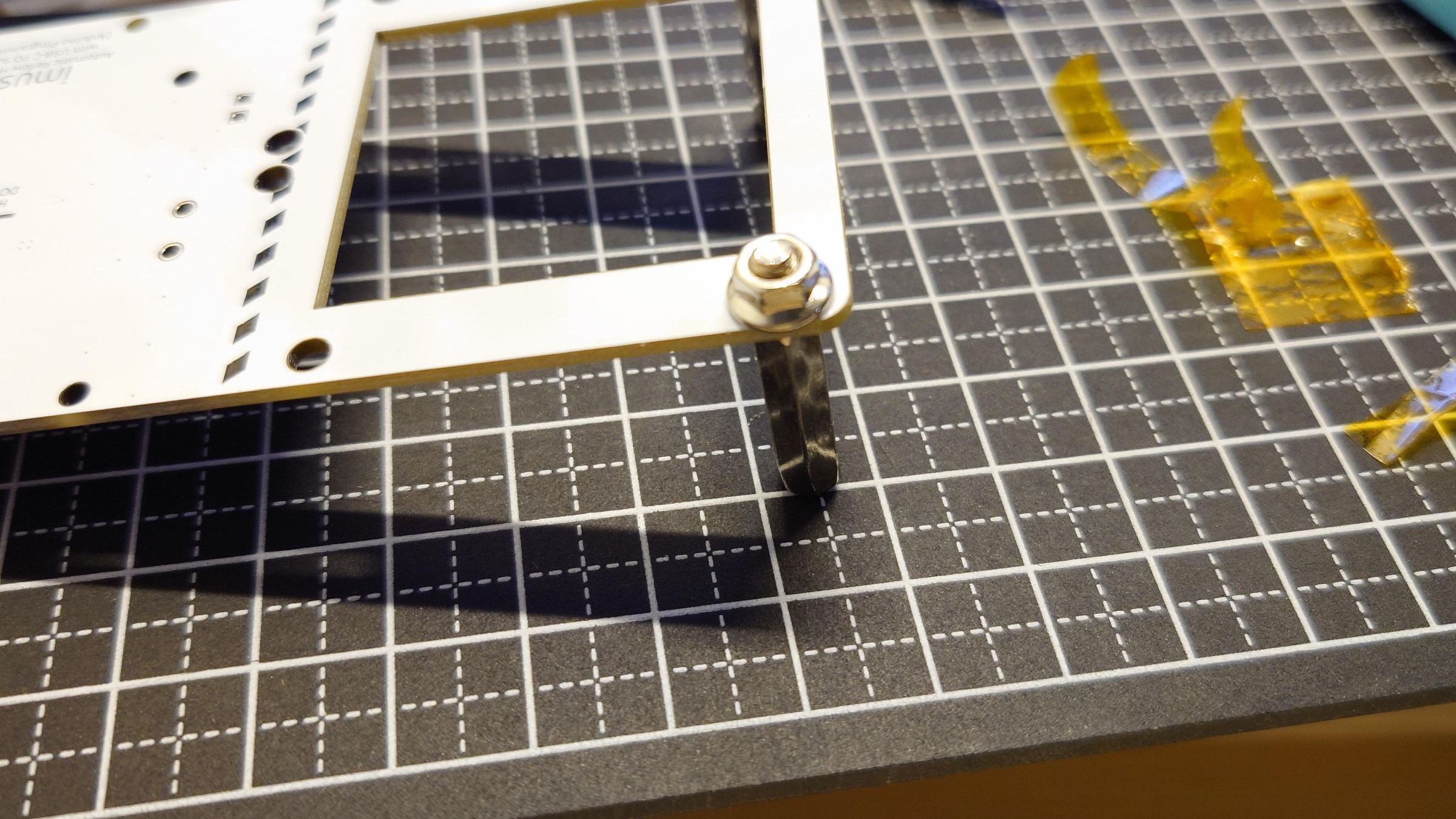

5Assemble the Heater Support Structure
Screw the 4 M3 stands off into the PCB and secure them with M3 nuts. Next, fix the MDF heater support structure on top of the stand offs. Make sure not to screw it too tight and leave some space for the thermal expansion.
After complete, you will see something like this as shown in the photo below..![]()

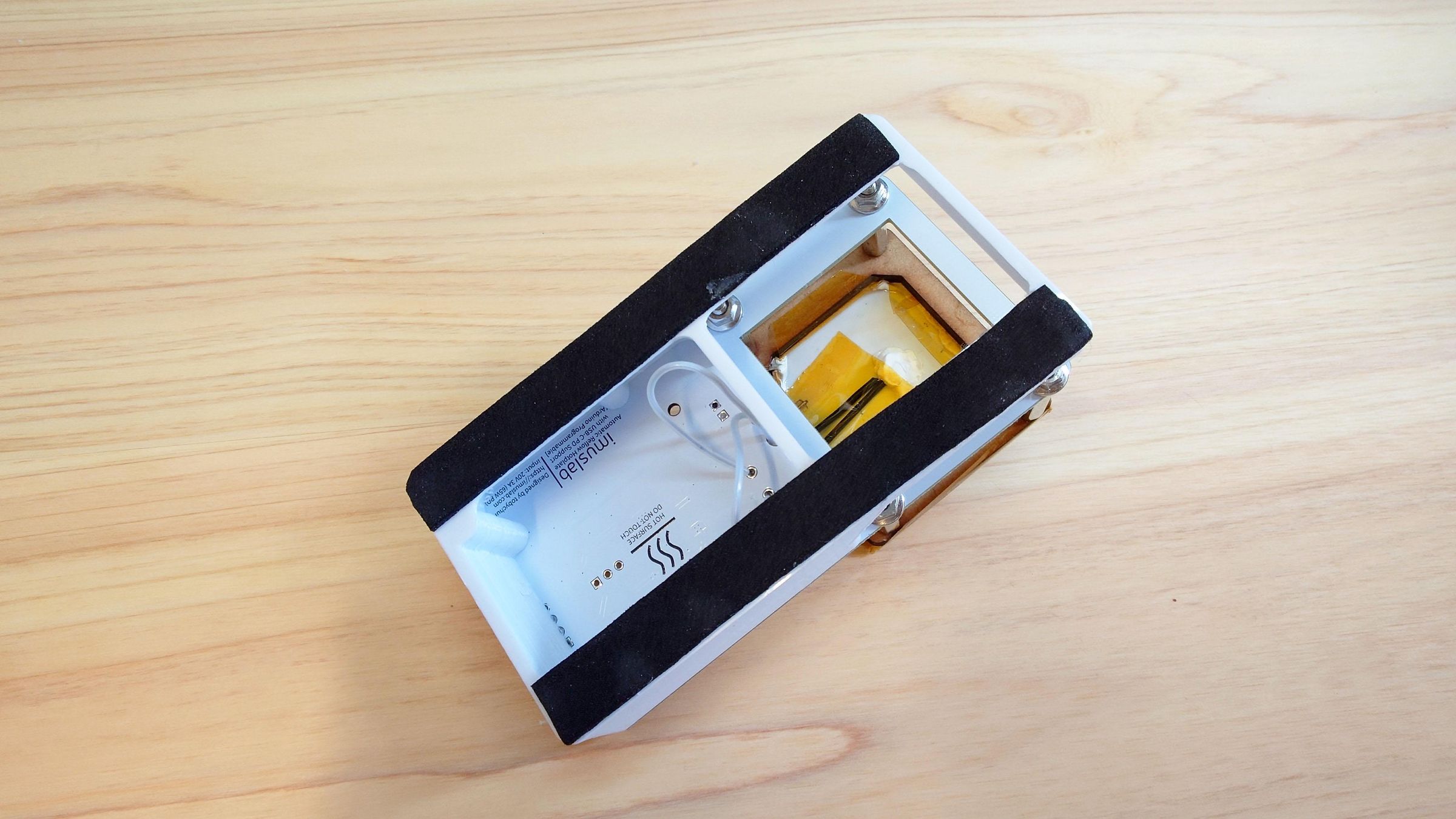

9Thermal Testing
In order to test the hotplate, screw the base to the PCB assembly and stick a temperature sensor to the surface of the hotplate with Kapton tape.
Press and hold the "START" button to start reflowing. The yellow LED should start fast blinking indicating the reflow will start in a few seconds.
For detail usage guide, see here
If everything is working, the temperature will peak at around 235 - 245 degree Celsius when the hotplate entered reflow stage. Note that the temperature on the hotplate is slightly hotter than what is recommended by the reflow profile as it is not a reflow oven but an open-air hotplate which I need to accounts for thermal lost to surrounding.
If the reflow seems completed, you can always early-stop the hotplate by pressing the "STOP" button.
