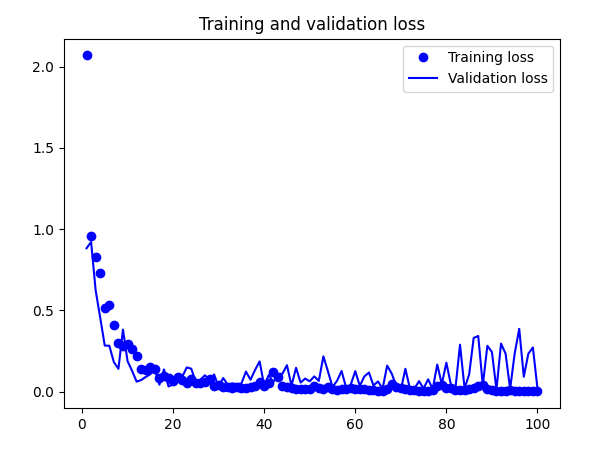

I wanted to come back to the topic of overfitting, which can cause many troubles when working on a model. Very often, while observing the training progress - we may see a beautiful curve of training and accuracy that reaches 1 very quickly and stays there. At the same time - the training loss gets very close to 0. Such graphs may lead to a false impression that we have created an excellent neural network.
Unfortunately that is too good to be true. If we look at the validation graphs instead, it doesn't seem so great anymore - the accuracy and loss lag way behind and achieve worse performance.
What actually happens is that the neural network becomes too specialized, learns the training set too well, that it fails to generalize on the unseen data.
And that is overfitting in a nutshell. There are various ways to fight that.

On the graphs below you can se the effect of adding a dropout: - the the validation loss follows the curve of training loss; the training accuracy doesn't reach immediately 1 and validation accuracy follows the training one.
In my project I use dropout on fully connected layers, I will further increase the dataset, use data augmentation, try out transfer learning.

When the training is done, I want to observe the basic metrics:
# Extract accuracy and loss values (in list form) from the history
acc = history.history['accuracy']
val_acc = history.history['val_accuracy']
loss = history.history['loss']
val_loss = history.history['val_loss']
# Create a list of epoch numbers
epochs = range(1, len(acc) + 1)
# Plot training and validation loss values over time
plt.figure()
plt.plot(epochs, loss, color='blue', marker='.', label='Training loss')
plt.plot(epochs, val_loss, color='orange', marker='.', label='Validation loss')
plt.title('Training and validation loss')
plt.legend()
# Plot training and validation accuracies over time
plt.figure()
plt.plot(epochs, acc, color='blue', marker='.', label='Training acc')
plt.plot(epochs, val_acc, color='orange', marker='.', label='Validation acc')
plt.title('Training and validation accuracy')
plt.legend()
plt.show()
Obviously we would like that validation accuracy follows closely accuracy on the training set, similarly the validation loss shall follow loss on the training set. Of course the validation set will perform worse, but we don't want them to fall too far apart.
