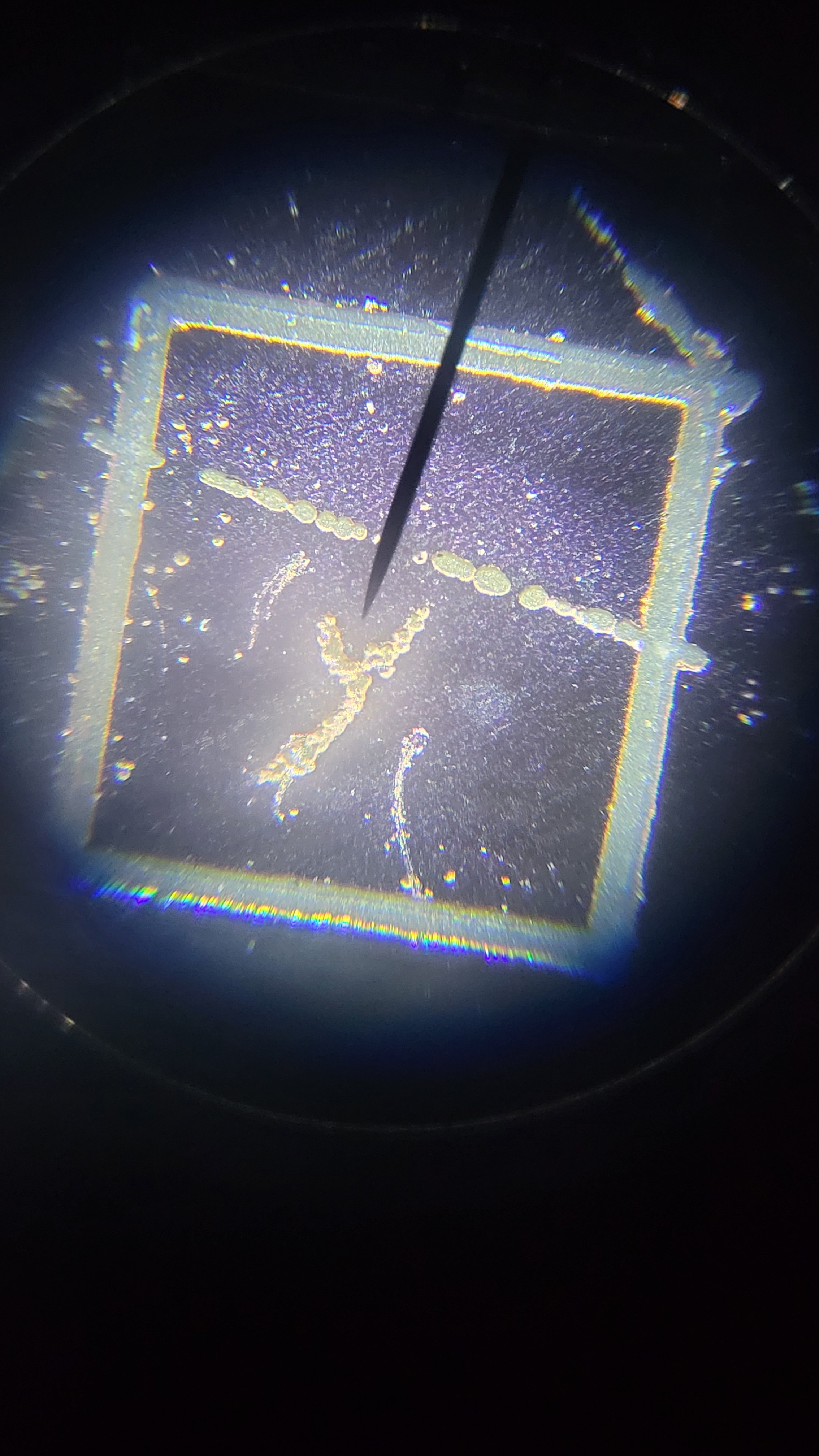

Here example of 3x3mm square using 1W IR laser and drop of ferric chloride under the microscope. (Ferric chloride is already washed away)
I would try different parameters but this project is definitely done!

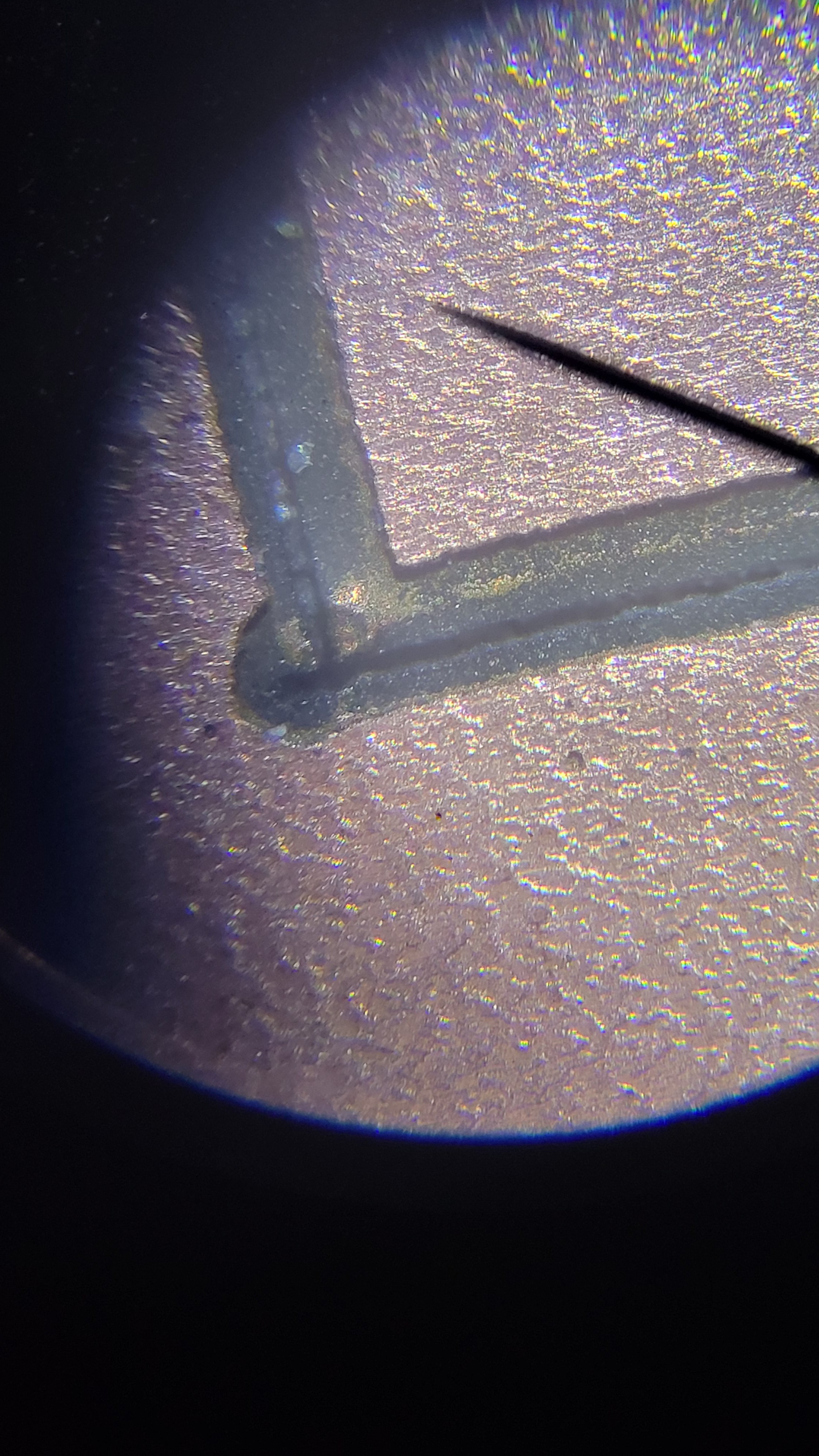

I thought it would be a good idea to measure the groove
It's less than 0.2mm which is very good for that price.
Also, 0.03 groove of laser beam can be seen

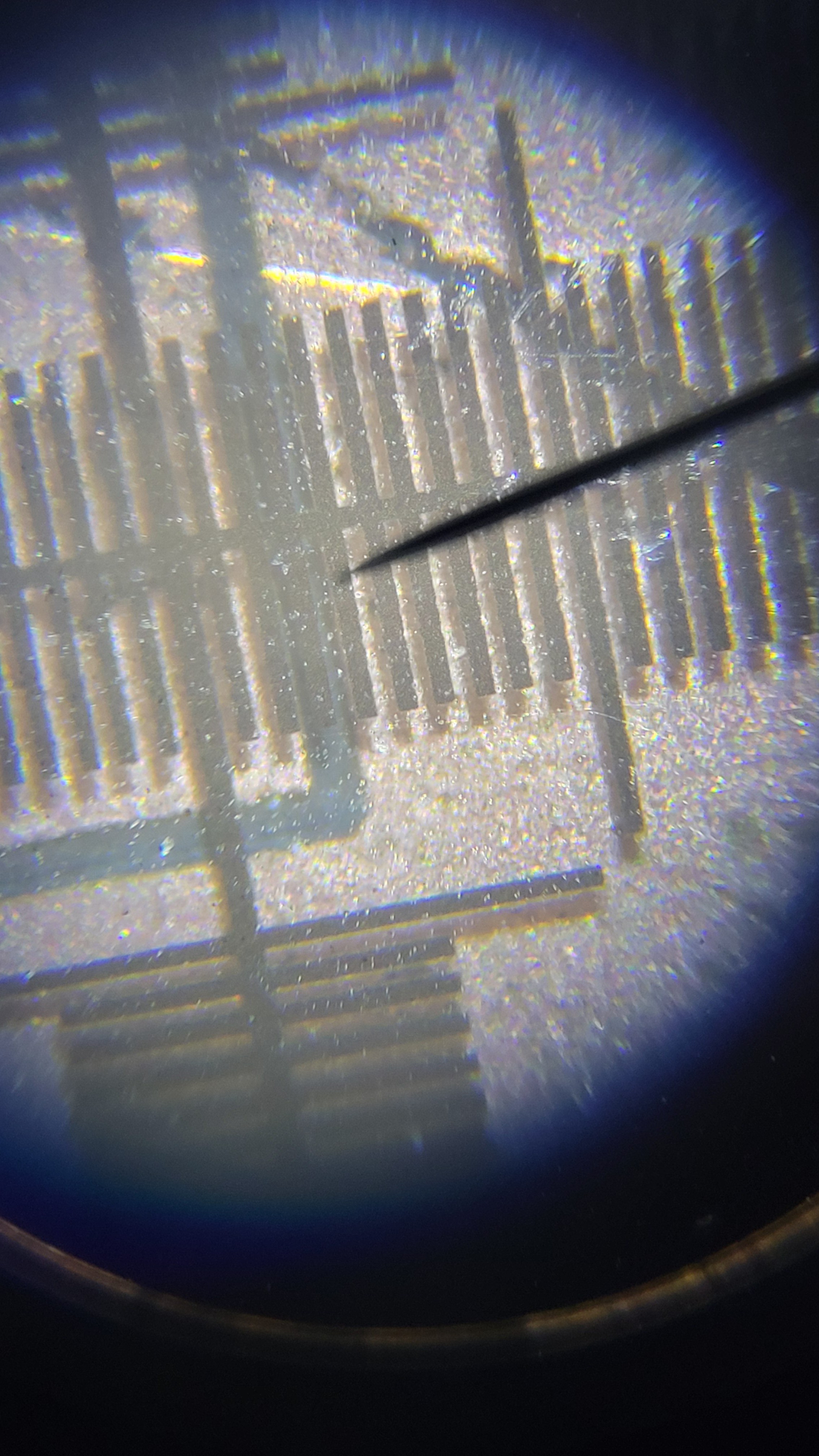

Although the results was good enough I had a feeling that it can be improved. I heard that some people use laser. So I've tried myself standard 0.5mm pitch
Let's look under the microscope
No broken bits no height map. I've tried to run laser at full power and see if it will etch the PCB but the fumes was terrible.

Now let's see the quality...
We got quality that hard to get with CNC even with 0.1mm bit.
It's my first attempt, no need for height map adjustment.
