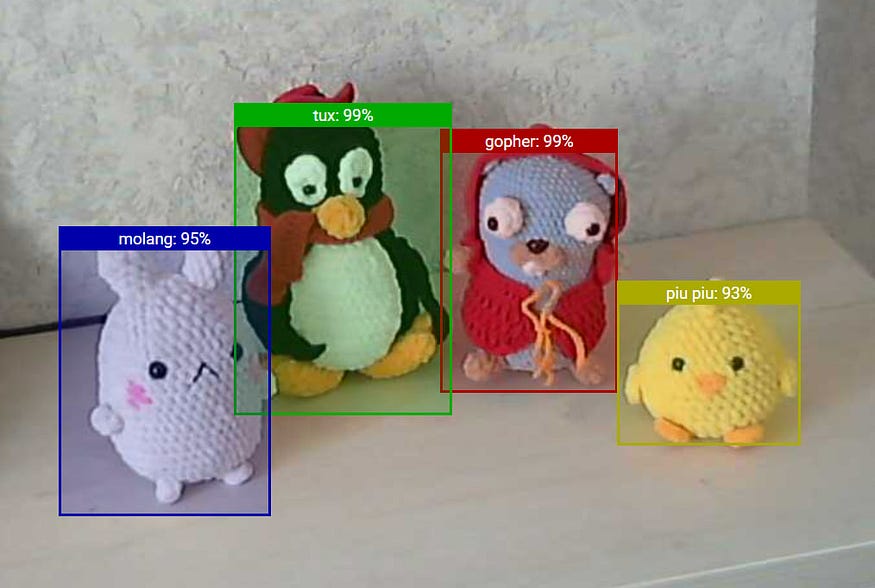

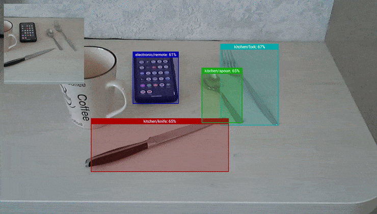

And… after quite some time, I finally managed to finish my image_classification and object_detection examples of how to test mobileNetV1 and ssdLite-mobDet models (precompiled by TI) with TFlite runtime using the libtidl_tfl_delegate.so. The inference can be observed through classification.html and detection.html respectively in browser from any machine in local network as MJPEG stream:
make build-image-classification-tflite make build-object-detection-tflite make run-image-classification-tflite make run-object-detection-tflite

And after more copy-pasting and “dependency managing” I made my version of compilation scripts as well as edgeai-tidl-tools.Dockerfile to build everything within one machine. So finally I can get my desirable object detection performance of ≈6.5ms per frame using Go:
make train-image-classification make train-object-detection make build-edgeai-tidl-tools-docker-container ...Read more »
