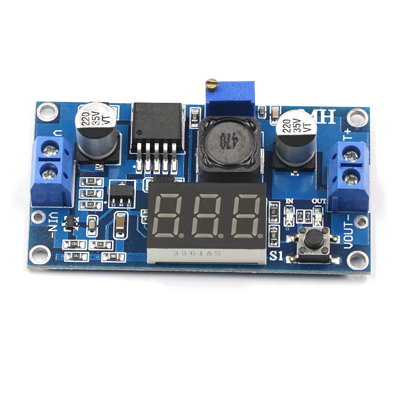

Hackable DC/DC Converters
A quick search for "LM2596 DC 4.0-40 to 1.3-37V Adjustable Step-Down" on AliExpress presents a range of cheap DC/DC converters with voltmeter from $1.50. I discovered that the voltmeter uses a STM8S003F3P6, the low-cost µC that's the target of my first Hackaday project. The first specimen I hacked didn't have the most promising hardware design: it was necessary to solder patch wires to pins of a 0.65mm TSSOP package *).
The second one I ordered looked like this:
The first obvious thing, already visible on the vendor's pictures, is that the 7S-LED display nicely covers the voltmeter part including all the passive components.
*) Of course, it's still possible to remove the 7S-LED display, and use the pin as a breakout for no less than 11 GPIOs!
Under the Hood
Underneath the LED display we find this nice arrangement:
The LM317 in TO92 package is directly connected to the voltage divider R4/R3 (the LM317 lacks the recommended capacitor Cout, Cin is shared with the LM2596). C13 is connected to Vcap (STM8 1.8V core supply circuit). R1/R2-C4 and R8/R9-C5 are the "voltmeter inputs" (PC4 Vin, and PD3 Vout). R5 is connected to the green power LED.
PC3 is connected to LED "in", and PB4 to LED "out" without current limiting resistor (the same as the 7S-LED display). Like in the first variant, the "design" relies on the limited current driving capability, and on the surprising robustness of the STM8S outputs. The LED power dissipation is limited by a 4% duty cycle (there is a small risk of accelerated aging).
Isn't there anything else missing? Yes, a bypass capacitor for the STM8S003F3P6! A 100nF capacitor should be added to prevent communication errors (see instructions). Any doubts about the robustness of the STM8S are unfounded: it will tolerate circuit bending practices on a mass production scale ;-)
I first assumed that the GPIOs used for the 7S-LED display are the same as in the first variant, but they're not (the STM8S003F3P6 is rotated by 90º).
The LEDs "in" and "out" are now connected to dedicated GPIOs (which is good for us), but the keys still share a GPIO with LED segments like in a 70s pocket calculator (PC5/SegE and PD2/SegG). It would have been really easy to use PB5 for reading the keys but well ...

    Prepare the board:
    1. remove LED "IN"
    2. remove LED "OUT"
    3. interrupt the connection between LM2596 pin 5 (!ON/OFF) and GND (i.e. cut the pin in the middle, and de-solder the lower half)
    4. carefully cut the copper trace between the LM2596 heat sink GND and the 330R next to the trimmer.
    5. cut the copper trace between LM317 pin2 and anode pad of LED "IN". Expose some of the copper of the trace near said pad.
  • 2
    Step 2
    Add new components:
    1. solder a C 100nF between LM317 pin 2 and GND on the backside of the PCB
    2. solder a 10µF ceramics capacitor 0603 or 0805 over the now cut copper trace between the LM2596 heat sink GND and the adjacent pad of the 330R next to the trimmer
    3. solder a 47R 0805 resistor to the pads of LED "IN"
    4. solder a 1k8 0805 resistor to the pads of LED "OUT"
  • 3
    Step 3
    Make new connections for controlling the LM2596:
    1. add a wire between the cathode pad of LED "OUT" (PB4) and LM2596 pin 5
    2. add a wire between the copper trace near the anode pad of LED "IN" (PC3) to the 330R pad, where also the 10µF capacitor is connected
    3. connect (pin 2 || pin 3) of the trimmer to pin 1 of the voltage adjust trimmer on the board
View all 6 instructions

Elliot Williams wrote 04/10/2017 at 19:10 point
I love the idea of a simple/cheap programmable power supply as a demo project for your Fortheries, so I ordered two of these things a few weeks ago.  As luck would have it, I got the "first variant" versions of the boards (or maybe something else, who knows?).
To anyone following along: the big difference in board appearance is that the "first variant" board has more discrete components visible -- three resistors next to the TO92 package and two on either side of the display.  Don't get that board if you want to retain the display.
So I popped the display off and soldered some wires on.  Of the SWIM and UART lines, the only one that's not broken out into a through-hole is the NRST, which you may not need.  I gently lifted the pin and fly-wired it anyway.
On my board, the chip needed unlocking, so I ran stm8flash with the -u flag first, and then uploaded a version of Thomas' stm8ef that didn't need to use the half-duplex hack, because without the LED you have clear access to both the TX and RX lines.
So far, so easy.  Next I'm going to hack on Thomas' control routines for the  LM25596.  I'm half tempted to see if some minor code changes can turn this into a solar-cell MPPT device.  We'll see.
Thomas wrote 04/11/2017 at 05:36 point
Hi Elliot, the MPPT idea sounds great!
If you want to continue with the "first DC/DC PCB type", most of what I know about it is described in the log entries below. I also have half-baked code to control the LED display. If necessary I can refactor it to meet the improved "board framework" conventions but as you live in Germany I can also send you one of my a "green" DC/DC boards by mail.
If no LED display is required, an MPPT might also be feasible using plain DC/DC boards, and a STM8S breakout board. So far I didn't find out whether measuring the current is necessary for an optimal MPPT.
Here are log entries on the first DC/DC board variants:
https://hackaday.io/project/16097-eforth-for-cheap-stm8s-gadgets/log/51072-a-dcdc-converter-with-a-voltmeter
https://hackaday.io/project/16097-eforth-for-cheap-stm8s-gadgets/log/51120-more-details-on-lm2596-with-voltmeter
Here is a bit on getting a PWM out of TIM1:
https://hackaday.io/project/19647-low-cost-programmable-power-supply/log/52861-some-progress-and-a-refresh-of-a-lesson-learned
Elliot Williams wrote 04/11/2017 at 08:26 point
Thanks!  I was looking through those links late last night.  And no need to send me a green one -- ebay is already on the case. My impatience costs me only 2€.
Summarizing the voltage control routine to see if I've got it right: you inject an offset voltage into the voltage divider between the output and feedback pins by disconnecting a resistor to ground and replacing ground with a filtered-PWM voltage.
You then look the PWM up in a table?  Why not close the loop on output and vary the PWM until it produces the desired output?  Is it unstable?  Have you tried?  Some combo of the lookup table PWM plus fine-adjustment should get the voltage "accurate" down to the resolution of the ADC.  (Of course, no voltage reference, etc.)
For MPPT: yeah, current is also necessary. But without the LED, I've got a lot of free pins. :)
Thomas wrote 04/11/2017 at 17:05 point
You're of course right in all points:
* injecting an offset lowers the output voltage, but it also reduces the DC/DC control loop gain by a factor of (1-offset/1.25V)
* the lookup table acts as a open-loop-control component for the DC/DC converter's closed-loop-control set-point, and it greatly improves stability and responsiveness of this hack. However, a feedback component can help to reduce the residual control error. I guess that a PID controller would be a good addition, even though the voltmeter resolution is just about 50mV. Also, the lookup-table can be "self-learning".
* Removing the LED-display from any variant of the DC/DC converter turns the display's solder pads into a STM8S003F3 breakout. Who needs a display if the power supply is networked and automated, and the visualization (if needed) can be done with a central "dashboard"? Really a smart idea!
EDIT: the Wiki page on the CN2596 board now contains some info on STM8S003F3 and LED display connections: https://github.com/TG9541/stm8ef/wiki/Board-CN2596#cn2596-circuit-info
