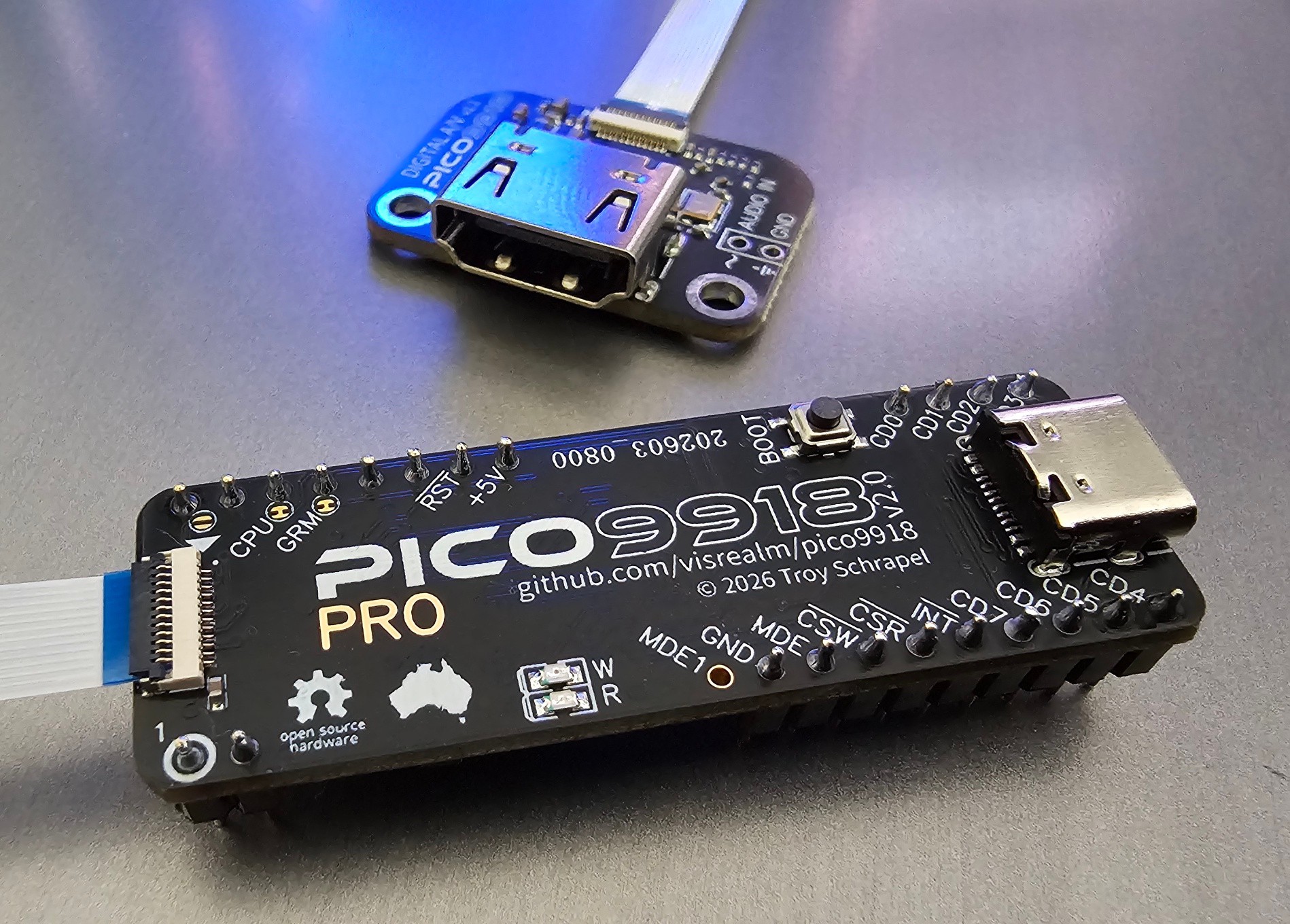

PICO9918 v1.1 is the single board version which doesn't require a piggy-backed Pi Pico. This is the version you can currently buy pre-assembled from Tindie and ArcadeShopper.
v0.3
v0.3 is relatively cheap and easy to build, schematic and gerbers are available. This version makes use of an external Pi Pico module piggy-backed onto the PICO9918 PCB.
