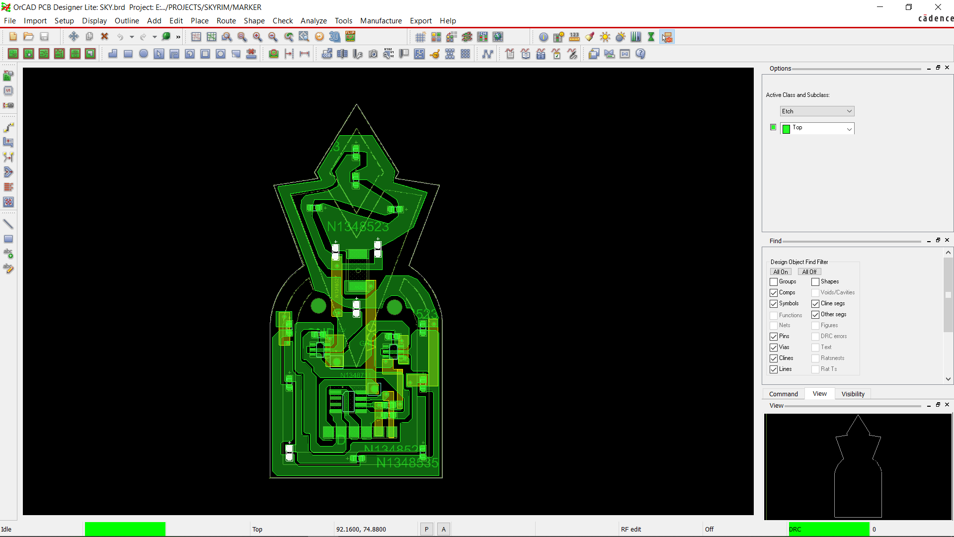

Once the schematic was finished, we imported a picture of the Skyrim Quest marker into the PCB design and used that to position all of the LEDs in the marker's white region in order to prepare the board design. This white space will be used to allow light to flow through by being opened up in other boards.
The microcontroller, resistors, mosfet, and CON6 Pad are placed in the center of the board, close to the marker's black region. Every component will have a slot created for it on the middle layer.
Two 4mm mounting holes were added in order to connect all the layers together. We can line up all of the layers consistently by stacking them on top of one another and aligning the two holes. Since the interior of these holes, will be plated, we can then use solder wire to join the layers together.
We connected all component tracks together in the right order and finalized the board.

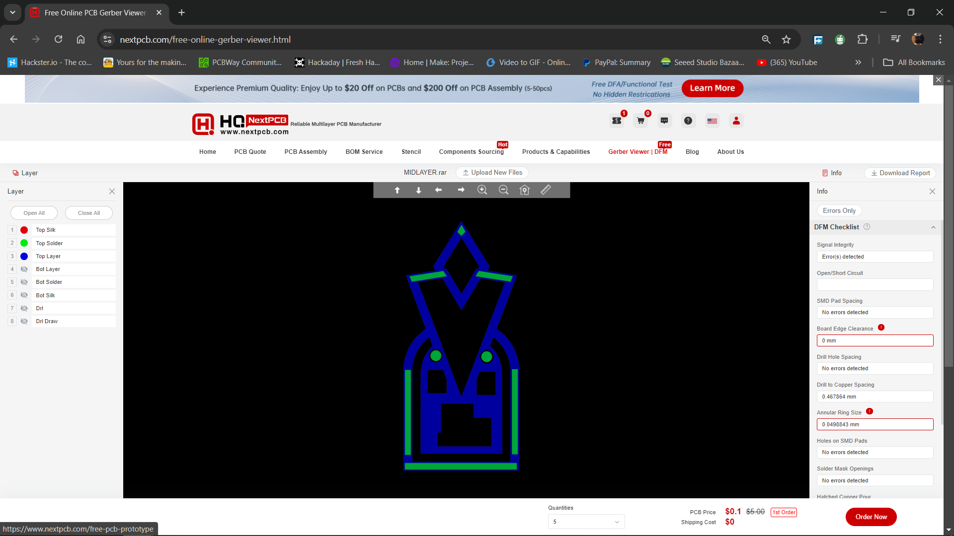

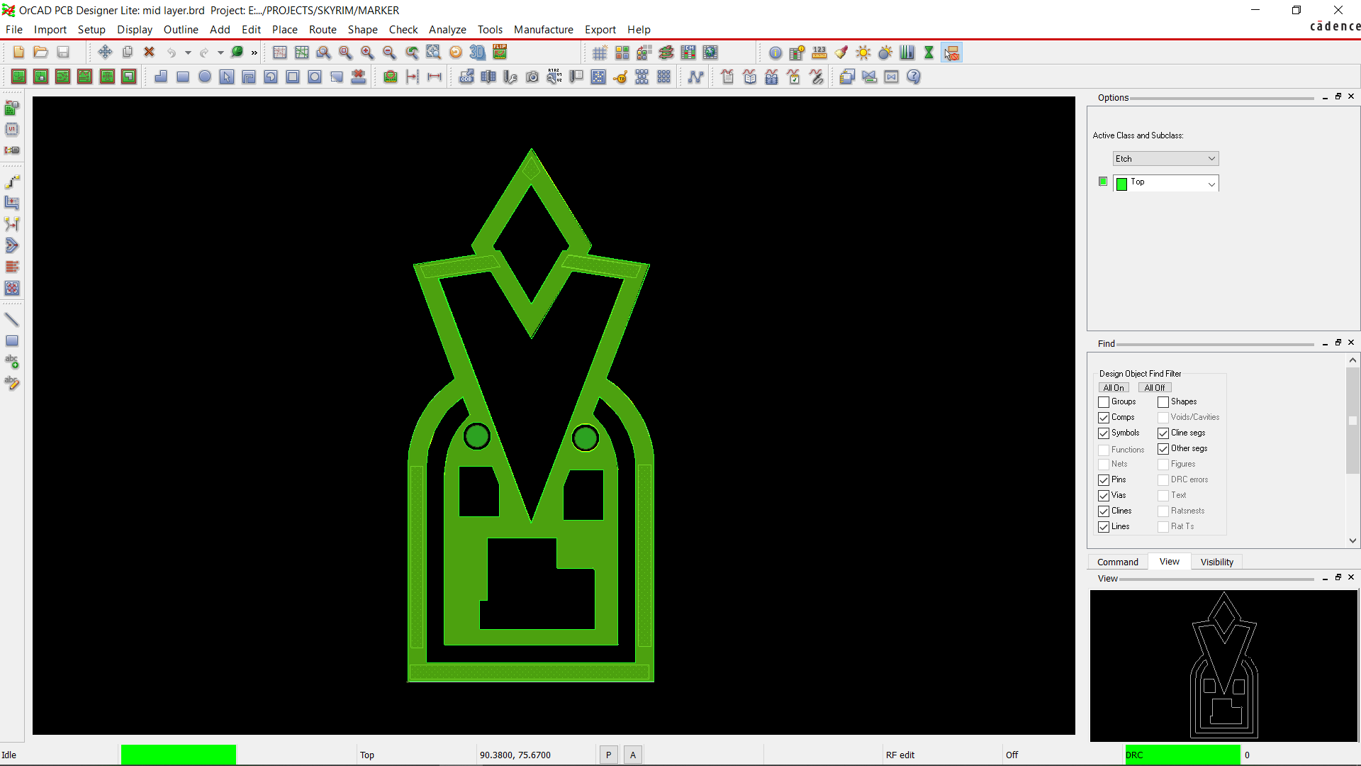

Reusing the Skyrim Quest marker image from the bottom layer board, we first prepare the Mid Layer board, which had multiple slots and openings.
The board slot layer was used to completely open the white area in the image, which is where the LEDs will be placed.
A few slots have been added to the middle, where the microcontroller, resistors, and Mosfet IC are located, so that the Mid Layer board can be positioned on top of the bottom layer without coming into contact with the components.

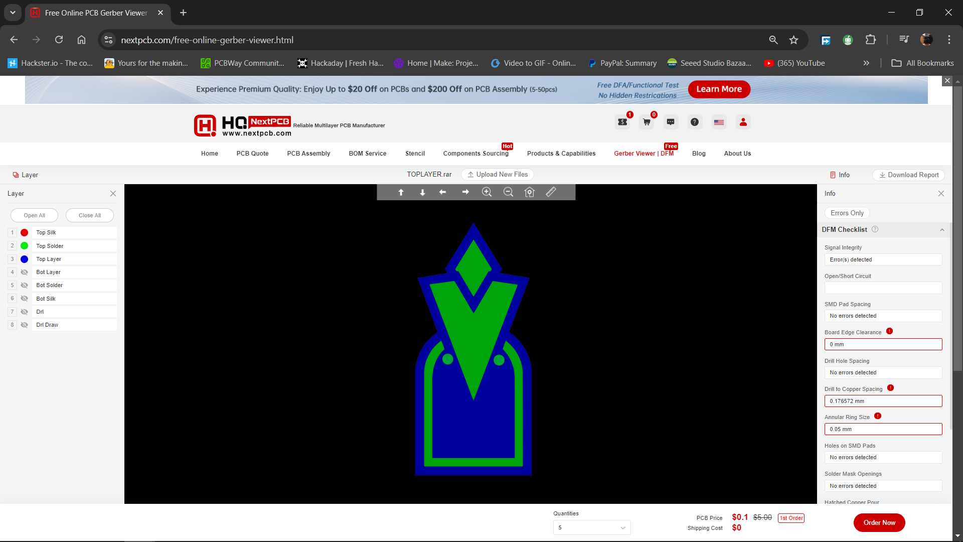

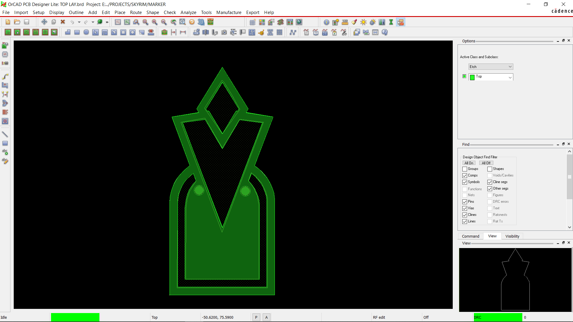

On the top board, we added solder mask openings in both the top and bottom layers, which will allow the light to pass through the FR4 material.

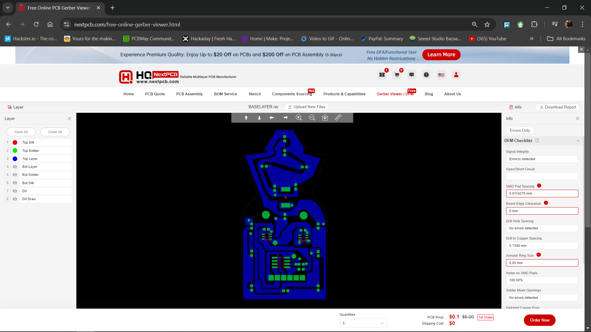

In addition, I have to bring in HQDFM to you, which helped me a lot through many projects. Huaqiu’s in-house engineers developed the free Design for Manufacturing software, HQDFM, revolutionizing how PCB designers visualize and verify their designs.
HQDFM: Free Online Gerber Viewer and DFM Analysis Tool
Also, NextPCB has its own Gerber Viewer and DFM analysis software.
Your designs are improved by their HQDFM...
