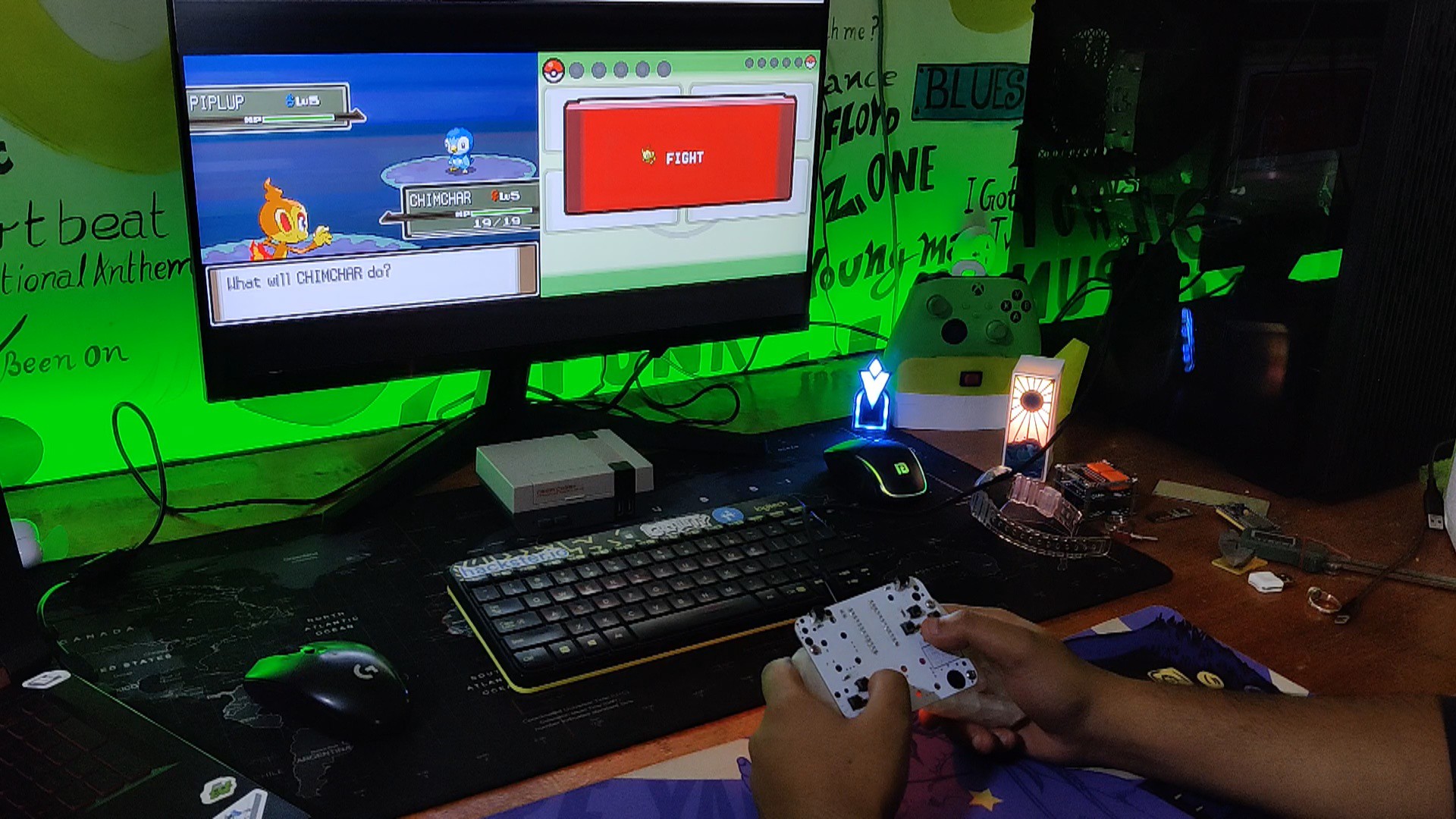

Result
The result of this little project is a functional game controller that can be used to play retro games that do not need analog thumbsticks.
Using a PC NDS emulator, we launched Pokémon Platinum, one of the best Pokémon games ever made, to test the power of this custom gaming controller.
Prior to anything else, the button layout needs to be configured. This was accomplished by choosing the emulator controller configuration and entering the button layout in the configuration.
The controller was extremely responsive and worked smoothly.
