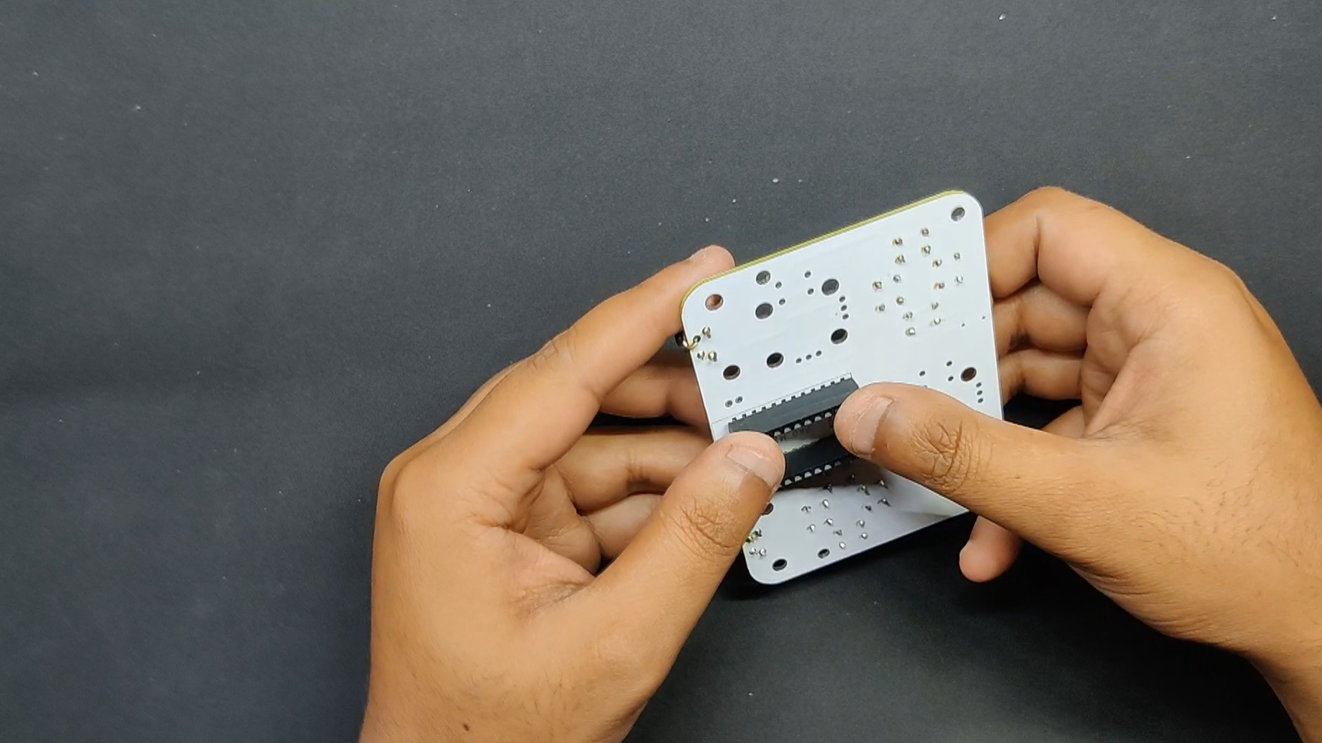

    Circuit Assembly Process
    • We start by adding the 1K 1206 Resistor in its place by using a soldering iron. Here, we first add solder to one pad, then use a tweezer to pick up the resistor and melt the solder that was applied to the first pad. The resistor was then firmly fixed in place by applying solder to the other pad.
    • By following this method, we added all 12 resistors in their place.
    • Next, we placed all of the push buttons in their proper locations, including both horizontal and vertical buttons.
    • We secured them in place by attaching solder wire to their pads, from the back of the board.
    • Next, we attach two CON12 header pins from the back of the board to the Arduino Micro footprint.
    • We solder the CON12 pads from the top side and fasten them firmly.
    • Next, we use the previously inserted CON12 header pins to connect the Arduino Micro in its location.
    • The circuit assembly is now finished.
