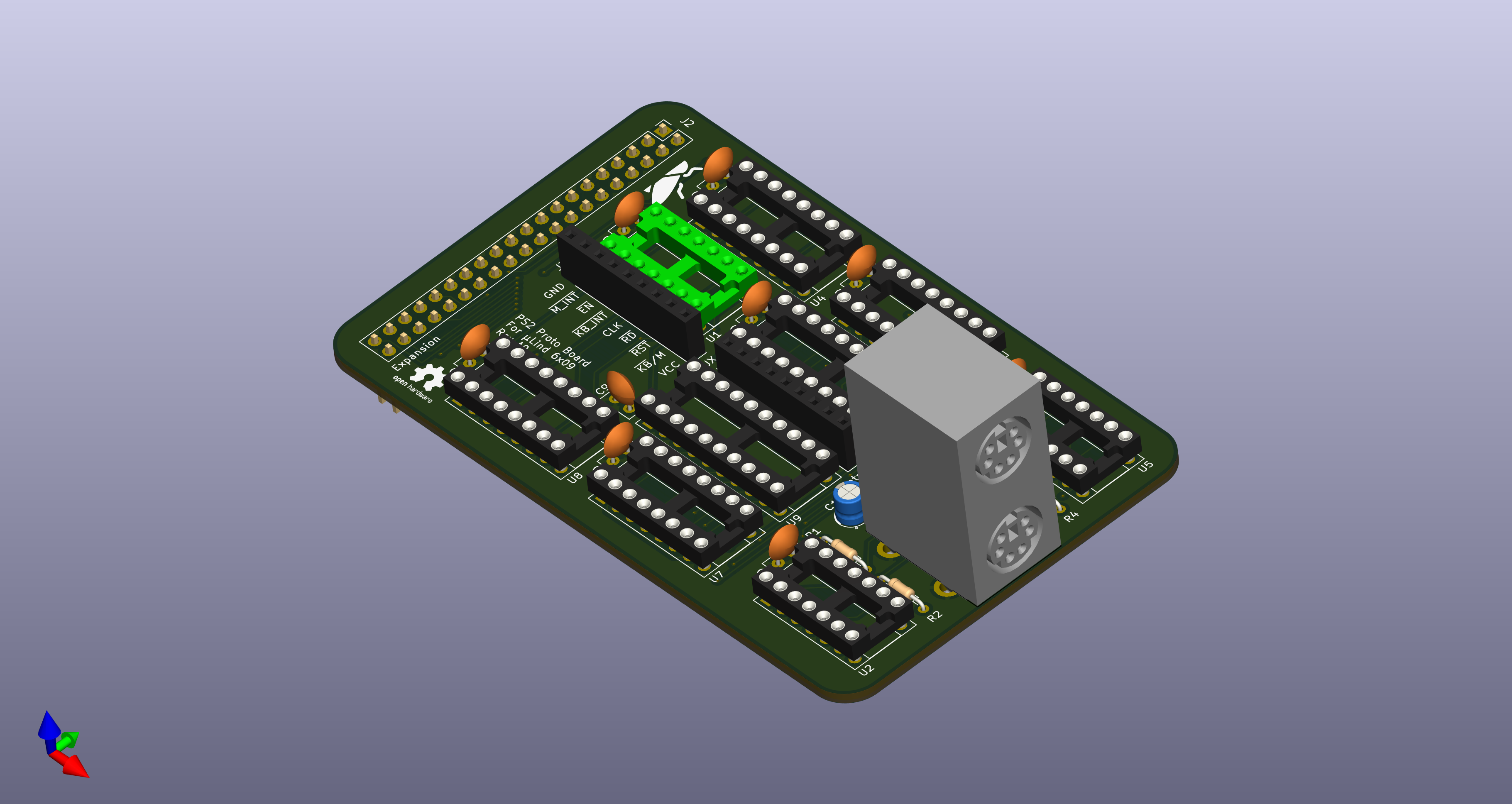

05/15/2025 at 07:25 • 0 commentsWhile we are stuck in the fault tracing I decided to start working on an expansion backplane. We wanted a possibility to add expansion cards to the µLind system and we settled on following requirements for the backplane:
- 6 expansion cards.
- 2 of the ports should have a complete address bus to it (for use with DMA functions for example.
- 2 sockets for 512kB ram, for up to 1MB of expanded ram.
- Possibility to chain one more backplane to the first for additionally 6 ports and 1MB ram.
- Slot for I2C expansion, giving the backplane a way of auto configure the different added expansion cards.
- Possibility to add RTC clock.
- Own address handler and IRQ handler.
So below is a picture of the first draft of the Expansion Backplane:

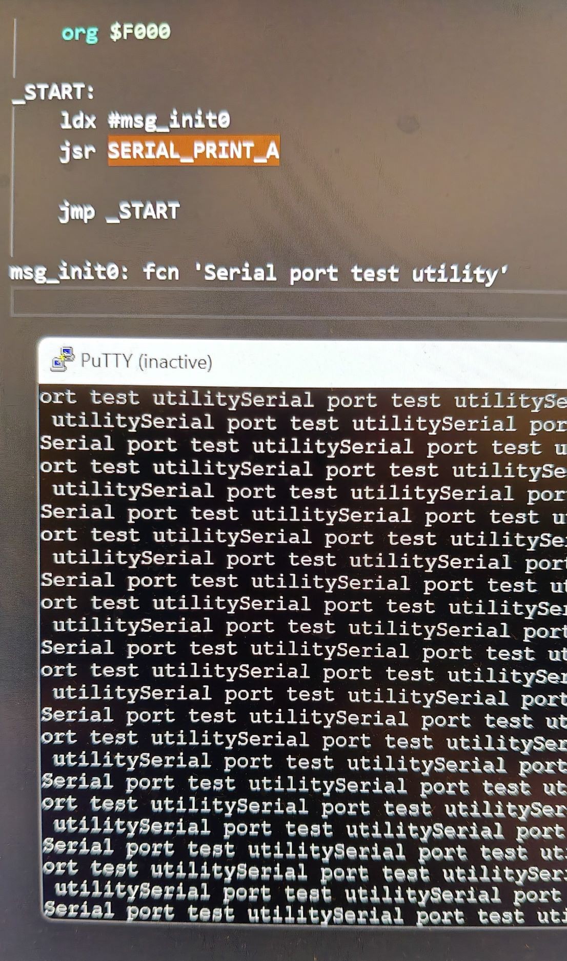

04/05/2025 at 15:07 • 0 commentsTwo days ago, we finally got all components working (sort of) on the stage 2! We sat down and made the serial communication work, there were just some minor tweaks to the code my son had written for the serial controller, and the tiny detail of actually start the serial tranciever after initializing (DOH!) and it worked perfect!
The parallel port (joystick ports) needed a missing pullup resistor to not have the inputs floating. Small miss but the stage 3 drawings are already updated. So after this, the computer deserverd a beauty shot:

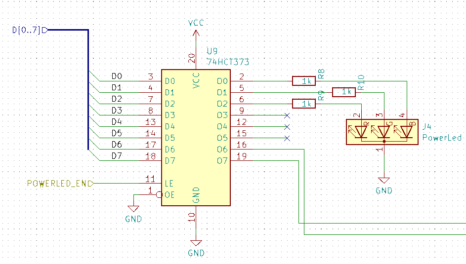

04/01/2025 at 18:59 • 0 commentsToday we finally got the stage 2 to work properly, we got a led blinking!
We started with a small code that should cycle thru the colors of the rgb led we got connected to a register.
When we tried the code the led only blinked once and was dark after that. When we looked in to the schematics we found that we were generating a active low enable signal from our address-logic and the 373 chip needed active high logic.
Easy fix, we just change a line in the GAL code:
PIN 14 = !EXP_EN ; /* Enable Expansion Port */ PIN 15 = !VDC_EN ; /* Enable Video Port */ PIN 16 = !SNDR_EN ; /* Enable Sound Port Right */ PIN 17 = !SNDL_EN ; /* Enable Sound Port Left */ PIN 18 = !CF_EN ; /* Enable Compact Flash */ PIN 19 = !PAR_EN ; /* Enable Parallel Port */ PIN 20 = !SER_EN ; /* Enable Serial Port */ PIN 21 = PWR_EN ; /* Enable PowerLed Port */ <--- HERE! PIN 22 = !IRQ_EN ; /* Enable IRQ Handler */ PIN 23 = !MEM_EN ; /* Enable MMU */After we fixed that we got it to light up, but not change color... Hmmm... After some looking at the code we realized that if the stack was not properly set up the jump instructions used in the delay would not work. Said and done, we updated the code and added initialization of the bank register for good measure :
org $FE00 PWR_LED EQU $F405 BANK_REG_0 EQU $F400 BANK_REG_1 EQU $F401 BANK_REG_2 EQU $F402 BANK_REG_3 EQU $F403 _START: clrb LOOP: stb PWR_LED ldx #$03E8 jsr DELAY_MS cmpb #$07 beq _START incb bra LOOP DELAY_MS: lda #$7C ; 2 cycles DELAY_MS_LOOP: nop ; 1 cycle nop ; 1 cycle nop ; 1 cycle deca ; 1 cycles cmpa #$00 ; 4 cycles bne DELAY_MS_LOOP ; 3 cycles nop ; 1 cycle nop ; 1 cycle nop ; 1 cycle nop ; 1 cycle nop ; 1 cycle nop ; 1 cycle leax ,-x ; 5 cycles cmpx #$0000 ; 4 cycles bne DELAY_MS ; 3 cycles rts ; 4 cycles STACK EQU $1000 org $FF00 HOOK_RESTART: ; Initialize the 6309 CPU in native mode ldmd #$01 ; Initialize the bank registers clra sta BANK_REG_0 sta BANK_REG_1 sta BANK_REG_2 sta BANK_REG_3 ; Set up the stack lds #STACK lbra _START HANG: bra HANG org $FFF0 vrestart: fdb HOOK_RESTARTWith this fixes the power led started cycling as expected! IT WORKS!
This means that following works:
