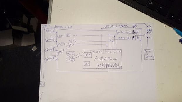

4Step 4Step 4: Make the hardware
Show All Items
Now we have the software part done we need to go to the hardware part.
For the hardware we need 1 arduino uno or nano a lot of long wires! 3 mosfets i use the IRFZ44N 4 5V ( 12V is possible with extra circuitry) relay i use the SRD-05VDC-SL-C but every 5v relay will work.
Before connecting anything keep in mind you are probably working with live voltages of 110V or 230V do this at your own risk!
.Just follow the schematic on the top of this page. If you do not understand something i have tried to explain some parts here below.

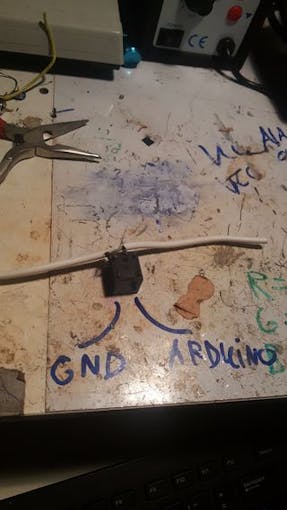

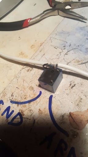

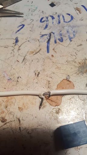

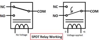

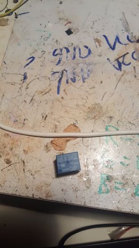

Relays
Keep in mind that the relays only disconnect or reconnect a wire when the relay gets a voltage. When you have a lamp with two wires going into it just cut one of the wires in the middle. Than get a relay and put one end of the wire to the switching pin the (com pin) and the other to one of the other two pins so that if the relay gets power the two wires get connected. Connect the relay as seen above in the pictures. If you have everything connected and the lamp goes on when you click on lamp off and it goes off when you click lamp on you need to change the the wire going to the not switching pin of the relay to the other non switching op of the relay. Here above is a pic of a relay. The other two pins that go to the coil should go one to the ground and the other to a digital pin according to the schematic.
I connected the office devices by getting an outlet box and cutting into one of the two wires. After that i soldered a relay in between those 2 ends like how the lights are connected. After that you can plug the devices you want t turn on or off into the outlet box
The ledstrip
The ledstrip shoulld be connected as below. The colors red green and blue should go to the right pin on the arduino. If you don't do this the colors won't be the same as they say in the program. If you cant read the diagram you should connect it like this Gate pin > correct arduino pin for that color source pin > ground Drain pin > Correct color on the led strip. Above is a picture of the mosfet.

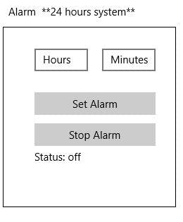

Wake up light alarm
CortanaRoom has an alarm build in! But this is not your normal alarm it is a wake up light style alarm. This means that if you set the alarm for 7 o clock it will actually go off a bit earlier. This is so that it will slowly turn on your rgb ledstrip in the colors of the sun. This helps getting up easier on those dark mornings. Remember the clock is in 24 hours format!!
How does the Wake up light alarm work?
As you can see the alarm has only 2 text fields. the left for hours and the right for minutes. Because you can't set a date the application will make a alarm for the next time your alarm time will be reached. For example: if it is 18 o clock and you want to wake up at 7:30 type in 7:10 (because it takes 20 min to light up the led strip) in the alarm. The alarm will now ring at 7:30 the next day. Example 2: if it is 13 o clock and you want to have it ring at 19:00. Just type in 18:40 and the alarm will go off on 19:00 the same day. Sadly it is at this moment not possible to set a alarm for example 9 o clock over 2 days because it will always search for the next coming 9 o clock not the one after that.

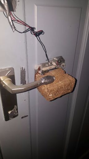

The door lock
As you can see when opening cortana there are 2 buttens called open the door and close the door. This does work when you hook it up the right way. The only problem is that you can only open and close the door with your voice or with the application. So if you are outside and you want to go in you need to open it by talking to cortana. I have on the outside a code lock wich must be entered to enter my room. So if you want to hook it up here are the steps.
Get
a cd drive with dc motor stripped down to only the motor with the rails part.
a l9110 dc motor driver
a piece of wood
hot glue
How to hook up?
Make the following connections
L9110 to the Arduino
GND ont the L9110 to the GND on the arduino
VCC on the L9110 to the 5v on the arduino
A-1A on the L9110 to pin 9
A-1B on the L9110 to pin 9
L9110 to the DC motor
the + wire of the DC motor to one of the pins of the motor A pins
the - wire of the DC motor to the other pin of the motor A pins
****If the door closes when you click open the door and it opens when you click close the door switch the two wires of the DC motor. Put the - wire to the pin where the + was and the + wire to the pin where the - wire was.*****
The last step
As last glue a piece of wood on the cd drive part where the reding sensor is. See the picture above as an example.
