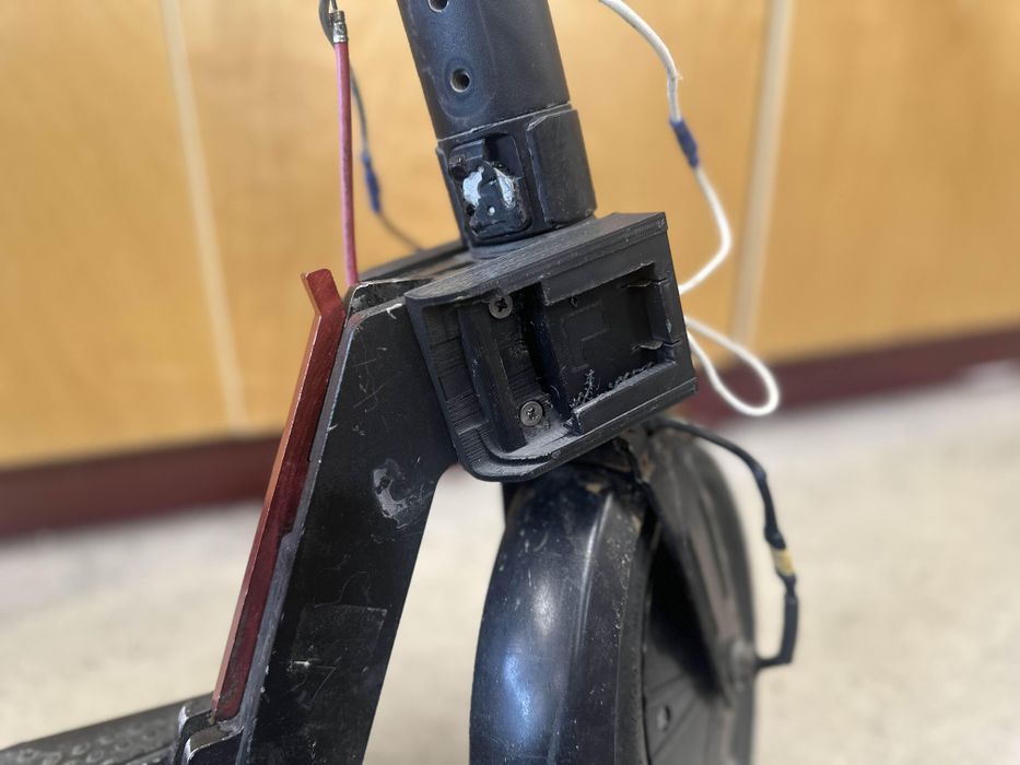

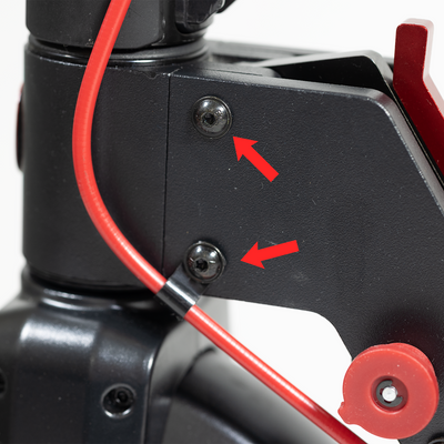

2Step 2: Planning the Build
Determine where to mount the batteries. Your chosen location should:
- Be accessible and convenient.
- Have pre-existing screw holes or a flat surface for secure mounting.
I mounted the batteries near the folding mechanism, as it was narrow and had two screw holes on each side. This area also keeps the batteries out of the way during rides.

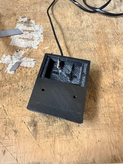

4Step 4: 3D-Printing the New Battery Holder
- Download the DeWalt battery holder model file (attached).
- Open the file in your preferred 3D modeling software.
- Add at least two screw holes for secure mounting.
- Print the holder in PLA or another sturdy filament.
💡 Pro Tip: Adjust the model’s tolerances based on your 3D printer to ensure a snug fit for the DeWalt batteries.
