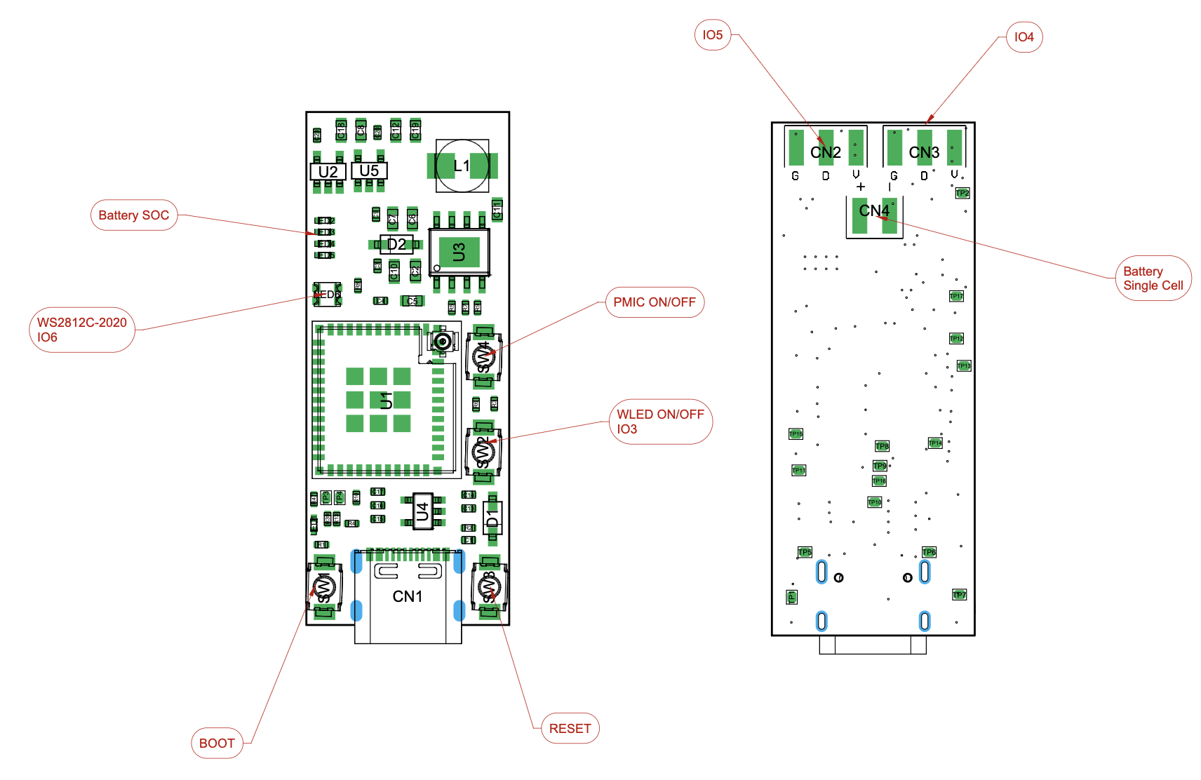

My goal for this project was to design a WLED-compatible board in the form factor of an common 801640 LiPo disposable vape battery. This would allow the PCB to stack neatly on top of the battery and fit into a simple 3D-printed enclosure. I used the ESP32-C3 module with an IPEX-3 connector to minimize the PCB footprint and to enable the use of an external flex antenna for improved Wi-Fi range. To support two outputs for WS2812 Neopixels, I included two 3V3-to-5V level shifters.
For the PMIC (Power Management IC), I got creative and chose the IP5305T, originally designed for inexpensive 5V power banks. This single SOIC-8 package handles lithium battery charging, 5V boosting, and includes a power path for USB input. It even integrates a push-button controller, making it an ideal all-in-one solution. To power the ESP32-C3, I used an LDO to provide a stable 3V3 supply.
The final design offers a compact WLED board that can be powered either via a 5V USB connection or recycled 801640 vape batteries. The two LED outputs can be toggled on and off using an assigned GPIO button or the WLED app. Additionally, the PMIC includes an on/off button for easy shutdown, perfect for power-saving applications.

Pinout:
