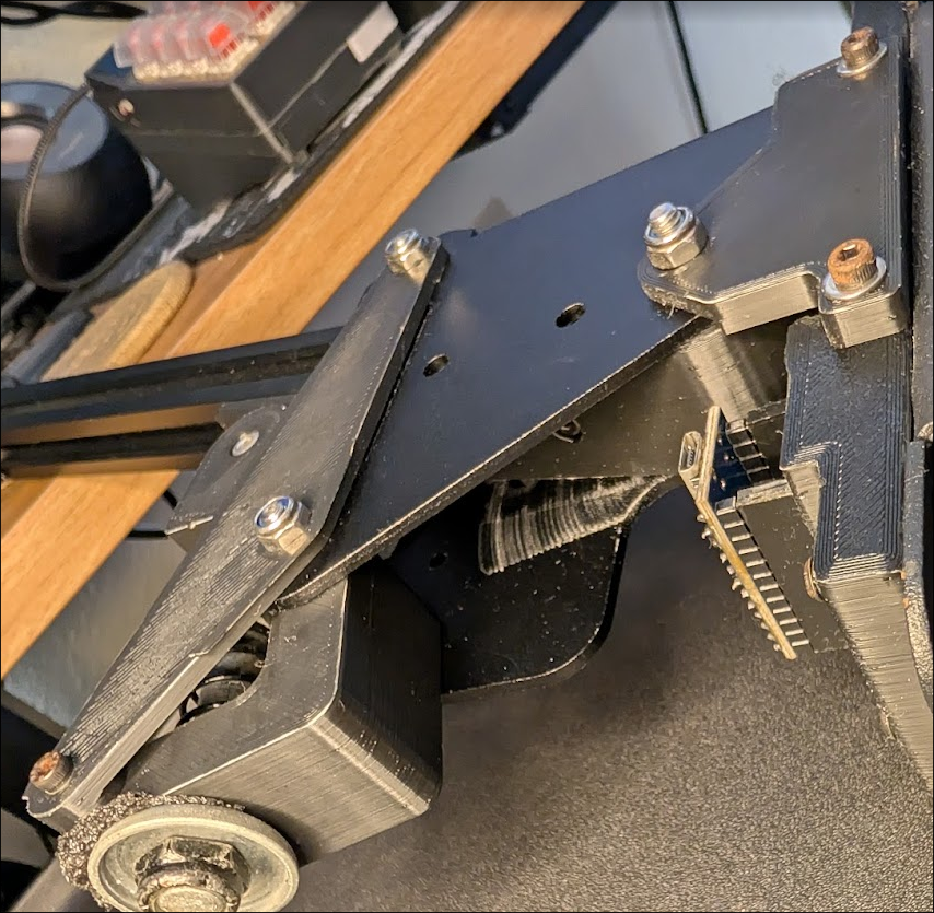

    neatloaf7 • 04/04/2026 at 21:33 • 0 comments

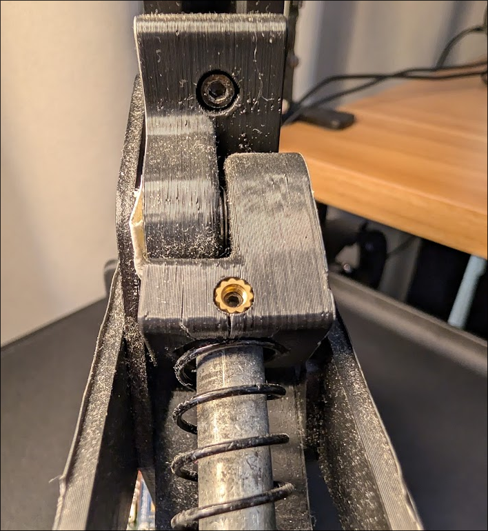

    After one year of using the handbrake, it is time for a redesign. The return mechanism is probably the biggest issue; when letting go of the handbrake, all the force ends up resolving into the two set screws holding the "plunger" bolt in place. I tend to get CAD goggles when placing threaded inserts, and in this case putting them on a too-small feature ended up cracking the plunger pivot, and didn't even really hold the plunger in place that well. I have experienced many spontaneous disassemblies of this region during some heated handbrake turns.
    The way I designed the return mechanism also made it so it was essentially impossible to adjust without taking the whole thing apart.
    Cracked plunger pivot. Has functioned like this for basically a year
    Every other hairpin looks like this!

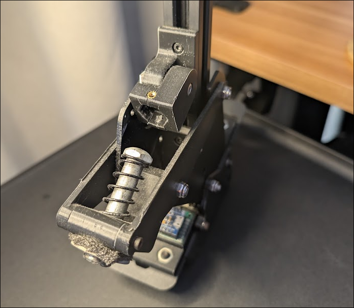

    I think the supporting structure of the design has been pretty robust though. There is minimal flexing despite the design of the housing. The magnetometer, while overkill, has also worked pretty well.
    My main redesign goal is to add a hard stop between the handle and base while the handbrake is in a neutral state. Relying on two 3mm set screws to essentially hold everything together was a poor design decision. I am looking to make this hard stop portion somewhat modular so I can test different materials for dampening the return. I have a few different adhesive foam/rubber tapes, and I could also look into a tpu stop of some sort. A hard stop should also put the neutral position in the same spot every time; with my current setup, the neutral position will tend to walk around as the plunger gets rattled.
    My second redesign goal is to test different return springs. Some looking around has indicated RC shocks might not be the best idea. I have a foam insert from my fanatec brake pedal that I will try to use first. Of course that means I would also like to make the aft portion of my handbrake modular as well. I would also like to look into a spring/soft bushing combo which I've seen used on several OEM and modded sim brake pedals. Of course, if I can get away with just a bare spring that would be okay too.
    Looking at the Moza and Fanatec handbrake designs, they have much thicker springs positioned closer to the pivot point of the handle. This keeps things compact and I assume also helps with the handbrake "rebounding" off the hard stop when you let it go.
    Ideally, I would like to keep the electronics positioned the same (mostly so I don't have to desolder the sensor). I think being able to have the electronics in the front of the assembly would open up some possibilities, but I'm not sure if having the micro usb on the other side would interfere with the shifter.
    A smaller issue is that the handle isn't really constrained transversely; it basically floats between the housing. This isn't a big issue, but there are some witness marks inside where the handle rubs against the housing. This doesn't greatly affect performance, but I think the design could be improved.
