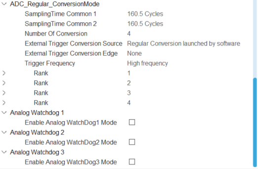

  • Important ADC notes
    Ghani Lawal • 10/16/2025 at 19:08 • 0 comments
    • What HAL_ADC_START_IT() does:
      • It doesn't directly start the ISR, instead it
        • Starts the ADC conversion in interrupt mode

  • Prep for Testing 8
    Ghani Lawal • 10/16/2025 at 18:34 • 0 comments
    • Gained a deeper understanding of the different modes of an ADC
    • Finally got Oversampling Mode to work
    • Helpful Resources:
    • ***After the for loop where I get the current raw ADC values for the voltages and currents, I have to add "HAL_ADC_STOP(&hadc1)" to get oversampling to work
                Apparently, "Calling HAL_ADC_Stop(&hadc1) after the entire for loop ensures that before the $100ms delay and the start of the next while(1) cycle, the ADC peripheral is completely reset and put into a clean IDLE state. This allows the very first HAL_ADC_Start() of the new cycle (for $i=0$) to initialize the sequence correctly and produce valid oversampled data again."
