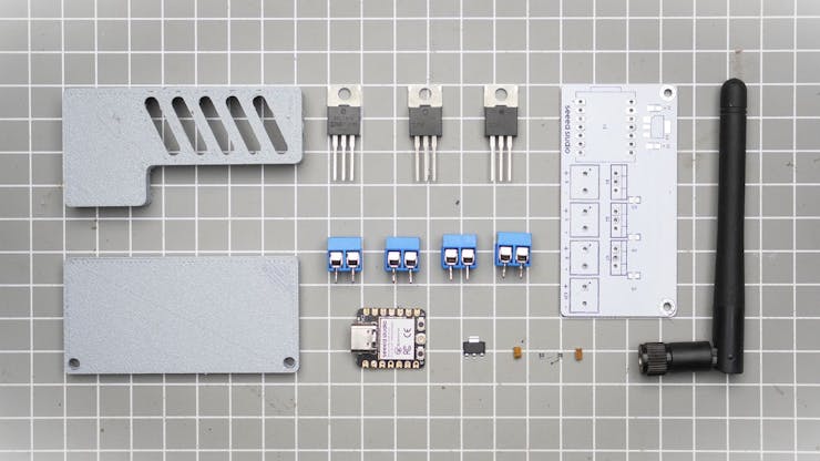

Parts
- Seeed Studio XIAO ESP32C3
- 3*IRLFZ44N mosfet
- AMS1117
- 2*10uf tantalum Capacitors 16 V 1206
- 3*10k 0805 Resistor
- 4*KF301-5.0-2P
- 2.4G Antenna
- 2*M2-5MM screw

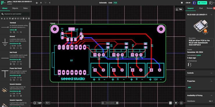

Step 1 Designing the PCB
The PCB designing process was straightforward, thanks to Flux.ai. This browser-based PCB design tool leverages AI to assist with hardware design. Once I finished designing the PCB, I exported the Gerber file for manufacturing. I used the seeedstudio fusion service to manufacture this PCB. All the steps I took for the PCB design is available in the video
link to the SeeedStudio fusion service: https://www.seeedstudio.com/fusion_pcb.html

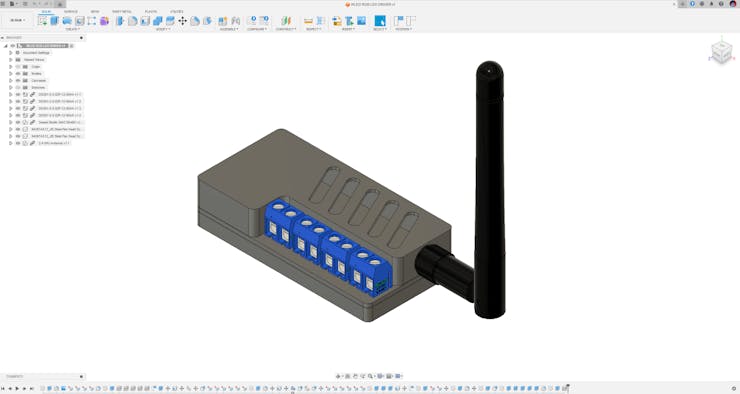

Step 2 3d printing enclosure
I used Fusion 360 to design the enclosure, then exported bodies to STL files and 3D printed it

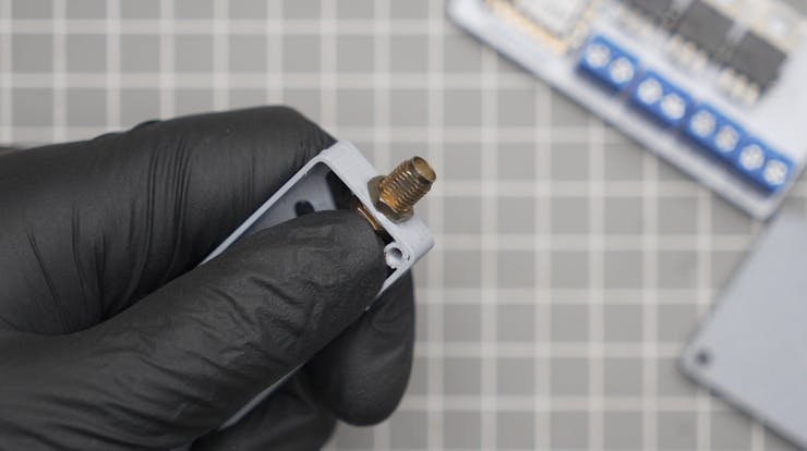

The first step is to install the antenna connecter to the hole
Then connect this cable to the the XIAO antenna port

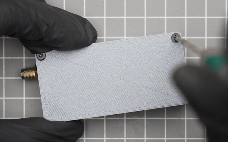

Put the top and bottom enclosure and fasten it with M2 5mm screws

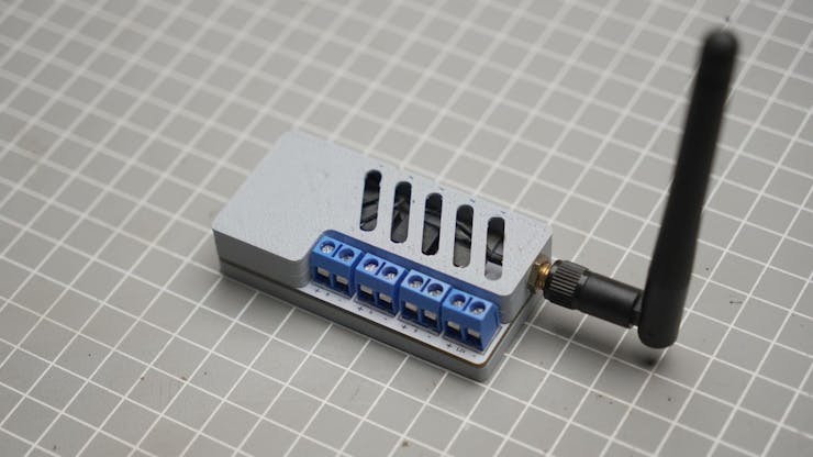

So we are done with our build

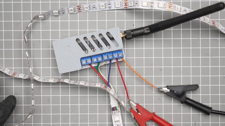

Step 6 Testing
Users can connect the wires to the device according to the labels on the PCB
I connected my 12 RGB LED stripes with a 12 v source into it. the LED strip has common positive terrain
I used the WLED app to control the driver. This app is available on the App Store
Now we can play around with the app. Try different colours in it
