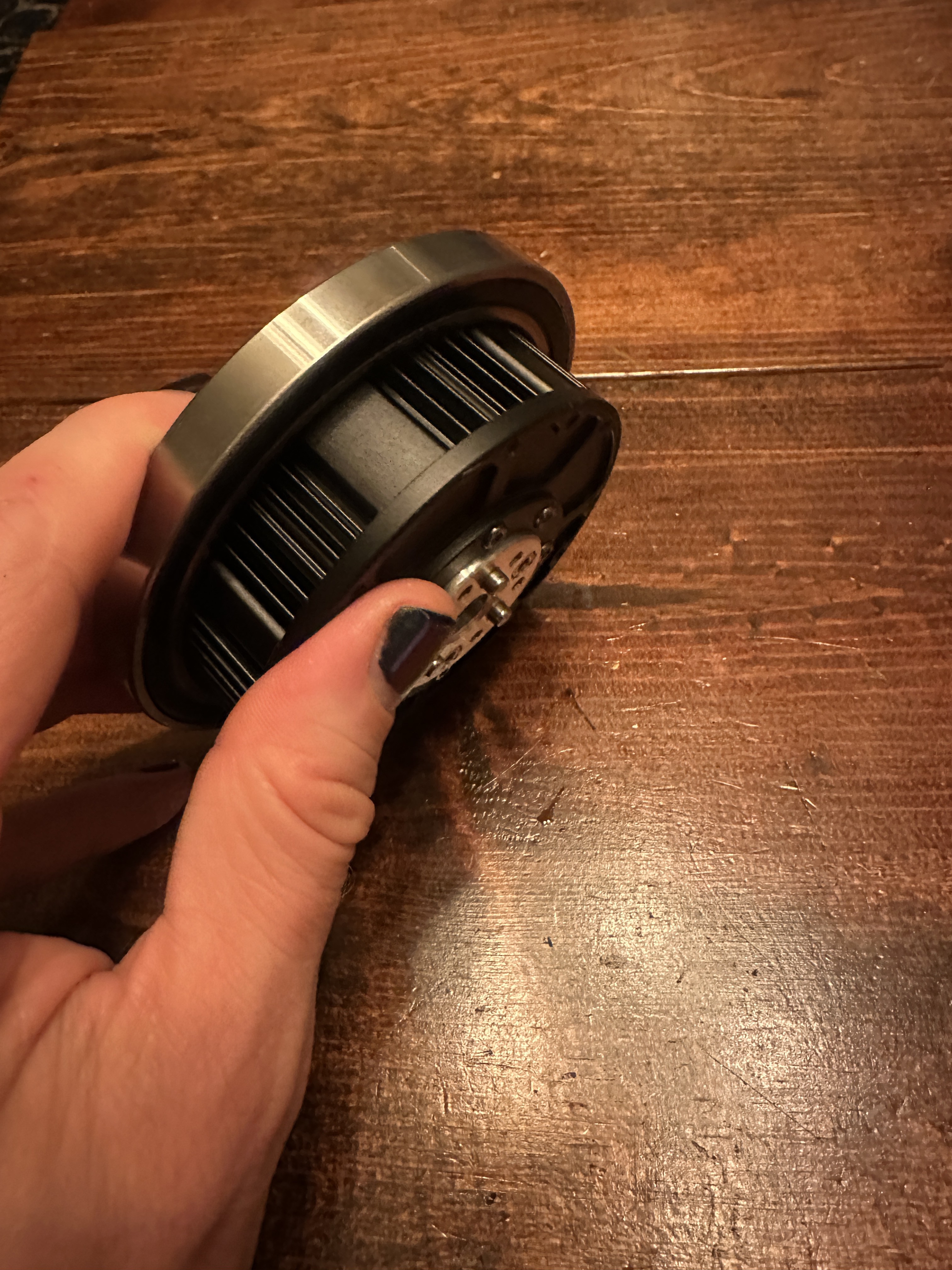

I marinated on this for a few weeks while traveling, and on my way home, I came up with a solution.
The ideal solution would be to support the hip attachment symmetrically on the motor, so that the motor is essentially centered on the movement arm. In this configuration, the attachment to the motor output would be on one end, and a free-wheeling bearing would be on the other. The additional bearing would help take the strain off the motor output connection.Luckily, I found a bearing that fit perfectly snug around the top of the motor down to the heat sink fins. Then it was just a matter of reworking the model to integrate the bearing.

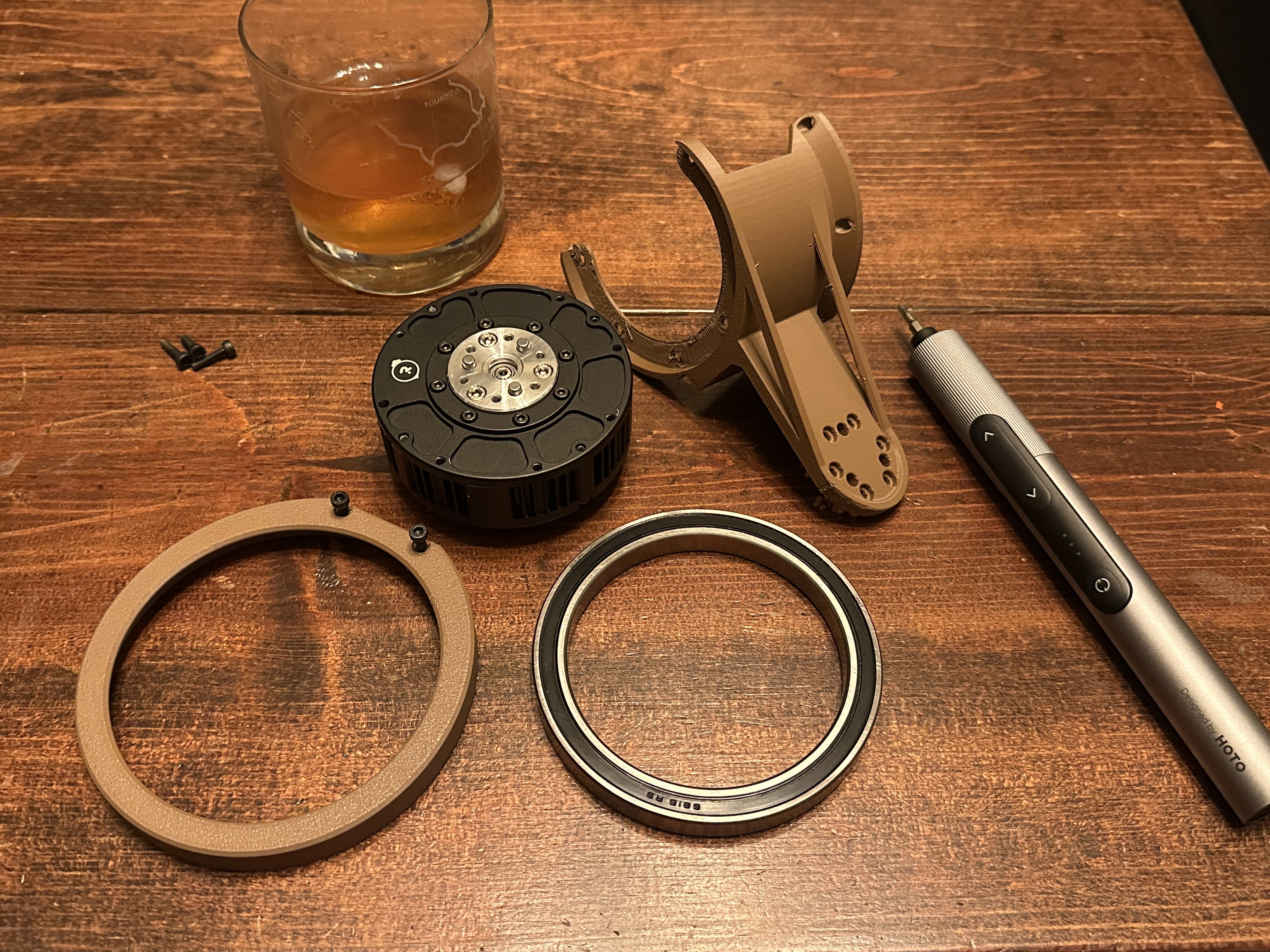

Here's the assembly of the updated hip section:
The parts, and a drink essential for assembly Attach the bearing to the motor The hip motor assembly All together

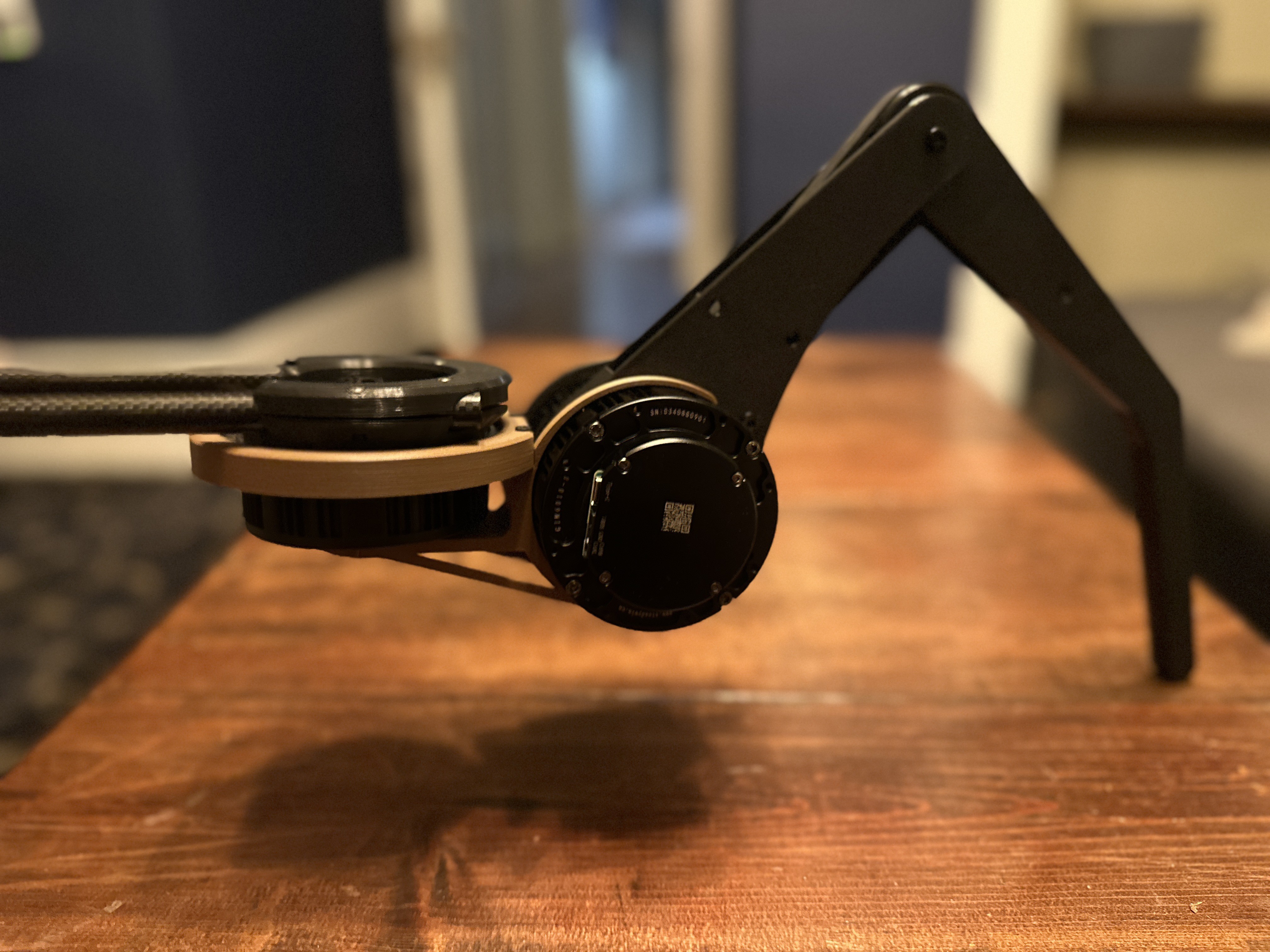

Here's what the updated leg looks like.
