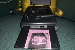

Inside the head is a Raspberry Pi Zero 2, a Raspberry Pi Camera, a 9600 baud thermal printer, and some bits to deliver enough power to everything. As of Supercon, here's what the head could do:
- pressing down on the citrus activated the Raspberry Pi camera in the snout
- a convoluted imagemagick algorithm tried to make the photo look like a lineart sketch
- a thermal printer in the mouth would spit out the photo on sticker paper, taking about 45 seconds to do so

To go from "normal color raspicam photo" to "pencil-sketch-looking B+W image," I used a convoluted imagemagick algorithm based on the "watercolor" algorithm from Fred Weinhaus.
# Take image with raspistill command
# Convert to black and white sketchy image
convert imagecolor.jpg -colorspace Gray -mean-shift 5x5+10% \( -clone 0 -define convolve:scale='!' -define morphology:compose=Lighten -morphology Convolve 'Sobel:>' -negate -evaluate pow 15 \) \( -clone 0 -clone 1 -compose luminize -composite \) -delete 1 -define compose:args=50 -compose blend -composite -brightness-contrast 10x50 sketch.jpg
