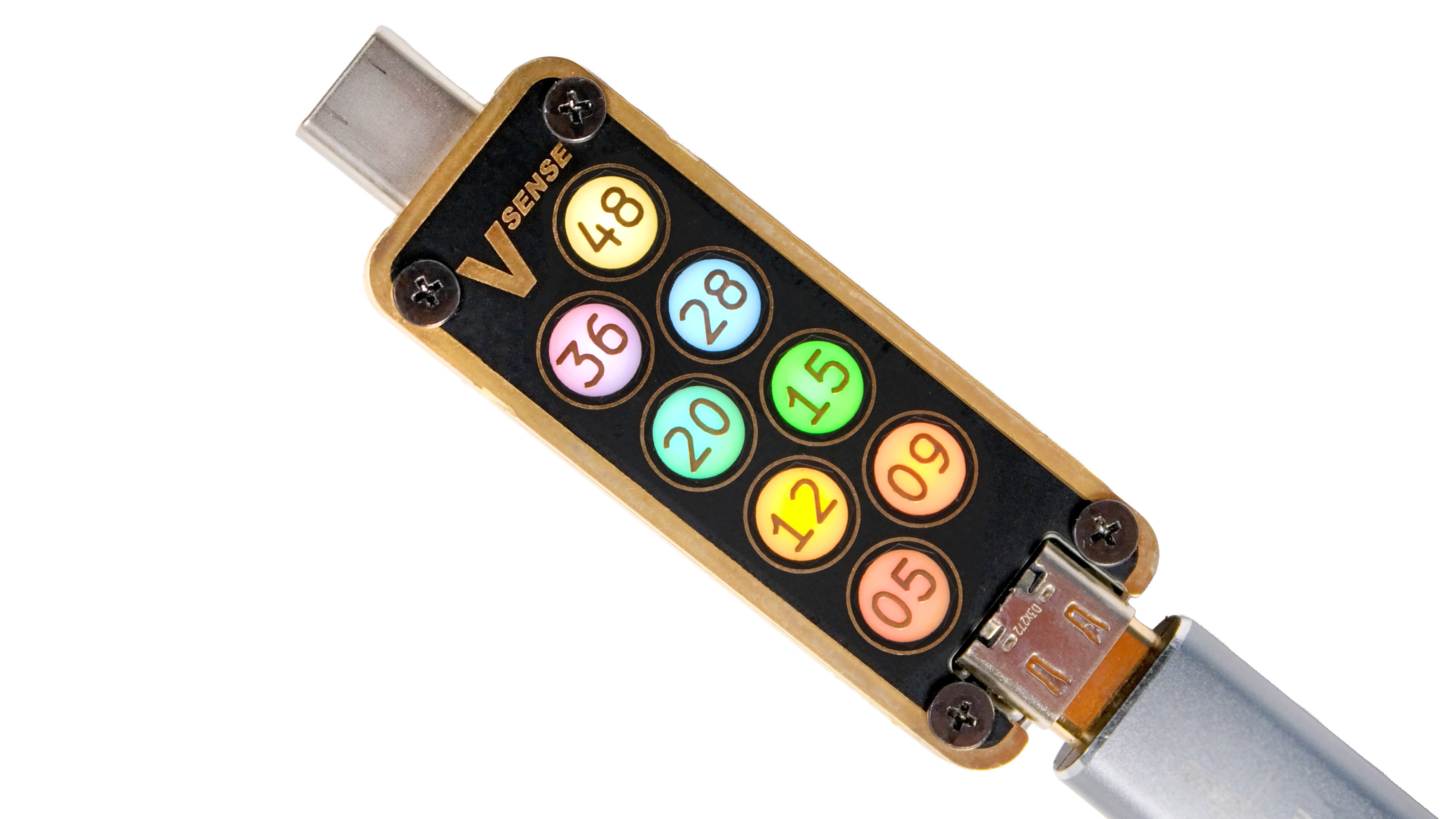

An effortlessly clear + intuitive USB voltage indicator for swift USB power diagnostic experience, which is easy to replicate and customize.
VSense is a voltage indicator that is designed to give you insight into power being transmitted through USB quickly. VSense works by giving you a clear and unambiguous indication of the current USB voltage mode with the help of illuminated, individually color-coded and clearly labeled annunciators, one for each USB Power Delivery fixed voltage modes. Furthermore, VSense distinctly notifies you of deviations from these fixed voltages outside of nominal voltage specifications. VSense consists of high quality components and a rugged construction, and it is capable of 48 V and 5 A which completely covers the latest USB Extended Power Range (EPR) specifications, you can expect VSense to be useful for years to come. And last but not least, VSense is composed entirely of PCBs making it a piece of cake for you to customize and replicate!

Features & Specifications
  • Fully capable of the latest USB PD EPR specifications (48 V, 5 A, 240 W)
  • A wide operational and measurement range of 4.5 V to 51 V
  • Individual color-coded indicators for each fixed voltage level:
    • 5 V (red)
    • 9 V (orange)
    • 12 V (yellow)
    • 15 V (green)
    • 20 V (lime)
    • 28 V (blue)
    • 36 V (purple)
    • 48 V (white)
  • Distinct alerts show > 5% and > 10% deviations from the fixed voltages. This feature is also helpful in approximating PPS voltages
  • Passthrough for USB 2.0 data, CC, and SBUS lines
  • Ultra-low power consumption, less than 6 mA of current drawn by the device (absolute maximum under regular operation)
  • ATtiny 406’s 10-bit ADC with 4.3 V internal voltage reference provides stable measurements of up to 22 mV resolution for voltages below 20 V and 49 mV for voltages between 20 V and 51 V
  • Stacked PCB construction with high-quality parts built to last:
    • Automotive grade LDO from Microchip (+70 V absolute max input voltage with ESD protection)
    • Kingbright low-current LEDs
    • JAE USB Type-C connectors rated for 48 V and 5 A
  • Dimensions: 56 x 18.5 x 5.6 mm (2.28 x 0.73 x 0.22 in)
The following table demonstrates the range of lights and flashing patterns and what they mean:
Voltage RangeState of Annunciators
Lower than 10% of 5 V (E.g. 4.4 V)5 V (red) rapidly blinking
Lower than 5% of 5 V but higher than 10% (E.g., 4.7 V)5 V (red) slowly blinking
Higher than 5% of 12 V but lower than 10% (E.g., 13 V)12 V (yellow) steady and 15 V (green) slowly blinking
Higher than 10% of 12 V but lower than average of 12 V and 15 V (E.g., 13.4 V)12 V (yellow) steady and 15 V (green) rapidly blinking
Within 5% of 15 V (E.g. 15.1 V)15 V (green) steady
Lower than 10% of 20 V but higher than average of 15 V and 20 V (E.g. 18.5 V)15 V (green) rapidly blinking and 20 V (lime) steady
Lower than 5% of 20 V but higher than 10% (E.g. 19.5 V)15 V (green) slowly blinking and 20 V (lime) steady
Above measuring capability (E.g. 52 V)48 V (white) rapidly blinking
