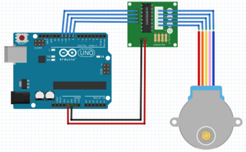

4Wiring
Follow these instructions to wire the motor
5Code
You can see over the code that we used in the files
