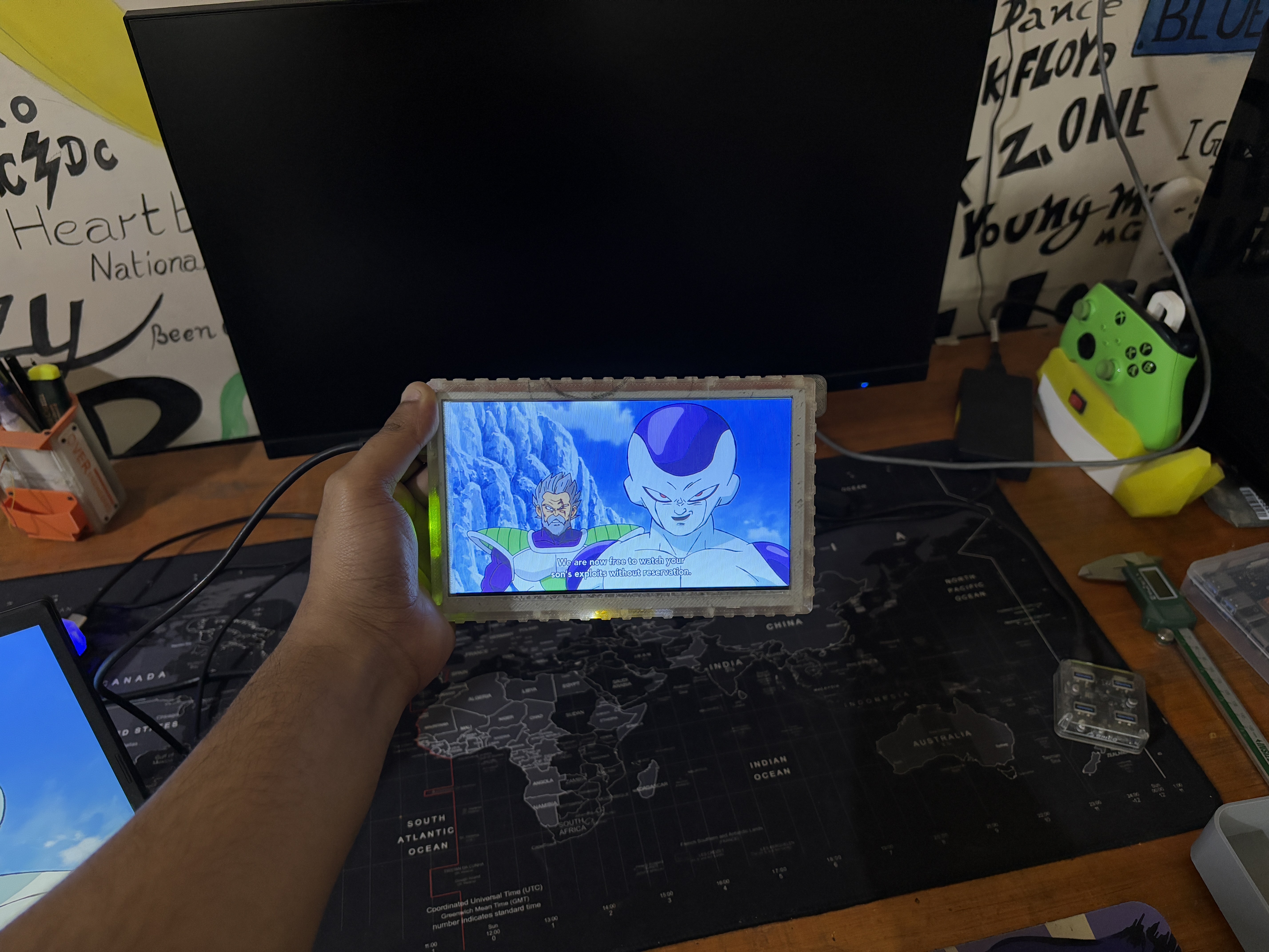

The Version 2 has a thinner LCD panel, resulting in a slimmer overall design of 19mm, making our design far slimmer than the previous version, which was more than 30mm.
Here, we first arrange a thinner LCD panel that is only 6 mm thick and is connected to an HDMI board via an FPC cable. Because the display was thinner, we were able to reduce the size of our design even after including a battery pack and charging circuit inside the device.

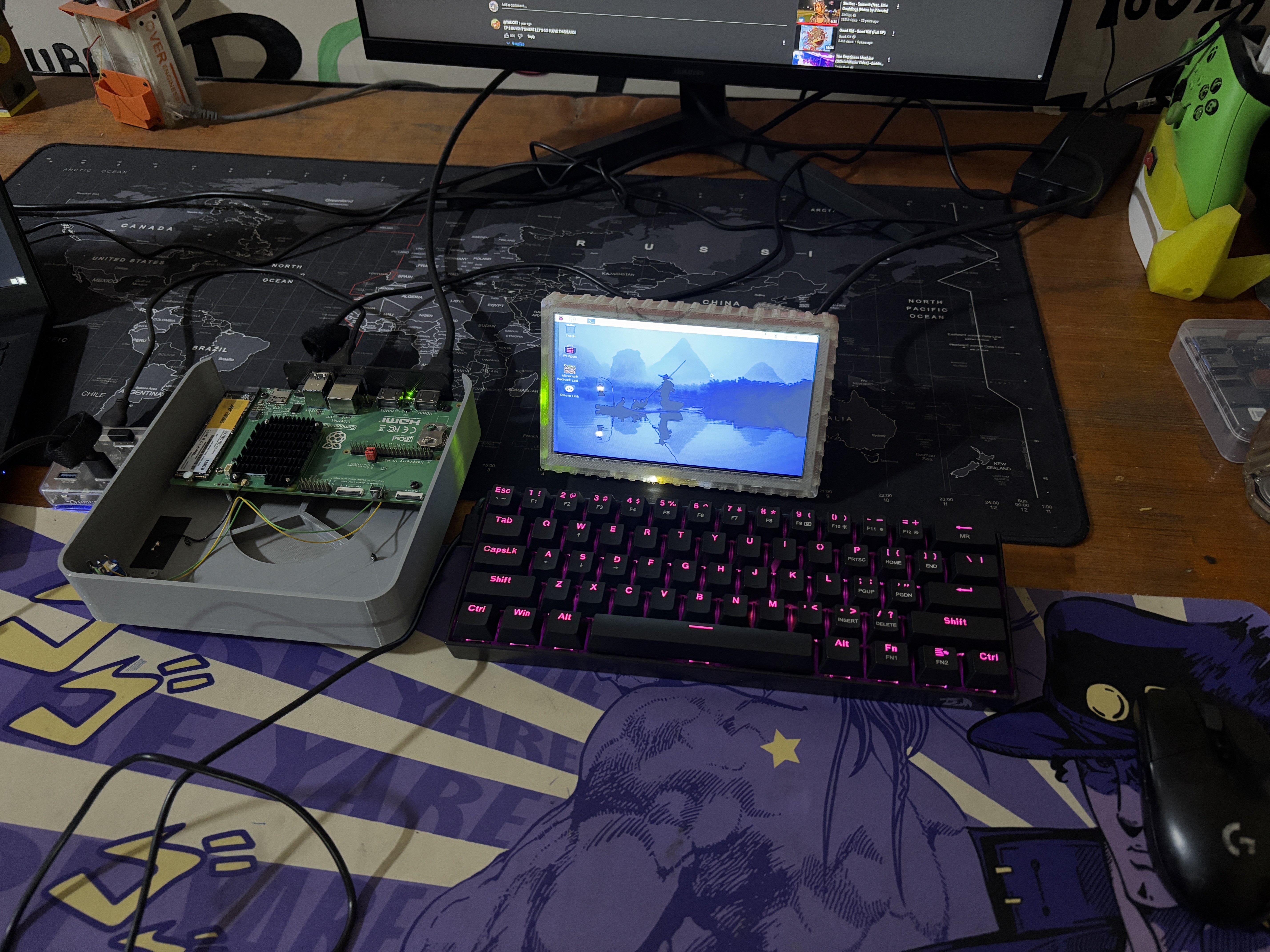

Because of its size, we may take this display in our bags and use it as a second monitor with our laptop or with a single-board computer setup, such as a Raspberry Pi.
