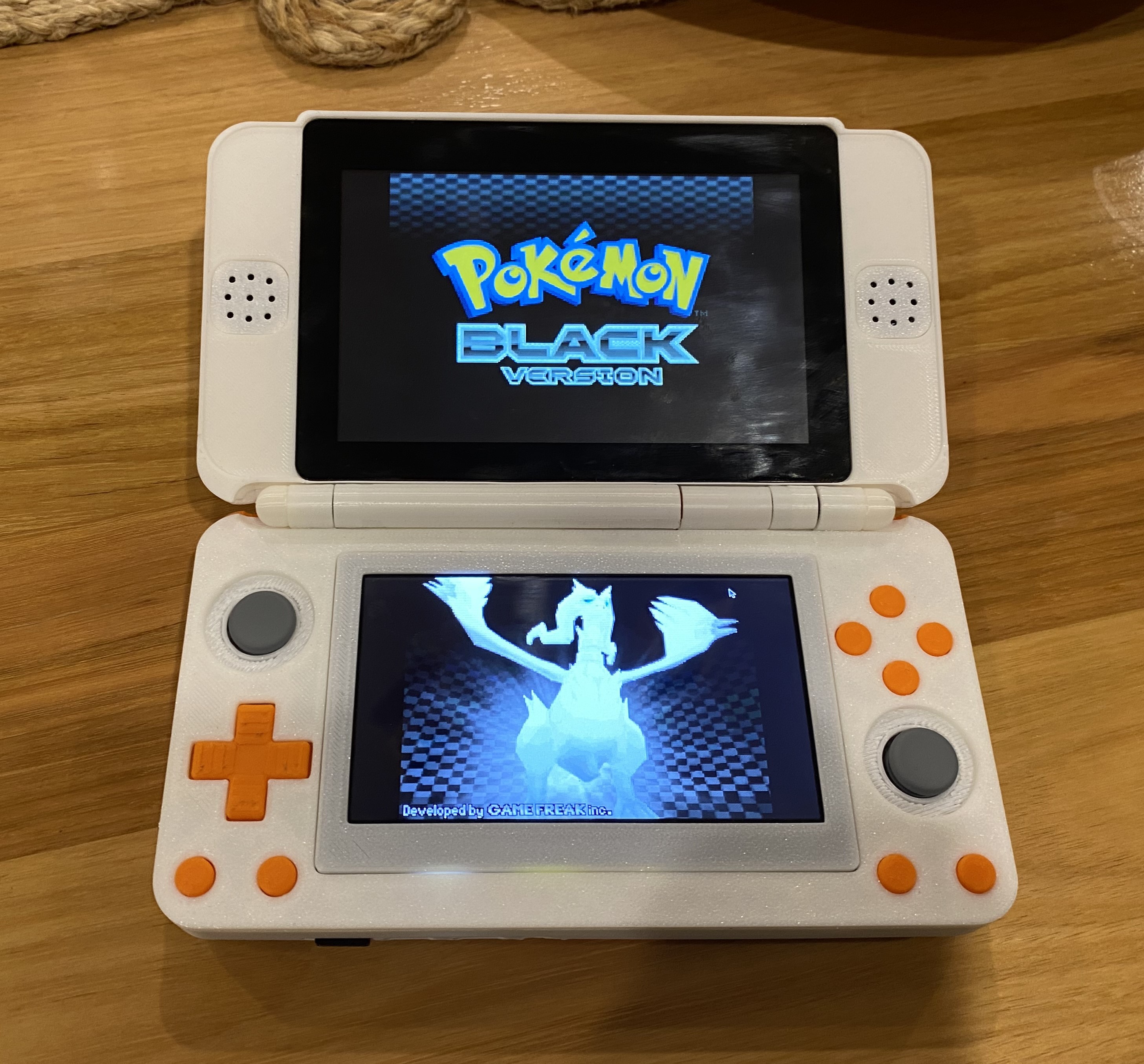

    Yeah as the title suggests i've done a lot recently. The thing now has 2 screens, a hinge, and works pretty good. Github is here: https://github.com/borpendy/DSpi. I'll probably do a longer write up on the pcb design at some point soon.

    Hey guys, sorry for disappearing for a bit, uni has been literally trying to kill me with workload. Its finally winter break now, so we're back. Motherboards have arrived, and mostly function, meaning I now have a semi functional handheld sitting in front of me.
    Hey look, it's half a ds
    Issues include, but are not limited to: Broken 2nd screen connector, Incorrect MCU making BMIC configuration difficult, Broken headphone jack, The thing being fat as f***, so yeah lots to work on.
    Apart from that everything seems to work fine, and I got retro pie running pretty easily. Ironically, in its current form ds games suck, since each screen gets a whopping 2 inches of size, but that's an issue for another revision.
    Also Linux sucks and I resent it's very existence
