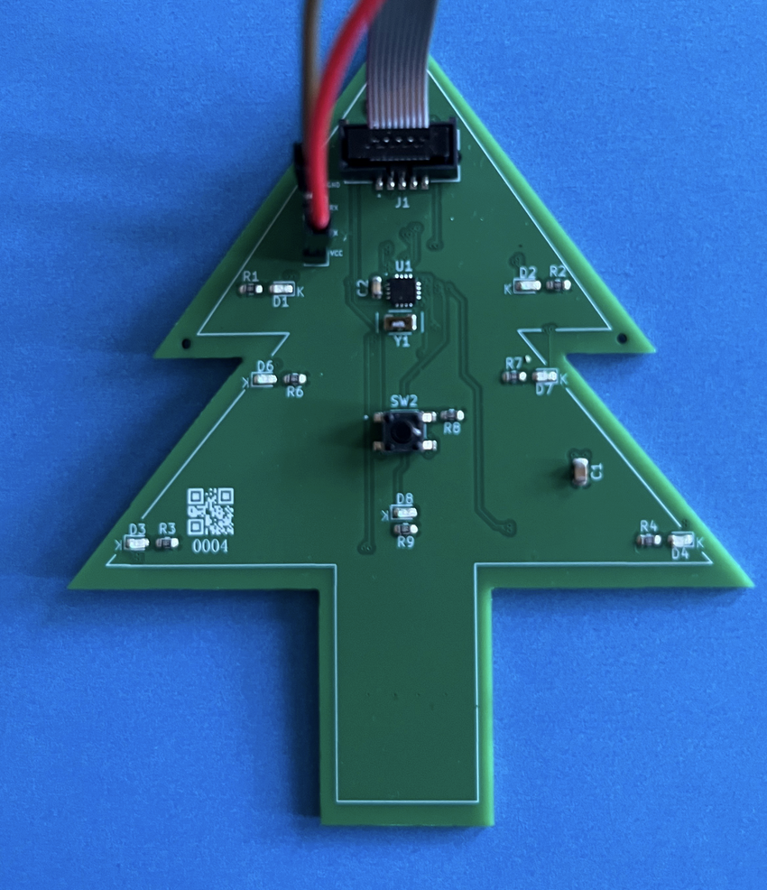

Electronic Ornament 2025 with EFM8SB1 Sleepy Bee
This EFM8-based ornament is an improvement on my PIC16-based design from 2024
268 views
0 followers
2-layer PCB with HASL finish, fabricated and assembled by JLCPCB
Board designed with KiCAD 7.0.
Firmware developed in C with Simplicity Studio 5, compiled with Keil 8051 C compiler.
2-layer PCB design with HASL finish, fabricated and assembled by JLCPCB.
Firmware developed in C using Simplicity Studio 5 and compiled with the Keil 8051 C compiler.
PCB designed with KiCAD 7.0.

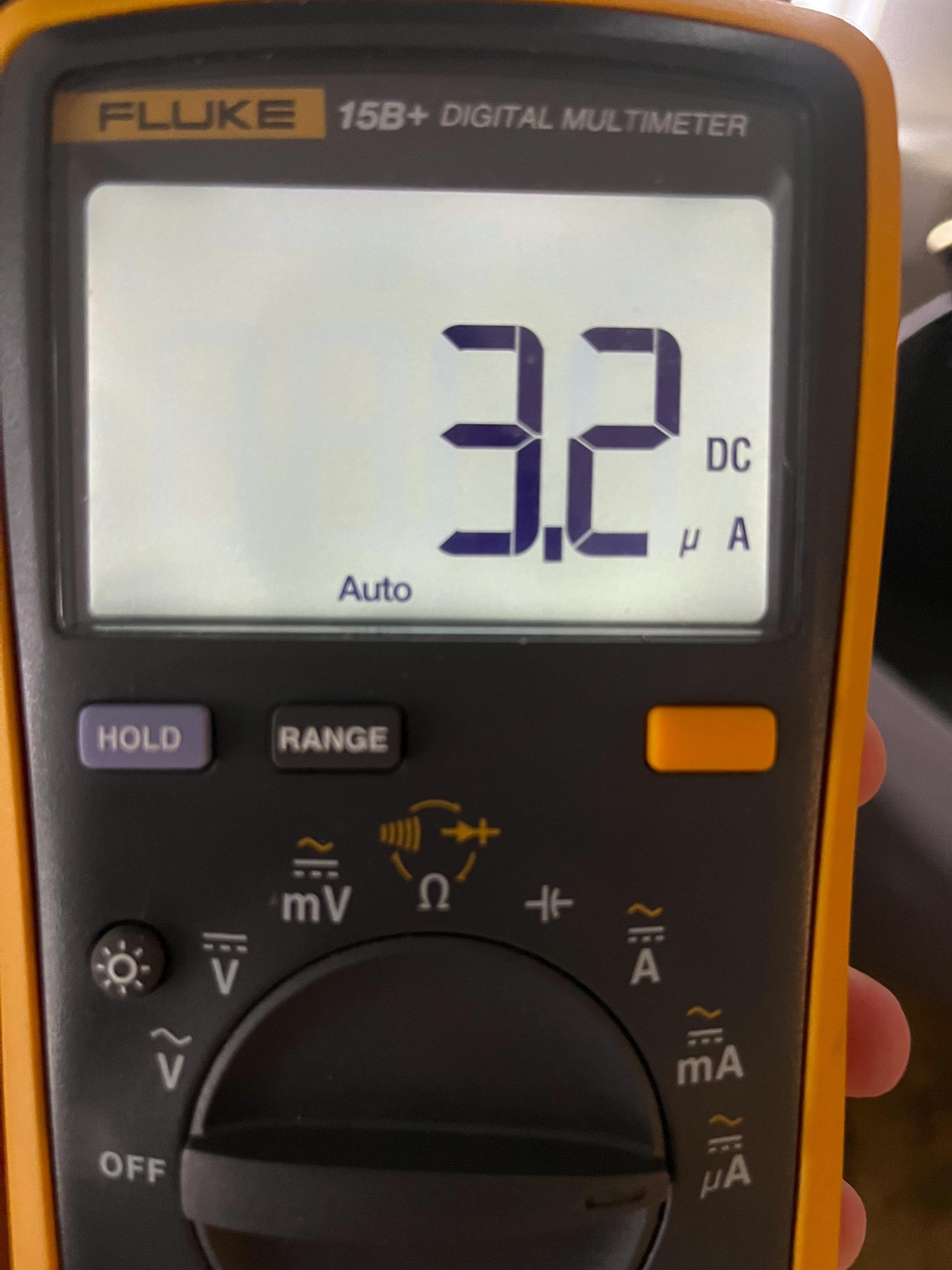

    I went and improved on the firmware build I put together earlier today by reorganizing my program to make use of the sleep mode to save power during periodic inactive periods, much like my PIC16LF1823-based design was implemented. The last build used the Timer2 peripheral for timekeeping, which I used because it is much easier to access than the RTC registers (which require indirect memory access to read/write). The use of Timer2 made the use of sleep mode impossible, as Timer2 cannot wake up the CPU from sleep mode (only idle mode).
    I disabled Timer2 as it would no longer be used for timekeeping - instead, I enabled the RTC timer and set the alarm function to periodically trigger an interrupt and wake the CPU from sleep. Like the previous PIC16LF1823 design, these intervals were set to the following:
    • Put the CPU to sleep after 4 fourhours of continuous use and turn off all LEDs
    • After twenty-four hours of sleep, wake the CPU and turn all LEDs back on
    In order to use the button to wake up the CPU from sleep mode, I enabled the port mismatch function for my button pin (P0.1) in addition to the existing use of the INT0 interrupt. This allows the button to wake the MCU from its sleep mode, much like how it works on my previous designs. This is required as only the port mismatch function can wake up the CPU from sleep mode.
    The use of sleep mode seems to have paid off, as I am now recording only a 3.2uA current draw from the EFM8SB1 when the CPU is in sleep mode:
    On the other hand, I recorded a 1.35 mA current draw from the EFM8SB1 when the CPU was in idle mode:
    Seems like sleep mode results in power consumption nearly 422 times lower than the idle mode!

    I banged out an unoptimized firmware build for implementing some light patterns and the power-saving mode. So far, we have for light patterns:
    1. Candlelight: bottom LEDs off, top LED flickers
    2. Solid: bottom LEDs on at 100% brightness, top LED flickers
    3. Blink (slow): bottom LEDs blink at a 1 Hz rate, top LED flickers
    4. Blink (fast): bottom LEDs blink at a 2 Hz rate, top LED flickers
    5. LED chaser
    6. Software flicker: all LEDs flicker at different offsets from the source RNG array; bottom LEDs flicker in software, top LED flickers in hardware with PCA0-based PWM generator
    7. Half-brightness: bottom LEDs are set to a reduced brightness through software PWM, top LED flickers
    So far, I've implemented a crude power saving function that shuts off all LEDs and places the CPU in idle mode, where all interrupts may wake the CPU. Unfortunately, this is not ideal as the way I implement timekeeping is through Timer2 driven by the RTC crystal divided by 8, so the CPU will wake up every 1 second and need to be put back to sleep.
