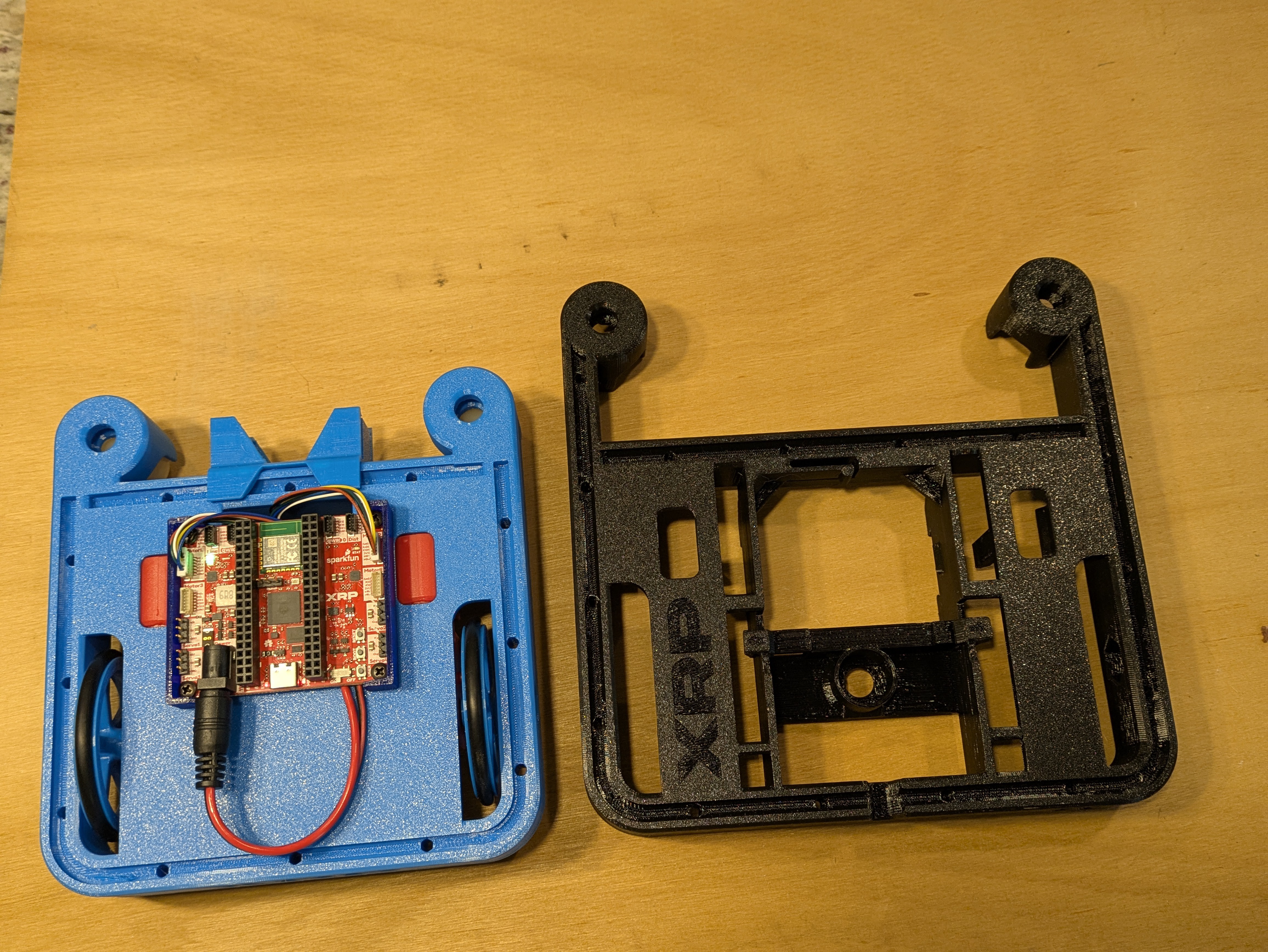

Since the whole design is open source, I am trying to modify the XRP to address all of the above. I'll document the project here.
My modifications
Better wheels
I made new wheels which work with Pololu's silicone tires https://www.pololu.com/product/3409.
They have same diameter as original wheels, so they can be used without any modifications to the rest of the chassis.
Design files are here: https://www.printables.com/model/1275321-wheel-for-xrp-robot-pololu-tires
Display board
This add-on board contains a 135x240 TFT SPI display, 2 user buttons, a large on/off switch, and two neopixels. It plugs into the headers of the XRP controller.
Source files are in github, and full documentation at https://xrpdisplay.readthedocs.io/
Custom chassis
My final modification is creating a custom chassis for the robot. This is work in progress.
Features:
- Smaller size
- Uses two 18650 batteries
Design in Fusion 360: https://a360.co/43SxnfM...
