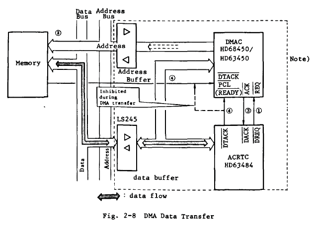

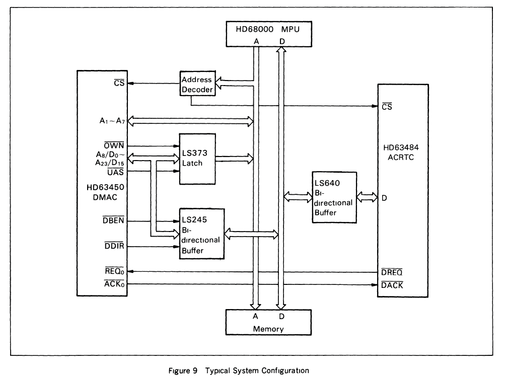

Like the Amiga and X68000, Amagaki will make extensive use of DMA to provide good system performance from a modest CPU.

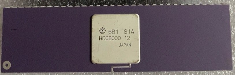

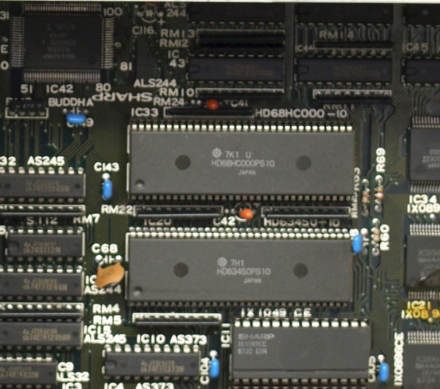

- 12.588 MHz HD68000-12 16/32bit CPU

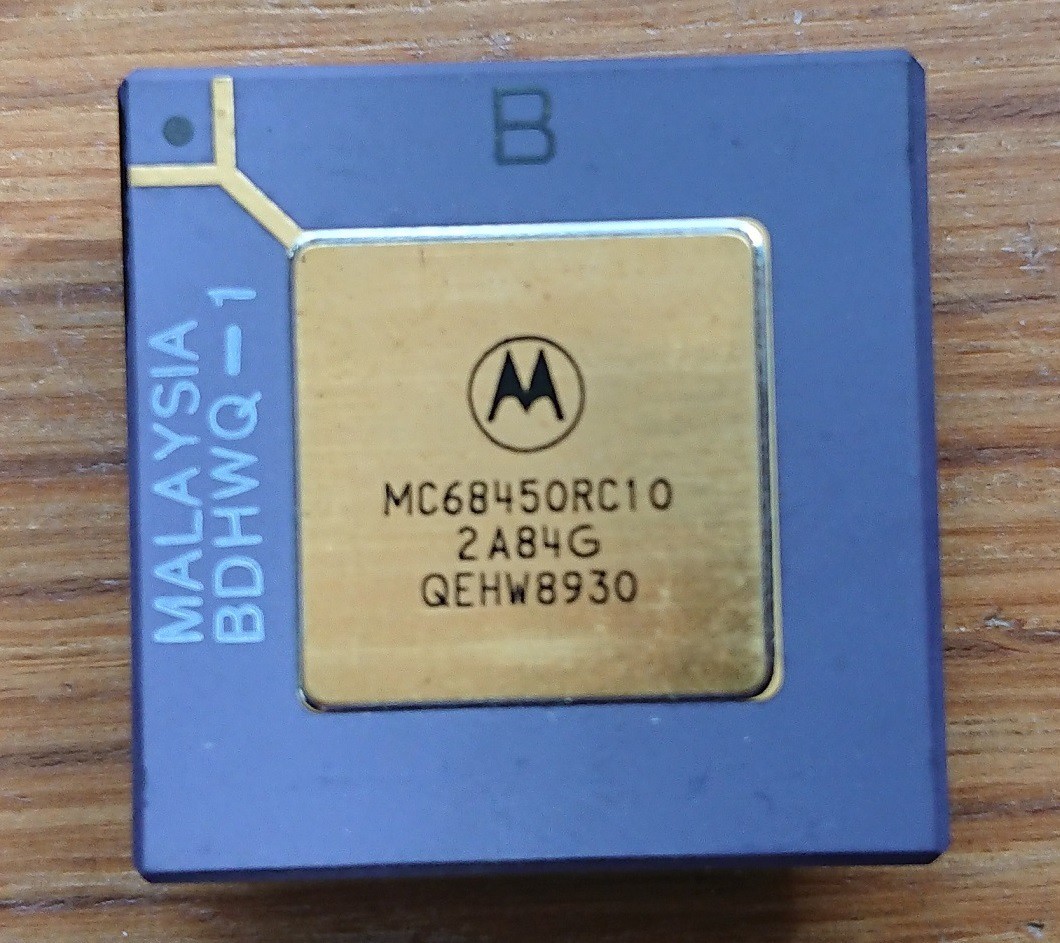

- 12.588 MHz HD63450Y12 4 channel DMA Controller
- 6.275 MHz HD63484 Advanced CRT Controller (early 2D GPU released in 1984)
