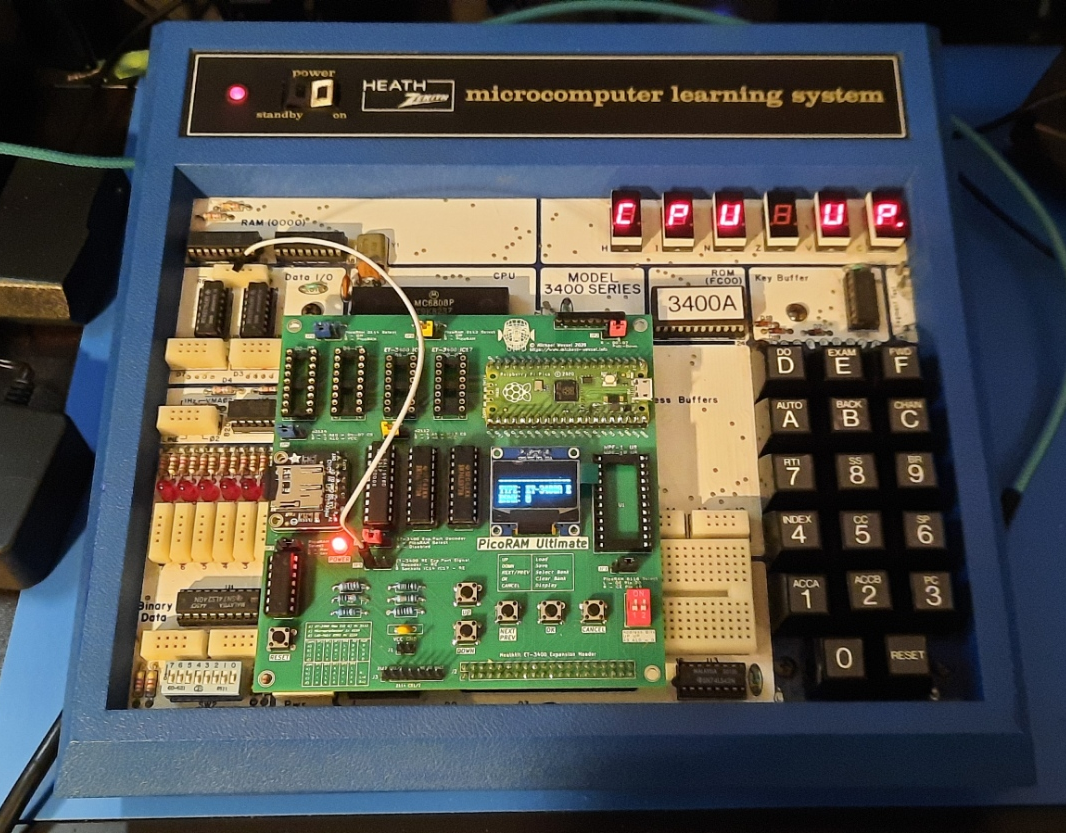

ET-3400 ROM Emulation working
01/21/2026 at 16:09 • 0 comments... both ET-3400A and ET-3400 ROM emulation are fully functional. Given that PicoRAM adds 2 KBs of emulated RAM / ROM, and the ROM starts at 0xFC00 and is 1 KB only, there was still some space to add my Towers of Hanoi program starting at 0xF800. PicoRAM's GAL was changed to map into the upper 2 KB = 0xF800 to 0xFFFF address range.
PicoRAM playing PicoROM

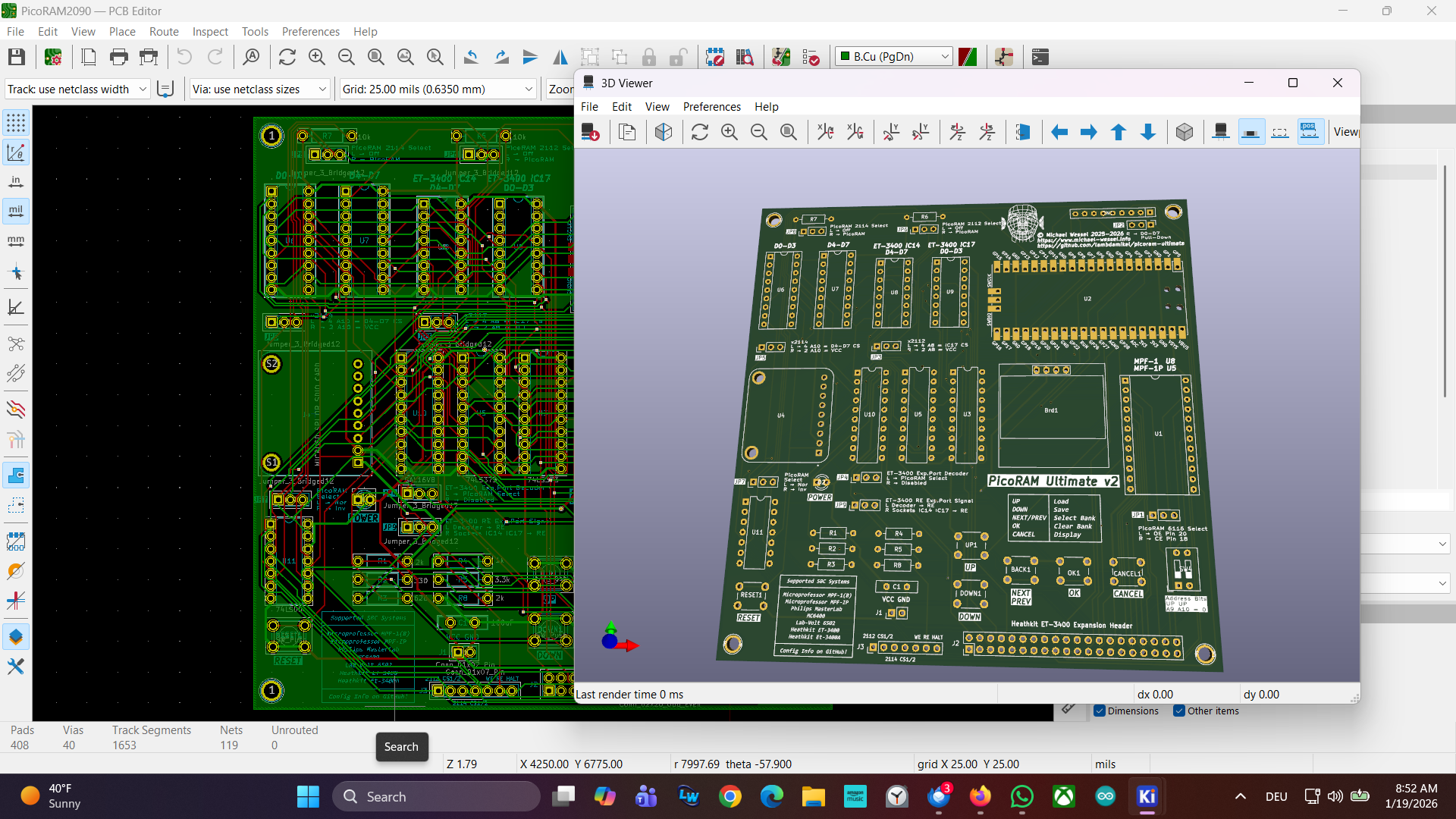

PicoRAM Ultimate Version 2!
01/19/2026 at 17:31 • 0 commentsIs currently being made - this fixes the PCB RE signal flaw on the IO header, routes more address lines into the decoder for more fine-grained control over the PicoRAM address range, and bumps it up to 4 KBs. More isn't possible because of the GPIO shortage on the Pico, and the address bus is already multiplexed. I need the other GPIOs to drive the other functions (databus, SDcard, display, ...)

PicoRAM and the 6808-Based ET-3400A
01/09/2026 at 23:20 • 0 comments... got my hands on a Heathkit ET-3400A. This one has the much faster 6808 CPU. It took me a week to get the timing right, but eventually, I got there:
