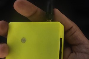

🔩 Hardware Overview
At the core, we’ve got the ESP32 — it handles all the logic and communication. That’s paired with a PN532 RFID/NFC module connected over SPI, which reads most common 13.56 MHz tags like MIFARE Classic and NTAG, with a read range of about 2 to 5 centimeters.
The display is a 0.96-inch OLED screen using I2C. It’s compact, low power, and perfect for showing tag scans, signal strength, and system status in real time.
To keep everything powered reliably, I’m using an AM1117 voltage regulator to step down battery voltage to a stable 3.3V — important if you’re running this from a Li-Po cell.
A TP4056 charging module handles battery charging and includes protection features. You just plug it in via micro USB, and it charges safely.
For programming and Serial monitoring, there's a CP2102 USB to UART bridge. It makes flashing firmware and debugging straightforward.
I also threw in a WS2812 Neopixel RGB LED for status indication — like changing colors when a tag is detected, an error occurs, or the device is jamming.
