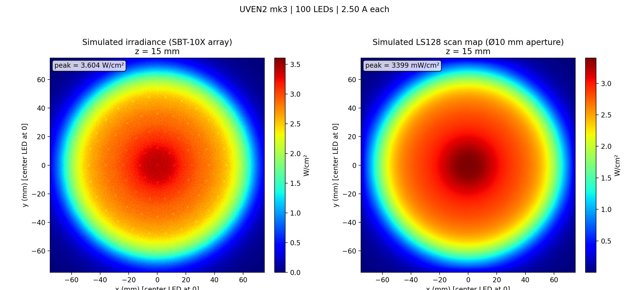

    Something we probably should have done before deciding on the layout of the LED panel...
    Luminus provides zemax ray spectrum files for their LEDs. So we were able to simulate the optical power distribution of our LED panel.
    We had somewhat arbitrarily decided on the substrate to be at 10mm distance from the LEDs. Using the simulation this reveiled hot spots.
    Simulating at increments of 1mm, a much more homogenous optical power distribution should be at 15mm.
    The center still showed a hot region. Removing the center LED would fix this to some extend.
    So we decided to implement these changes in the final design. In CAD we moved the entire LED panel 5 more mm away from the substrate plane. When ordering the LED panel, one should mark the center LED as do not assemble.

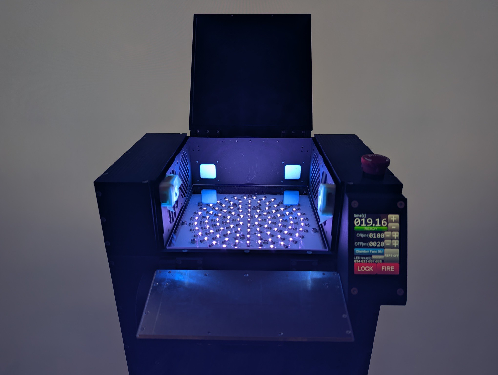

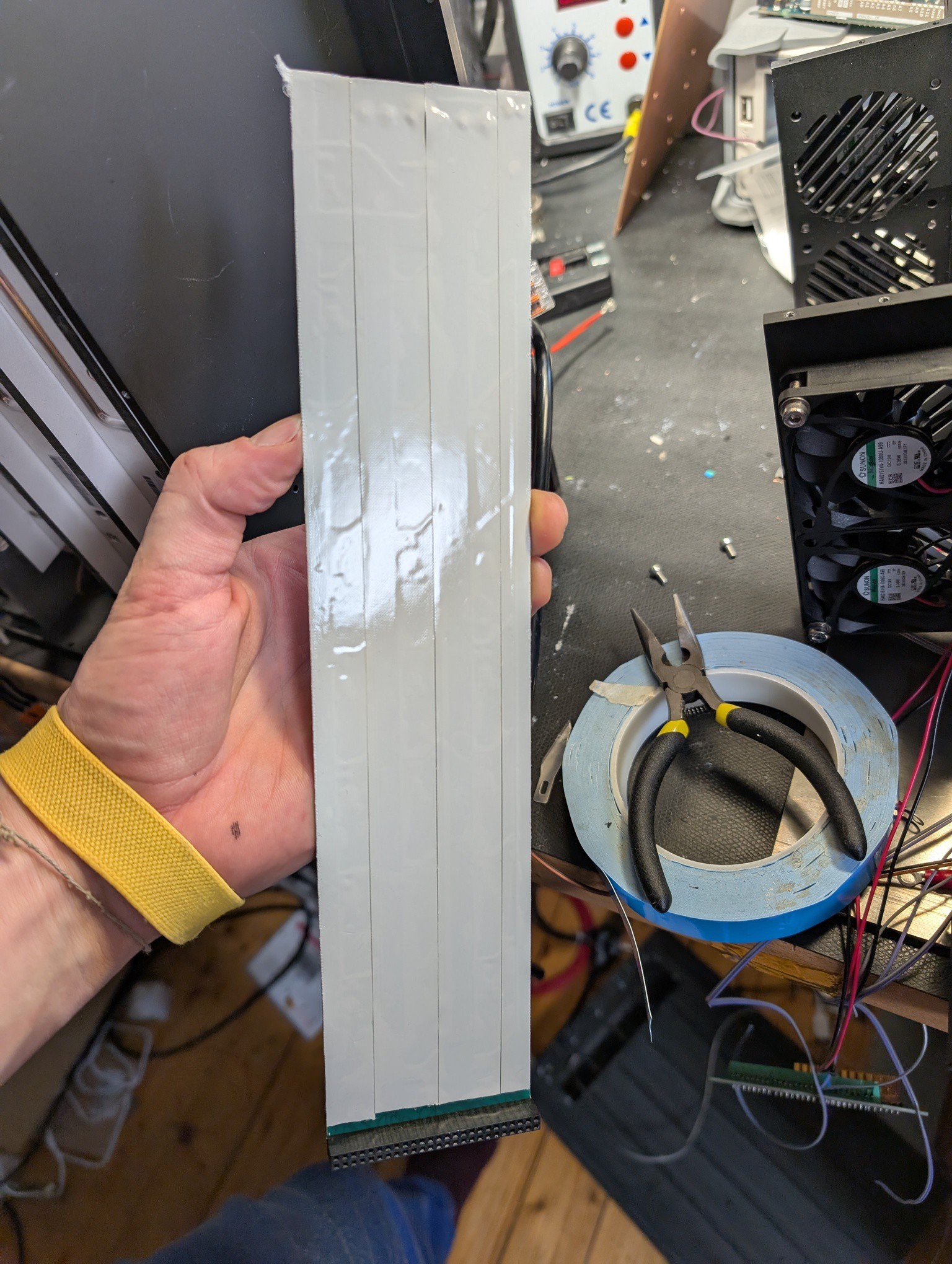

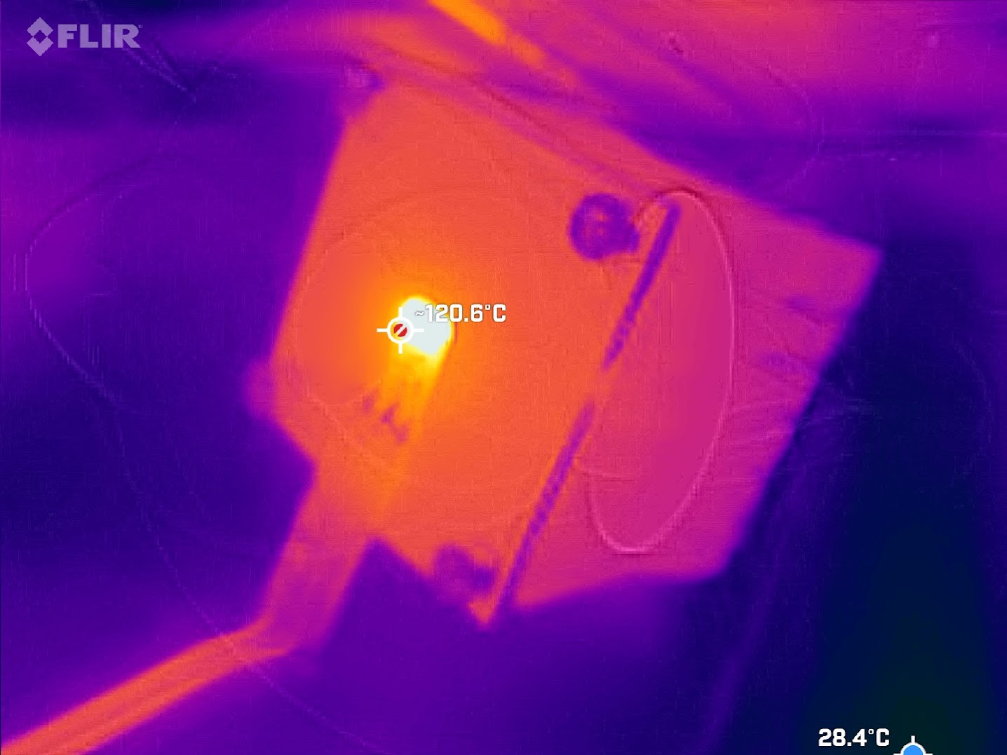

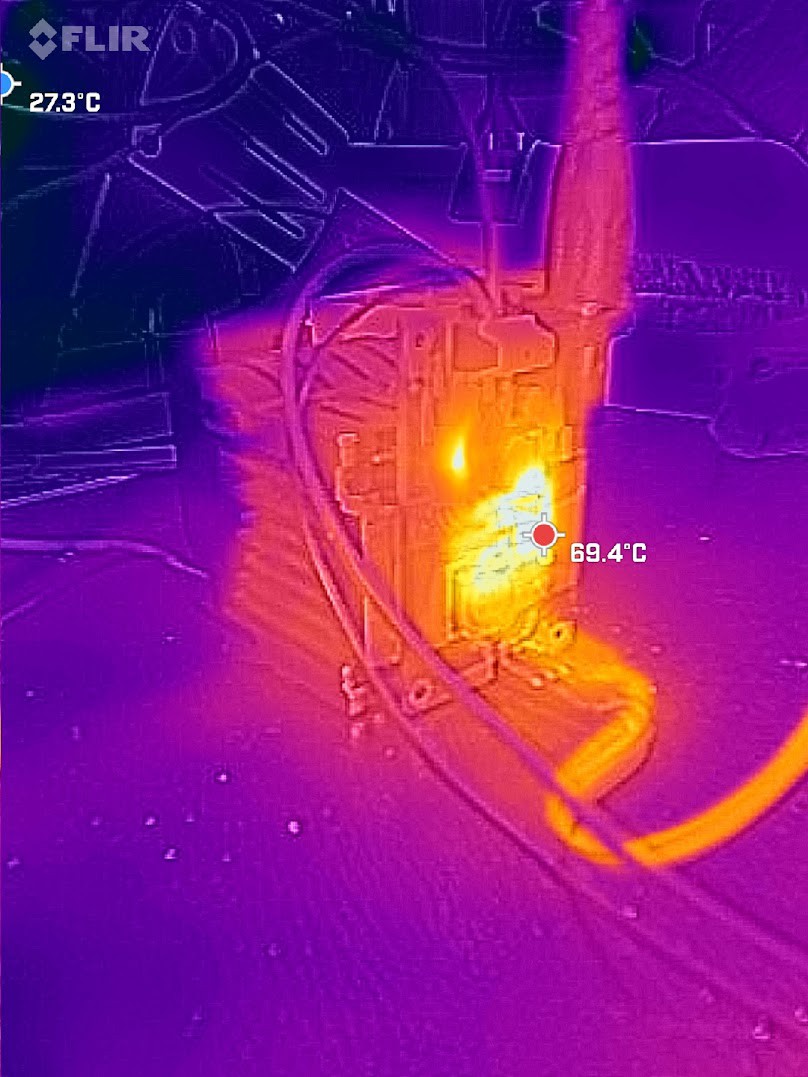

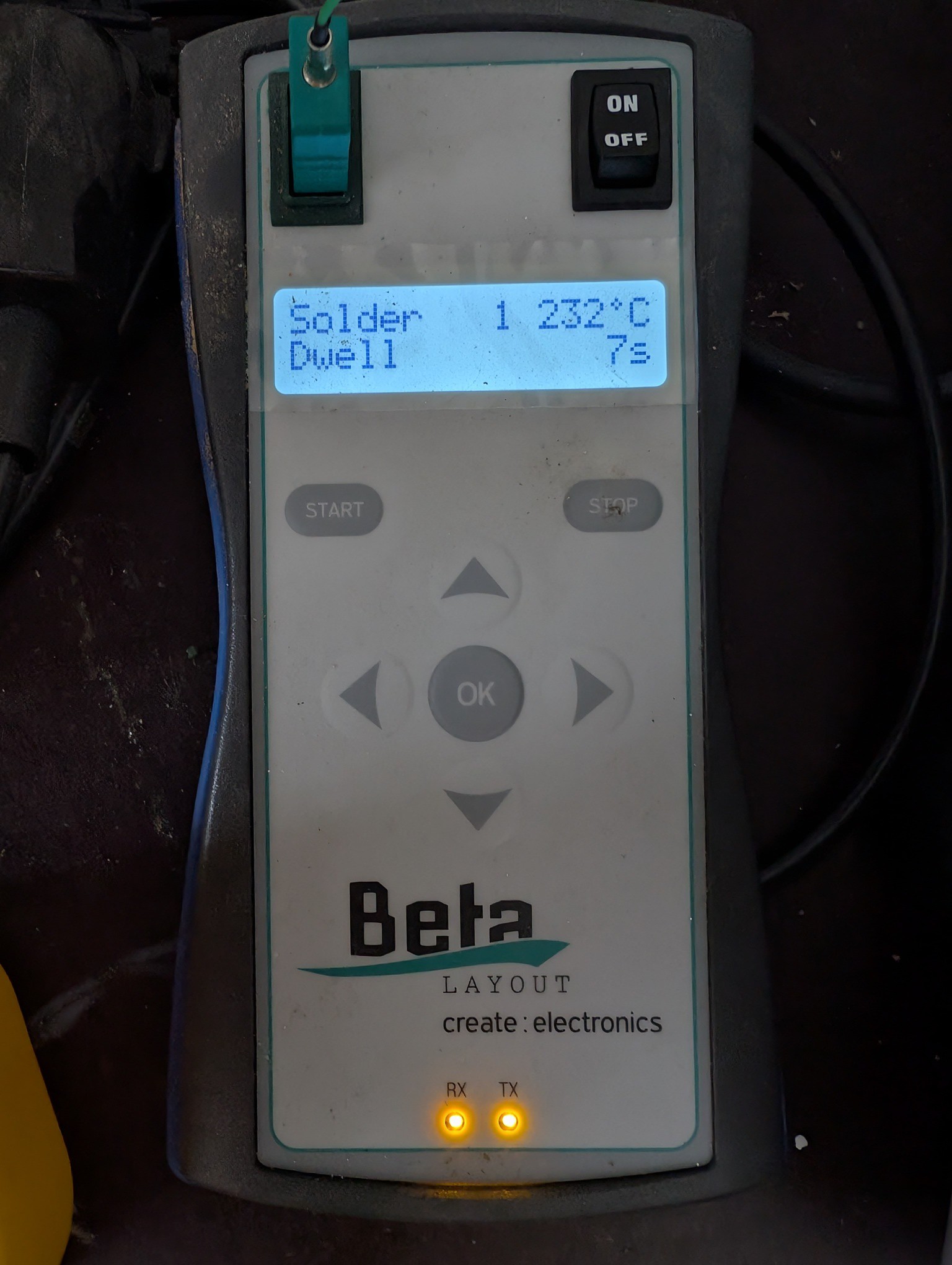

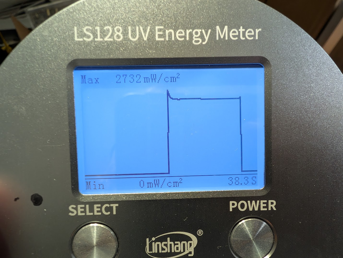

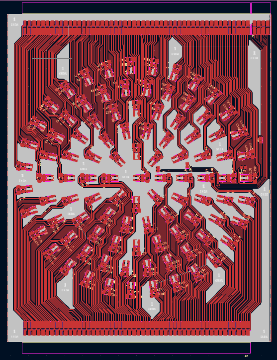

  • LED panel performance
    Simon Trendel • 01/05/2026 at 20:18 • 0 comments

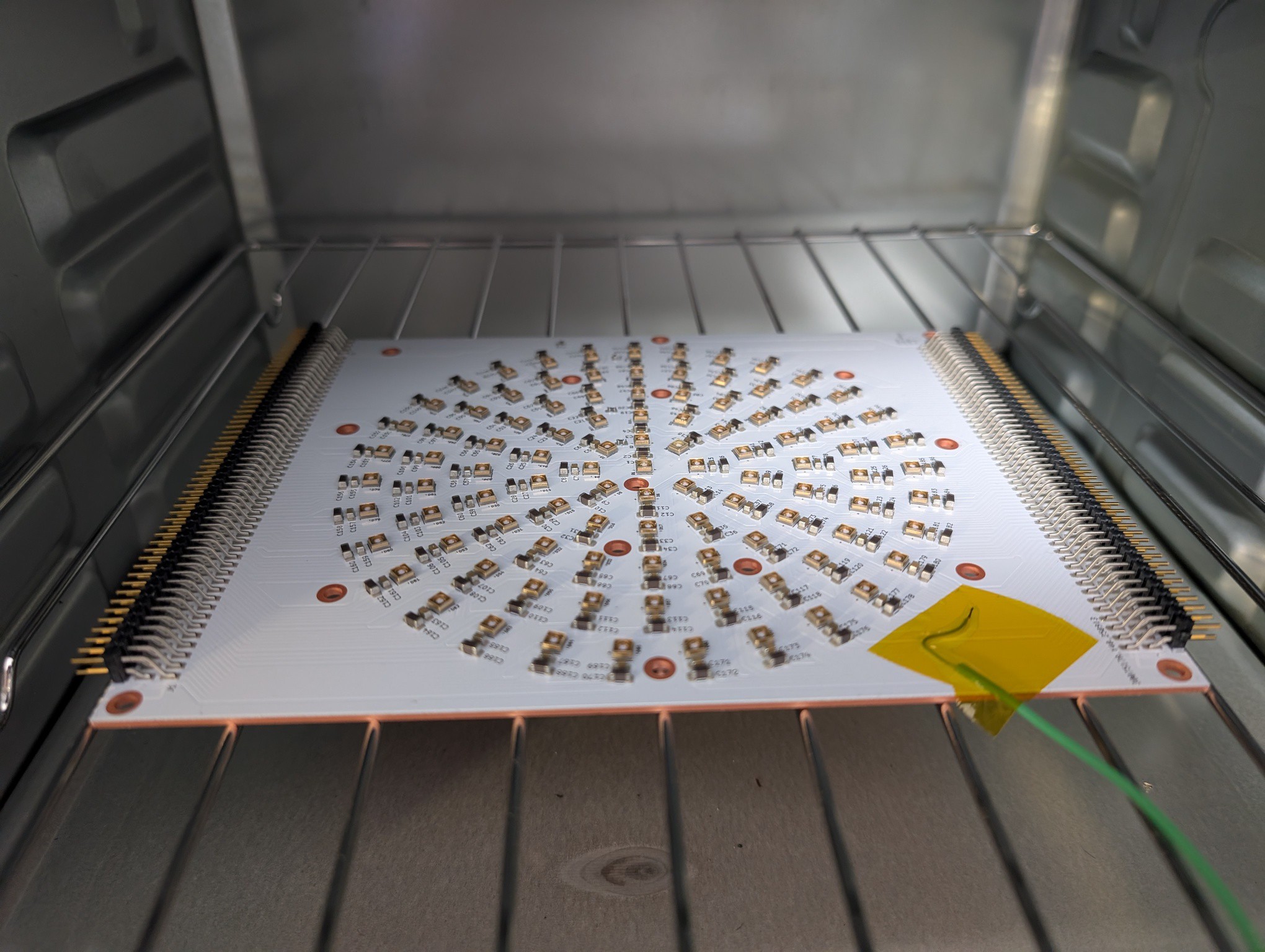

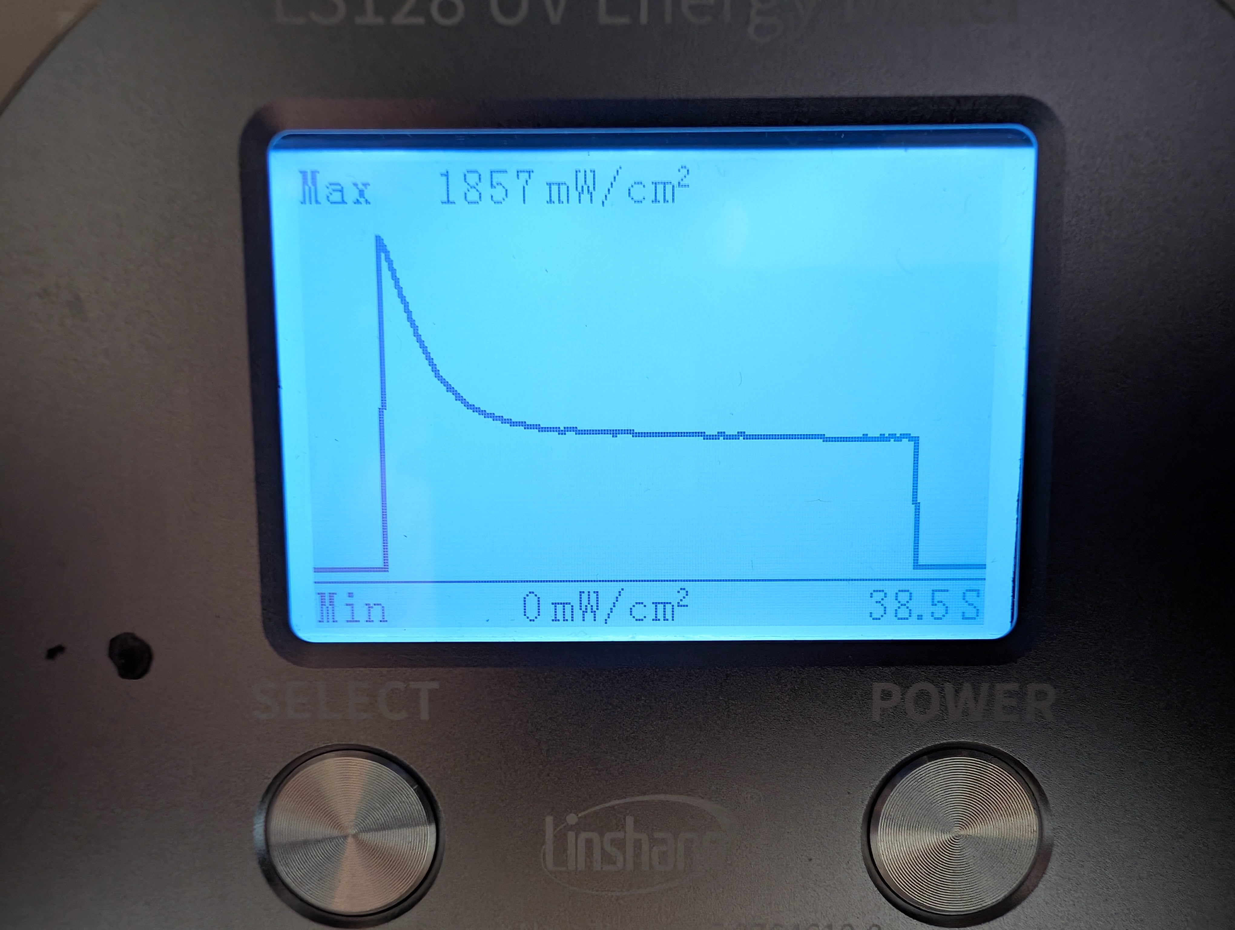

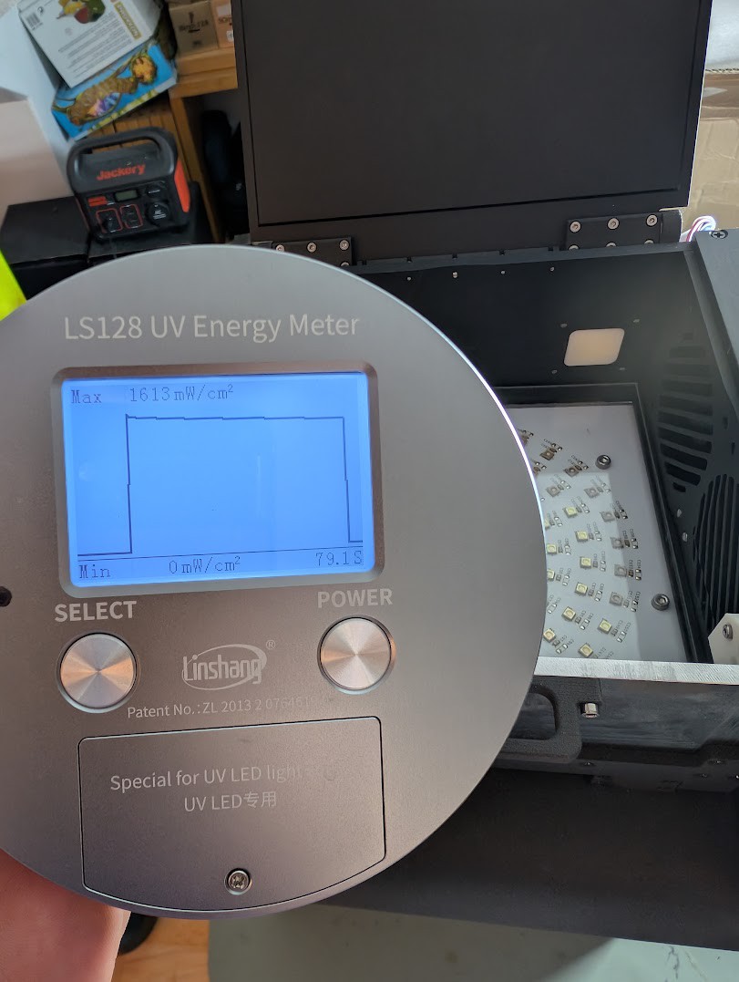

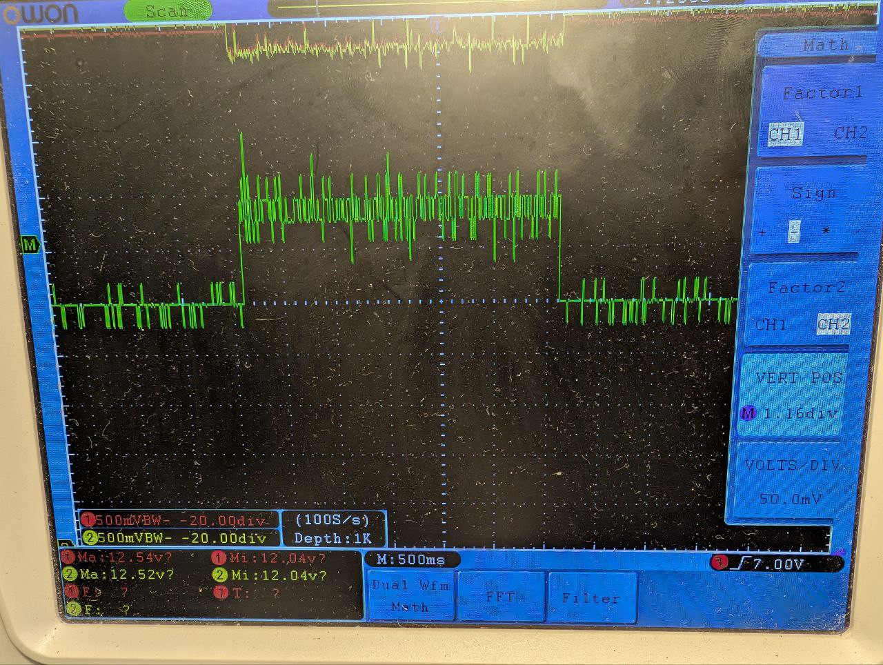

    We tested the fully assembled device and unfortunately the optical power dropped to 40% after a short duration.

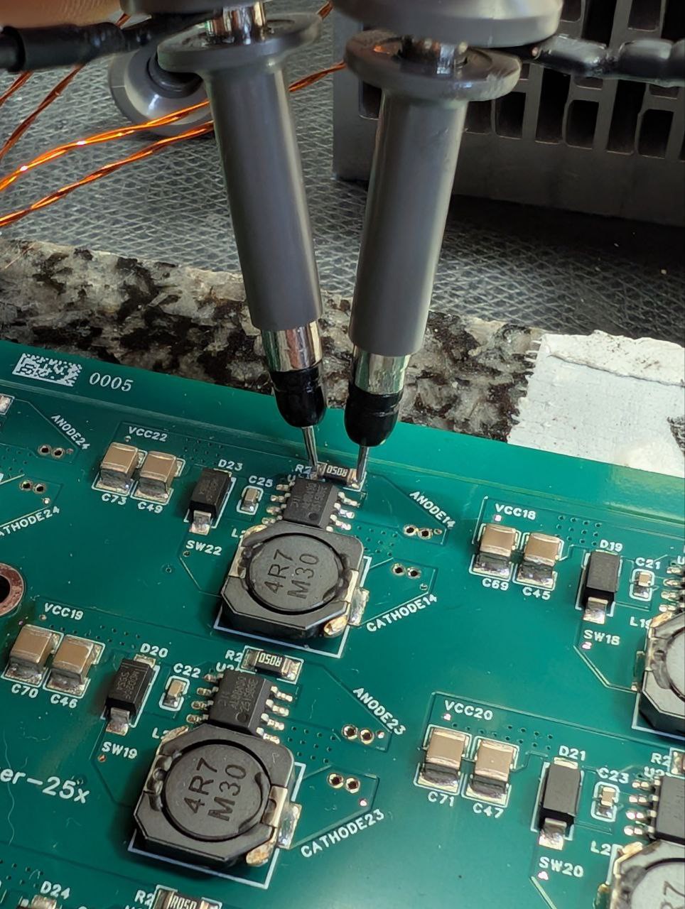

    This was unacceptable and we needed to investigate. Probing the voltage across the current sense resistor showed the driver was working correctly.
    The only possible reason seemed to be a thermal problem. When ordering the LED panel as copper base PCB, one needs to define thermal heat sinks. These are areas of the PCB that are full copper and can provide excellent thermal dissipation. Unfortunately in this version, we had not defined the heat sink pad of the LED as direct heat sink. To test this hypothesis we modified one of the test PCBs by milling out the heat sink pad and mounting a fitting copper heat sink into this slot.
    And indeed, the optical power now was stable.

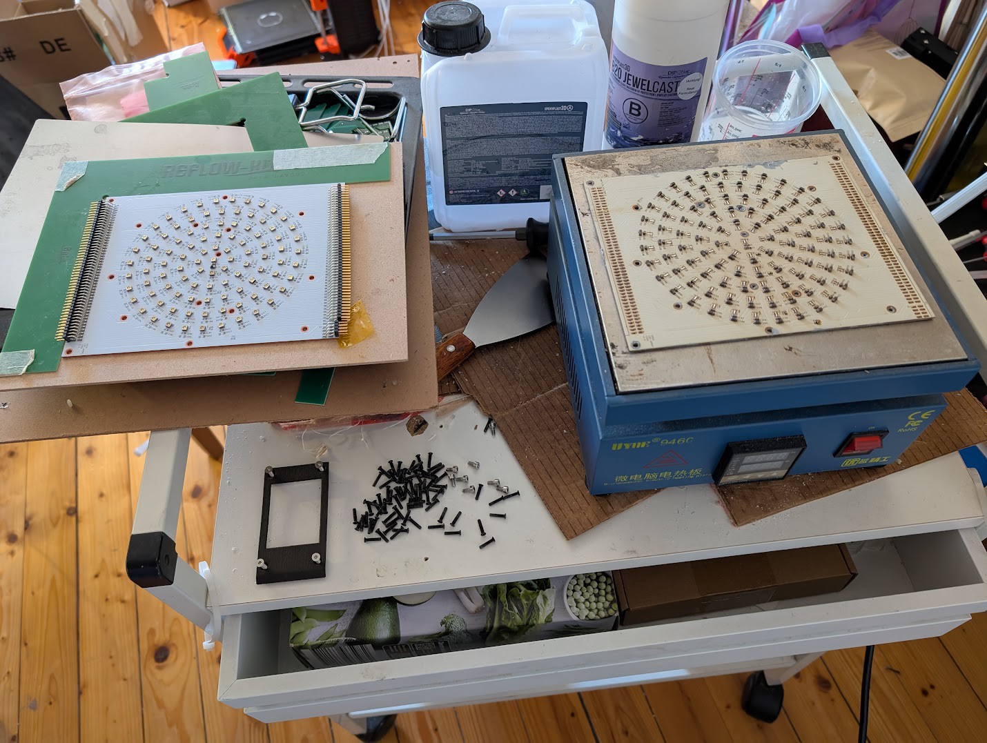

    So we ordered a new version of the LED panel. The white areas in the layout are direct heat sinks.
    We then desoldered all 100 LEDs and resoldered them to the new panel.
    And finally the test in the fully reassembled device showed much more stable optical power output.

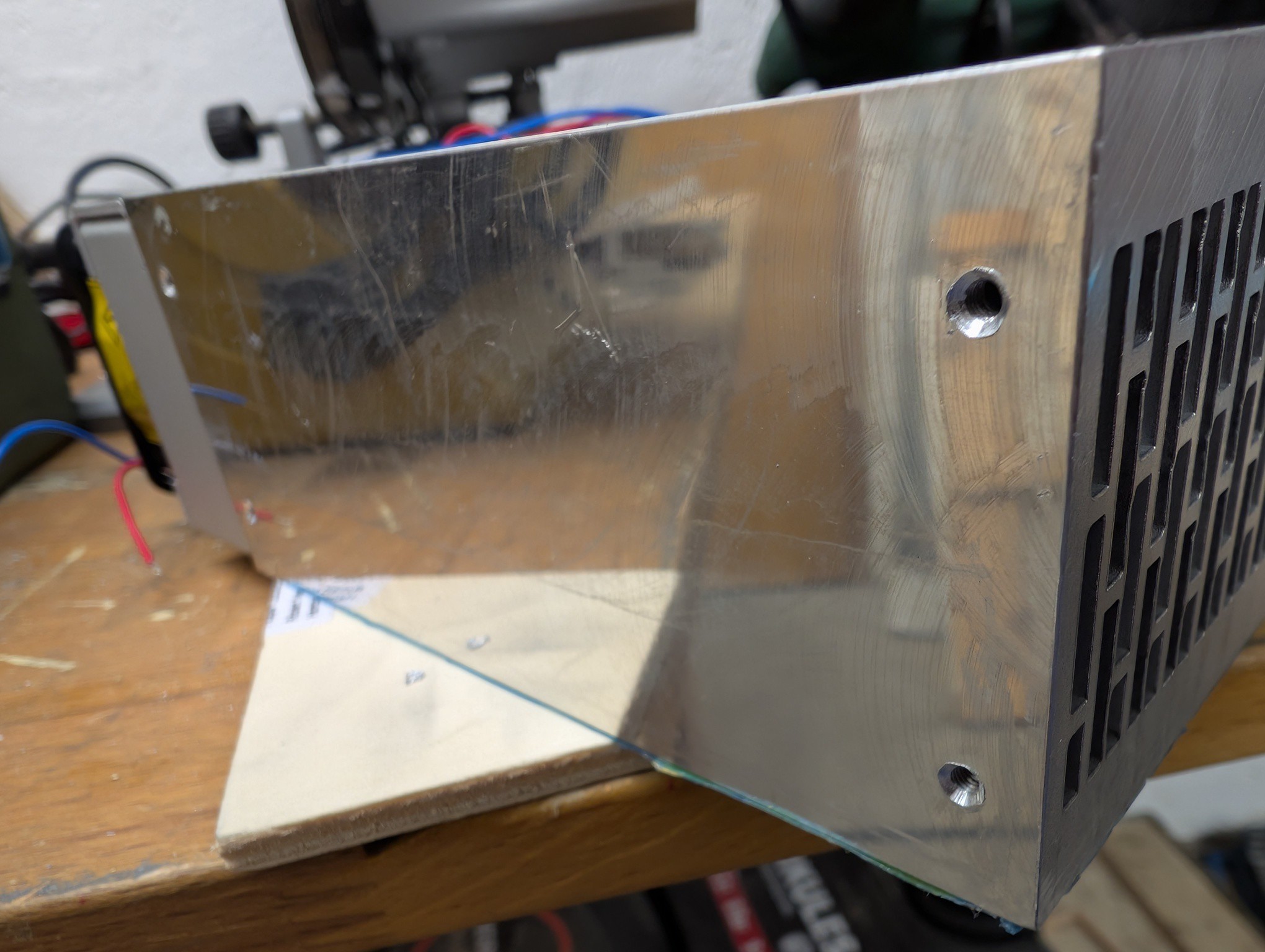

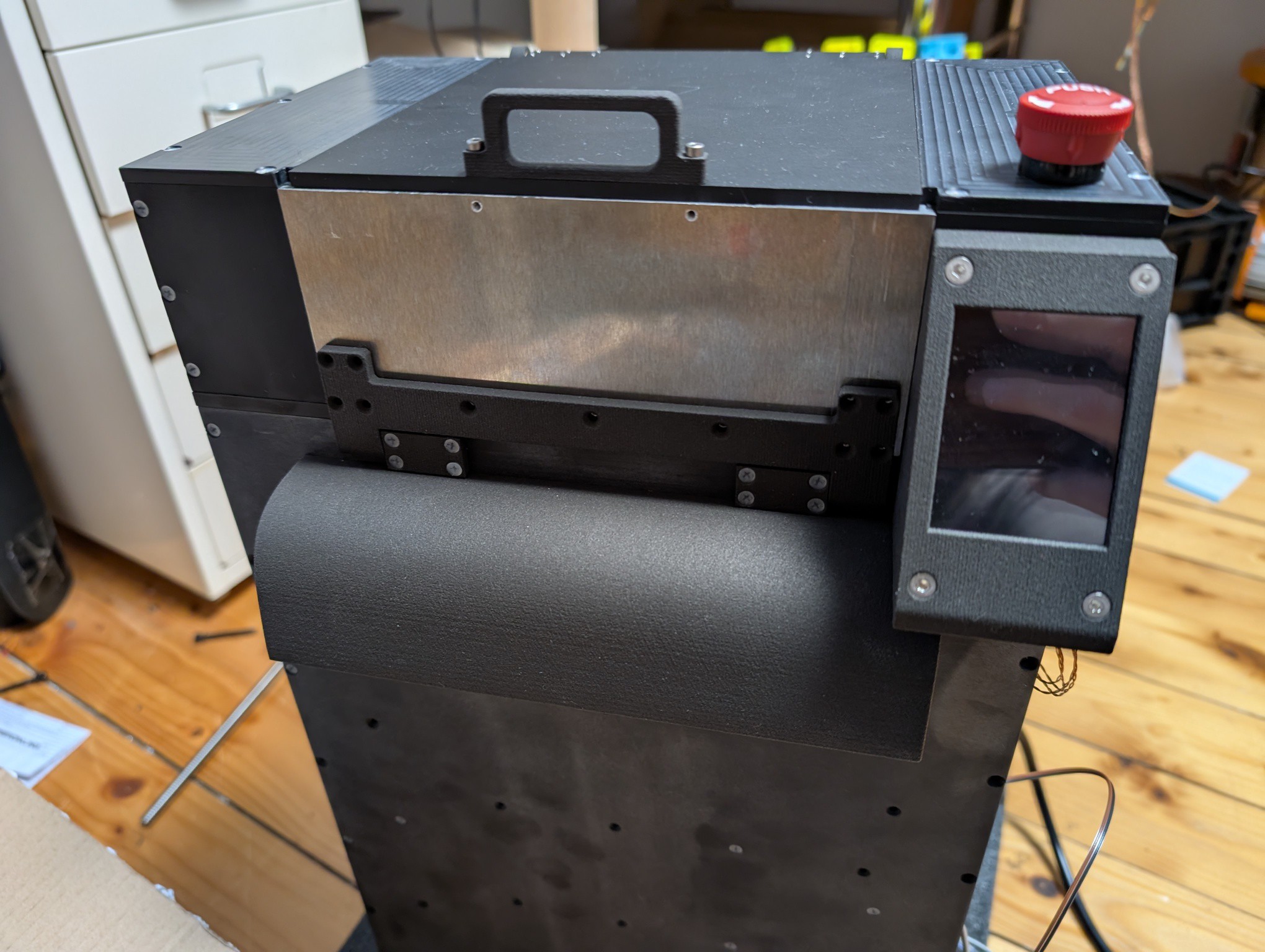

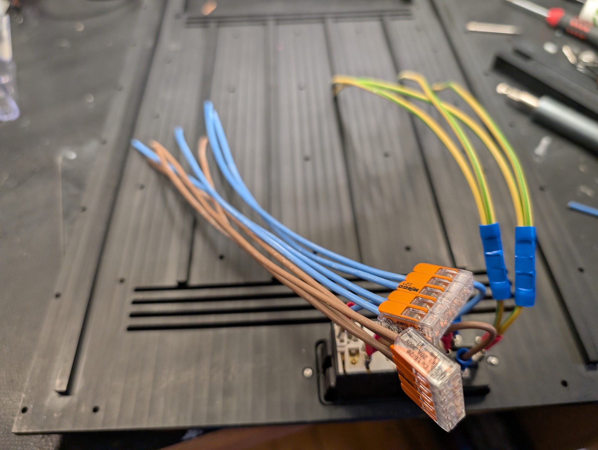

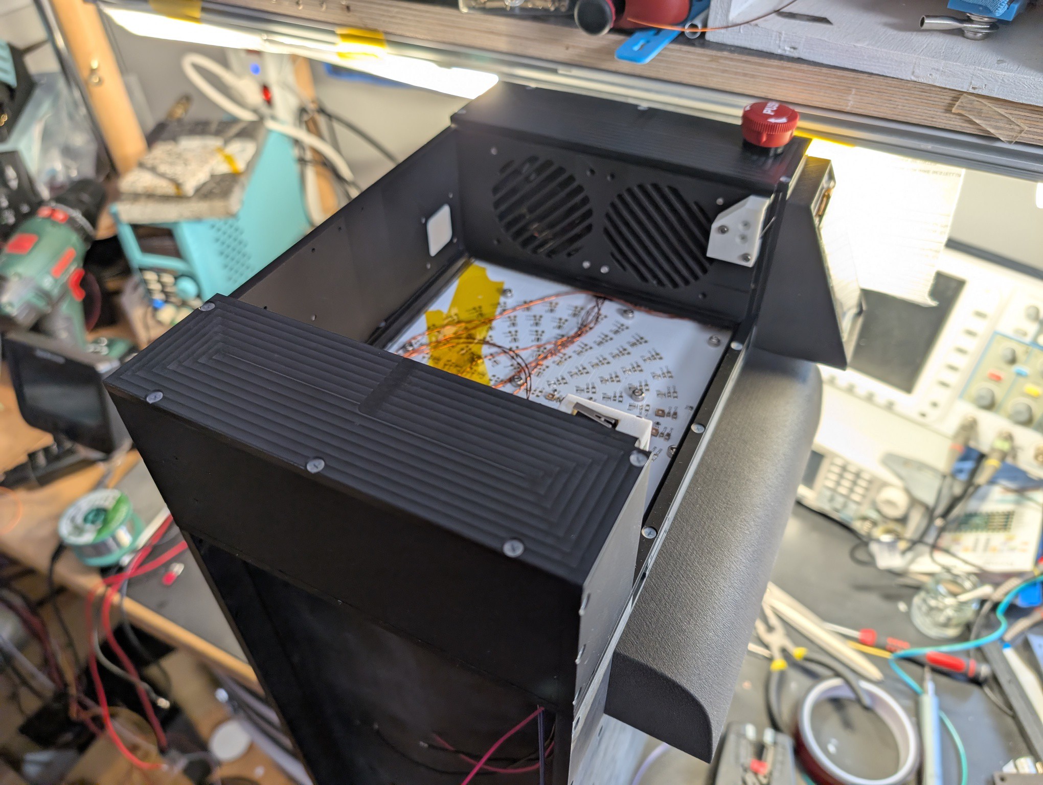

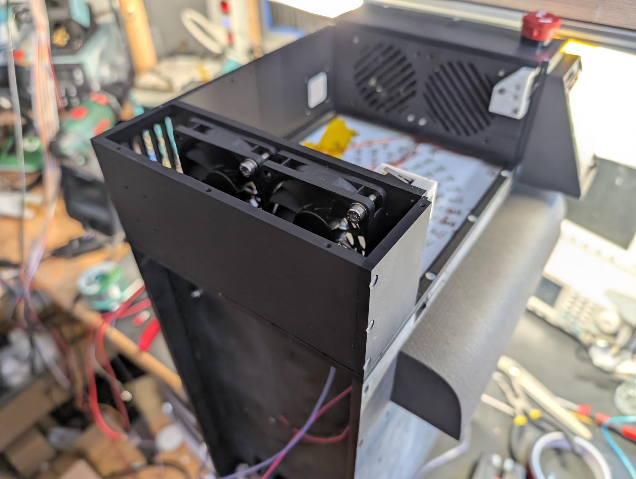

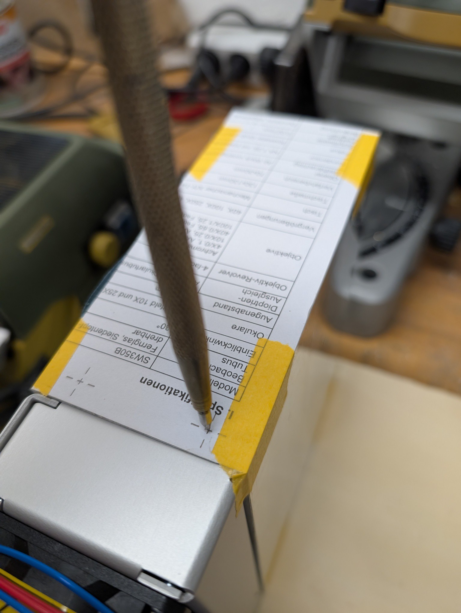

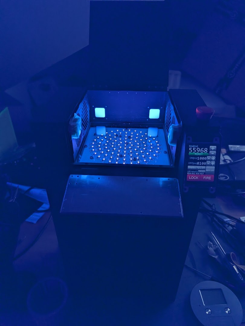

  • Final assembly #3 - light it up
    Simon Trendel • 11/06/2025 at 12:46 • 0 comments
    I forgot to order the front lid, so I machined it in my workshop

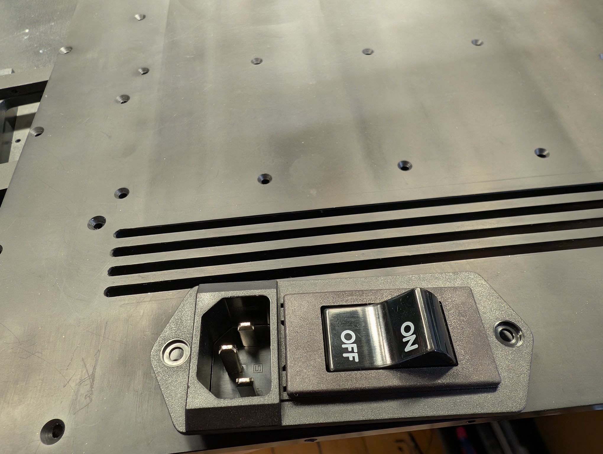

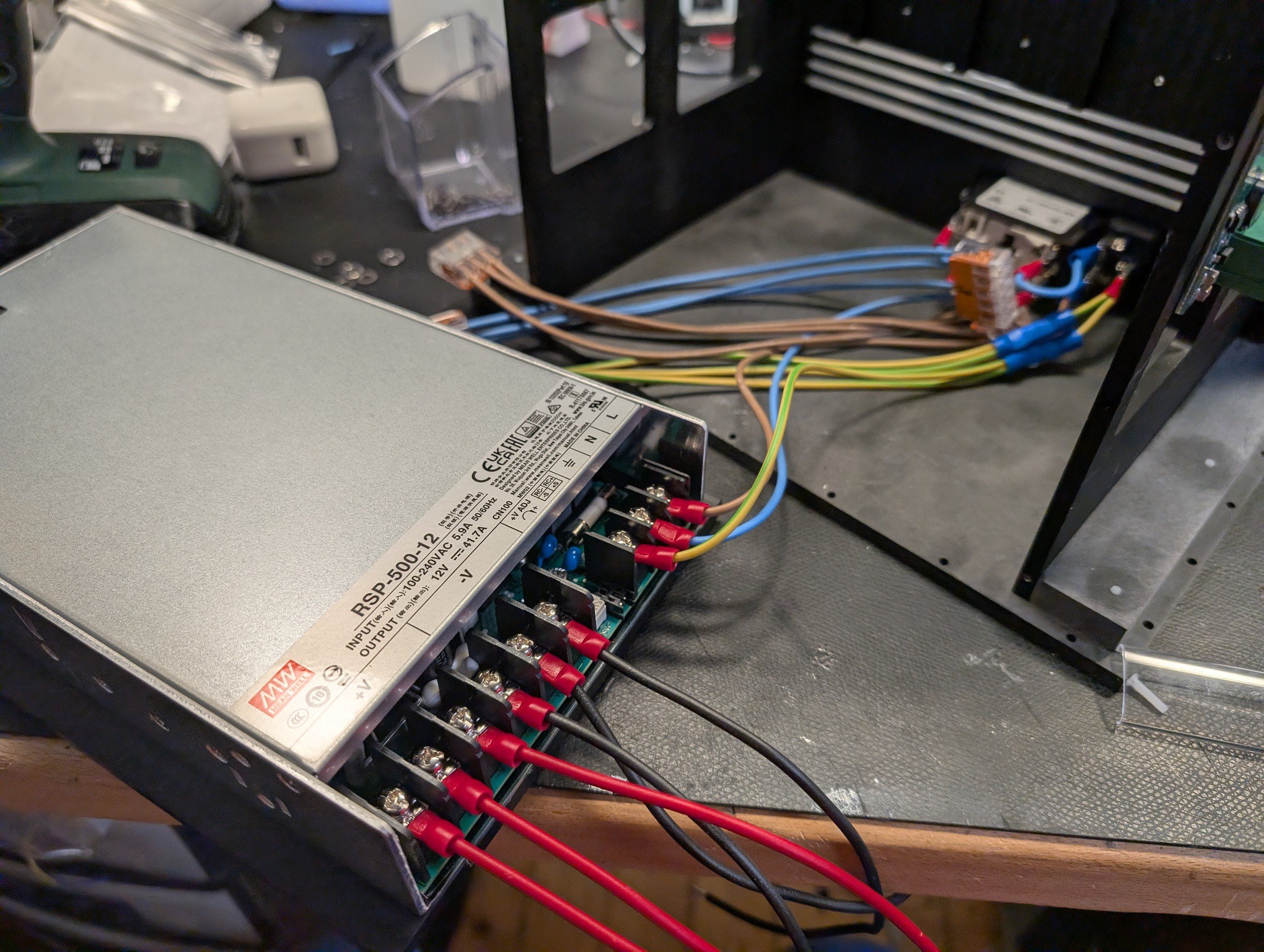

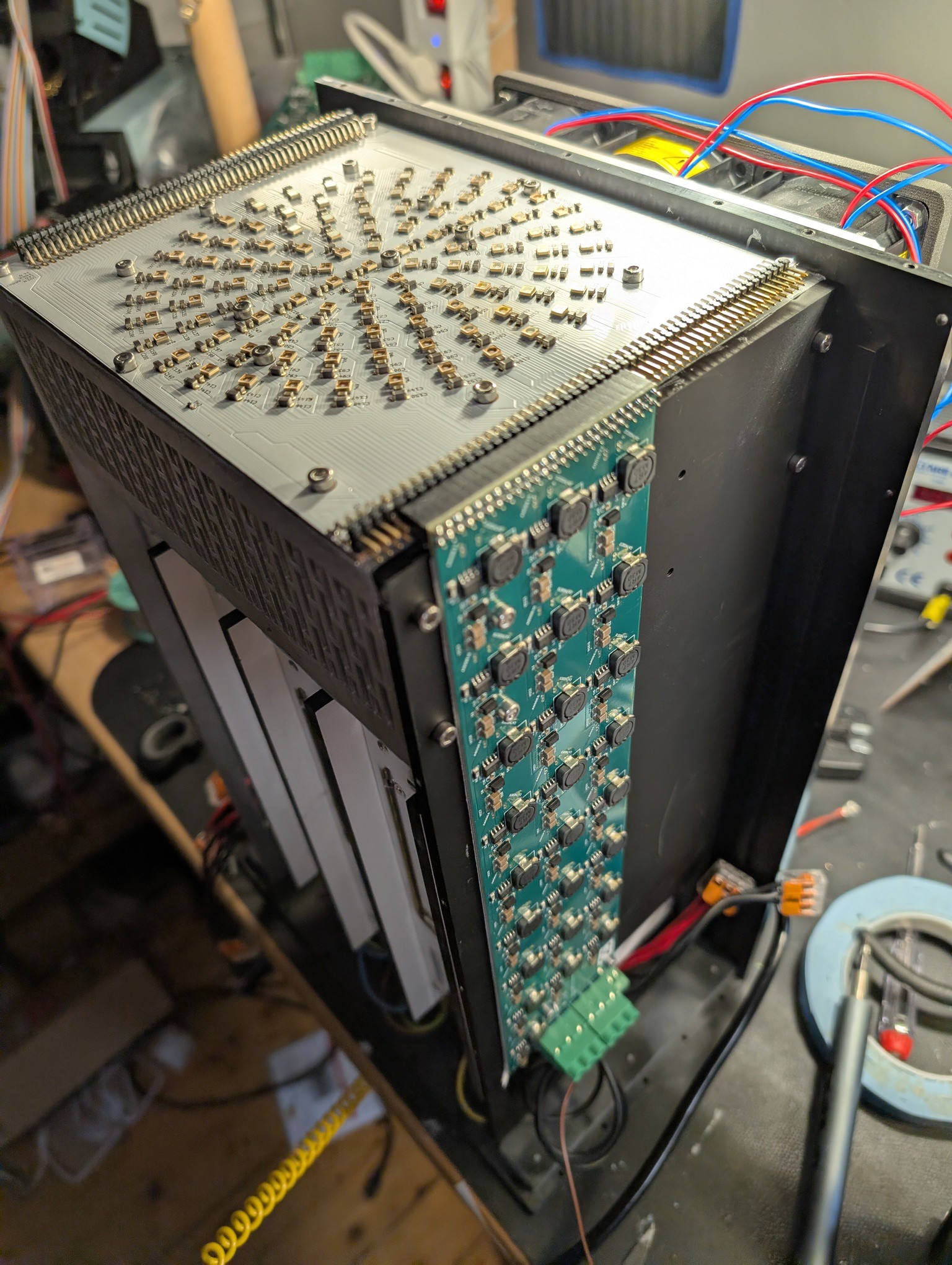

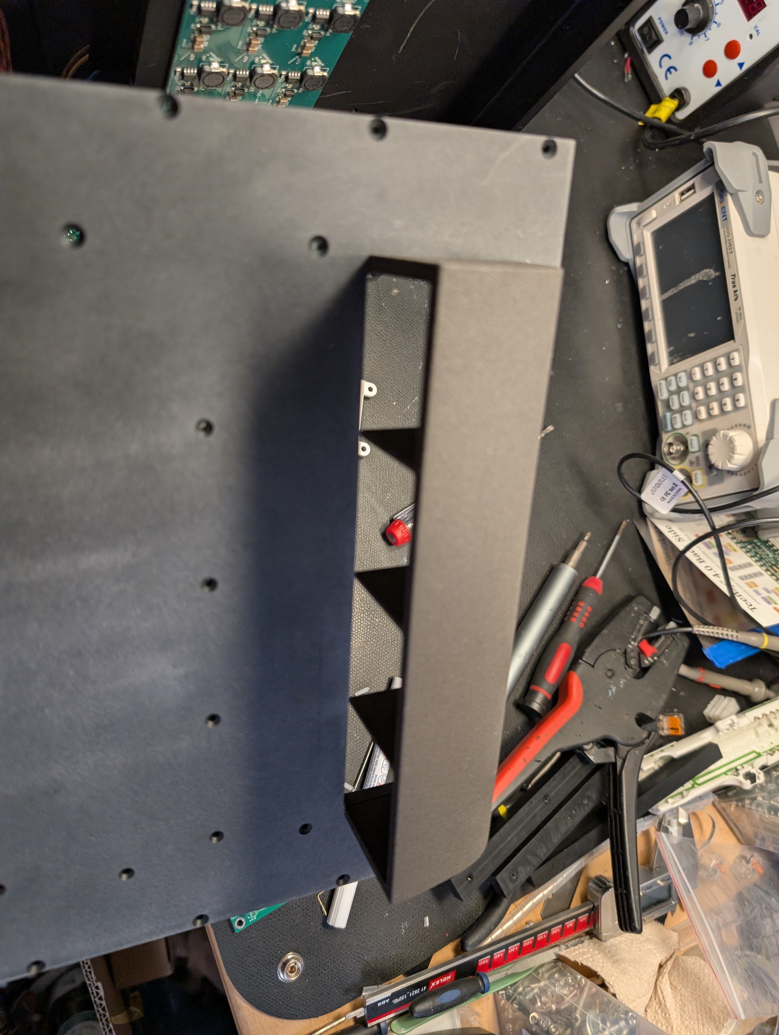

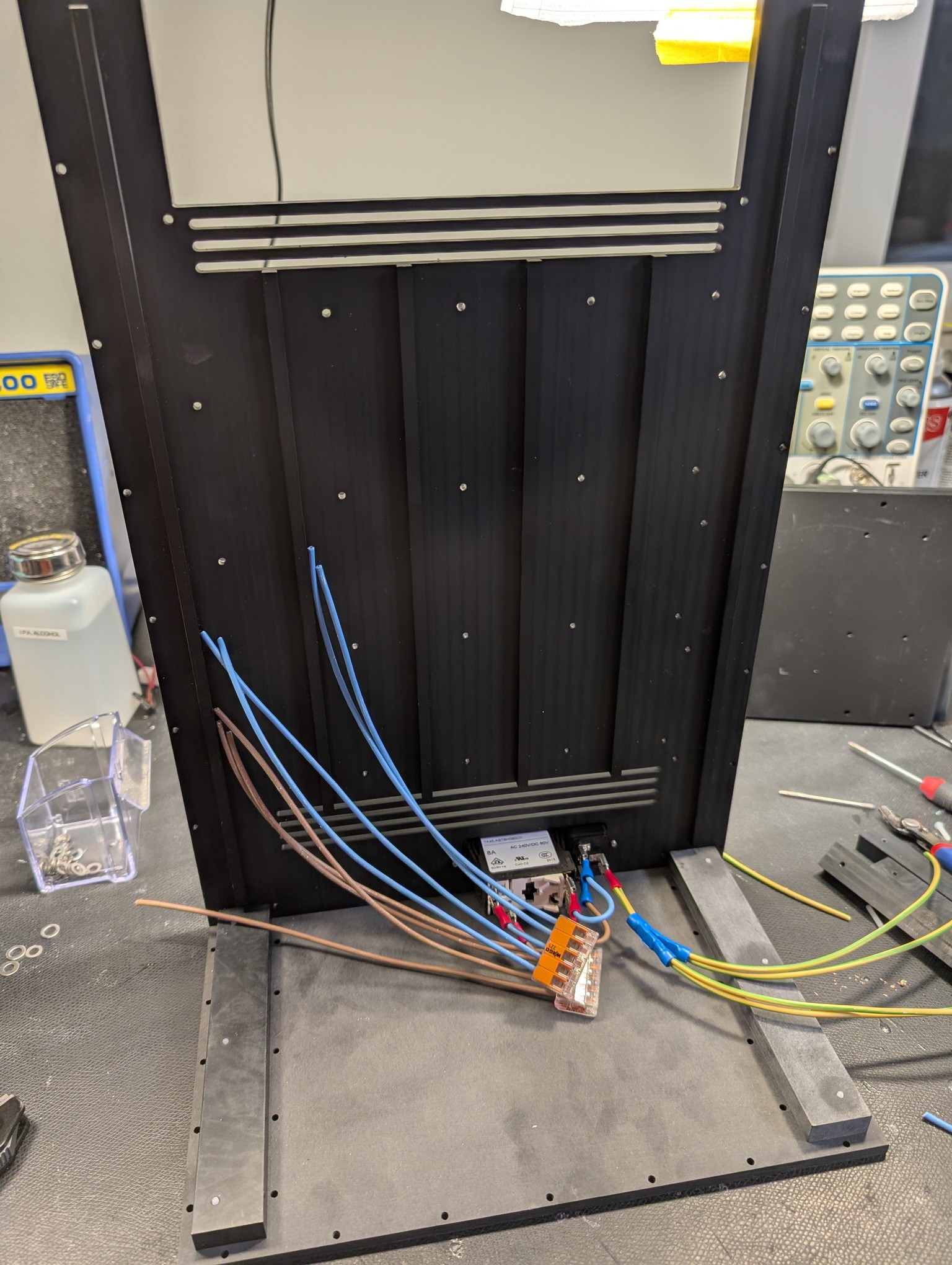

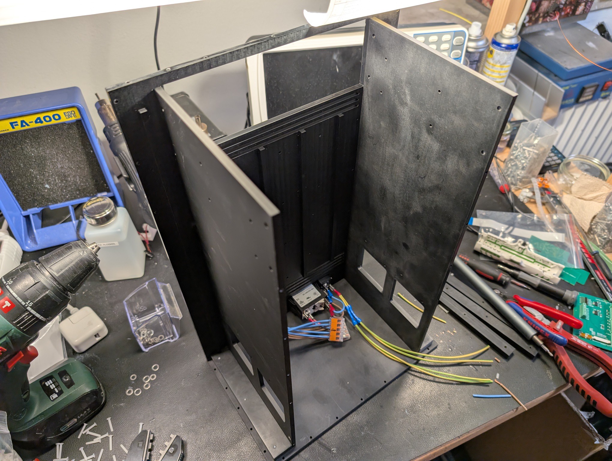

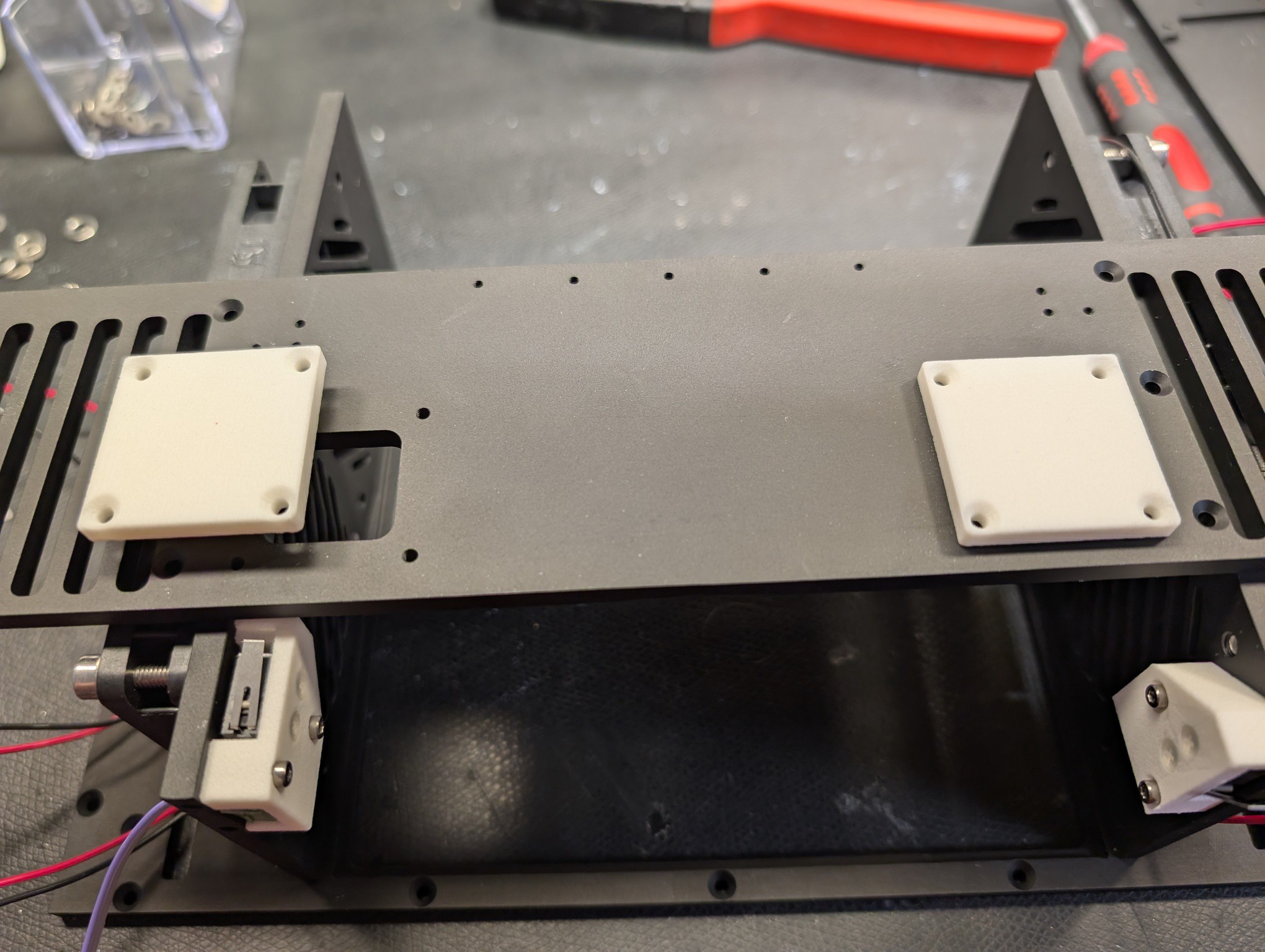

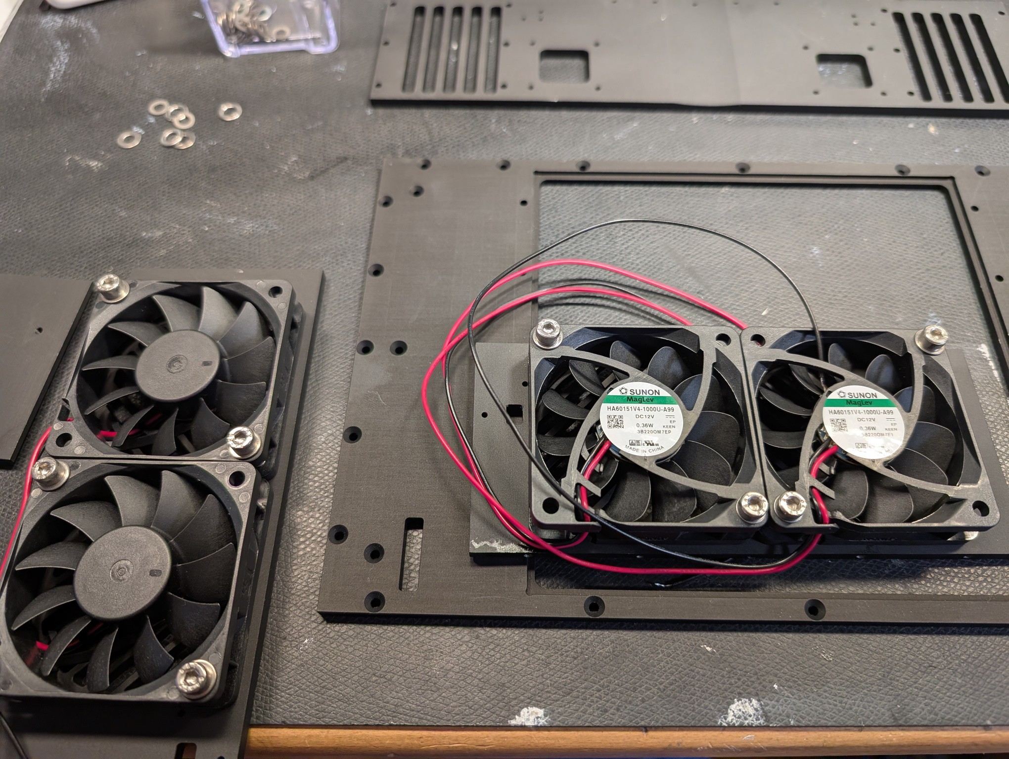

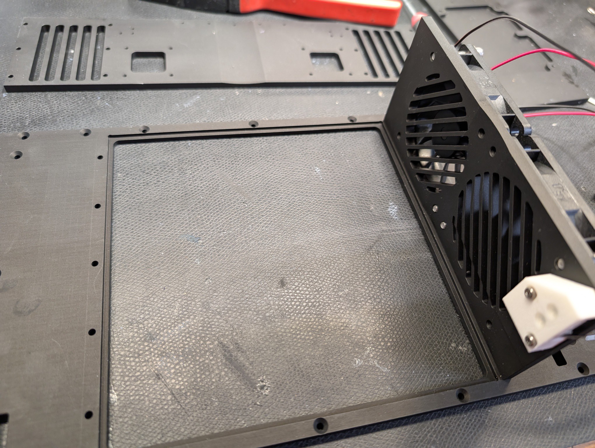

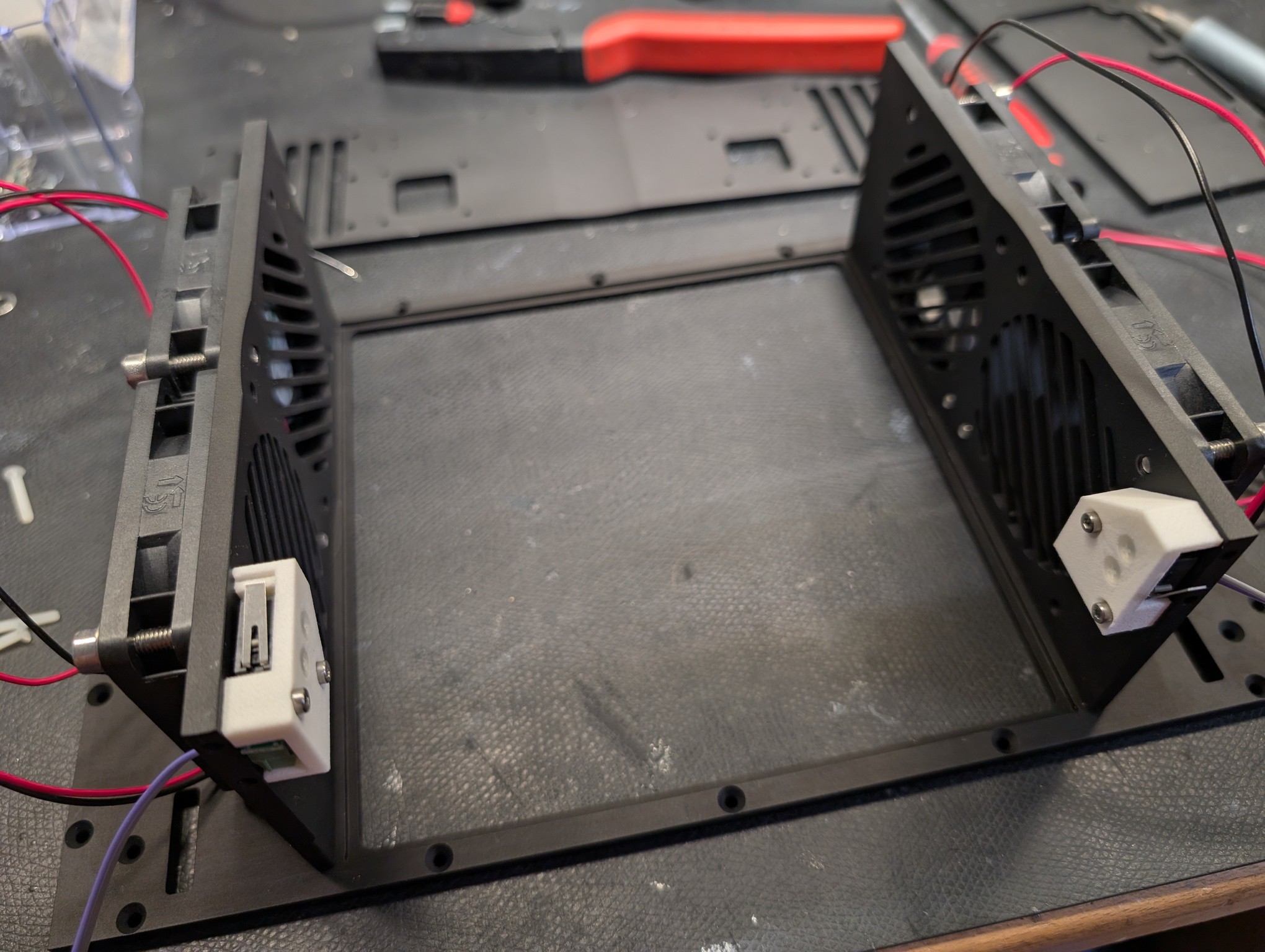

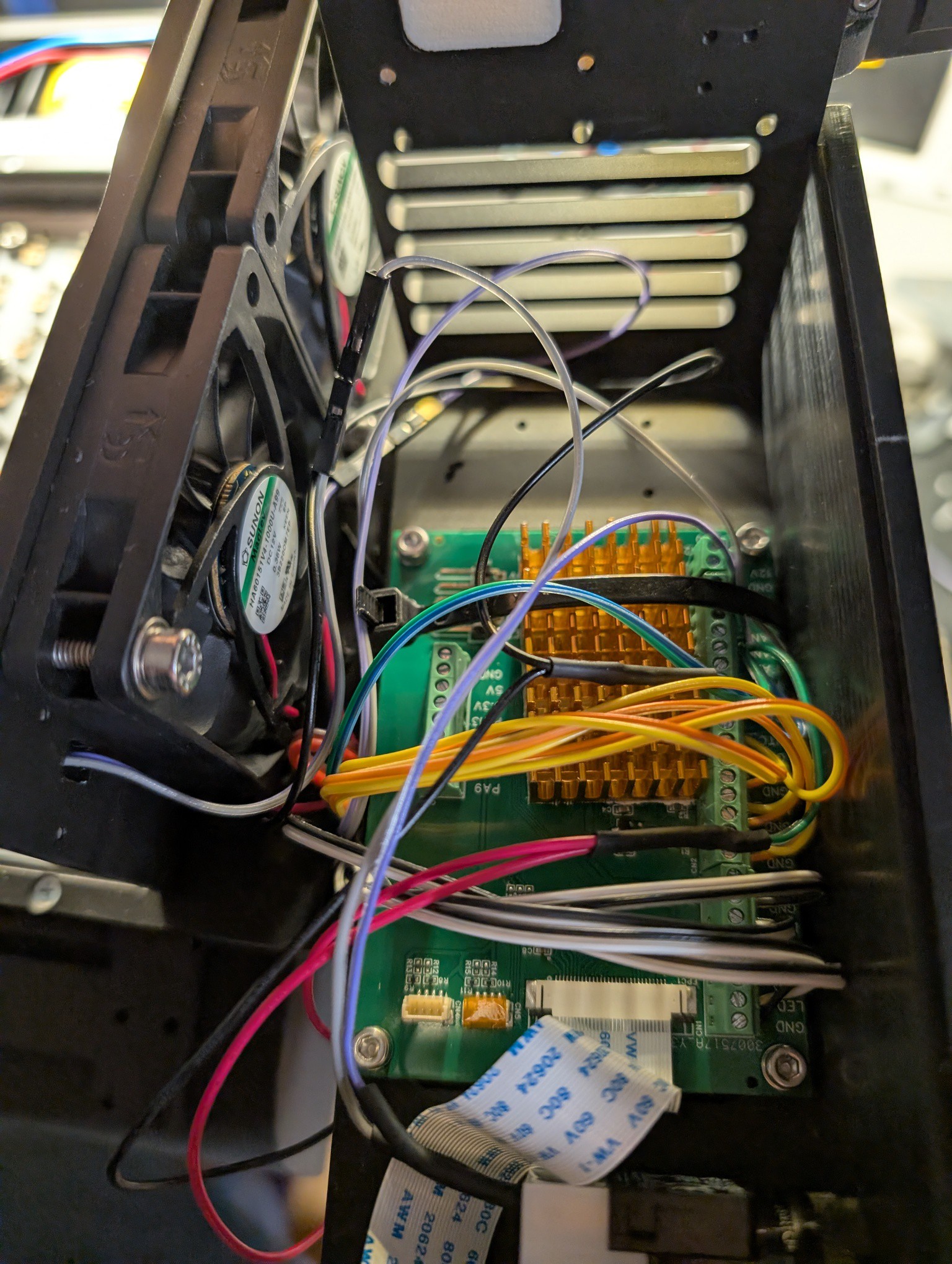

  • Final assembly #2 - put it all together
    Simon Trendel • 11/06/2025 at 12:39 • 0 comments

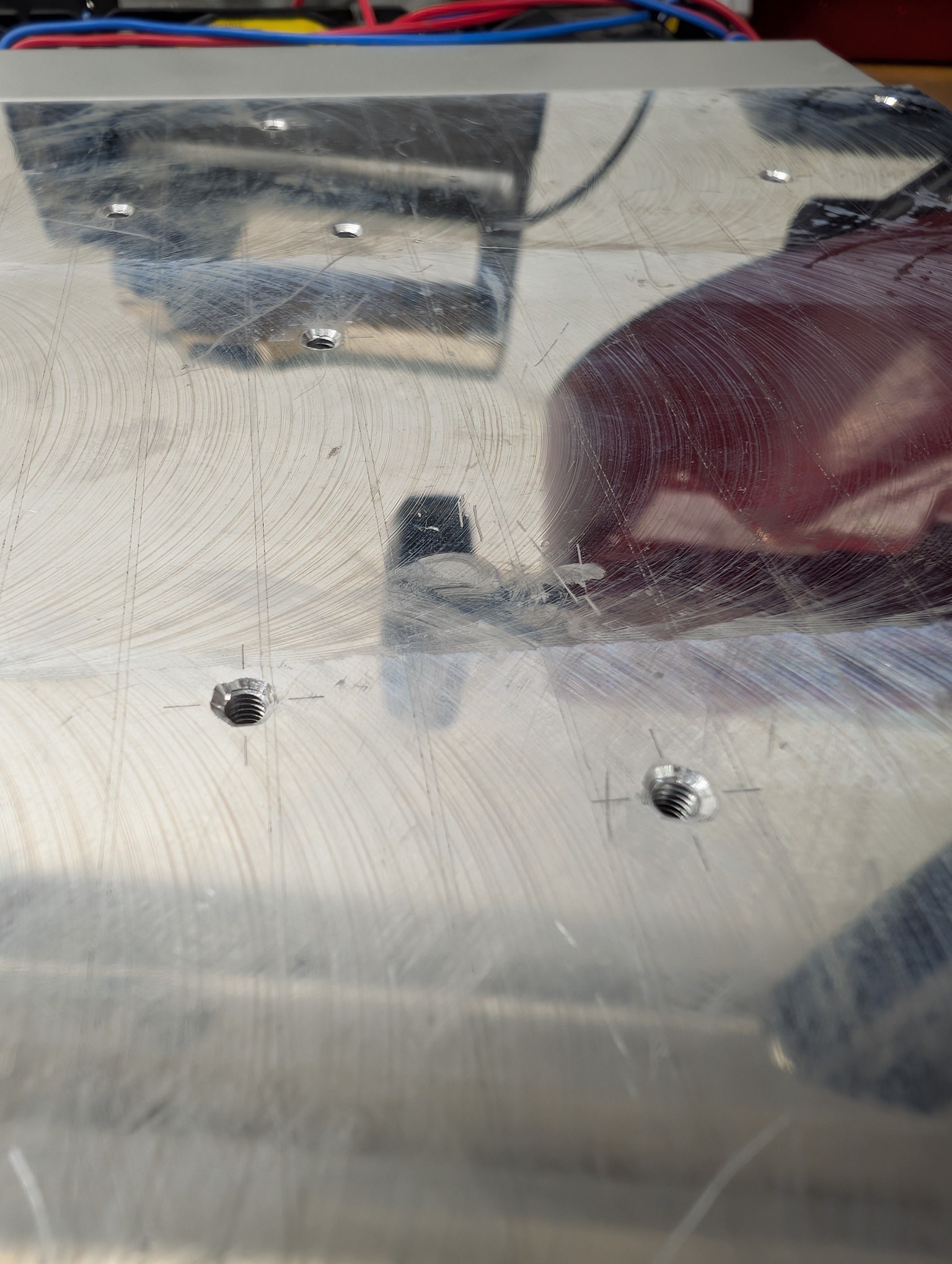

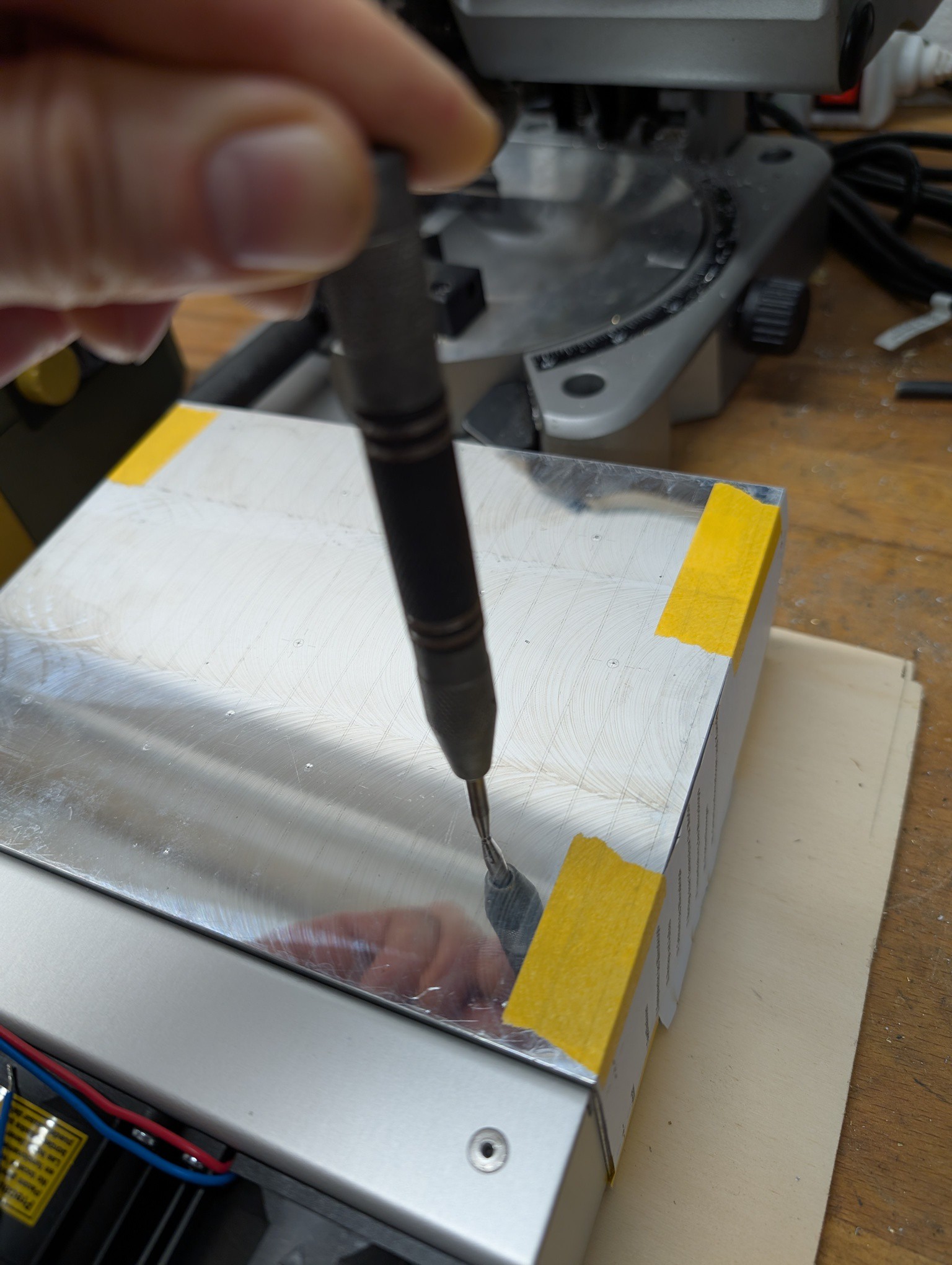

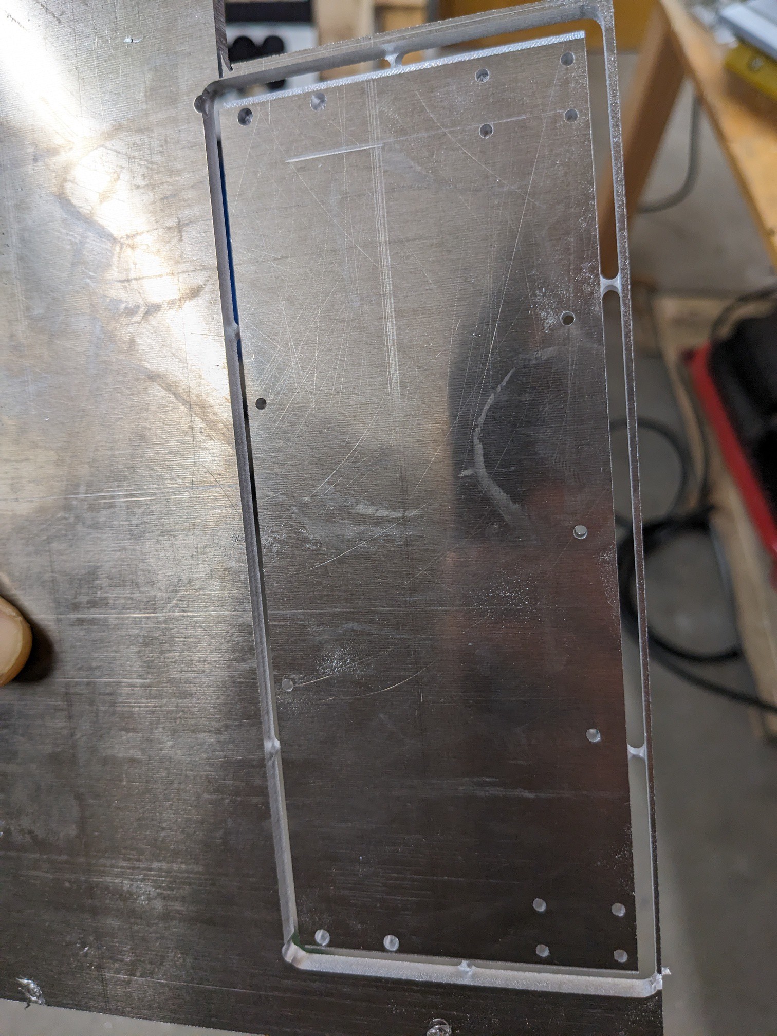

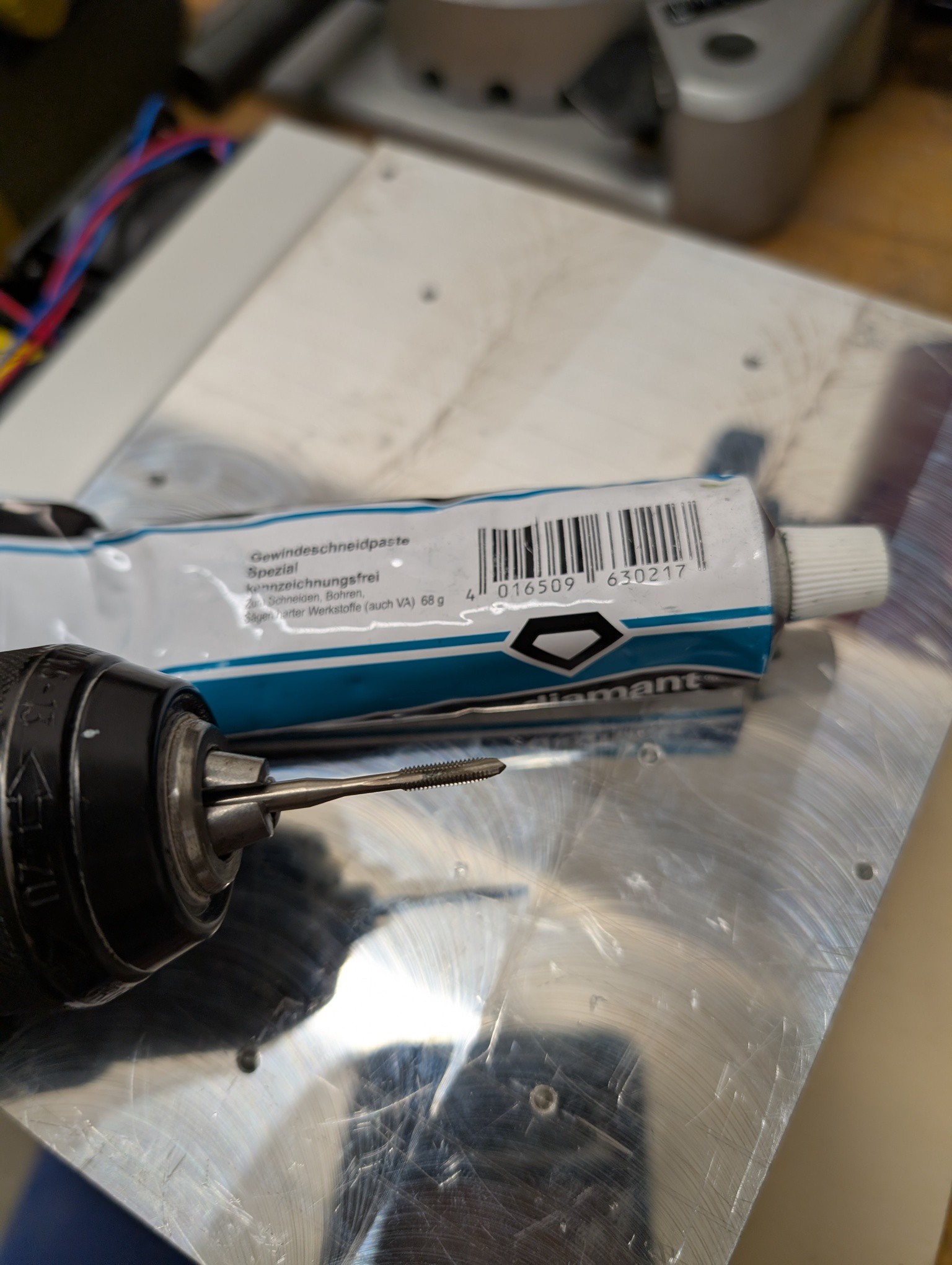

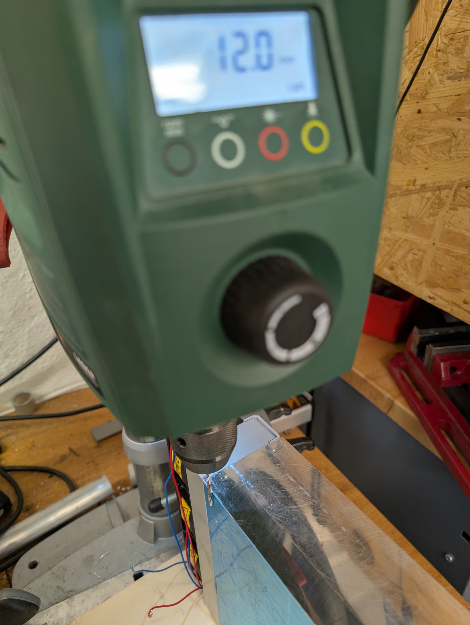

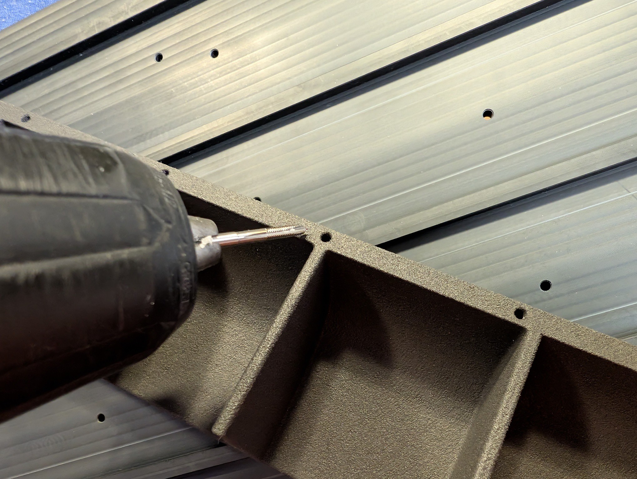

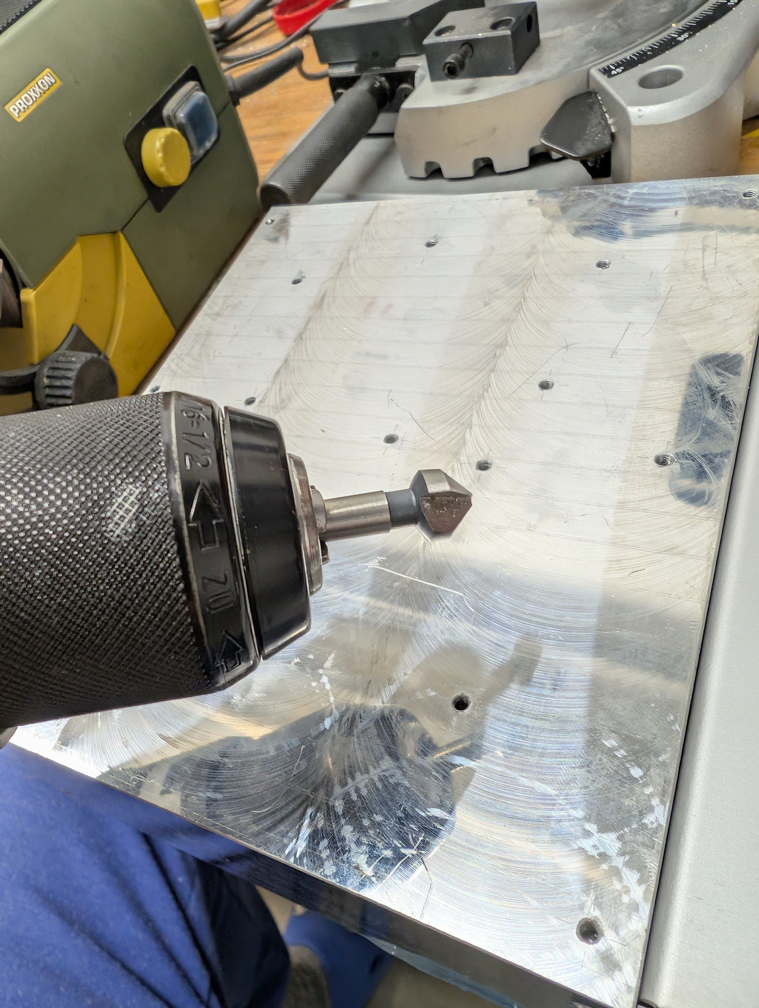

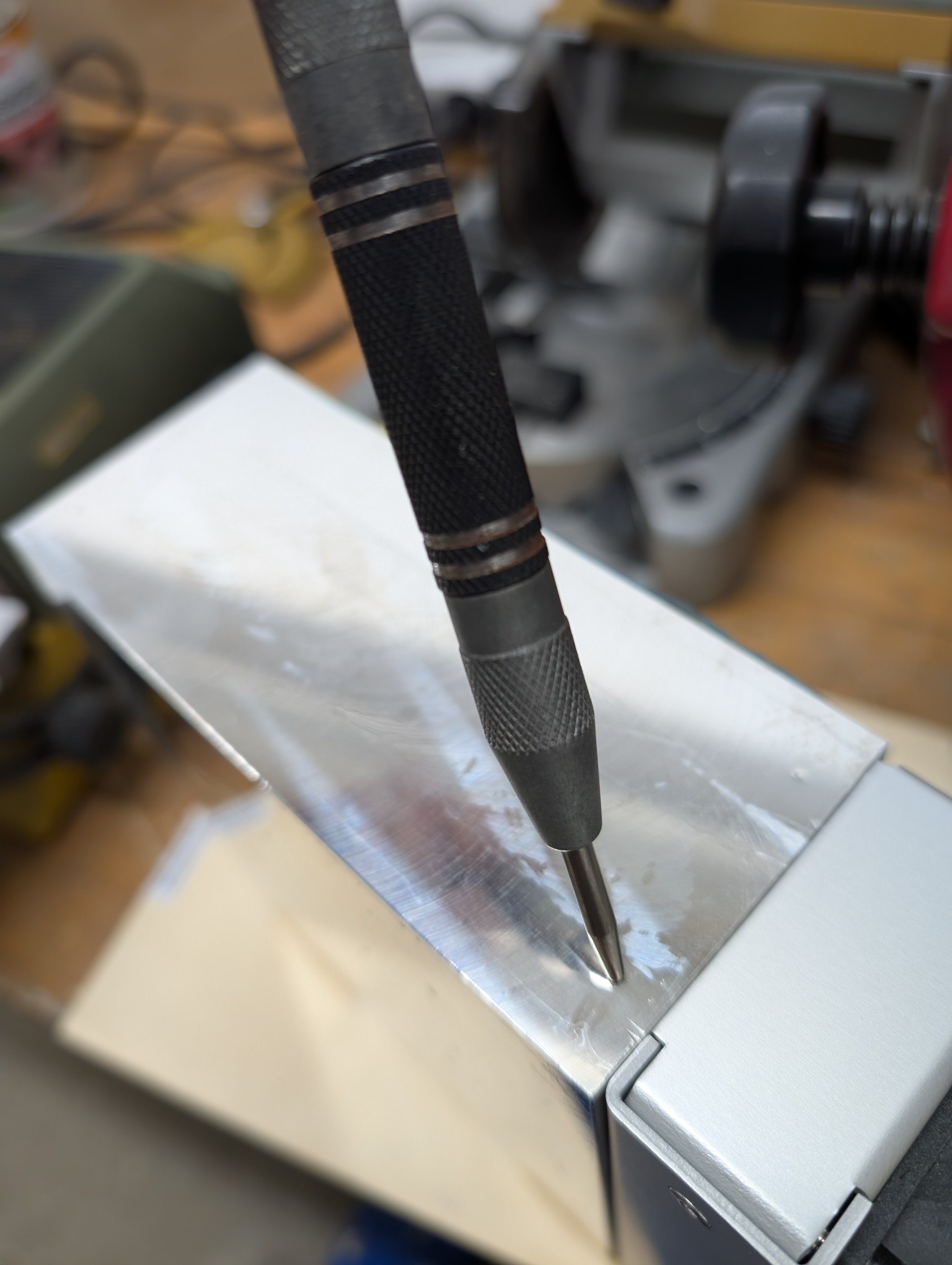

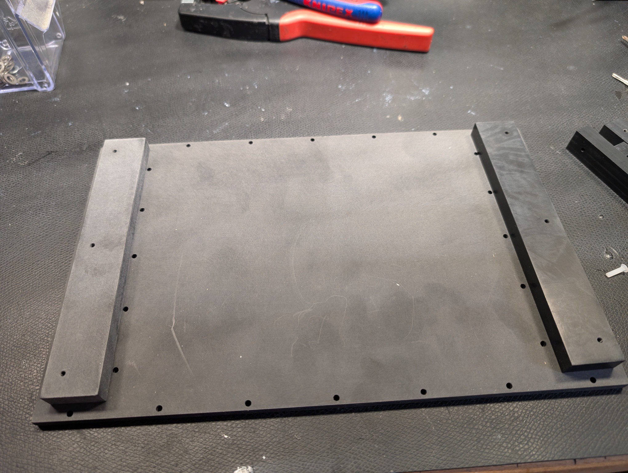

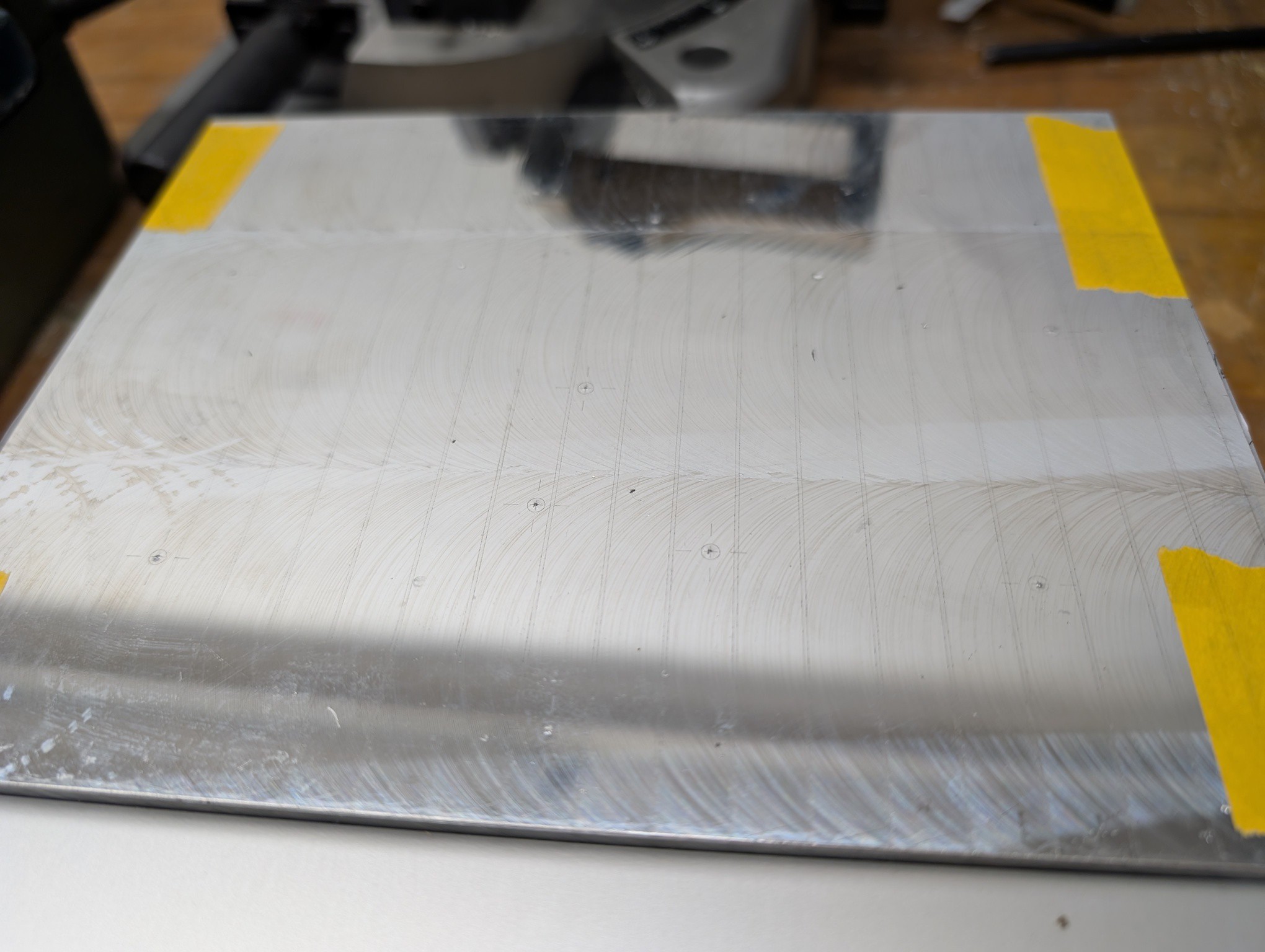

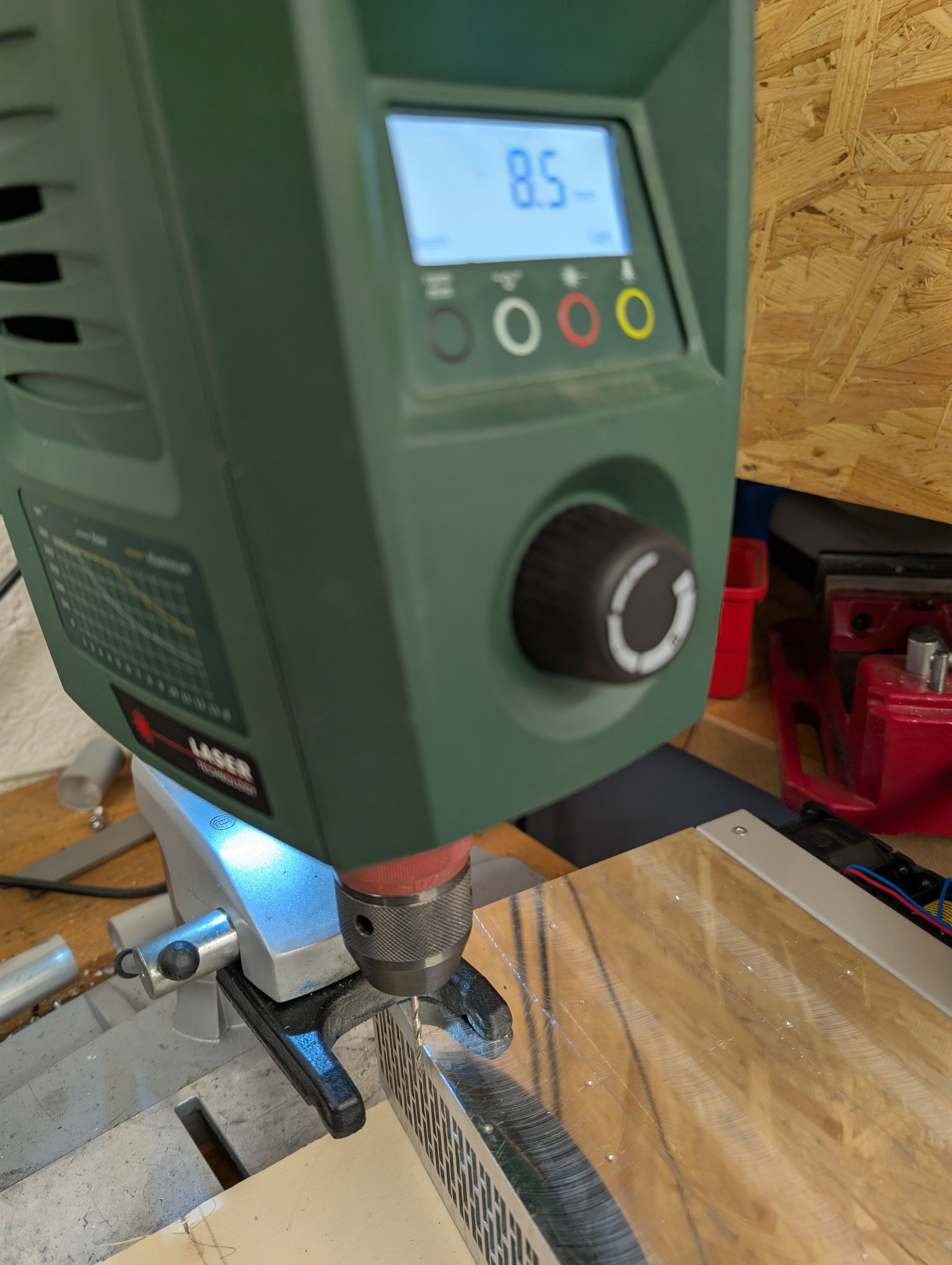

  • Final assembly #1 - heat sink
    Simon Trendel • 11/06/2025 at 12:16 • 0 comments
    Heat sink holes and threading:

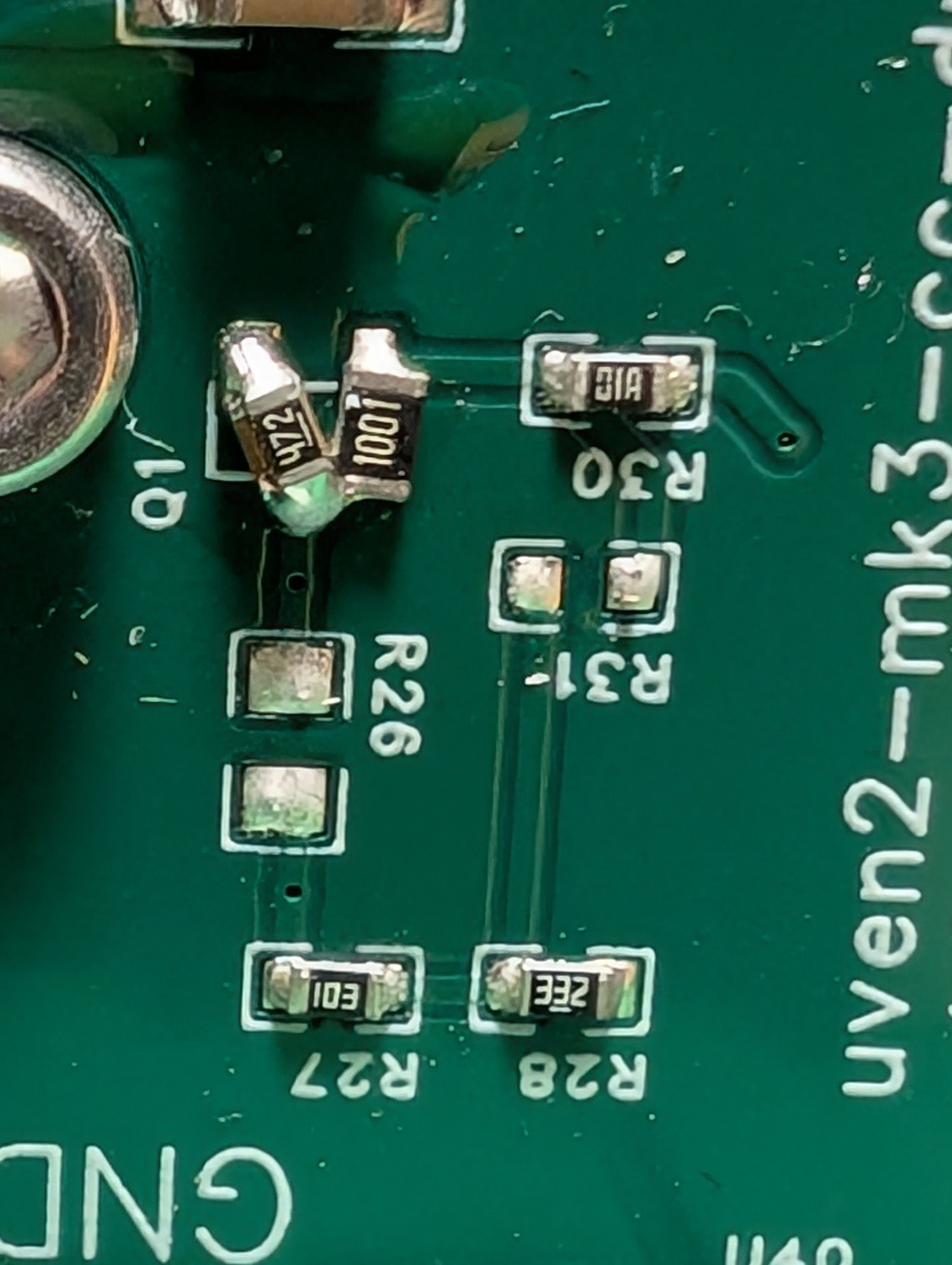

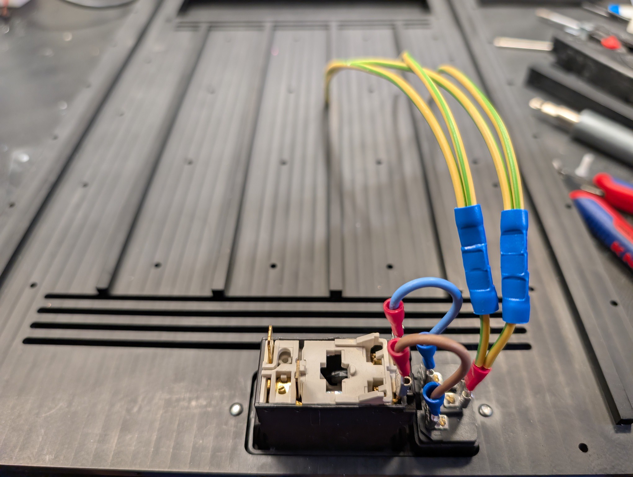

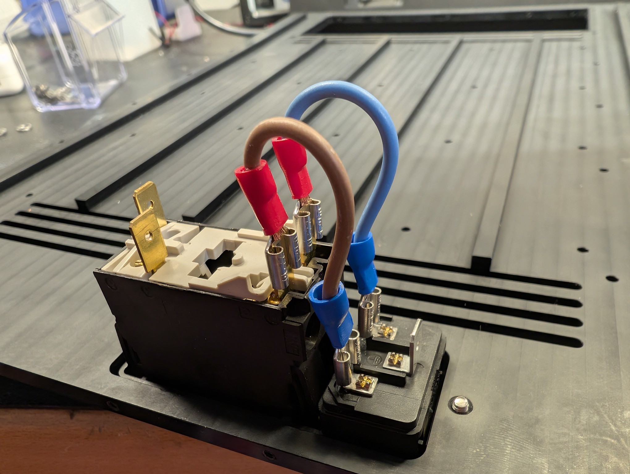

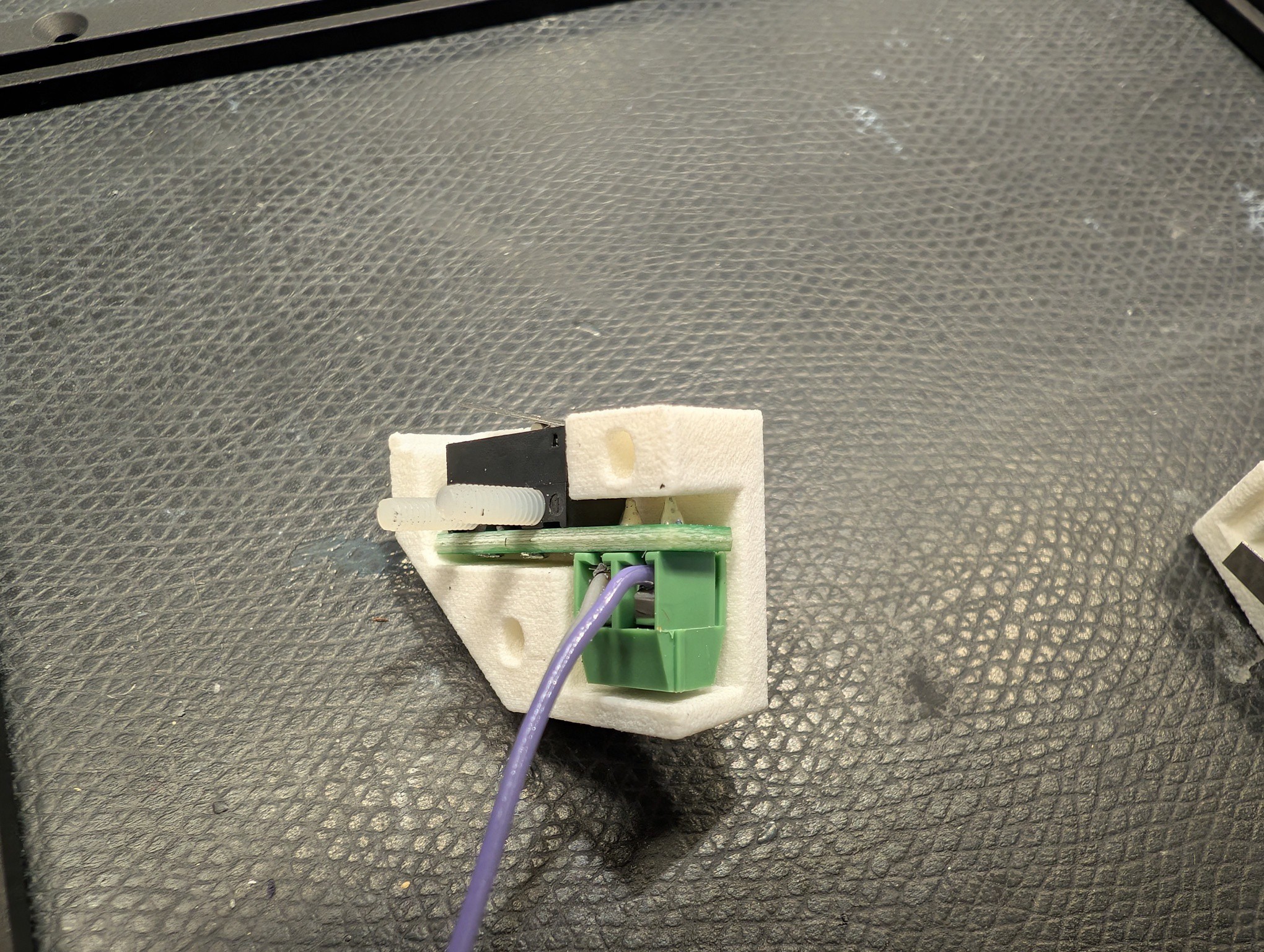

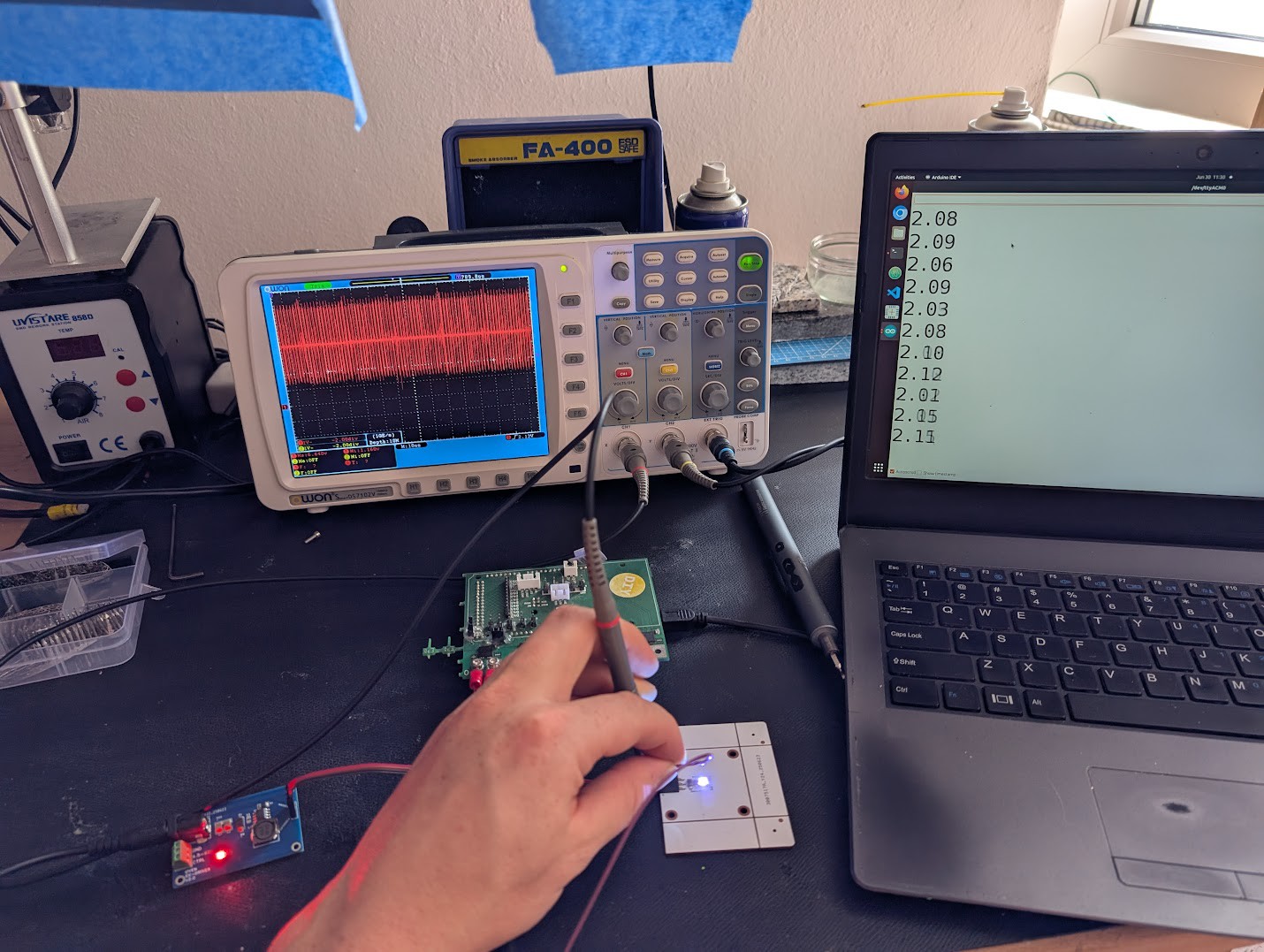

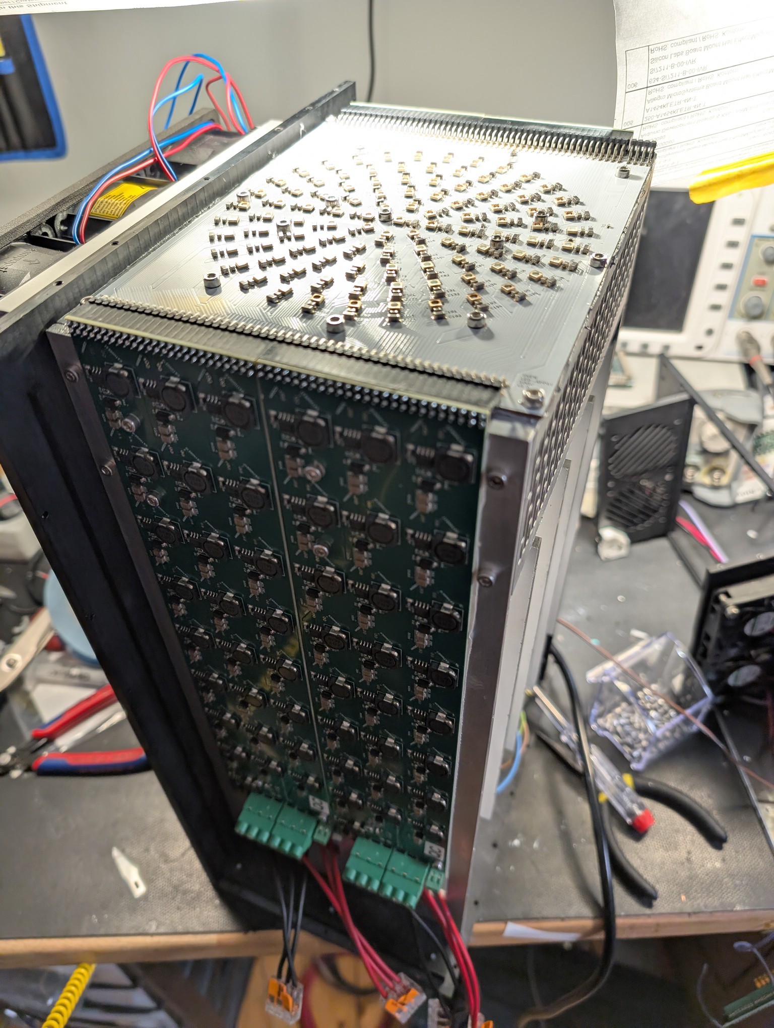

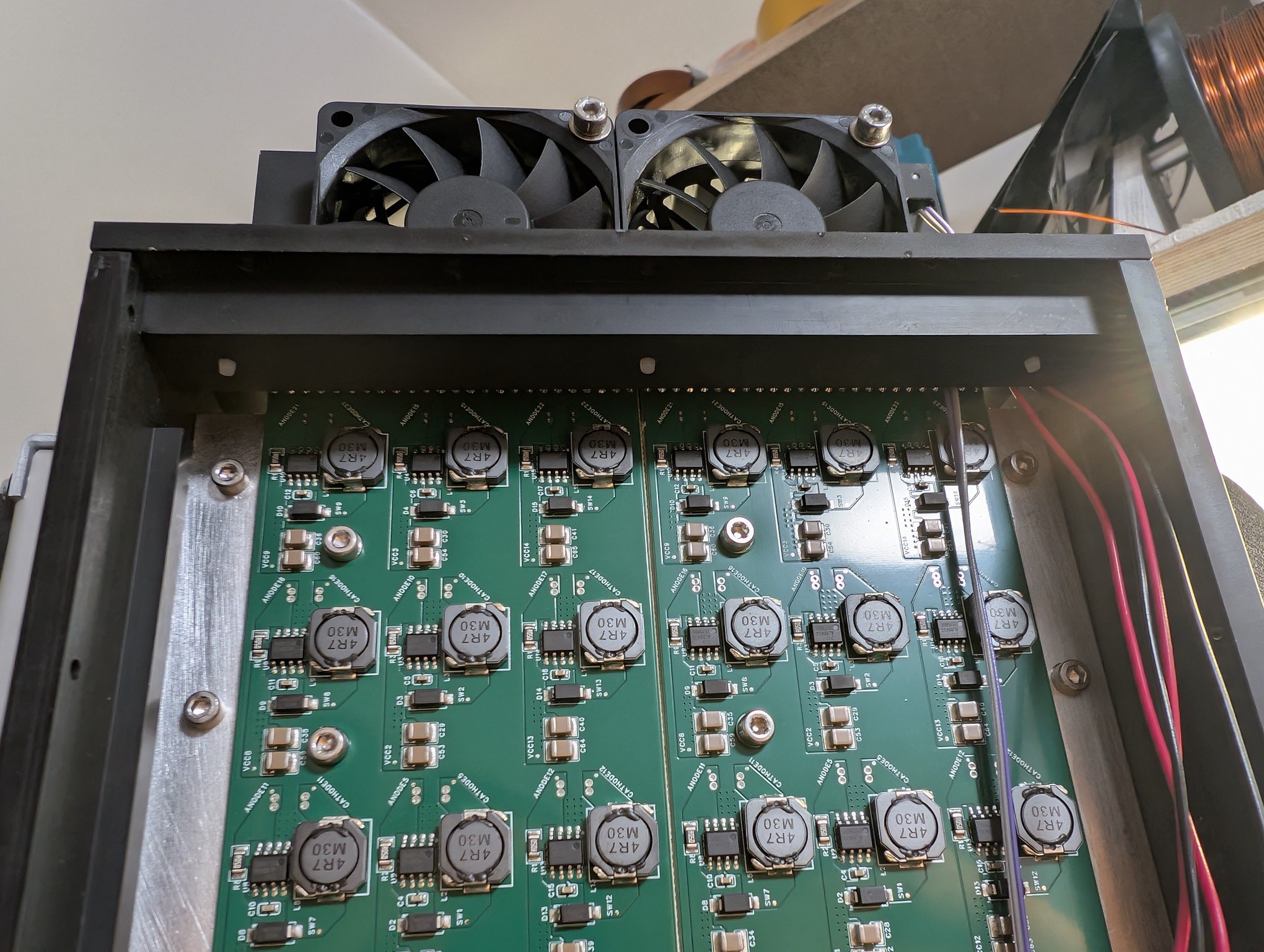

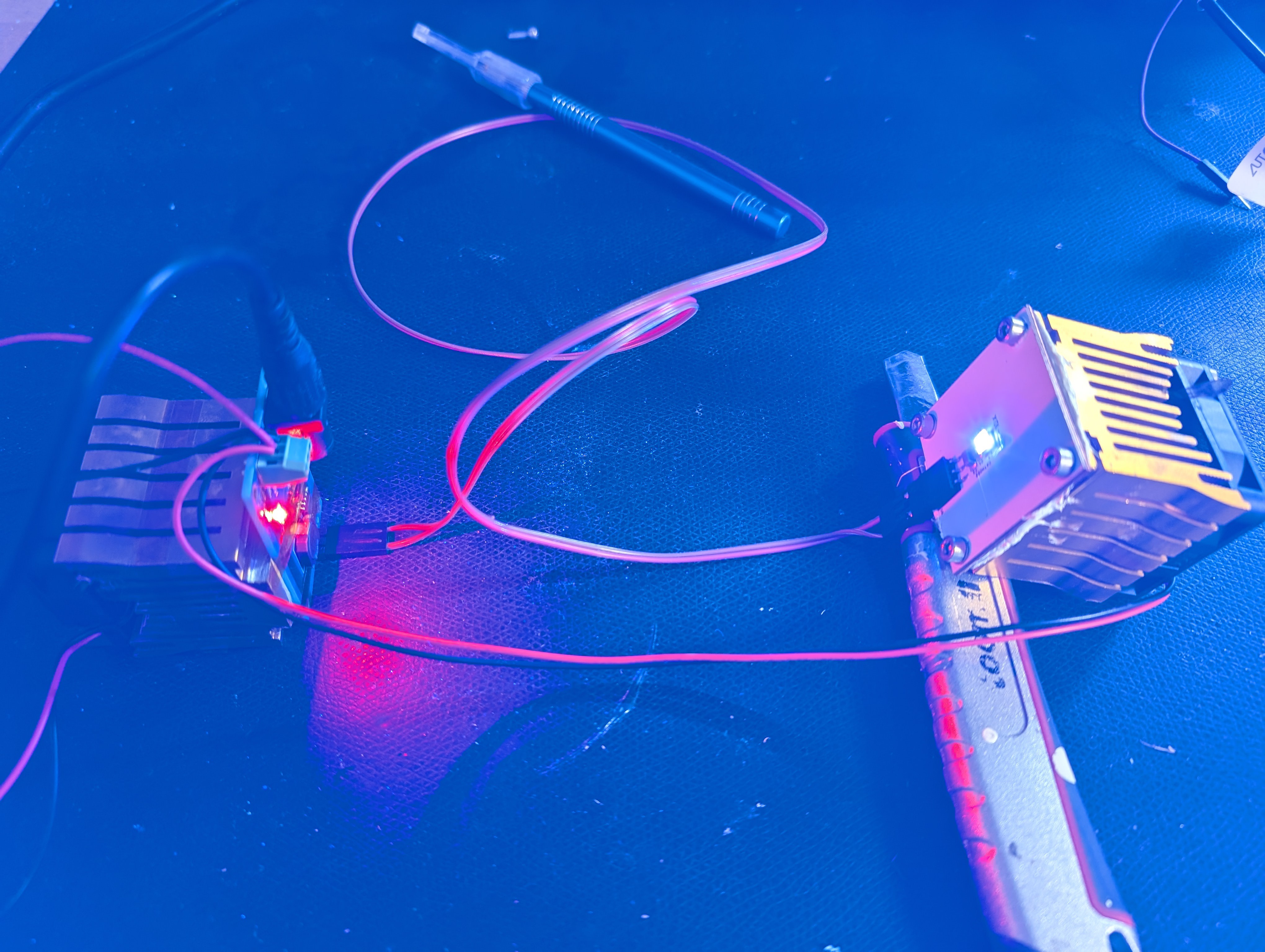

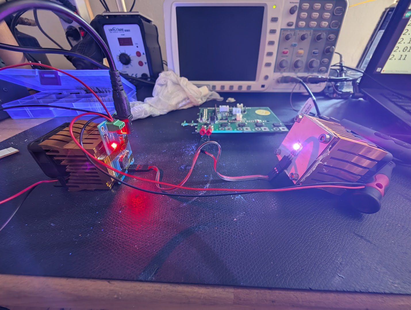

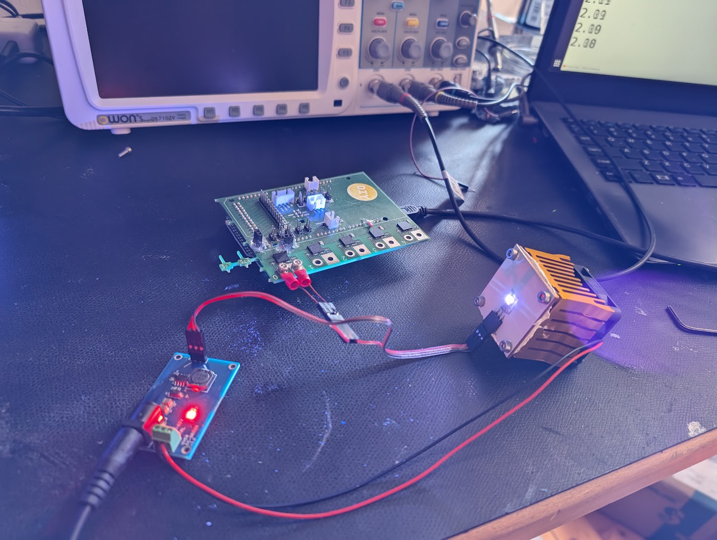

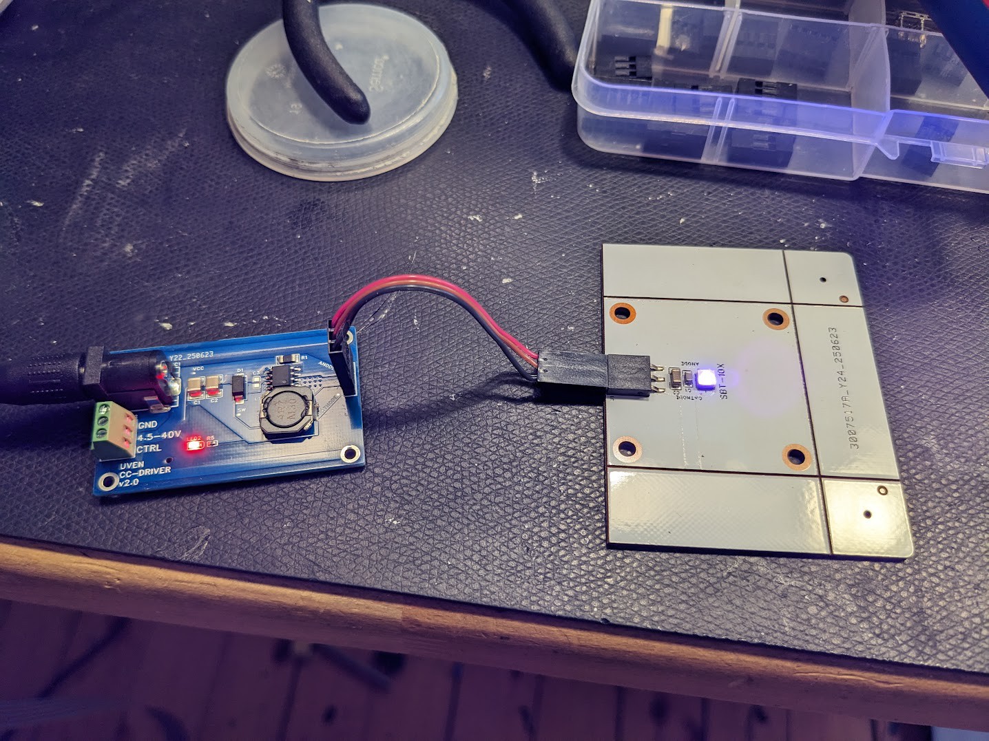

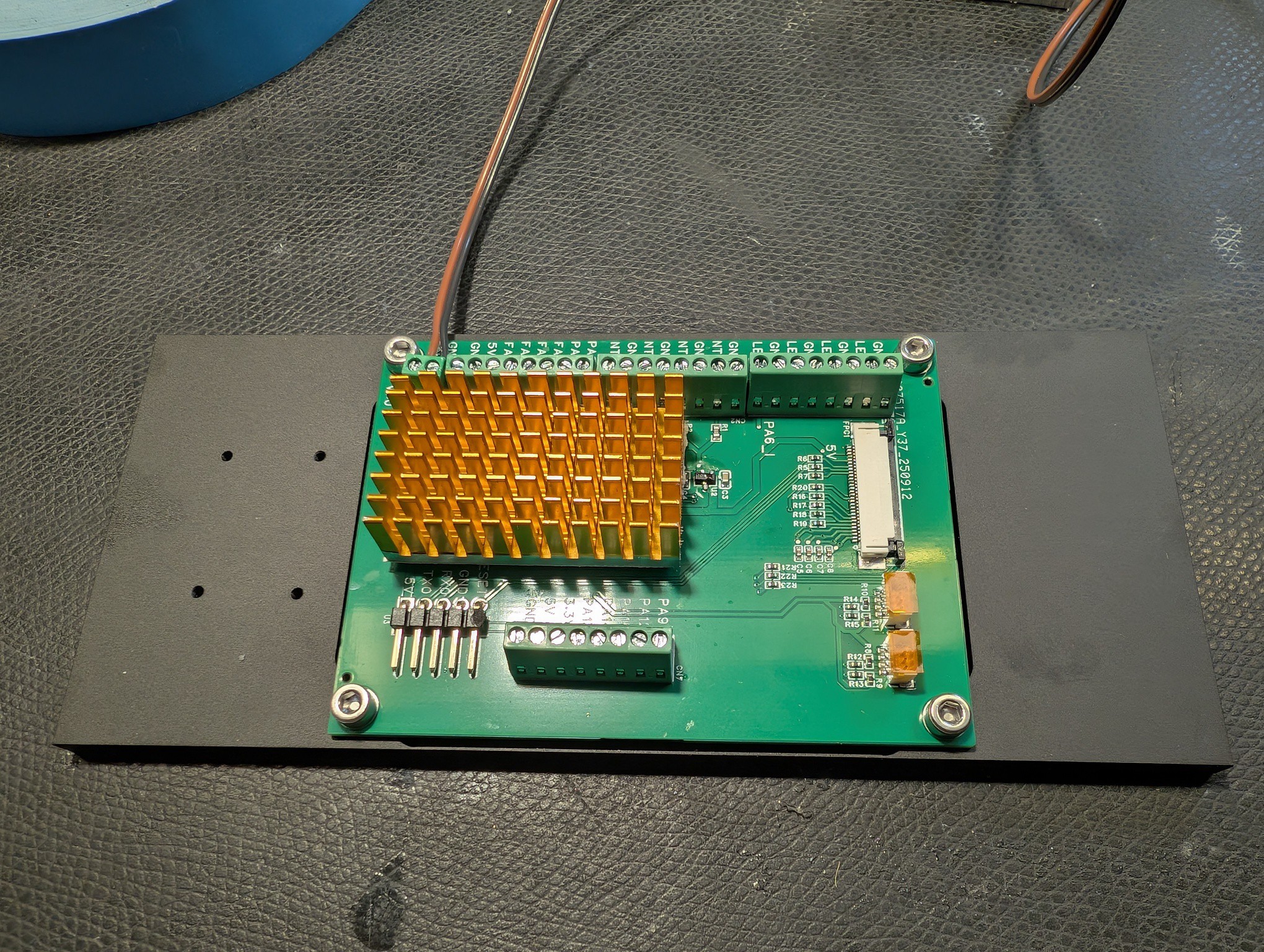

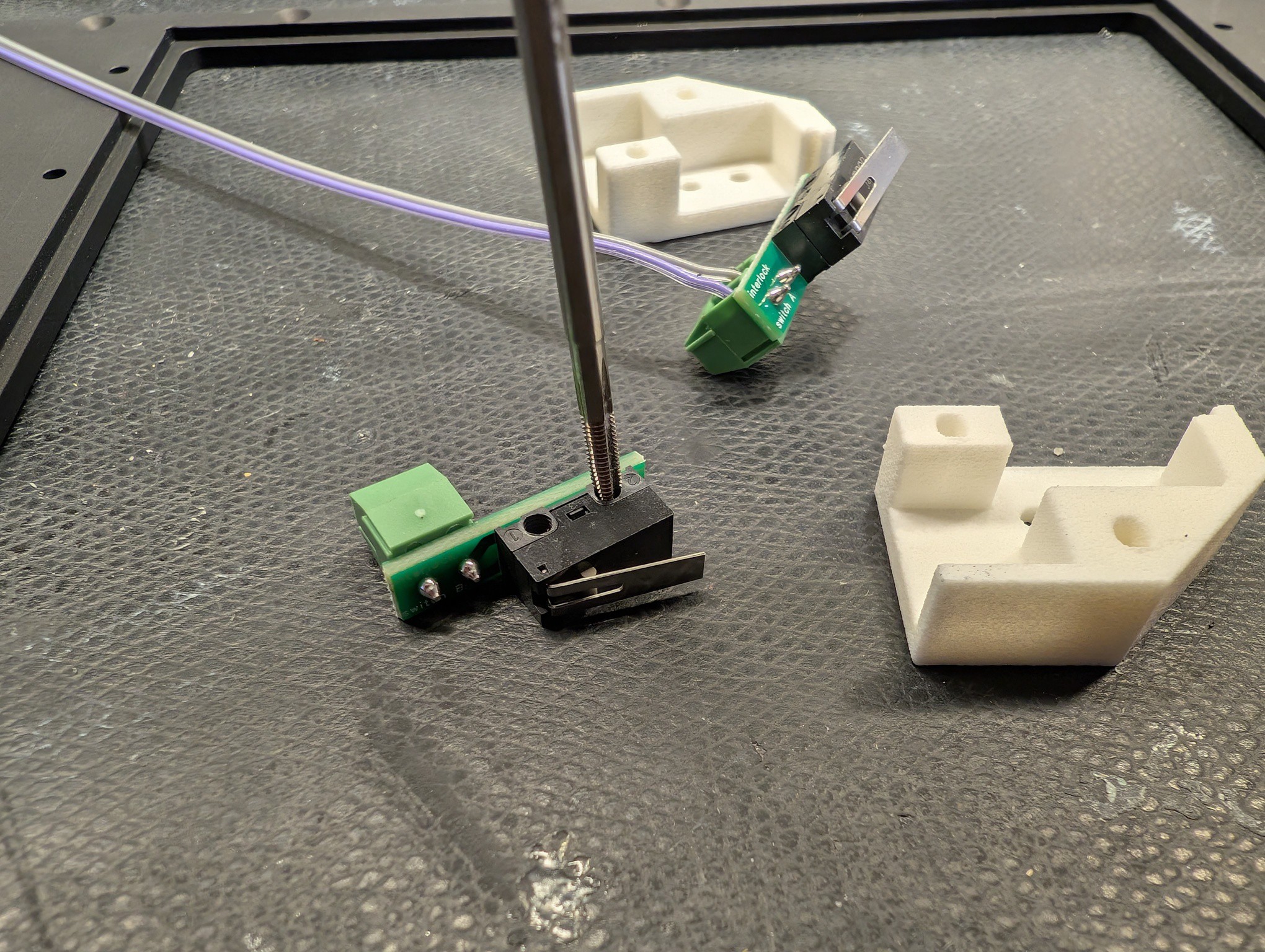

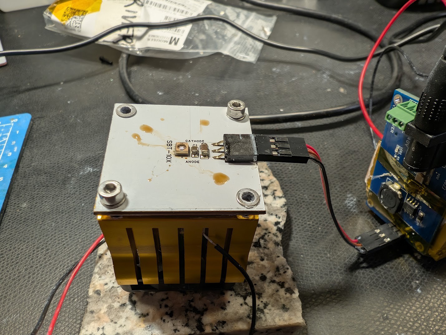

  • Testing the electronics
    Simon Trendel • 11/06/2025 at 12:01 • 0 comments
    All parts arrived and it was time to test.
    All boards had mistakes :( . But all could be fixed on the PCBs.

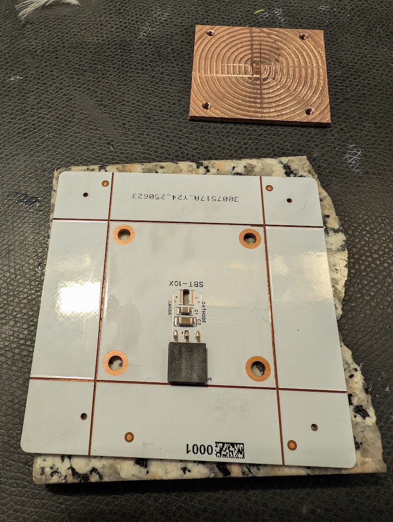

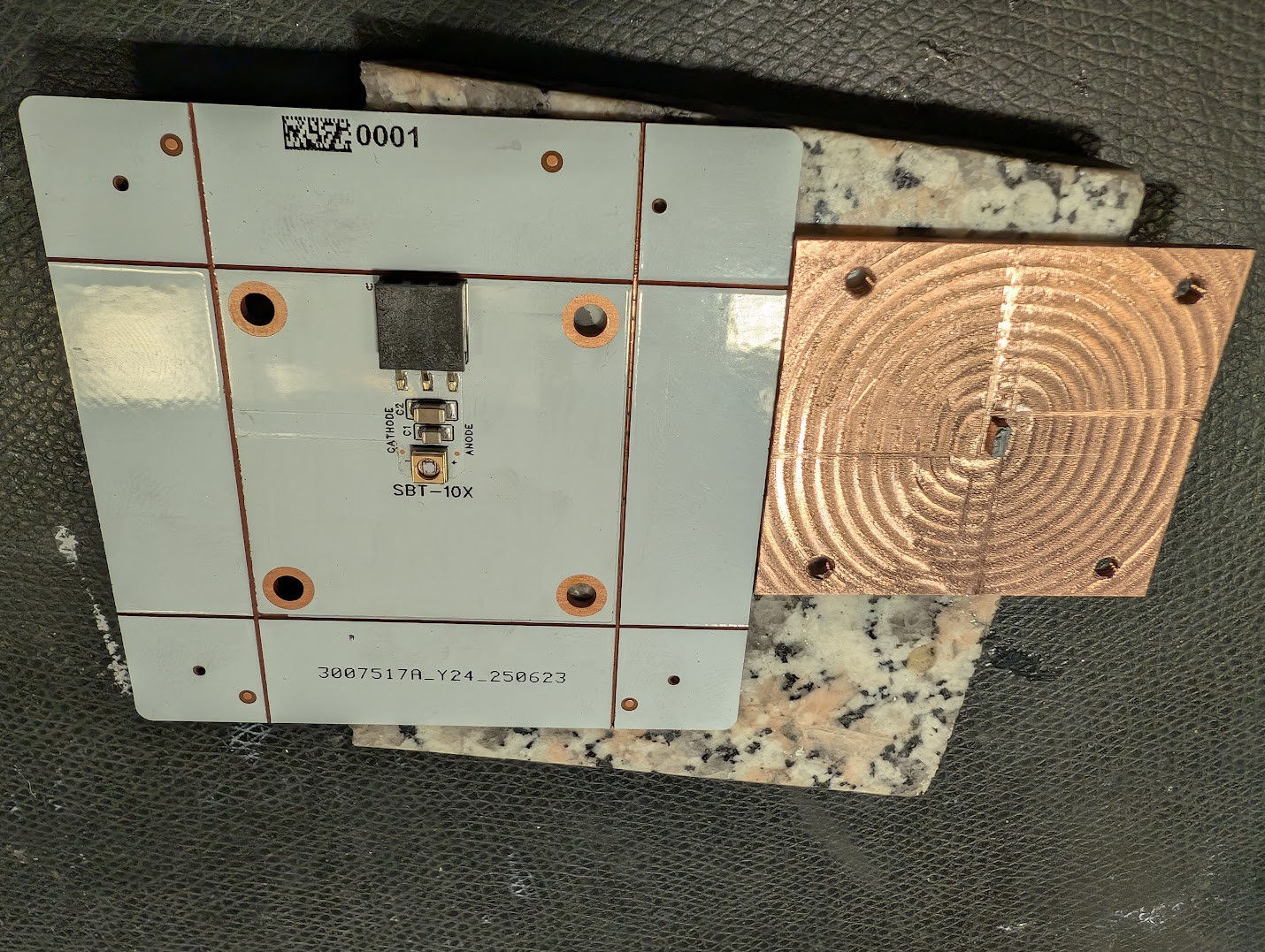

    After the initial light test, I assembled one SBT-10X LED to the copper core PCB. It turned out, I had wired the driver edge connector incorrectly. Luckily the LED footprint is symmetric, so I could simply assemble the LED 180 deg rotated. I burned only two LEDs until I realized the mistake.
    The driver PCB had another mistake that was more subtle and took a while to figure out. The mistake was to drive the CTRL pin of the led driver IC using 12V. That pin has a max voltage of 3.3V and driving it with higher voltage can damage the IC. So I removed the mosfet and pulled the CTRL pin low.
    There are two mistakes on the main-board. They are both very dumb, but luckily could be fixed on the main board PCB.

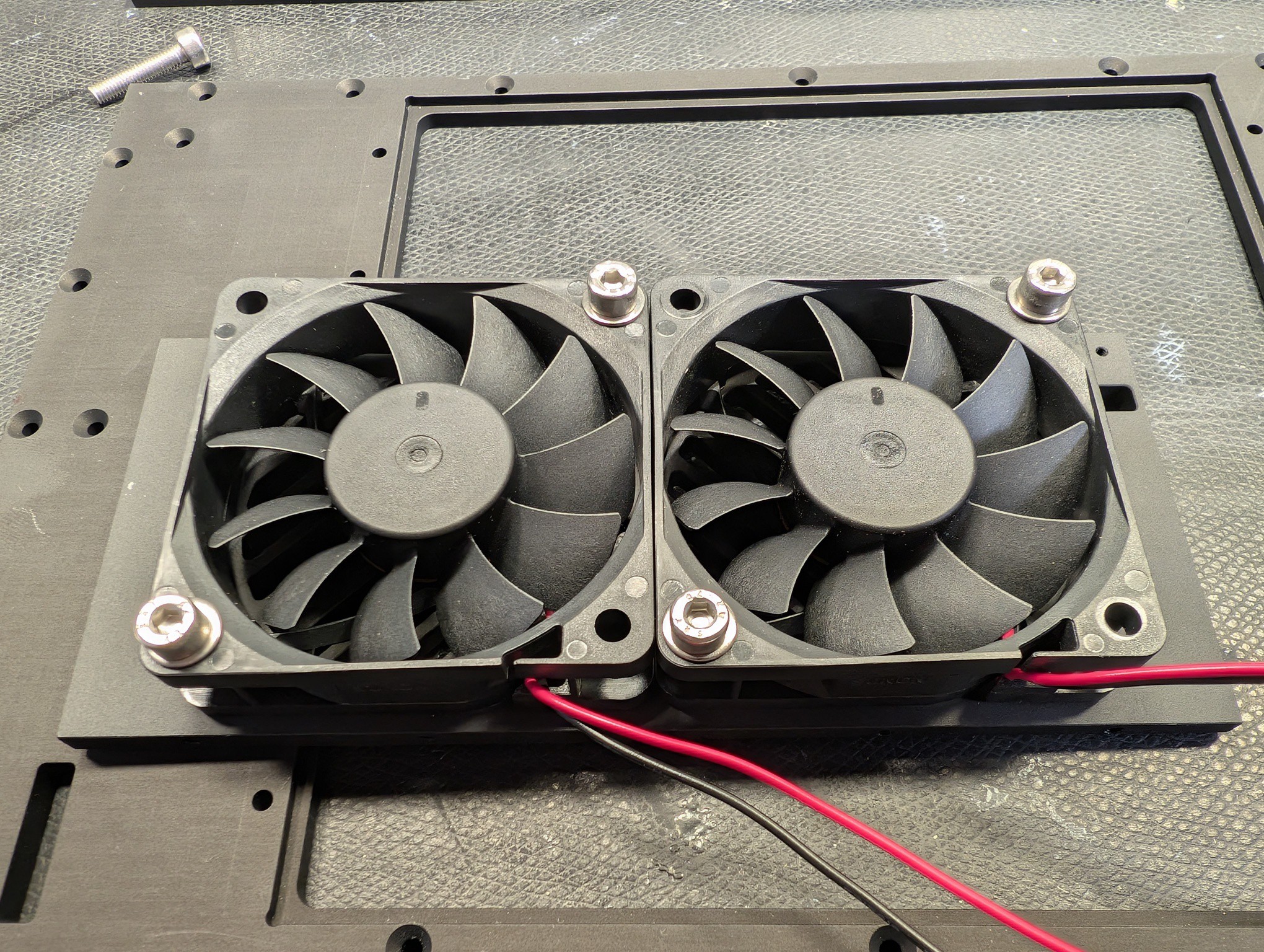

    The first mistake was to wire the EPAD pin of the 12V->5V and 12->3.3V DCDC converters to GND. For the fixed voltage version I assembled, this pin needs to be floating and serves as thermal heat sink. I simply cut the pins and added an external heat sink.
    The second mistake was not having checked the datasheet of the heat sink fans. Turns out they draw 4A@12V, which immediately annihilated the MOSFET I had planned for them.
    All mistakes are fixed in the latest version on github.
    I fixed all drivers and tested all channels of each driver.
    Next I assembled the full LED panel (with the LEDs rotated 180deg)
    For testing the full panel I needed to assemble the rest of the lamp.

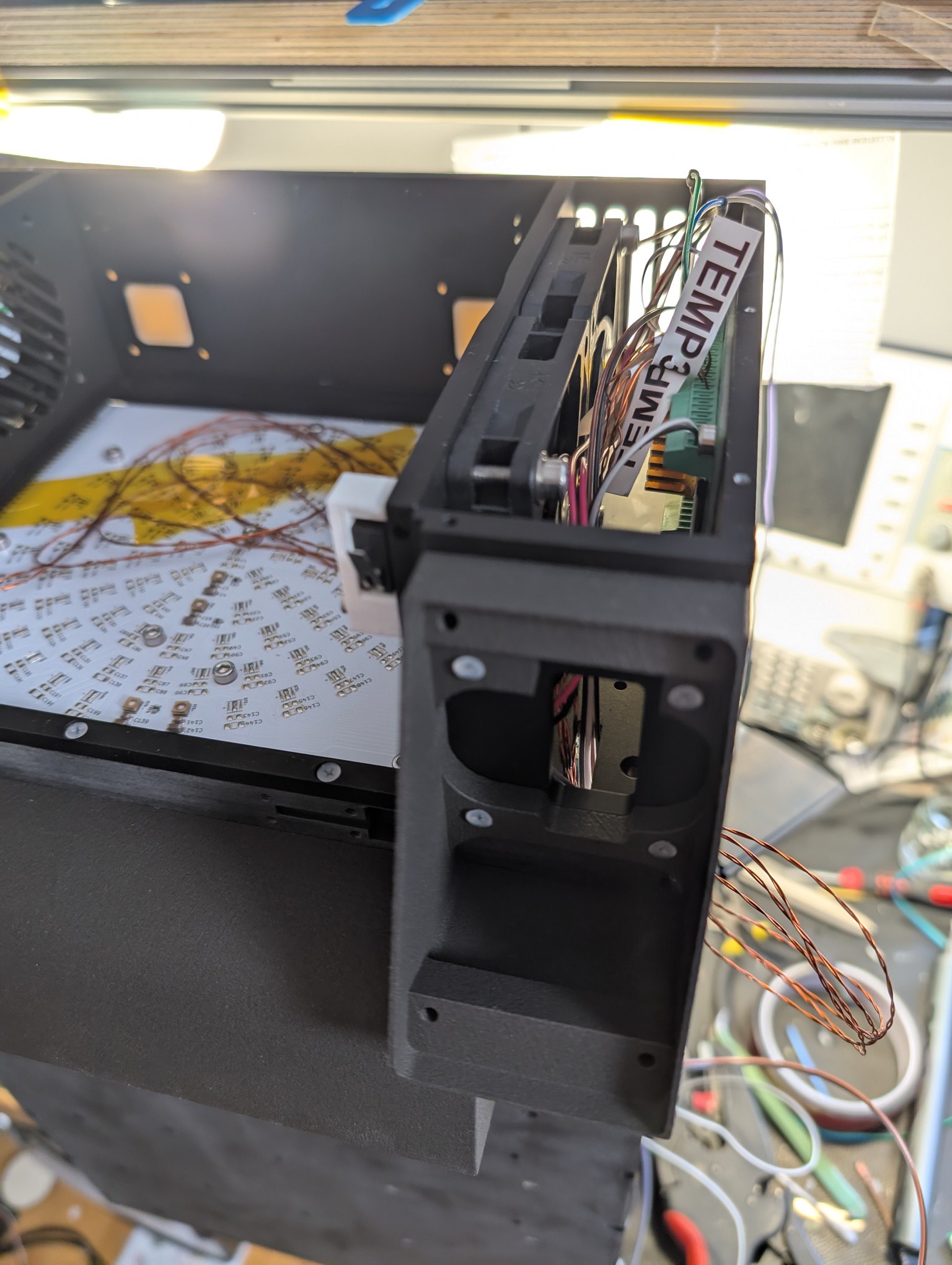

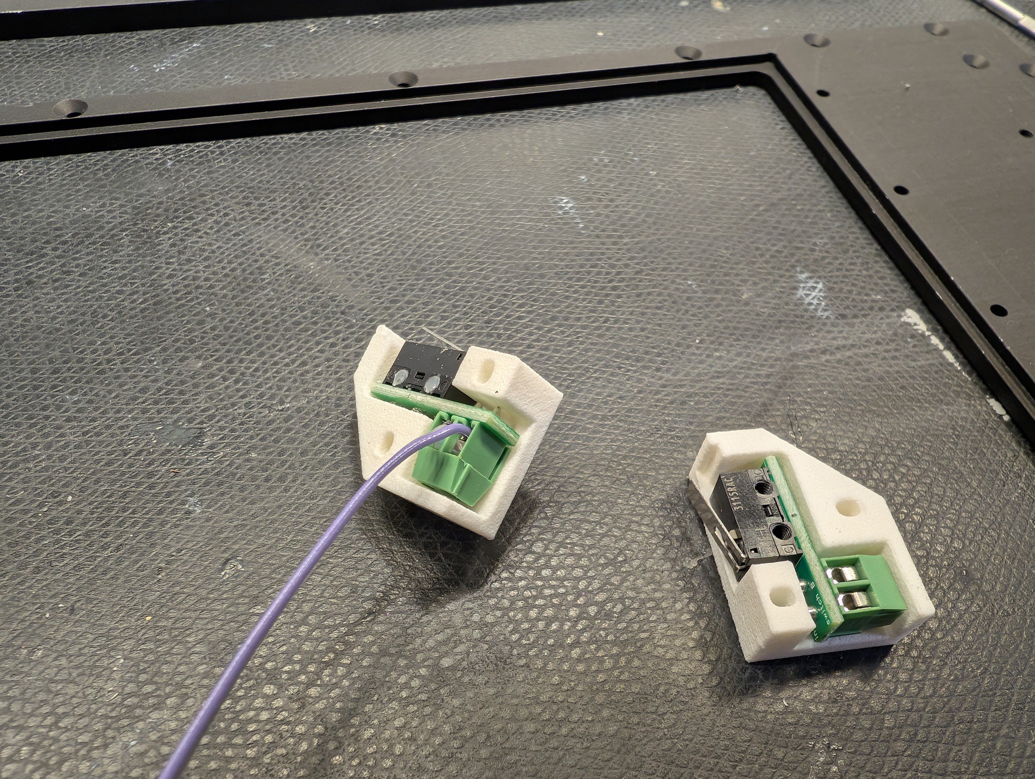

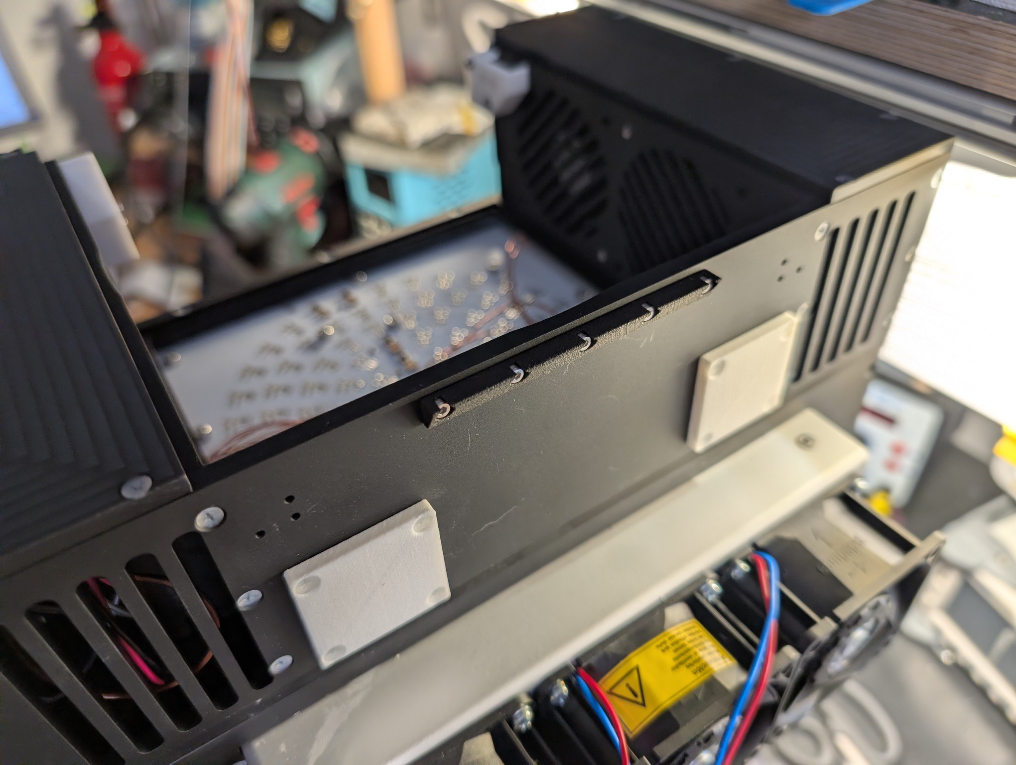

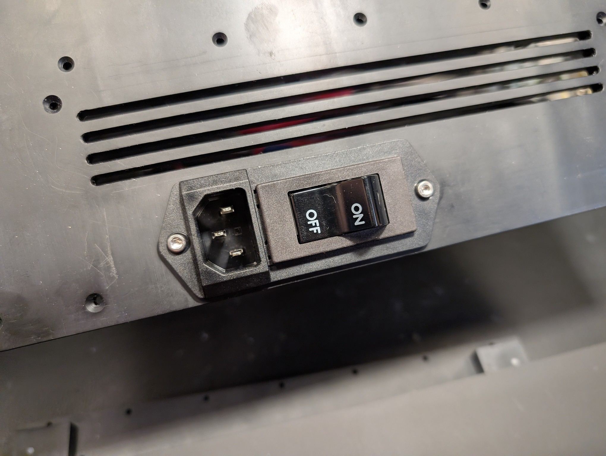

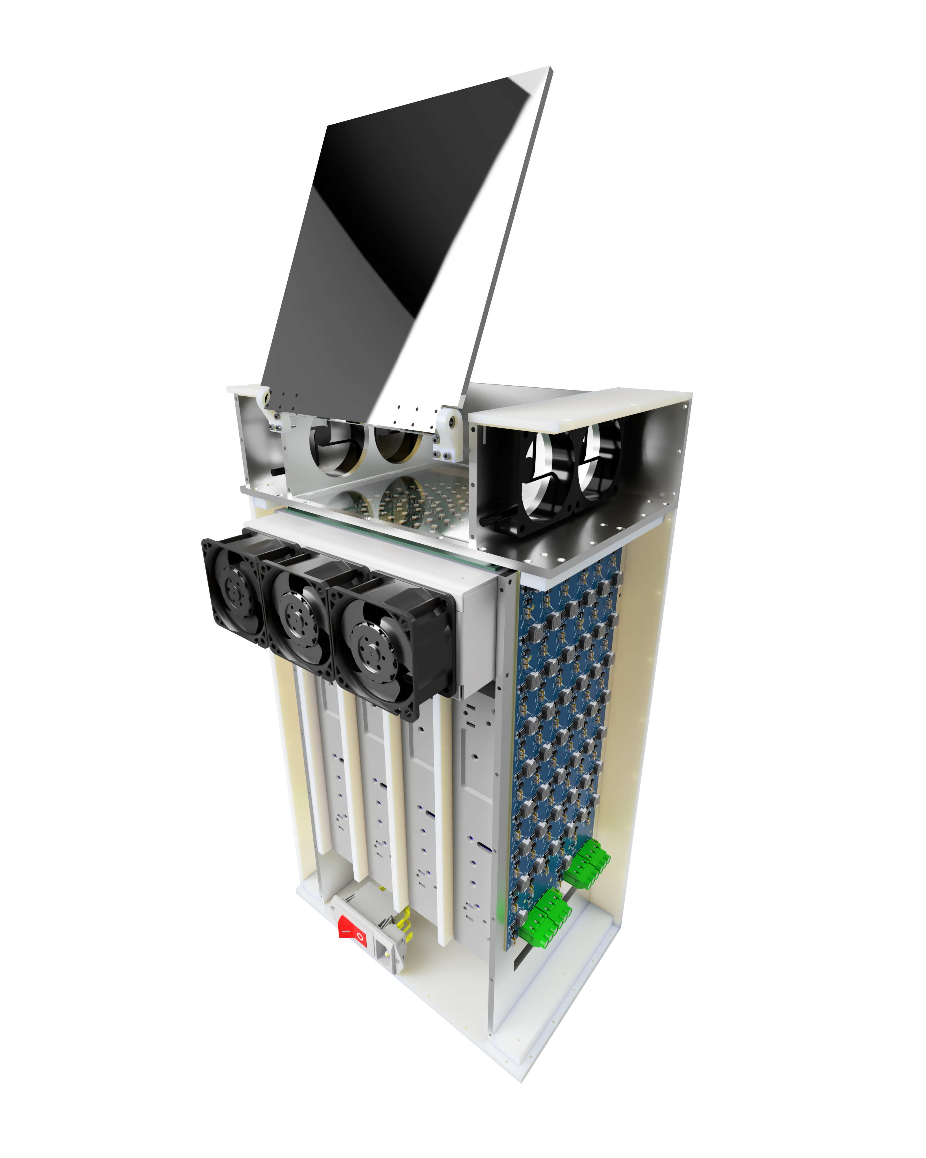

  • Final mechanical design
    Simon Trendel • 09/03/2025 at 11:00 • 0 comments
    We decided it was a good idea to make the chamber front loadable as well. With all the final mechanical details the lamp is ready for order:

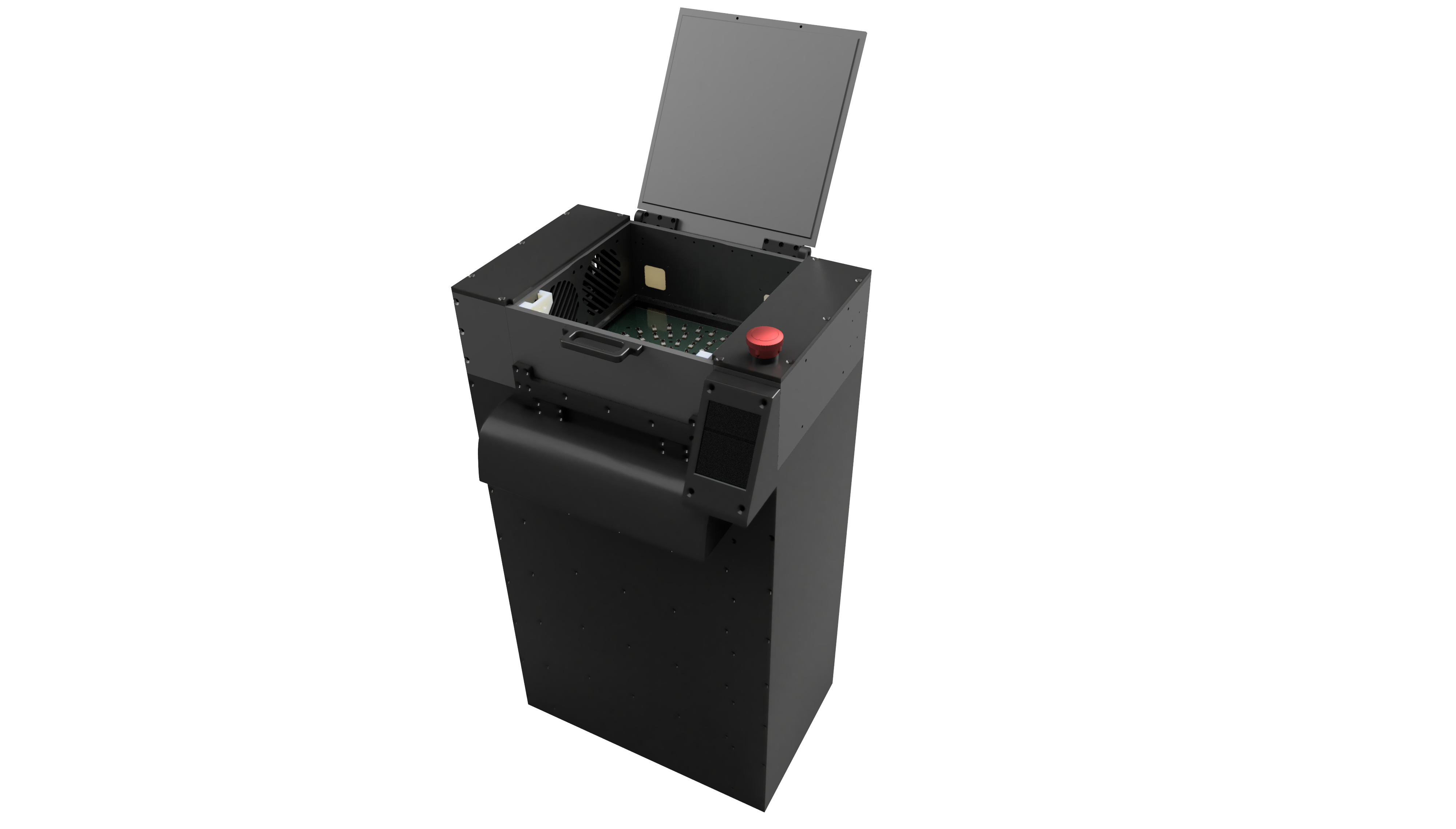

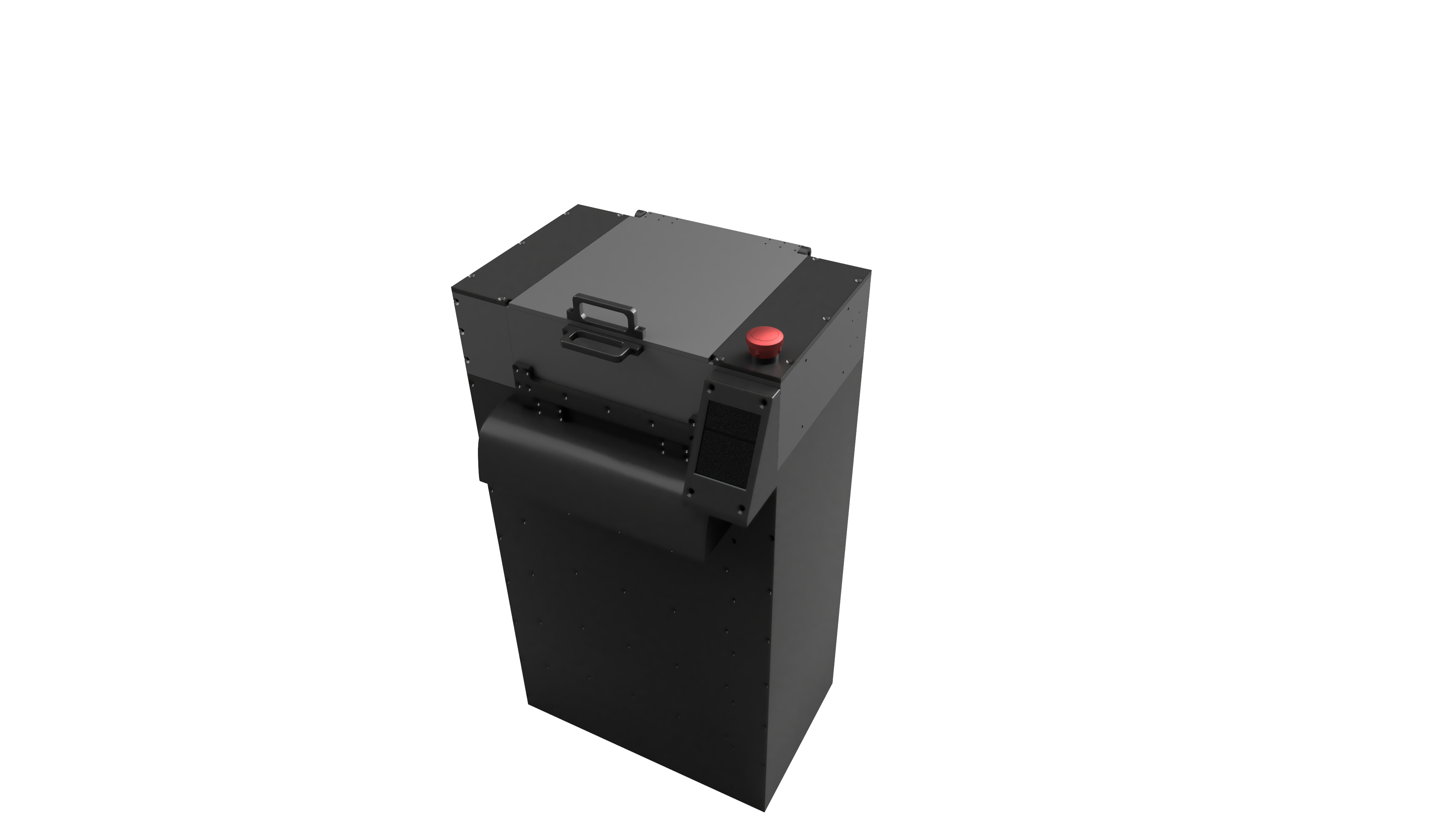

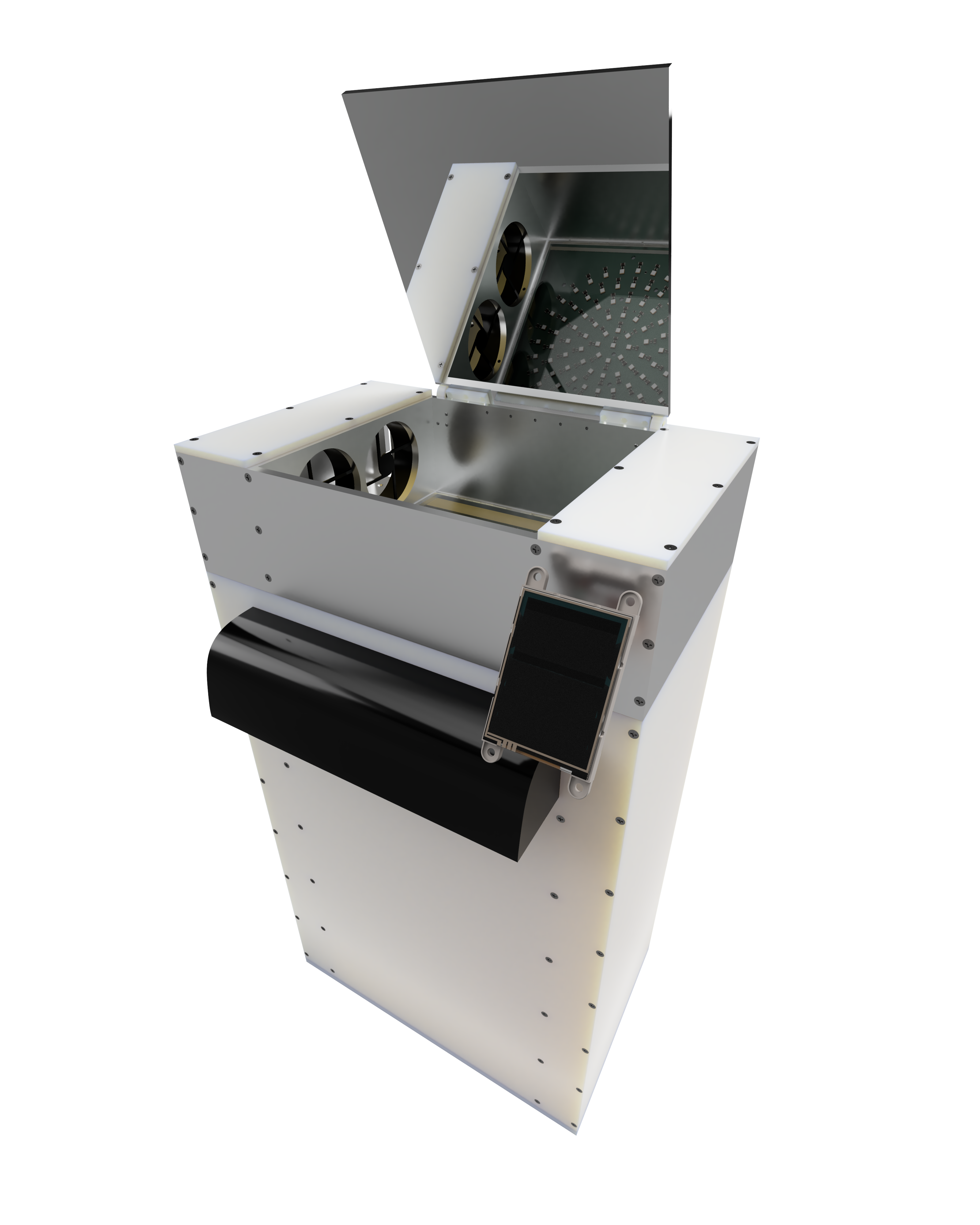

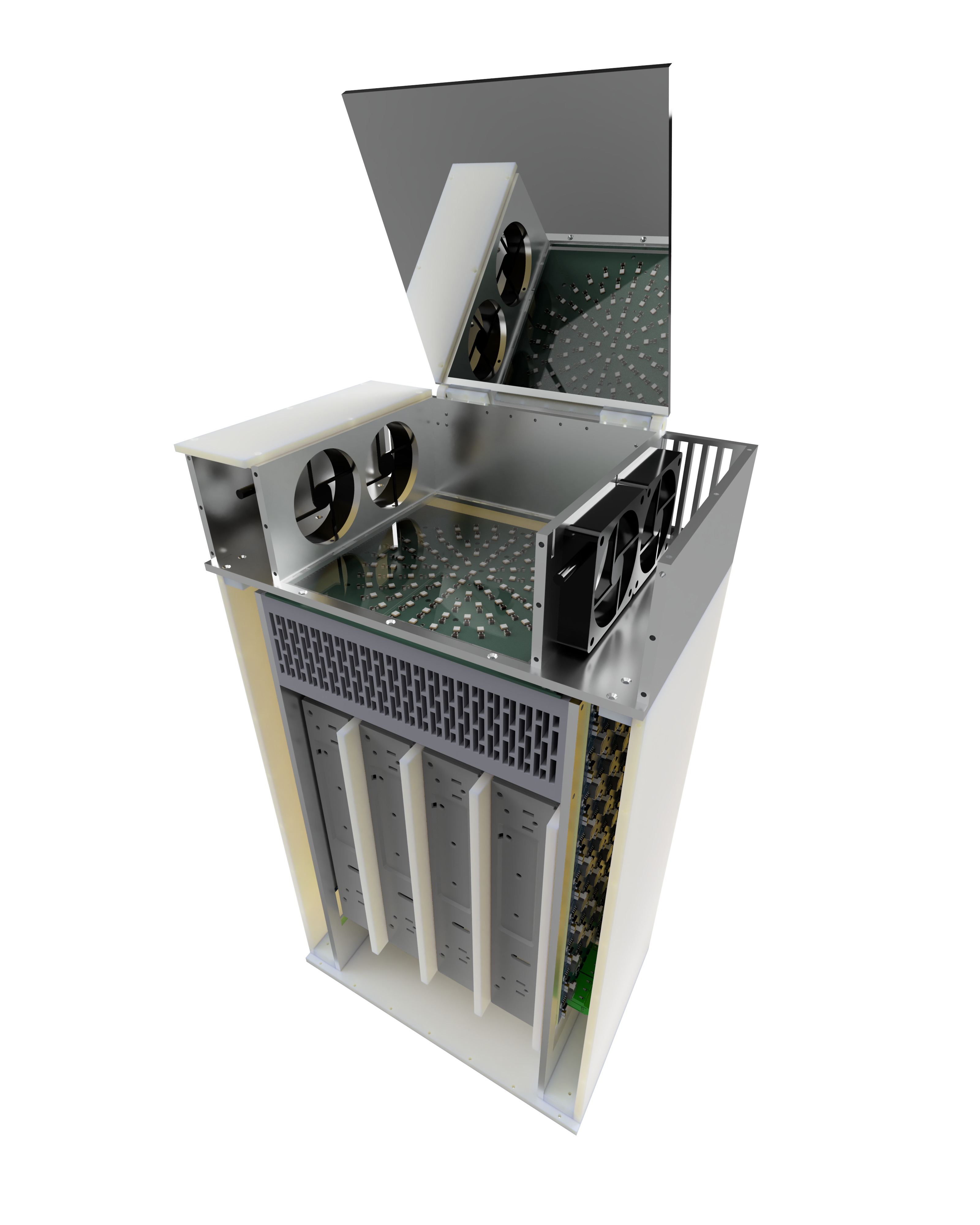

  • mechanical design
    Simon Trendel • 07/12/2025 at 17:35 • 0 comments
    With the main PCBs ready it was time to finalize the mechanical design. The following pictures show renderings of the front and the back of the lamp:
    And here is a size comparison with the previous version mk2:

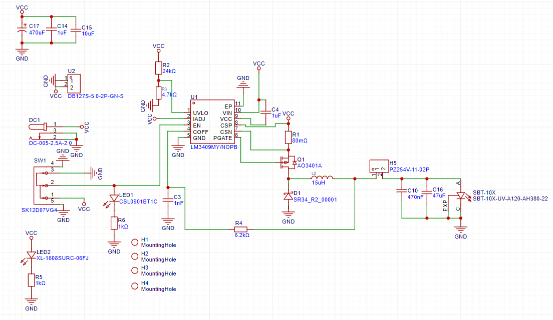

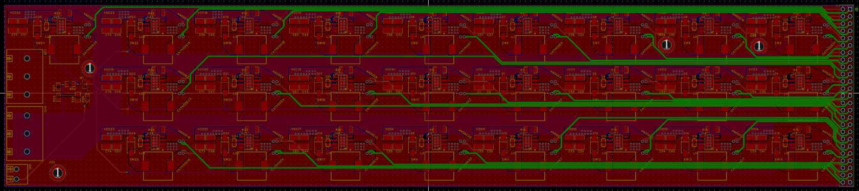

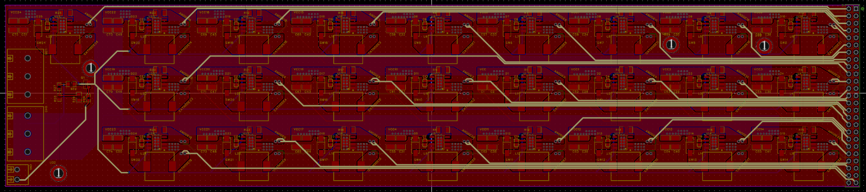

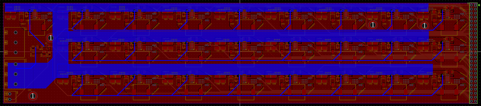

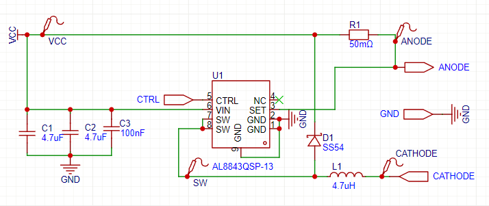

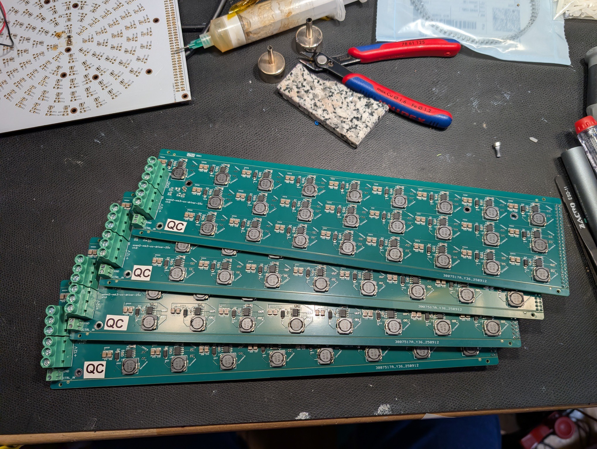

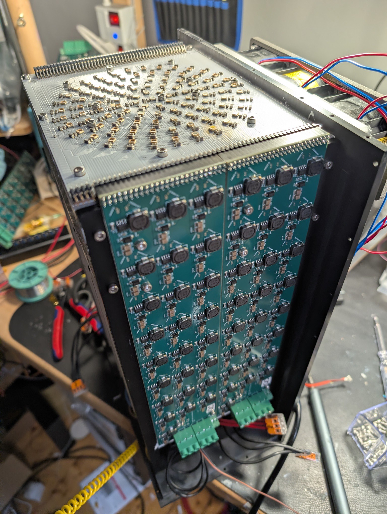

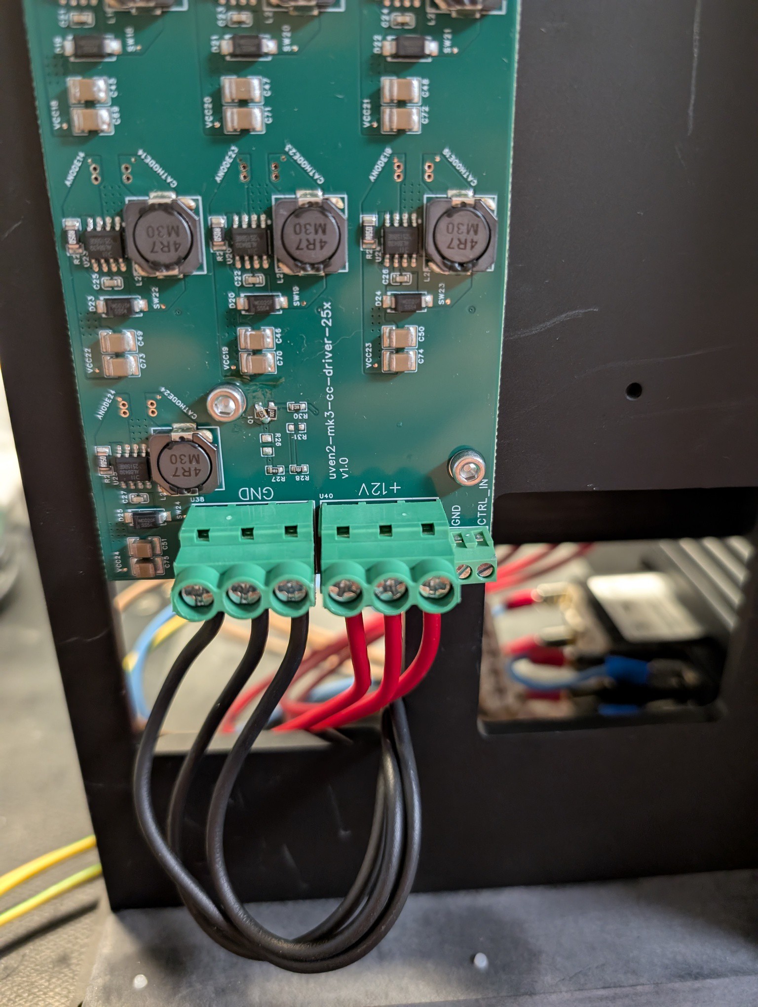

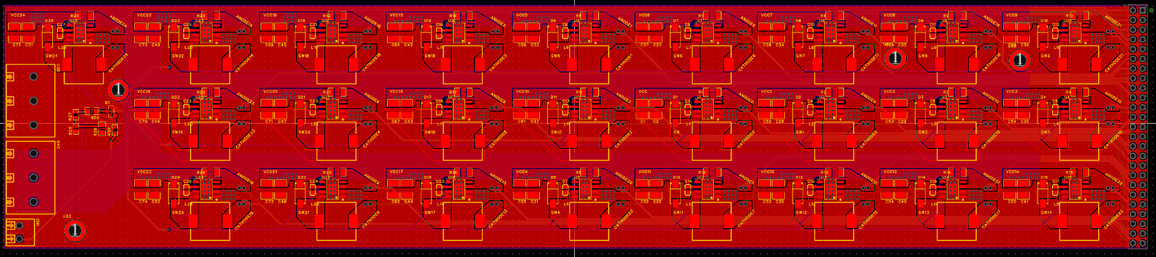

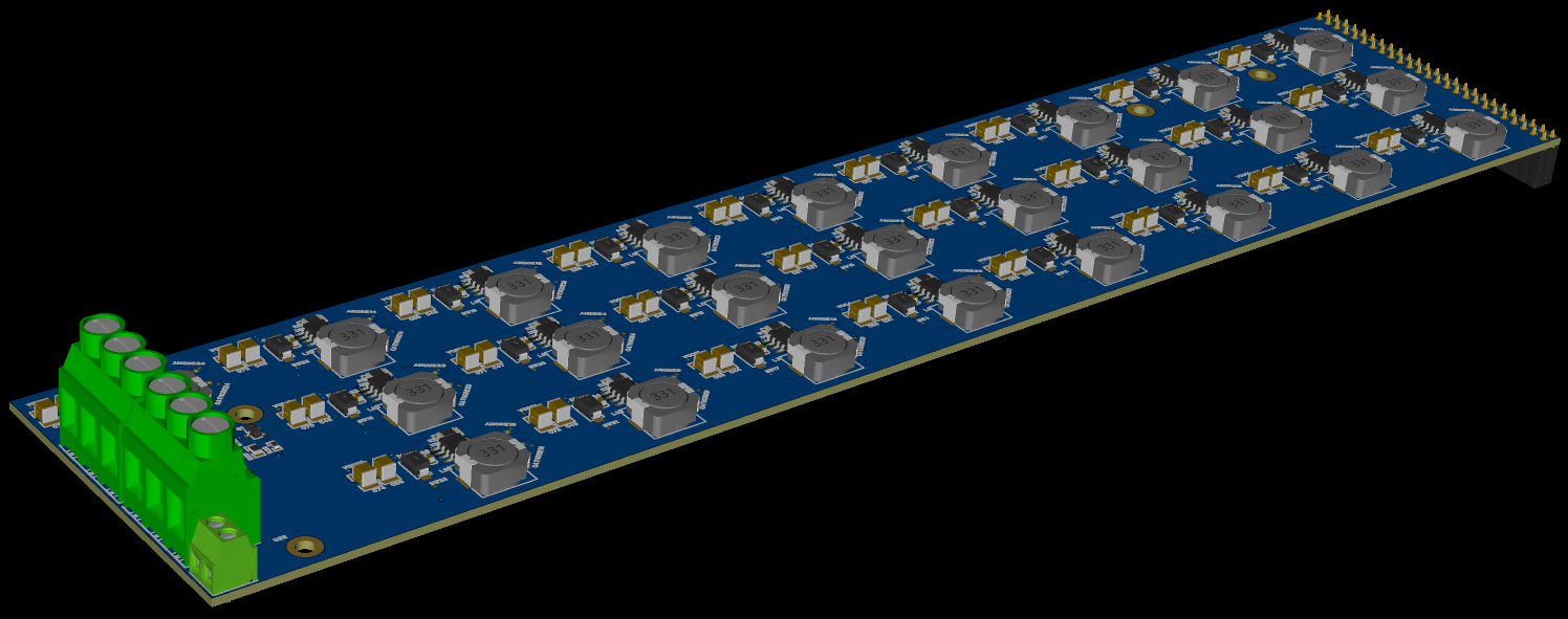

  • 25x cc driver
    Simon Trendel • 07/06/2025 at 18:46 • 0 comments
    For the 25x driver PCB I decided to control all drivers simultaneously using the CTRL pin of the AL8843. By default all drivers should be off, even if no MCU is actively controlling the board.
    To achieve this I'm using an N-MOSFET that is default conducting, pulling all CTRL pins low. If the MCU is connected, it can drive the CTRL_IN pin accordingly. Because the MCU will run at 3.3V, I use a voltage divider to set the gate voltage to 3.3V default.
    The finished driver looks like this:
    Top:
    Inner1:
    Inner2:
    Bottom:
    The default track width is 0.5mm. With 2oz copper for inner and outer copper layers, this should be enough for conducting the LED currents safely.
    For each LED panel with 100 LEDs we plug 2 of these 25x driver boards on either side of the panel. The full lamp is starting to take form:

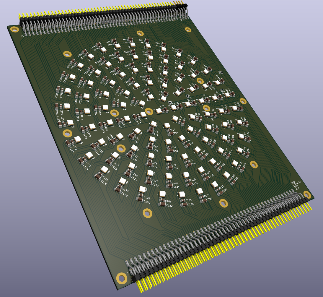

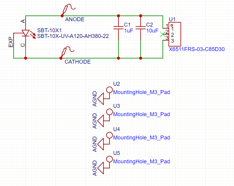

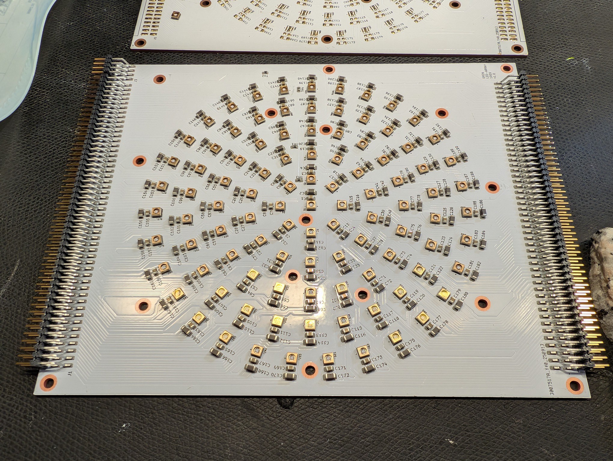

  • 100x LED panel
    Simon Trendel • 07/05/2025 at 14:23 • 0 comments
    Next I designed the LED panel. We chose 100x LEDs for this version. The spacing is as uniform as possible. Unfortunately EasyEDA doesn't seem to have any way of positioning components in a programmatic way, so for this PCB I'm using KiCAD again. KiCAD has a python scripting console and I used the following script to place all the components automatically.

    Routing was a bit tricky, because for a copper base board you can only route on the top of the board. I included 4 NTC thermistors as well, so we can get feedback on the LED temperature.
    The LED driver boards will be connected on either side of the LED panel using the 2.54mm pin headers.
