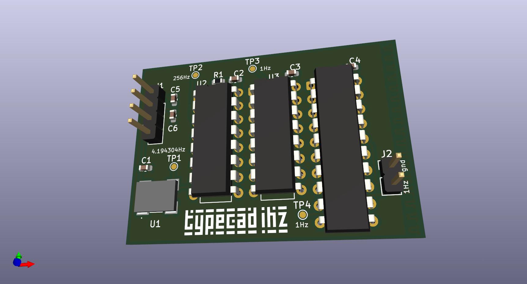

  • Making the board
    typecad07/20/2025 at 14:42 0 comments
    typeCAD code turned the components into a KiCAD PCB. All that was left to do was position the components and connect everything.
    A couple of minutes later, and this is the result.
    It could use some vias and maybe the traces could be routed better, but that's what it is for now.

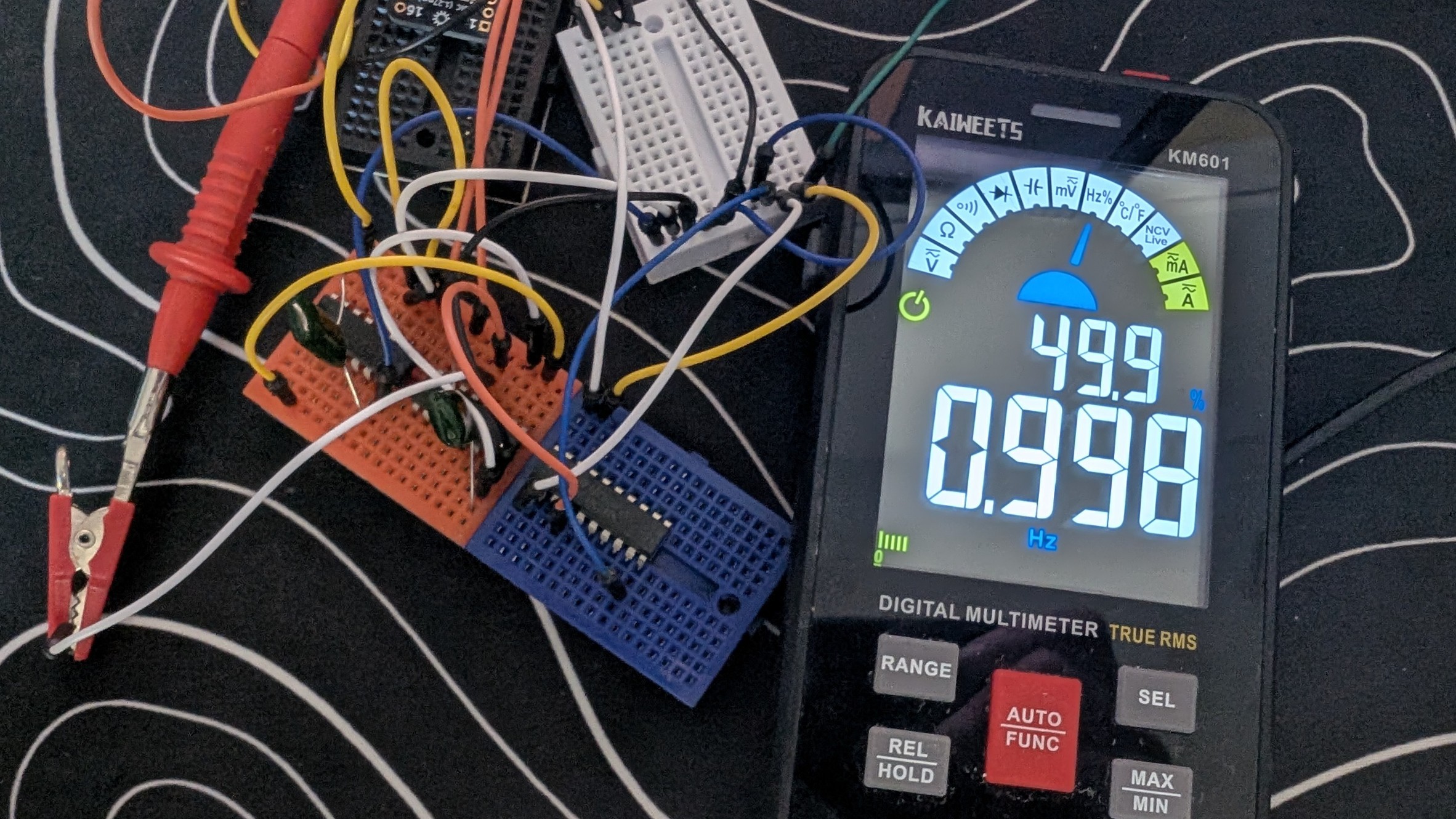

  • But does it work?
    typecad07/20/2025 at 14:31 0 comments
    When the components arrived, I mounted the TCXO onto a breakout board and put it together on breadboards section-by-section.
    TCXO 🡒 74HC4060N
    After I remembered to pull up the RESET pin, it worked. My MM measured 256.00.
    74HC4060N 🡒 74HC4040N
    This one was confusing. The datasheet pinout doesn't match any of the symbols I could find. The typeCAD code also had issues with this. It provided the correct pin names, but not the correct pin numbers. After matching the typeCAD pin name to the datasheet name, I got the pin number and there I got 0.998 - 0.999 Hz.
    74HC4040N 🡒 74HC244N
    The same issues came up for this as well. The symbol was different than the datasheet. The typeCAD code had the correct pin names, so matching names to pins provided a nice driven 0.998 Hz signal that would light an LED.
    Thoughts so far
    At this point, it works. AI designed a 1 Hz blinking LED with very little input and guidance from me. The issues with the pin number vs pin names would have come up for me as well. The particular components that were used didn't seem to match the more common pinouts for these old components.
    I did prompt the LLM 'validate U3 against [datasheet]' using the newly developed typeCAD MCP Server. Since LLMs can't read PDF files, it needs to be converted to text and that process doesn't result in easily understandable text:

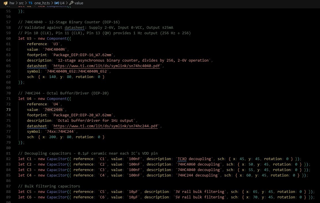

  • Making the circuit
    typecad07/04/2025 at 18:32 0 comments
    I copied the circuit description into Cursor and used Claude Sonnet 4.0 with the following prompt.
    Create a typecad circuit according to the following description. Use @typecad.json @website.json for reference.
    [circuit summary from last post]
    I'll create a new TypeCAD circuit file for the 1Hz pulse generator based on your description. Let me first examine the existing files to understand the structure and then create the new circuit.
    Read typecad.json and website.json
    Now I'll create the new 1Hz pulse generator circuit file based on the description provided. I'll create a comprehensive circuit that implements the exact specifications:
    one_hz_pulse_generator.ts+219•9

    Claude guessed at the footprint for the TCXO. After that was fixed, the file built with no issues. I opened the generated kicad_pcb file, and the parts were there, ready to be placed and routed. I decided I didn't want all the test points; I didn't like the connectors it chose, but other than that, it appears to be correctly created. AI did the entire schematic portion of this project.
    The typecad.json and website.json files referenced in the prompt are JSONified documentation to teach the LLM how to use typeCAD. They are attached to this project in the Files section.
    Code Additions
    I added additional code to create a schematic. I also added PCB layout information for the components. The vast majority of the code remained unchanged, and the additions were for extra features, not strictly required for a working PCB design.
